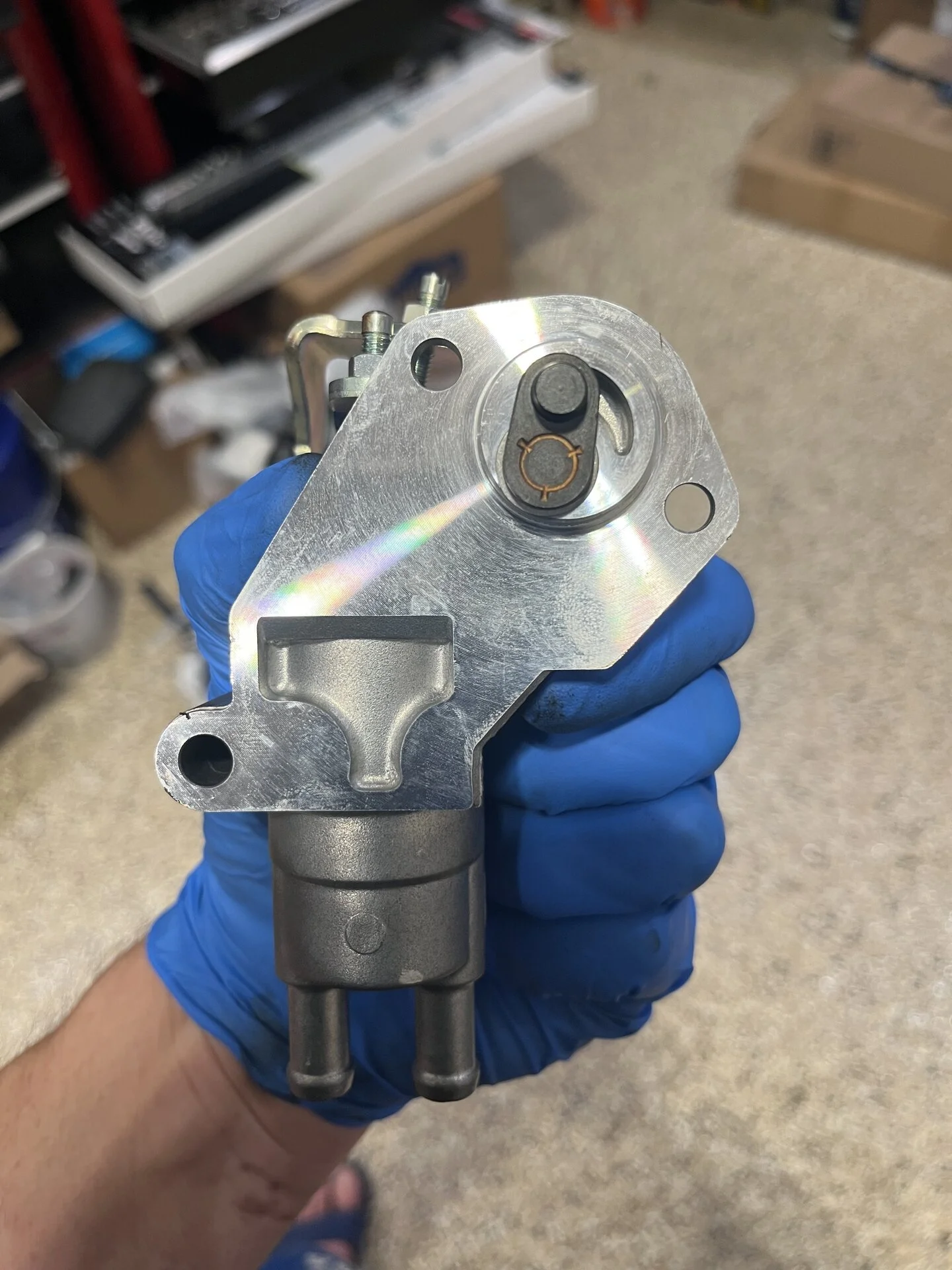

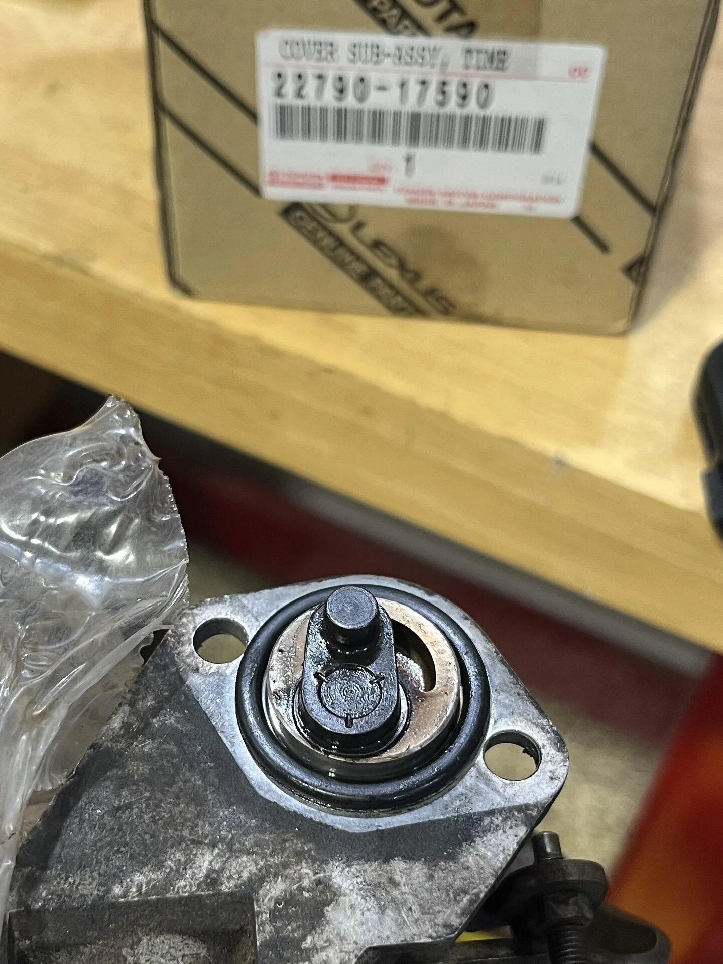

I have your kit on the work bench. Thanks for putting them together.
What I am asking is - any known problems from replacing the ACDS with a new OEM part? It's clearly more expensive than the delete option but does retain function. If original part lasted that long, I don't see any harm in replacing the assembly with new.

Removed and replaced with new. Original had 250k KM on it.
This is off a LHD. The swap took just under an hour. Replaced the o-ring with new oem. Like others have said, you loose a small amount of diesel and coolant.

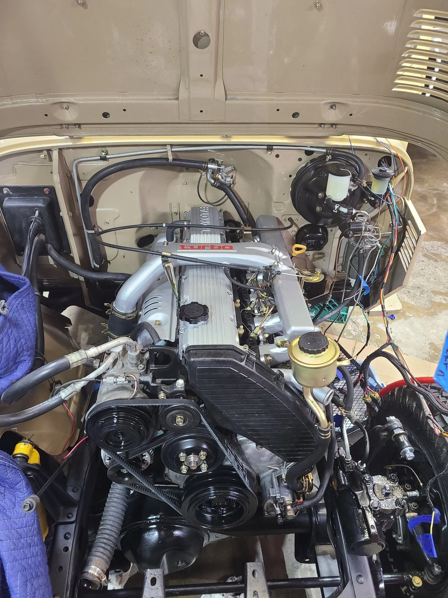

Great thread, thanks to all who contributed. I have a 1HZ-T outfitted with a ACSD and oil cooler plate from a 1HD-T. I'm guessing with the Thermo Wax and diaphragm cover this is an injector pump off a 1HDT I'm a huge fan of having less parts, so I will be removing this part. Wiring and brake lines are super sloppy and next on my list...
Great thread, thanks to all who contributed. I have a 1HZ-T outfitted with a ACSD and oil cooler plate from a 1HD-T. I'm guessing with the Thermo Wax and diaphragm cover this is an injector pump off a 1HDT I'm a huge fan of having less parts, so I will be removing this part. Wiring and brake lines are super sloppy and next on my list...View attachment 3455554View attachment 3455555
The top diaphragm from a 1HDT fits the 1HZ pump, which is hopefully what the PO did. Never just bolt up a 1HDT pump to a 1HZ, the pump pressure is too high.
Great insight. Hopefully that's what previous motor owner did.
There's a whole lot of brand new shiny parts on that pump and engine!
Is the previous owner able to give you any insight into what was done with the injection system?
Its possible to build a lot of 1hd-t features onto a 1hz pump. Housings are essentially the same, so things like the boost compensator, and ACSD would be able to be added.

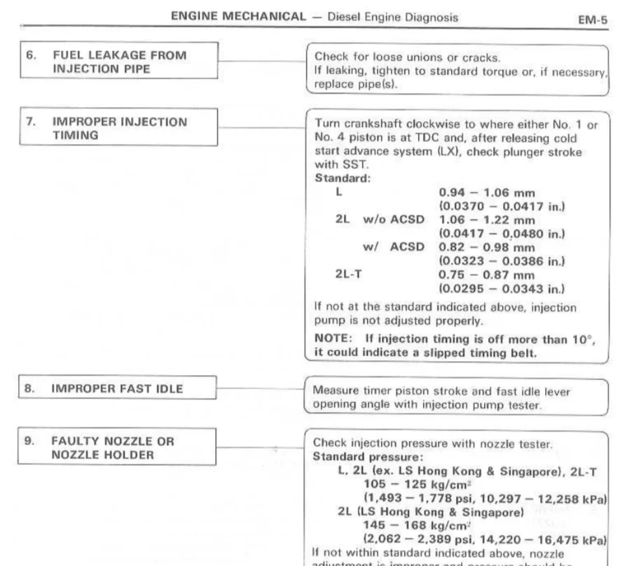

The service manual states different static timing settings depending on if the ACSD is installed
I only have information for the L series engine but I assume it is similar for your engine.
After removing ACSD. A slight advanced timing may be required. If your pump is warn the specifications can be off still.
