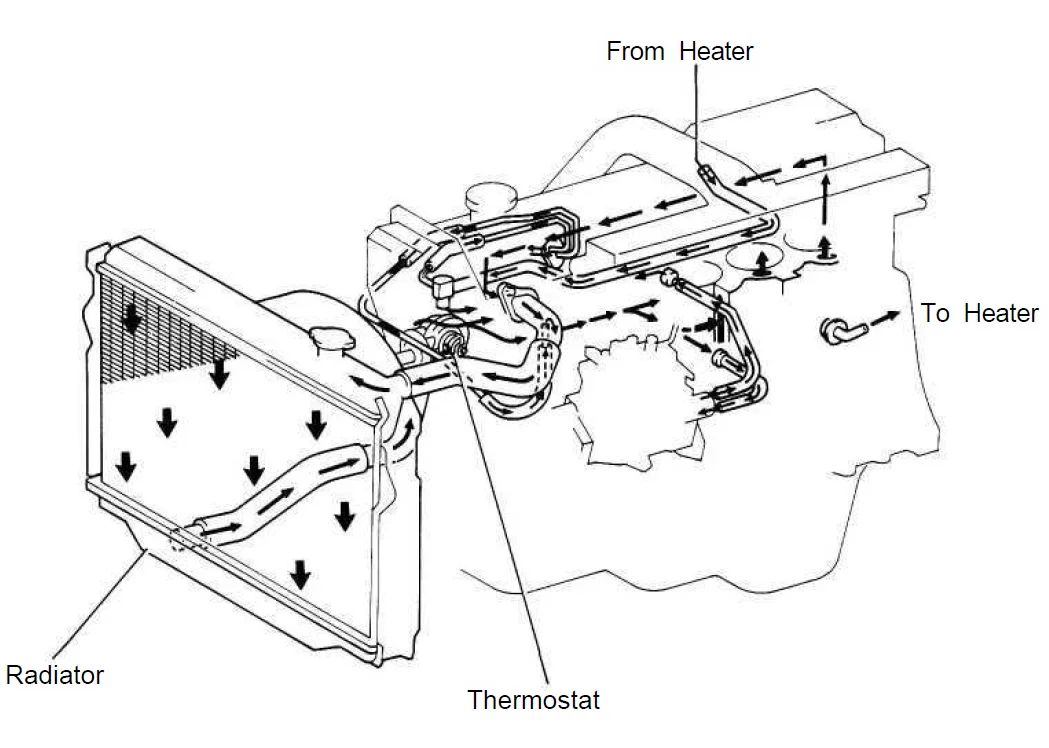

That is what I am planning on doing - capping them at the block. Based on this flow diagram, ACDS coolant supply is just an accessory. Capping it will not change anything.

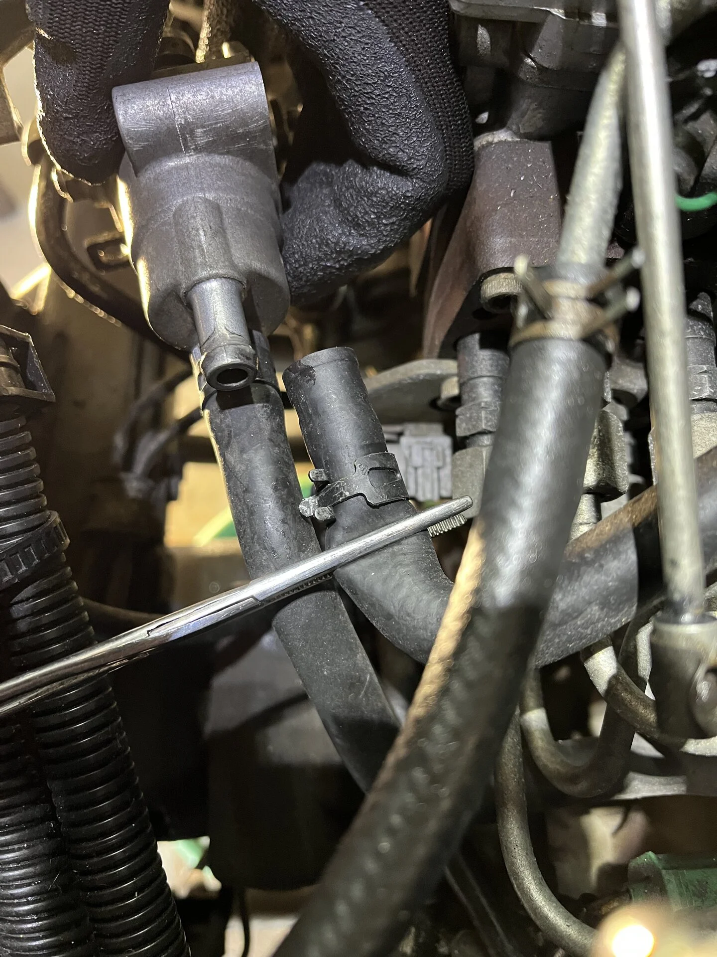

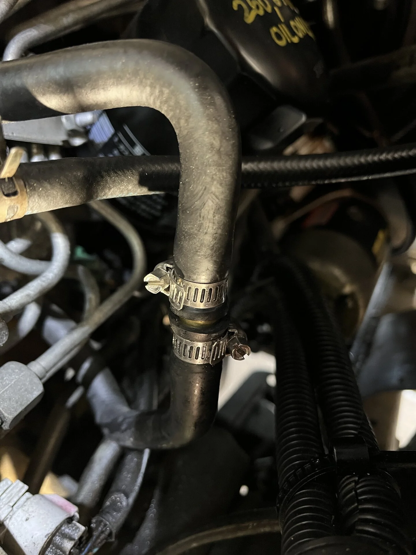

ACSD delete completed today…..

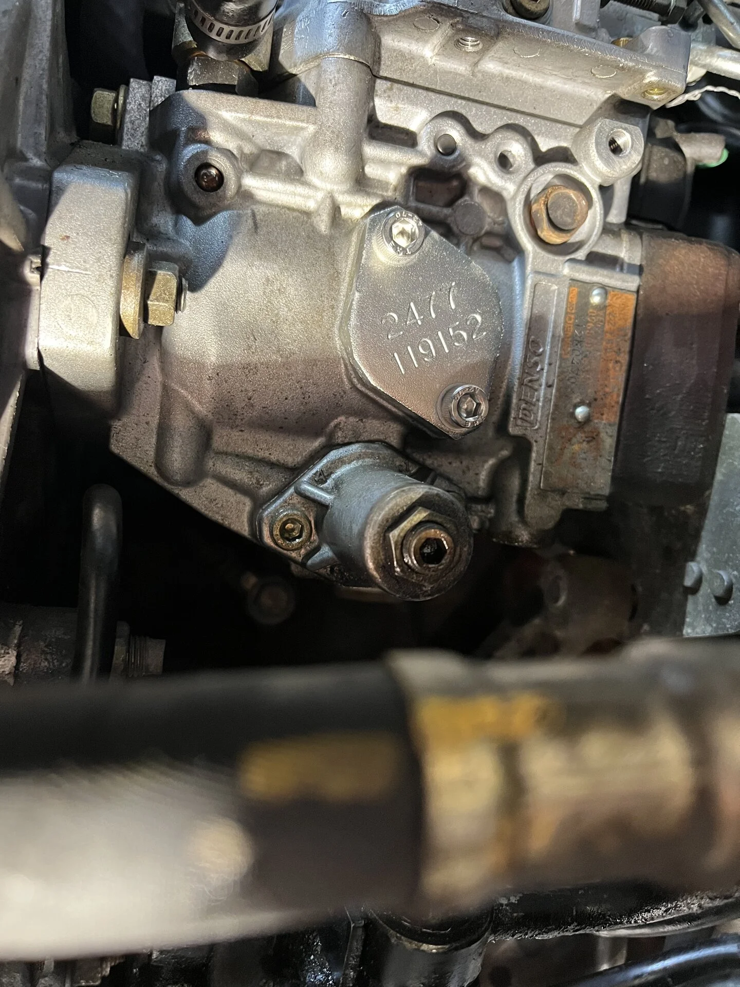

Thanks to Stiles and Hillcountry for their photos and description. Definitely a fiddly proceedure for sure. The bottom Hex bolt on the ACSD broke loose with a LOUD snap, I practically pooped myself as I thought I broke a bolt. All bolts were hosed down with PBlaster. The top hex bolt got caught up on the spring and required careful movement. I had to use a flat head screw driver to move the cold starting lever (?) forward to access the top hex bolt, the spring is quite large. I used the Back40 imports kit and everything worked great. The engine fired right up without hesitation (I primed the fuel pump with 20 plunger presses). No leaks, fuel or coolant. Also, I bought 2 new hex bolts for the ACSD delete plate. They are M6x12 and both fit perfectly. M6x16 are too long btw.
Interesting to use a union. I just got. A longer piece of hose I don’t like worm clamps.
Me either but it was 90+ degrees in my garage and I was done for the day. Maybe do something with it in the future.
Ok just keep a eye on the worm clamps. They seem to loosen up in time.

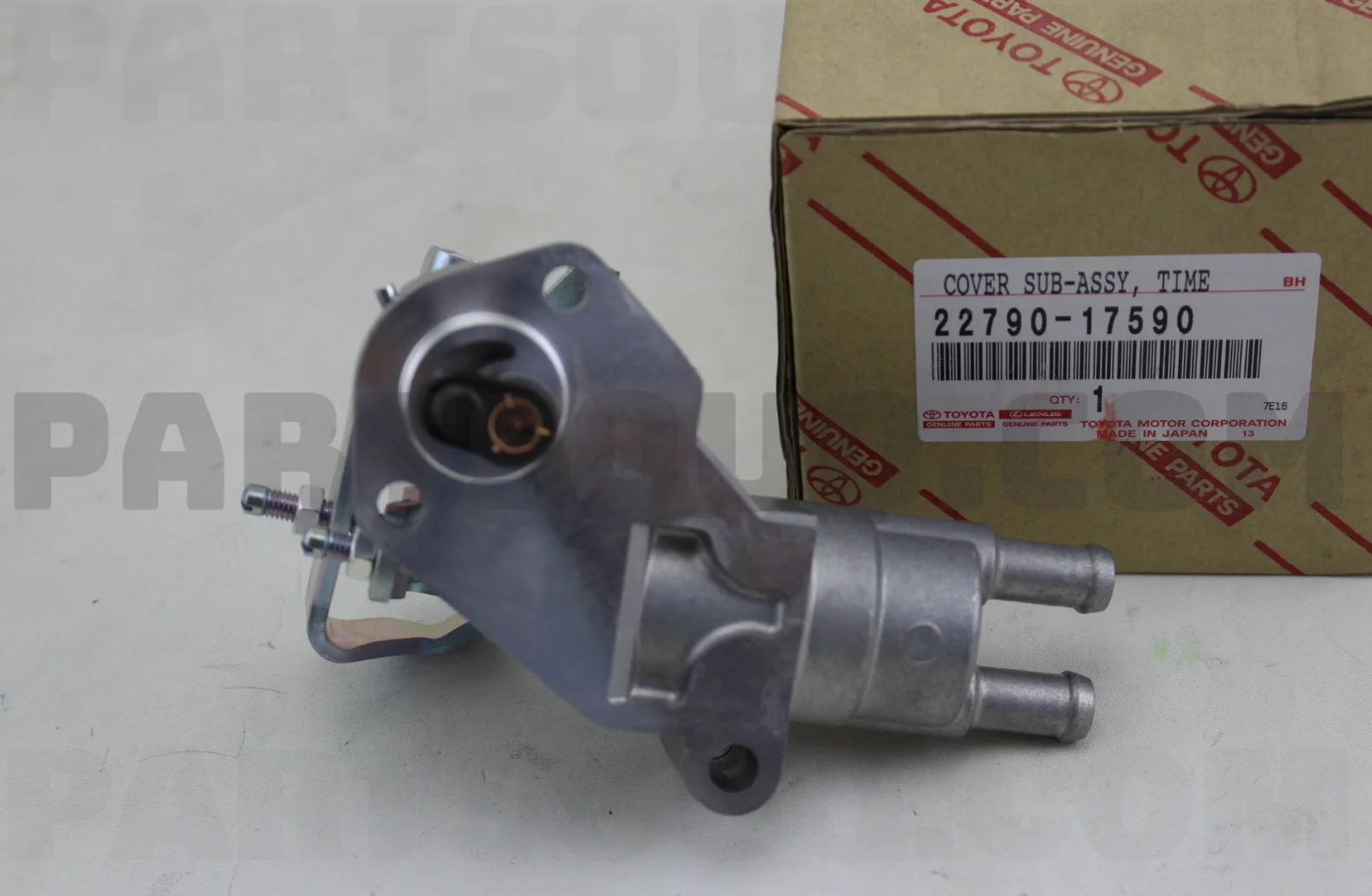

I had a change in direction with this - Since the ACDS is still available new from Toyota at $223 USD, I will replace it instead of deleting.

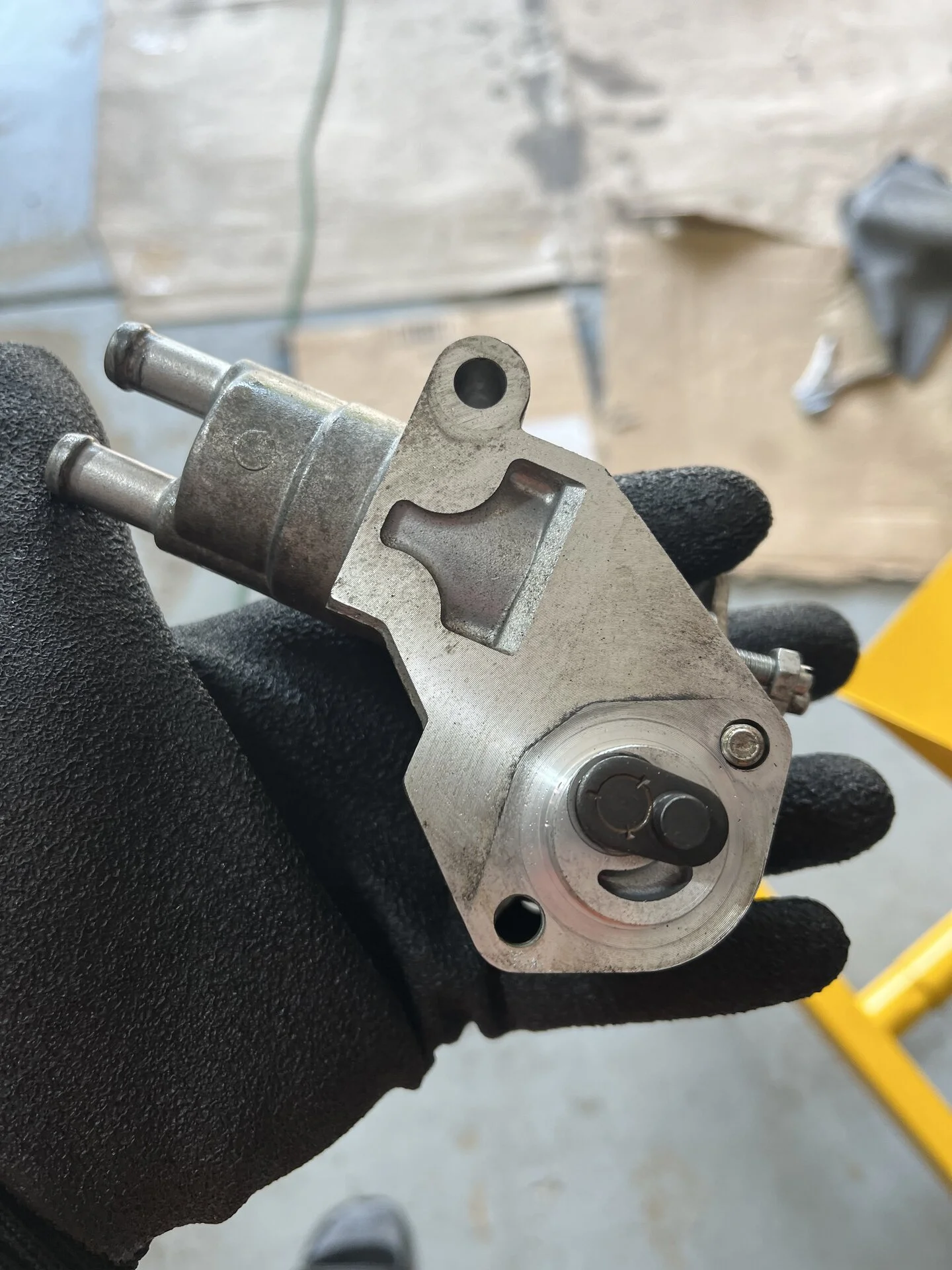

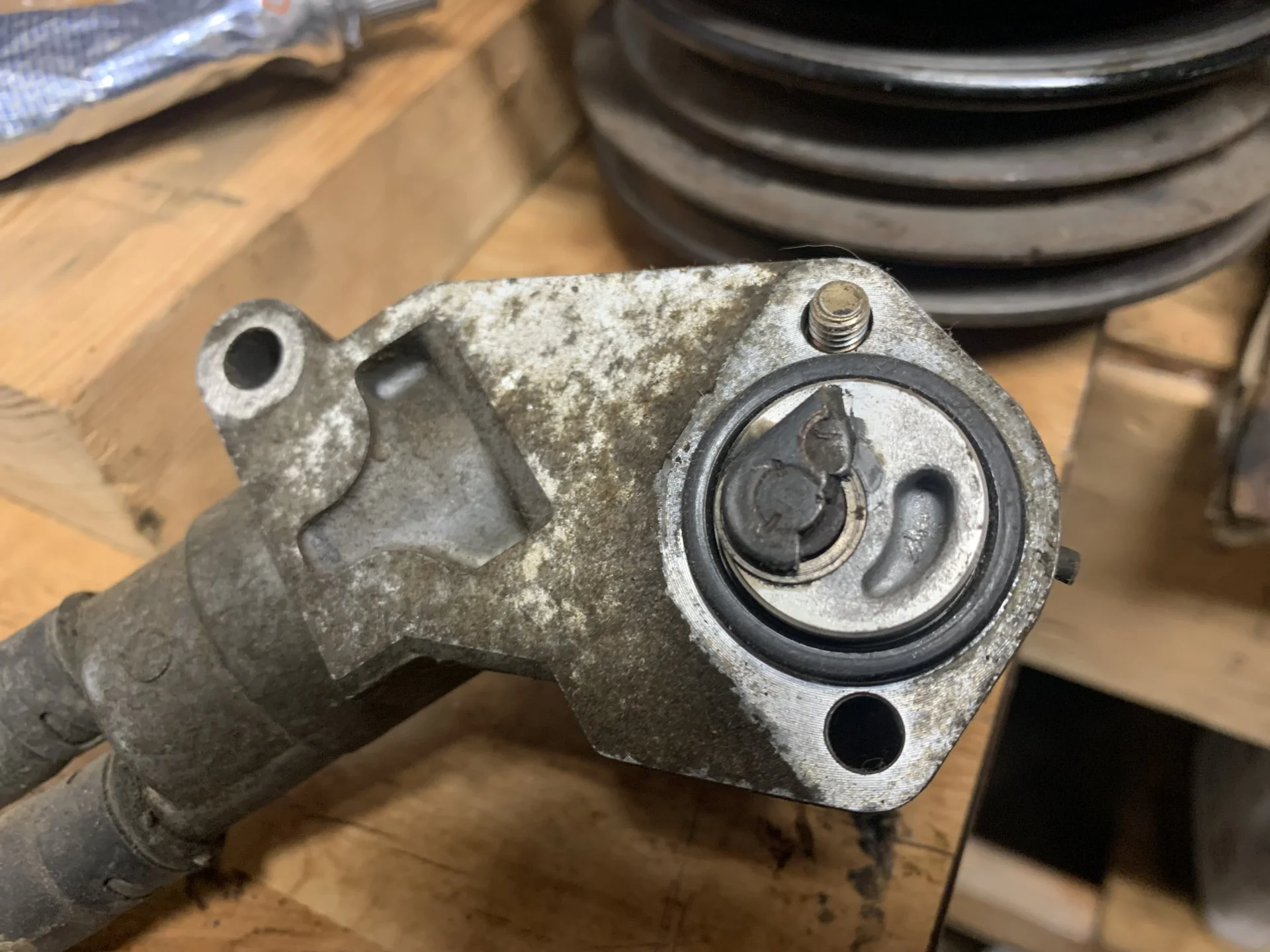

You want me to talk you out of it? Ok, here goes… Just to be clear, I offer a delete kit to keep the Cruiser community supplied with a necessary maintenance item. I think I clear about $5 profit from each sale, so really not worth my time actually. However, catastrophic pump failures will keep your truck from starting in all temperatures. See picture attached

If you do decide to keep it, i have a BNIB ACDS i could sell you for $200 all in.
