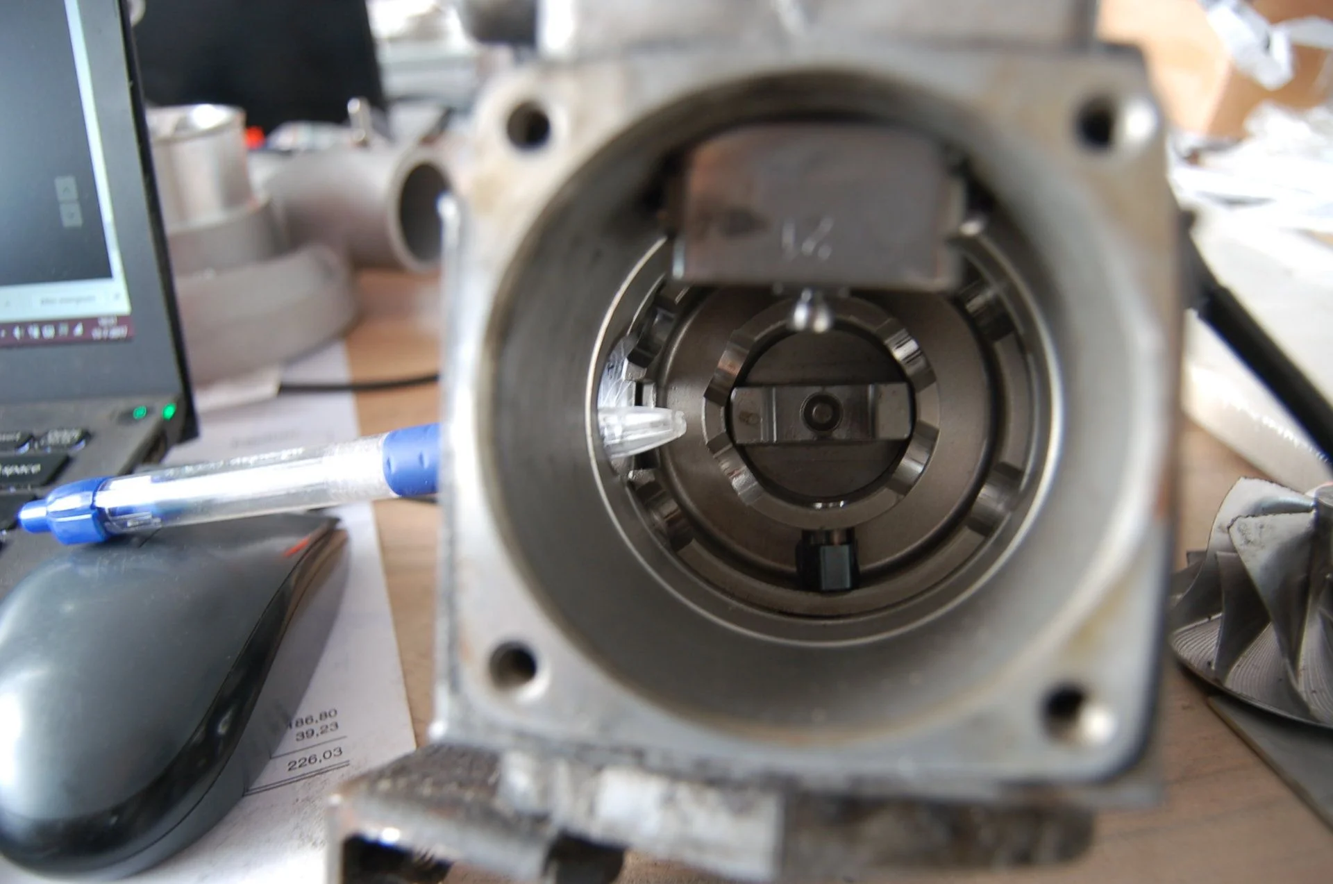

made a picture of the other side of the hole on a IP housing I had laying around on my desk. The ballpen is where the ACSD is fitted. So the ACSD mechanism rotates the whole roller plate. The rollers are normally fitted into the 4 crossed slots.
how hard it's to rotate the roller plate by hand ?
Easy. But there isn't spring pressure from the roller springs at the pump on the picture. I guess its very hard to turn if the pump is assembled.
ask coz the spring assembly on the ACSD it's very " stiff " so I guess it must overcome great force in ( roller plate ) or out ( throttle linkage ) which does not seems to be the case ..
And related .. if the ACSD it's not there anymore with the blank plate, what prevents the timing from moving freely ..
