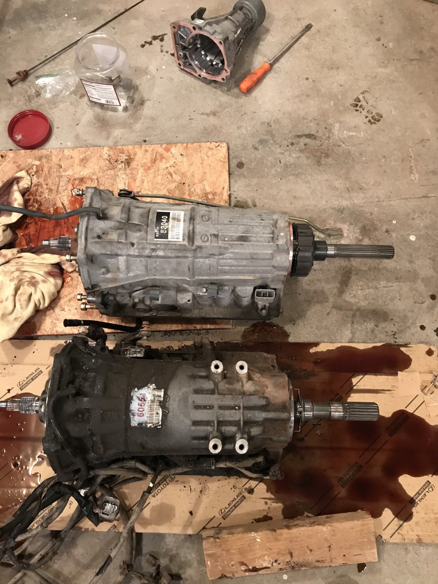

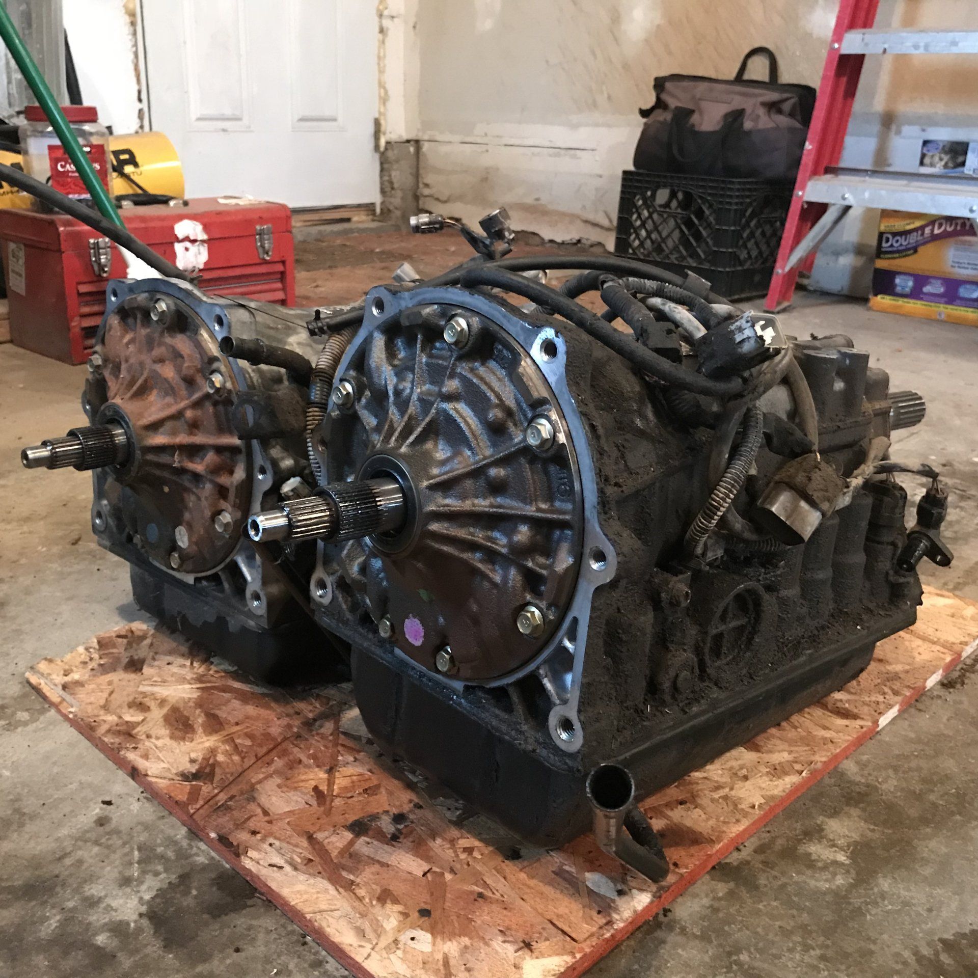

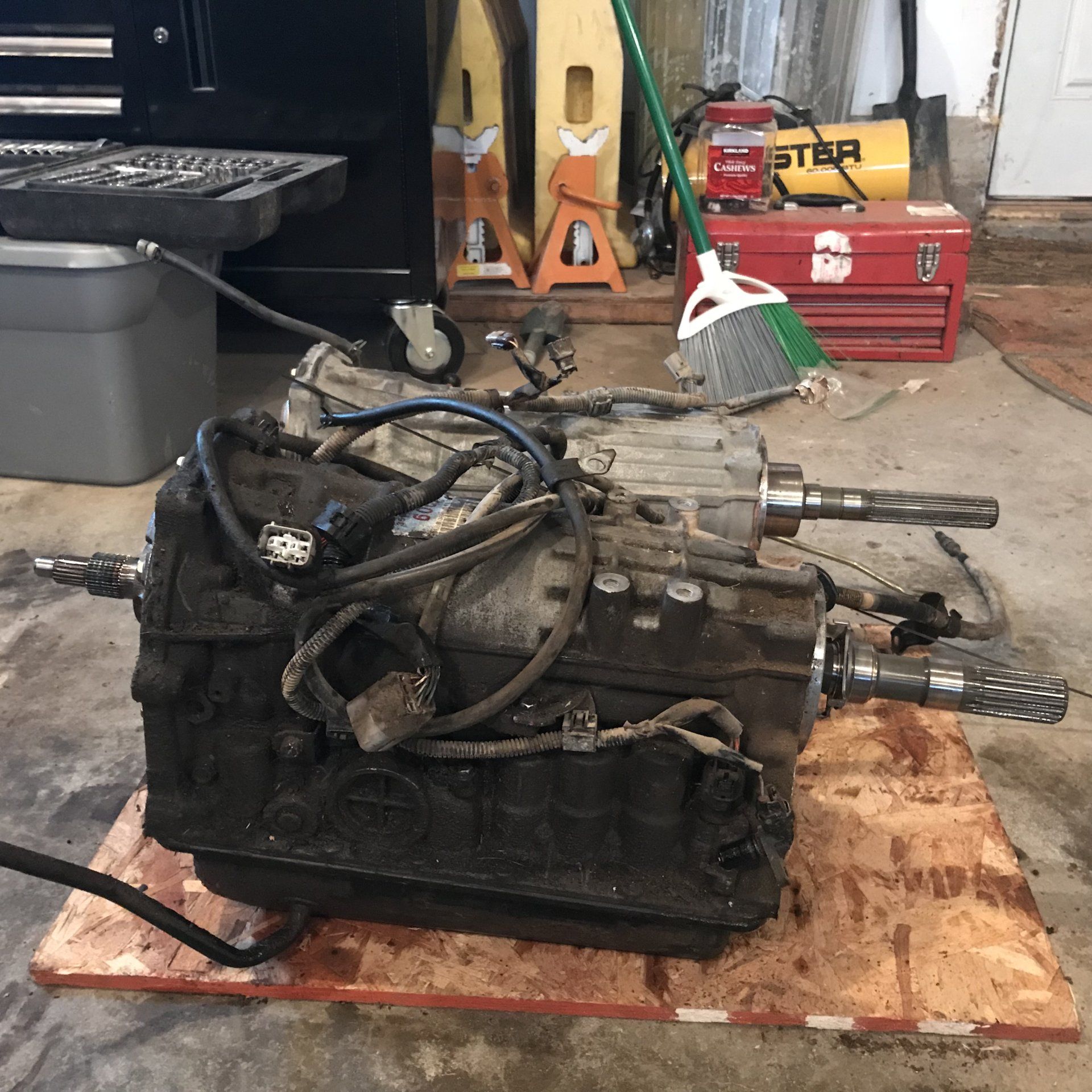

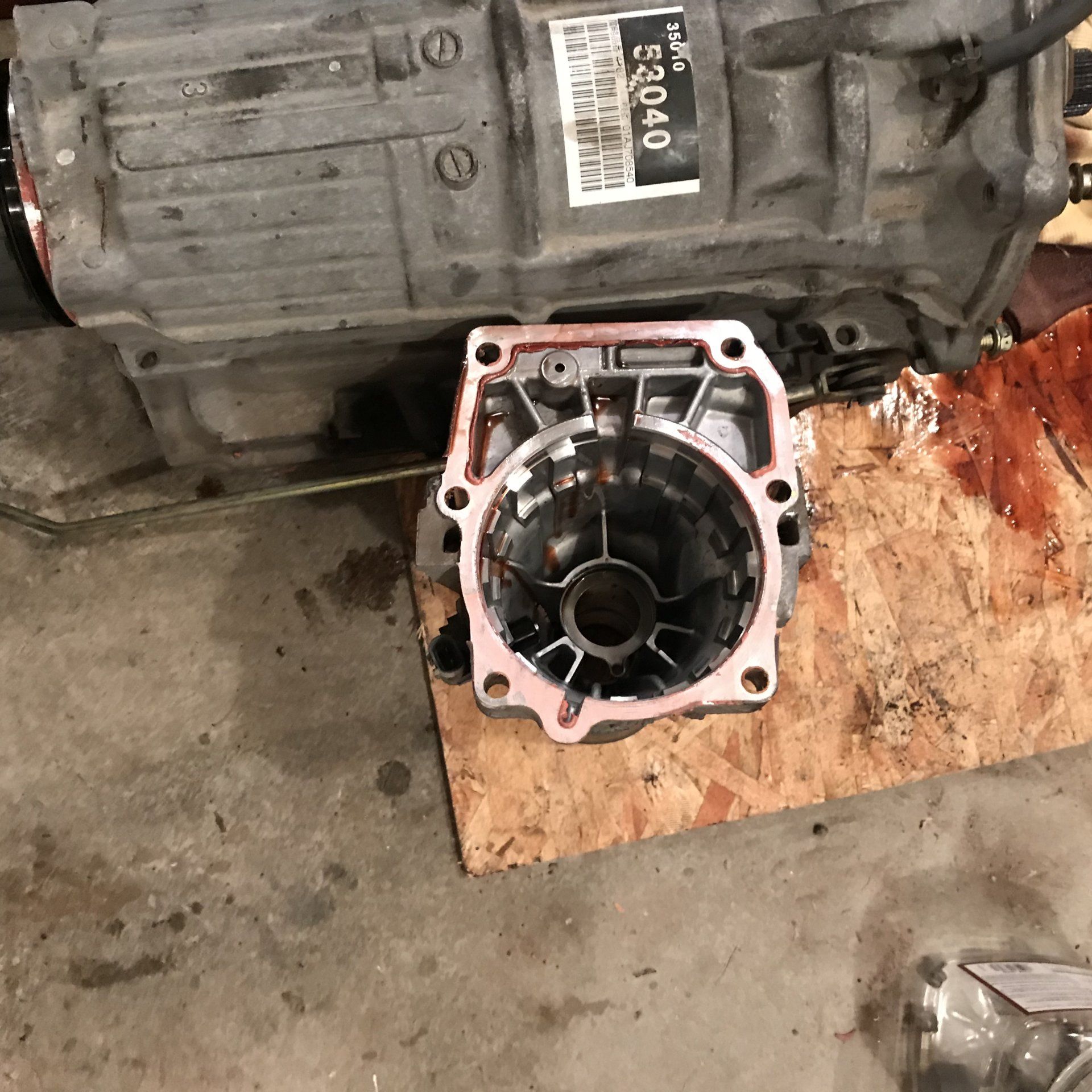

Hard to find the right angle for a photo, but the A343 pan is much deeper than the A650, thus it sits higher and at an angle compared to A650 when both are sitting next to each other.

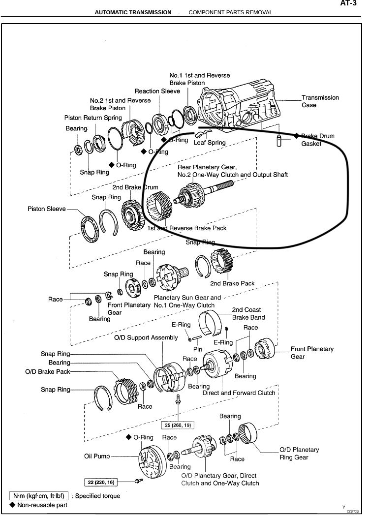

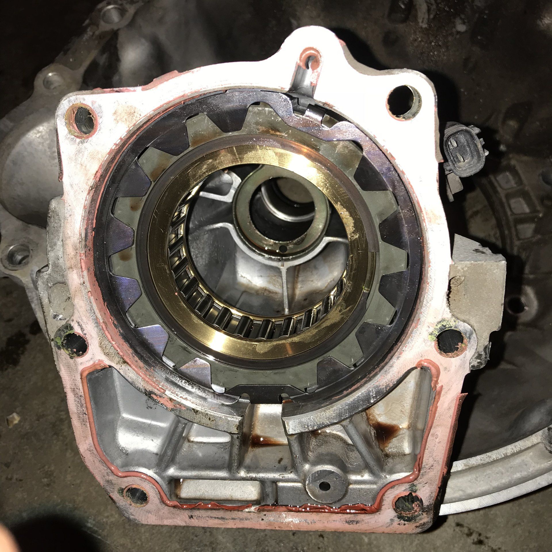

A343F, the No. 2 One way clutch is INSIDE the main housing. The tail housing is “empty”.

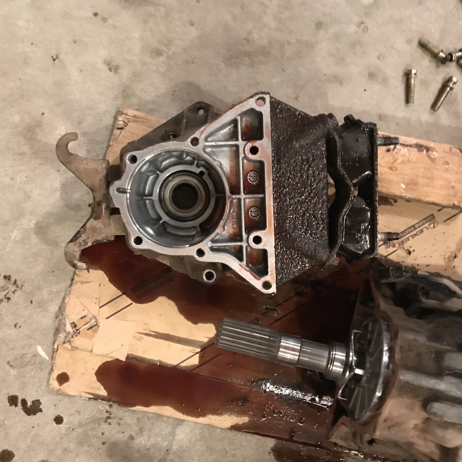

A650E, the No. 2 One Way Clutch is OUTSIDE the main housing and in the tail housing.
Game Over :(
