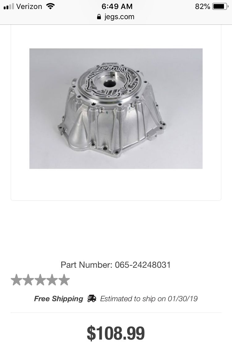

It will be a .65 or .75” thick plate to make the HF2A bolt to 6 bolt pattern transmissions.
If @NLXTACY doesn’t come up with something first, I was going to use the spud shaft from this kit and cut it down. (I’ll probably use the tail housing too).
That will give me about an 1” for the adapter plate between the 1FZ and 6L80. Hopefully I’ll be able to clear the starter without notching the 6L80 bell. But at least it’s removable and only $100.
