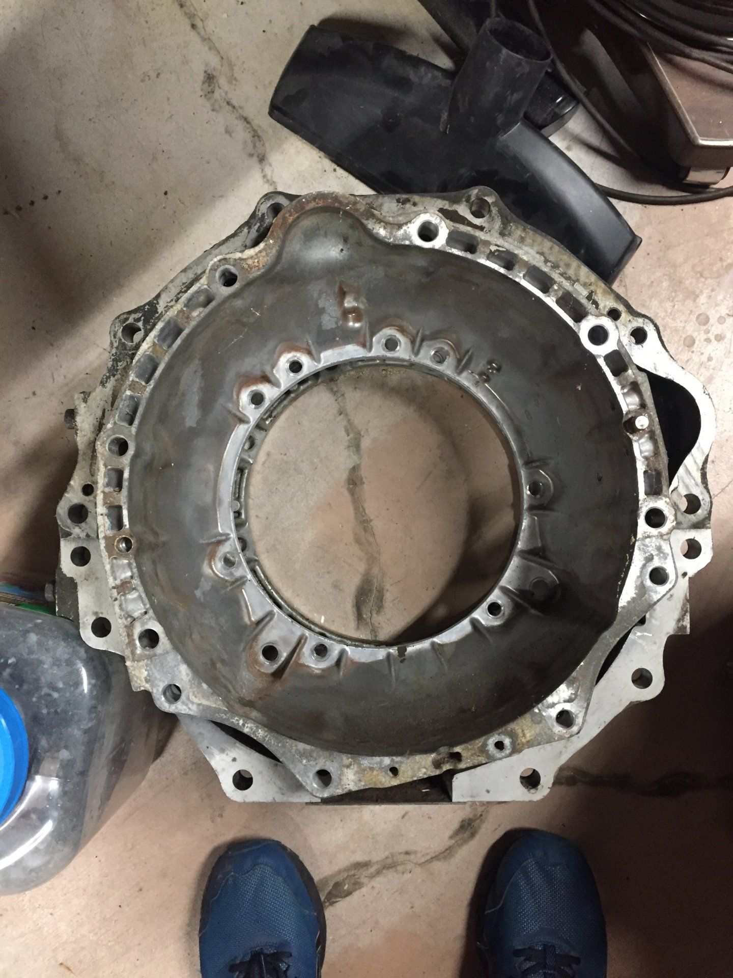

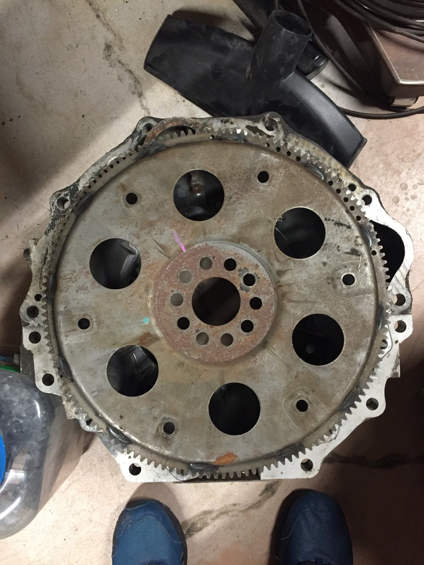

5 9/16”. Shallow and the converter is very small. Picture is the a750f bell inside the 1fz pattern with a the 1fz flex plate. It would be a thick piece of material. Crank adapter needed for pilot. Extension, converter adapter for flex plate, thick intermediate plate like you posted.

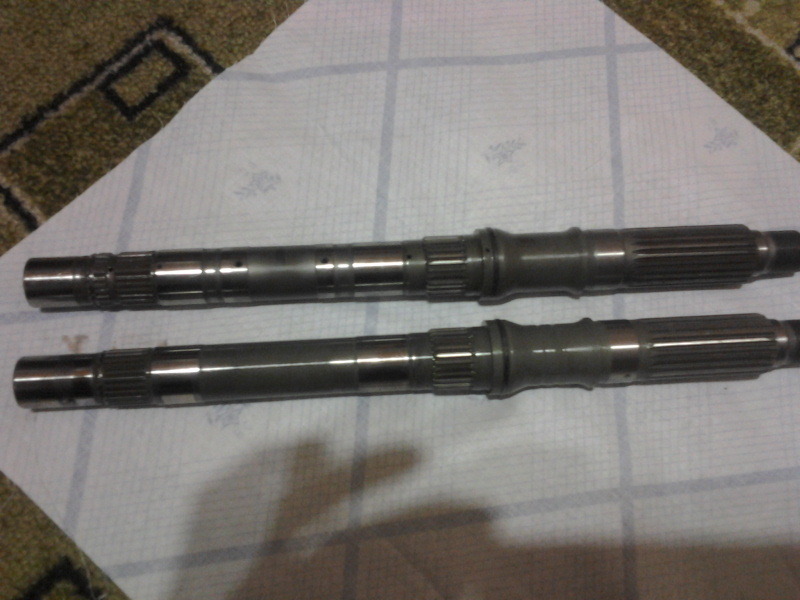

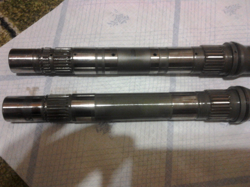

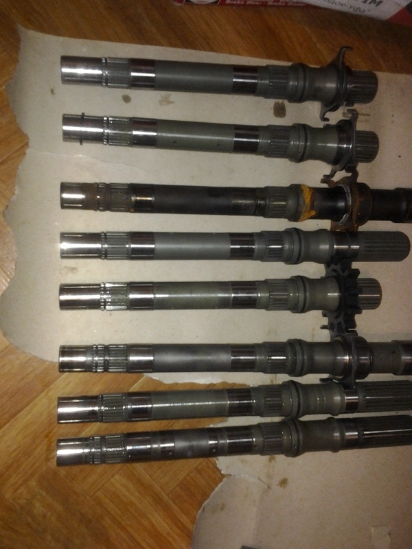

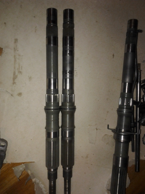

First of all, in accordance with this instruction, it is necessary to find a box with the correct output shaft, of the required length ...

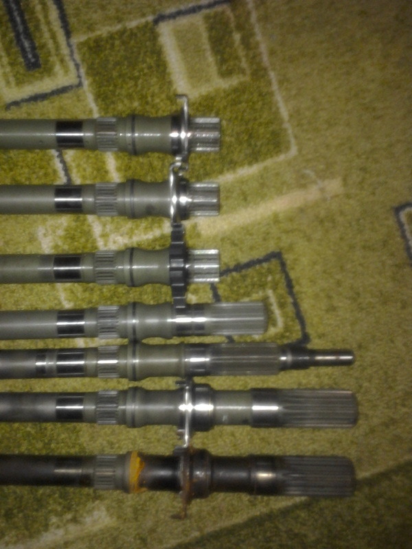

I have a lot of shafts and different…. Just a photo, the differences of the shaft shafts under a different slot and different handouts.
The same shafts but already the part that comes in the box ...
Please note that one single shaft of all, the one that is below, has a pair of additional grinding for additional supports in the sliding bushings.
Here it is in comparison with the same from the same machine and the same box ...
Here we will use it ...
This is it next to the shaft of the hundredth cruiser .... Even the weave has no such additional polishing, and the 343 cruiser is considered the pinnacle of the development of the 343 series of boxes ...“
Thanks, that’s helpful! What’s the overall length of A750F from bell housing to engine surface to transfer case mounting surface? It’s 28.5” with the 1FZ A343F.
I am wondering if there’s any length left for an adapter plate between 1FZ block and A750F bell housing, possibility with V6 bell, starter is about same location as 1FZ.

27" plenty of room. My plan was to always match the length so no driveshaft or cross members had to change. with that space, it really wouldn't matter where the starter on the A750F bell was it would all be accounted for on the intermediate plate (yes same transmission mount used on the LC/LX not sure on 4runner version)

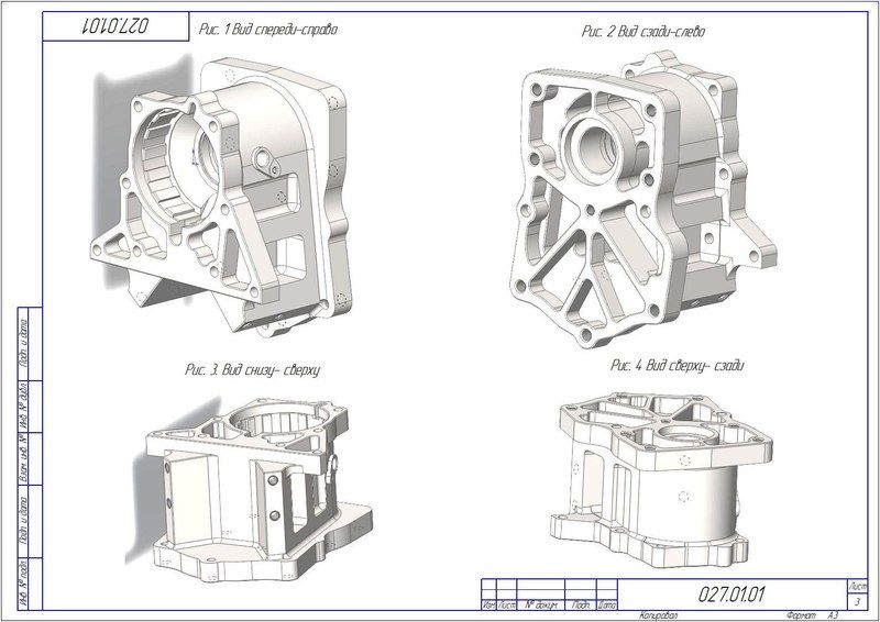

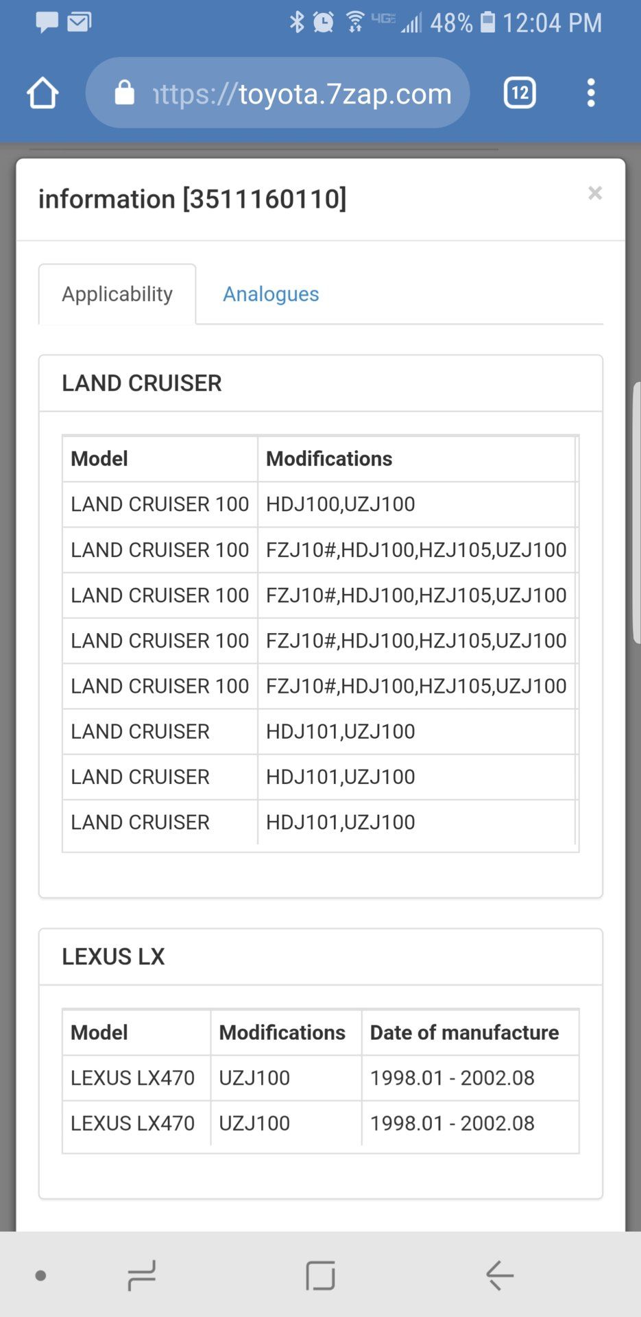

I was looking around and found this
A few more
Does this mean that toyota has a bellhousing for the A750 that bolts to the 1FZ?
Is this what we need to make the A650E work?
Interesting! Where did you find find that drawing? And the follow up question, is the part actually available? Where?
I tried googling A650F couldn’t find anything.
I got it from that Russian LandCruiser website. Here's the Link
