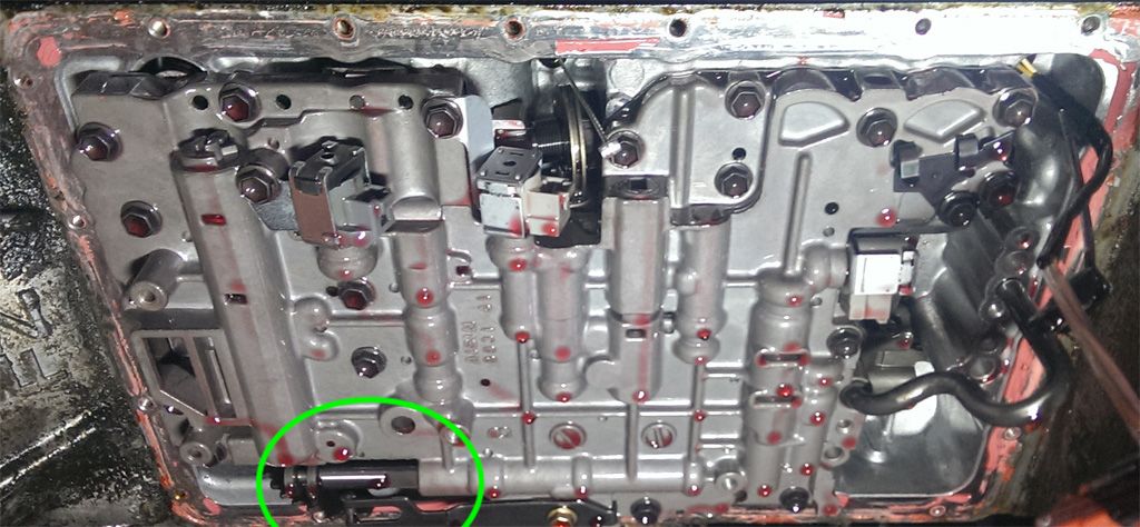

So having some trouble that I think is tied to the installation of the shift kit. Finally getting my rig running again and its like its missing a gear. pulled the shift linkage off and I can only move the lever through 4 positions. Have a spare tranny in the garage so I know it should have 5. Engine starts fine in park like usual but once placed in reverse it still only moves forward. To get neutral to shift the transfer case it has to be in drive. When I set the shift linkage up as per the fsm I cant get into 1 or L, which I believe is the lever pushed all the way forward. Any thoughts before I drain it and drop the pan? So far I have only done a cold fill because it cant get out of the garage to drive it and check the level hot without reverse.
Sounds like you didn't get the shift linkage lined up with the rod on the valve body.
Figured so. Thanks. Should be able to fiddle with it with the pan off until it pushes through all positions.
Yup. shift lever wasnt connected to the valve body rod. Works now.

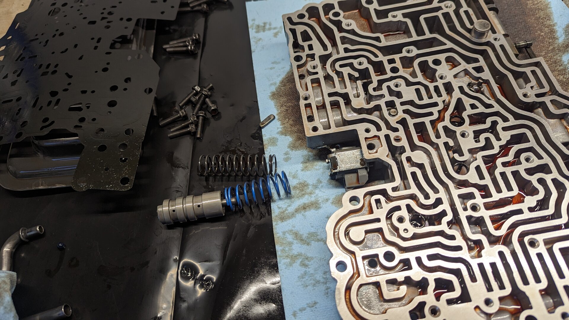

Installed the transgo shift kit in an A343F out of a 1997 Fzj80 today in preparation for the new motor and turbo going in. Drilled out the 1-2 2-3 3-4 shift holes, removed the balls it said to and replaced with the ones supplied. Was easy and straight forward
Upper valve body, one check ball removed, nothing added.
There was some confusion about this one earlier in this thread. The ball the screw driver points to stays, if there is one in the square to the right remove it. This one did not have one there.
Lower valve body, one ball removed and spring replaced with the blue one of the same diameter.
Pictures of the accumulator springs after changes have been made
