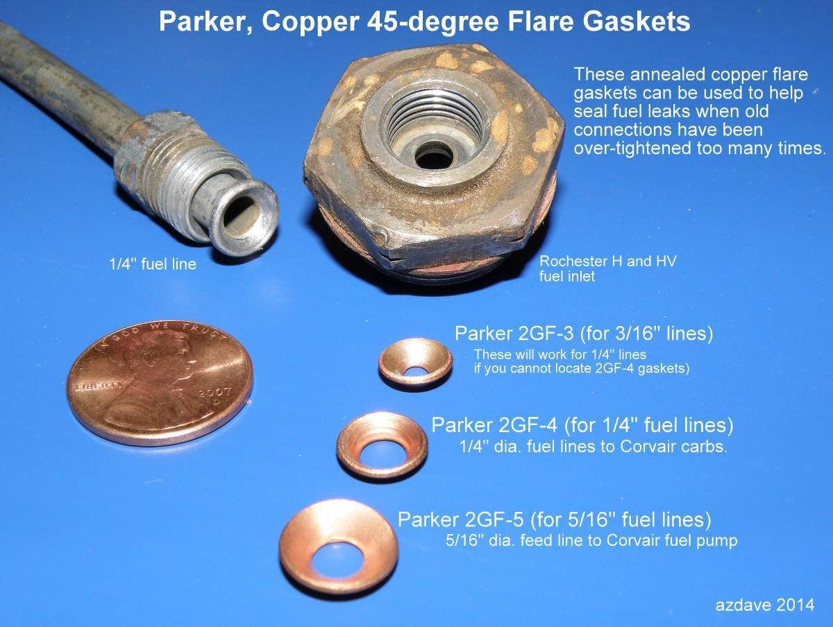

I remember seeing some at one of the local parts houses and they were kind of fancy with some coating of some sort on them similar to these..
Well there you go. Thanks! Forgive my ignorance on brake line connections but which one would you use? 1/4"? The OD of the flare measures just under 0.275" on the brake connection that will be going there. I assume the flares and connectors are all the same in the brake system but I just happened to have the jumper from the front to the rear cylinders handy.
Edit: Guess you would use 3/16" based on your second post?
