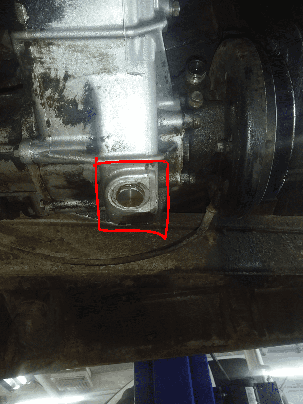

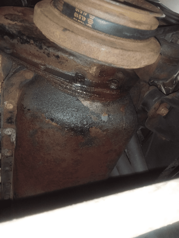

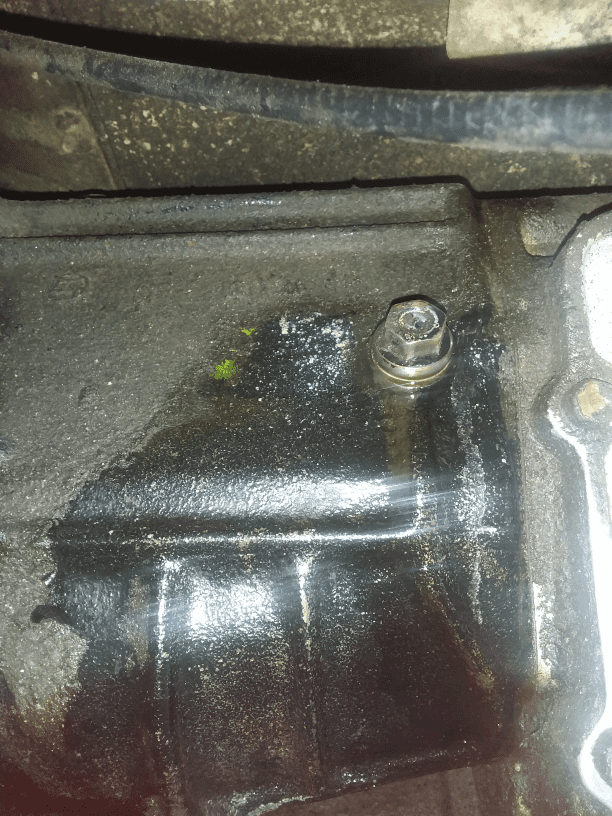

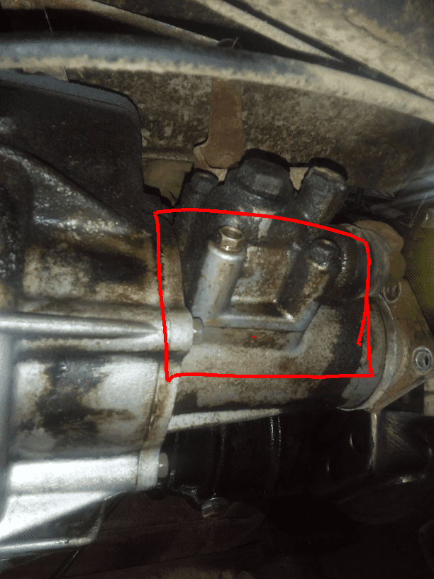

I got a report from the installer that included some images, which I thought I'd post with the hopes that folks might be able to let me know if any of these are anything to be seriously concerned about. They all look to be pretty minor and nothing is dripping onto the driveway. Two are at drain plugs, so perhaps a new o ring on those would fix that, and I wonder if a little retorqueing of some bolts might adress some of the others.

I got a report from the installer that included some images, which I thought I'd post with the hopes that folks might be able to let me know if any of these are anything to be seriously concerned about. They all look to be pretty minor and it's not leaking. Two are at drain plugs, so perhaps a new o ring on those would fix that, and I wonder if a little retorqueing of some bolts might adress some of the others.
