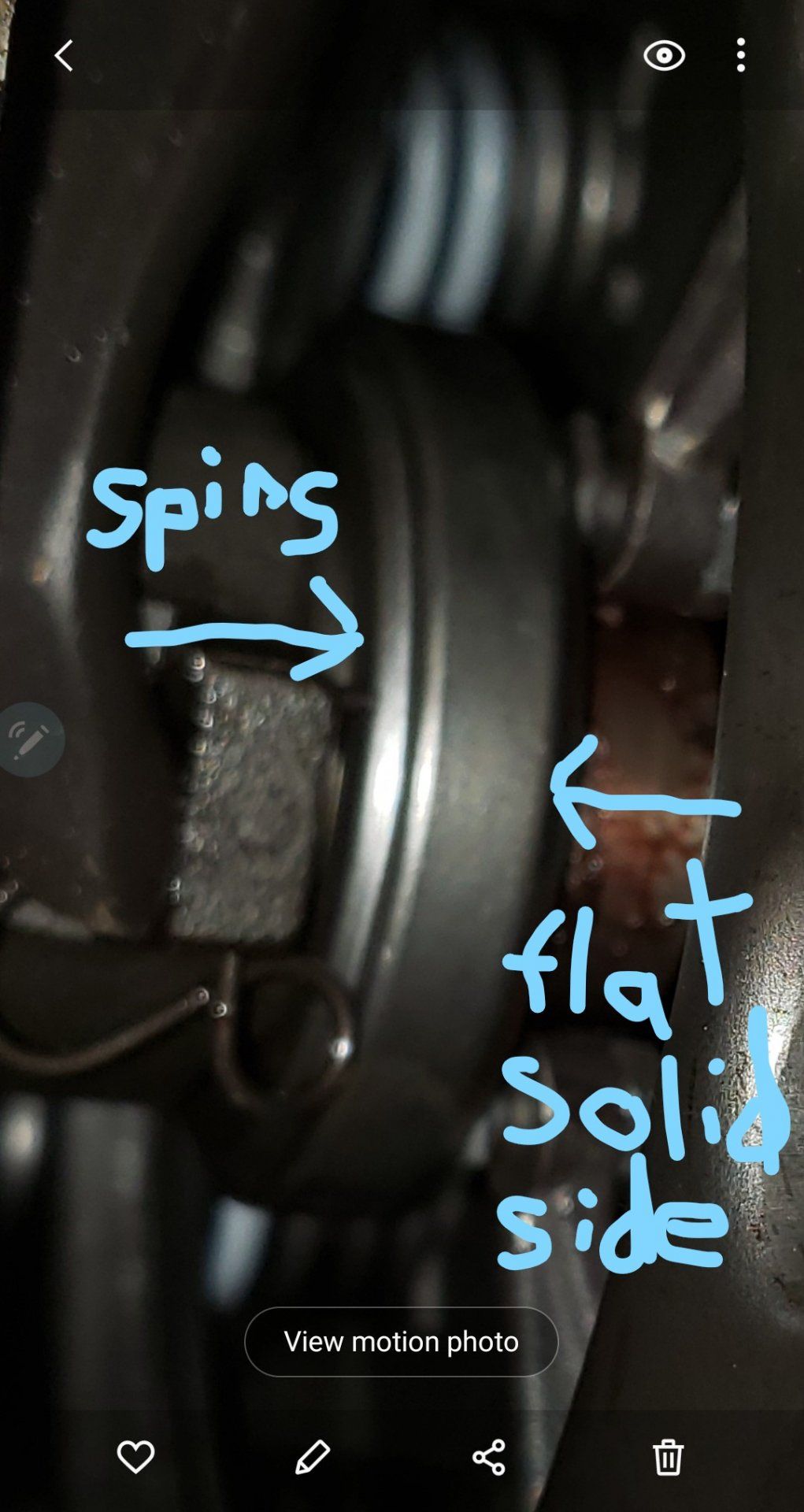

I'm pretty sure they installed it backwards. Can any of you confirm the part that spins should be facing the fingers on the pressure plate, and that mine is in fact backwards? I took the cover off and felt the spinning surface facing rear and the flat surface facing forward, but the shop called me after I dropped it off this morning and told me it's right, based on the fact that the old one that came out had the flat surface facing the pressure plate. The old one is seized so you can't tell what was supposed to spin on that one, but I'm starting to spuspect that was installed wrong by the PO.
If not and this is installed right, the bearing went bad in 2 weeks or they screwed it up when installing it. I really need the right information to hold somebody's feet to the fire here. Cruiser Corps has been helpful but is essentialy taking the position that there's no way their bearing is bad. The shop say it's installed right, although i'm really doubting them considereing they pinched my reverse light wiring harness on the origianl install. Factor in the pilot bearing being bad from the kit and you have to wonder did they damage that on install, or was it actually dented out of the box like the said. All I know is if I they try get me shell out the $500 for labor on a new bearing isntall, I'm gonna kill a MOFO

Hoping for them to get an open lift later today so I can go down there and show them what I felt, but won't be able to until after 3 pm and then it depends what their schedule is like. I'm bringin my damn tools and will take the cover off in the parking lot if I have to! I think the issue is there are lots of different looking versions of the throw out bearing and it makes it hard to know what's what. Here's the one they took out, which apears to have lips on both sides. Also here's the one I bought that I know has one flat side. Hard to tell but it looks to me like the side that's facing up on that new one would be the spinning side and what I beleive to be facing rear to the trans in mine (last image)

I guess I should have stated, I am pretty sure the wide side turns and that yours looks correct. I would look to another who has been in there in the last 5 years to confirm
Understood. I'm gonna go down and inspect it with them hopefully today, regardless. I know I felt the front side not moving and feeling solid, but I do think that was the wider side.... but like I said, I'm seeing more than a few of these styles types of bearings
follow up - the owner at cruiser corps just texted me based on the same pics that it appears to be installed correctly, but I'm still not sold. I know what i felt under there. Maybe the bearing was damaged during install and it's not spinning correctly. If it is inf fact installed correctly, the shop is surely going to hit me for labor and likely the cost of a new bearing.

Ok. I thought I read that Friday, so I tired that and it doesn't spin. The only thing that spins is the back of the bearing. I even grabbed a huge set of channel locks to grab it to try spin it. barely moved, not even sure it moved at all. Did they smash it installing it maybe?
The slave cylinder might not be adjusted right. If the slave cylinder rod doesn't have any play in it then it's too tight. The TOB needs to have some free play when the clutch is engaged (foot off the pedal).
I know it wouldn't spin by hand, so this probably the case. I can almost see the fingers touching the bearing,...however, I had a the pedal pushed down with some boards at one point so I could run it and listen to the noise from underneath, and I think I may have taken that picture while the pedal was pressed...and then maybe tested the beariing while the pedal was pressed? I don't remember. Set to go to the shop at 7:30 tommorow with it on the lift so I'll see what we see
Scrappdaddy, that was it! Had them back the slave all the way back and it broke free but still rubbed a little. Will need to back down the tips on the pressure plate a turn or 2 to get it 100% free. They fought me and said 40 yrs of experience said the bearing should always spin with the motor but I pressed them on this and they backed down. I'm no expert but Im pretty sure that's bull****. I had a WRX that are known for TO bearing issues because people burn them out early becuase they have thier feet barely touching the clutch pedal, causing extra spin and premature wear.
