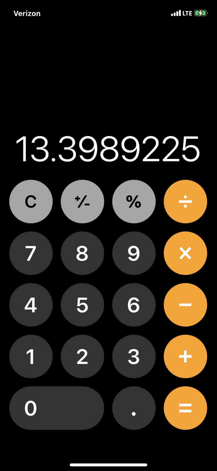

Last two fill ups:

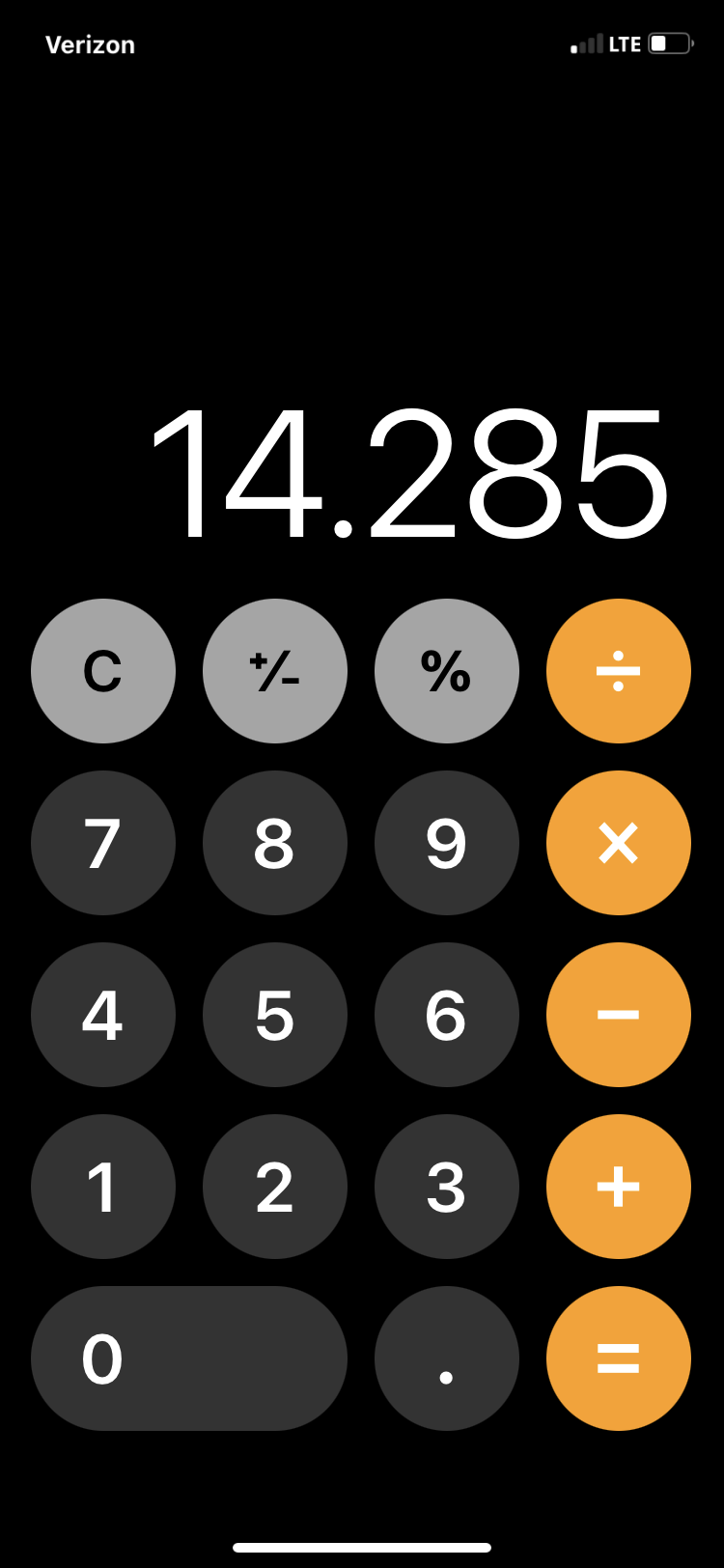

First was half tank spirited two lane road driving, the rest highway speeds 60-75mph:
Second was 95% highway speeds of 60-75mph with ECT turned on, remaining 5% was o/d turned off, 30-40mph:

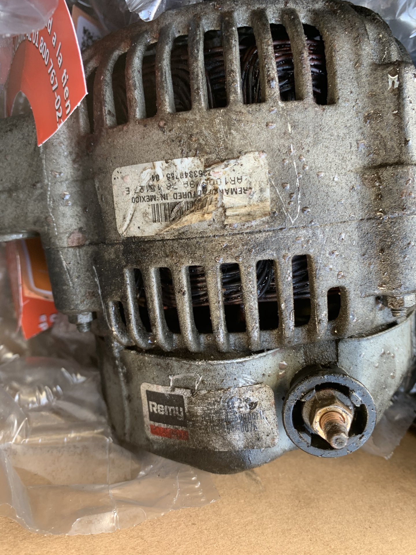

Dreaded battery light came on, accompanied with dim headlights.
Used Autozone checker and it states battery has 0% charge.
Bought a new alternator and battery to get me home, made it home.
How likely is it alternator is toast ?
Worst time too- we literally had just dropped off the loaner that we had for my wife’s car, which I can’t pick up (had loaner longer than supposed to) for a few more days.
Wife is not happy. Help
My tensioner has been squeaking for a few weeks intermittently. Is it possible that there’s maybe some slack in the serp belt that’s causing the light? I’ve driven 40 miles since I put battery in and it hasn’t come back

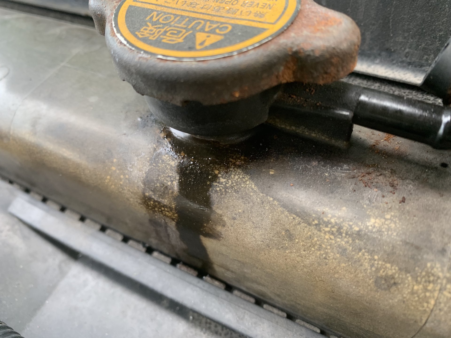

Well. Put the new auto store junk unit in. Boy my steering rack and hoses are in bad shape.
Discovered that it wasn’t an OE unit in there. Discovered that it is my tensioner pulley squeaking. Discovered my radiator pressure crack.
And a myriad of other things.
Need to get some OEM stuff in to make all this right. For now I just need to get to the end of the week.
50 miles and the new duralast alternator already died. With my whole family in the car.
Thankfully we were able to get a friend to come pick us up 15 min after we pulled over. Aaa has a tow truck out to get it now.
Swung by my fathers and snagged his 60 to drive since my wife’s car is still at the Honda dealer.
It’s always something. Shame on me for not going OEM
Windings appear to be burnt and Oil and Coolant soaked. New alternator will do the same thing if those issues are not addressed.
