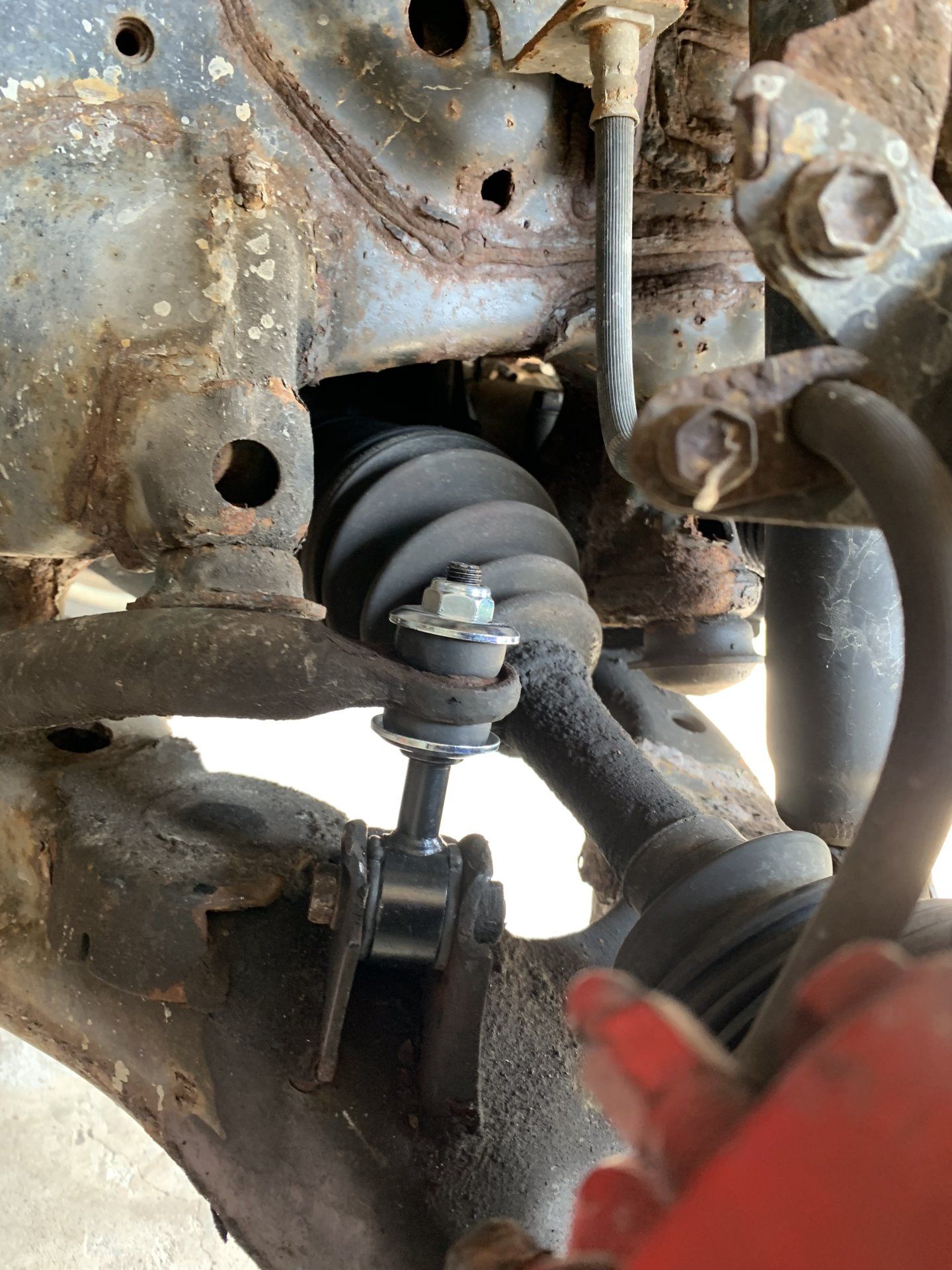

Oh really? I tried to put them on at install and couldn't figure it out, although I was a bit rushed. I'll give it a go when I go to put the new sway bar link on. Thx!
Did the sway bar link. Got a beck arnely since that is what was in stock. You can see the build quality between aftermarket and OEM.

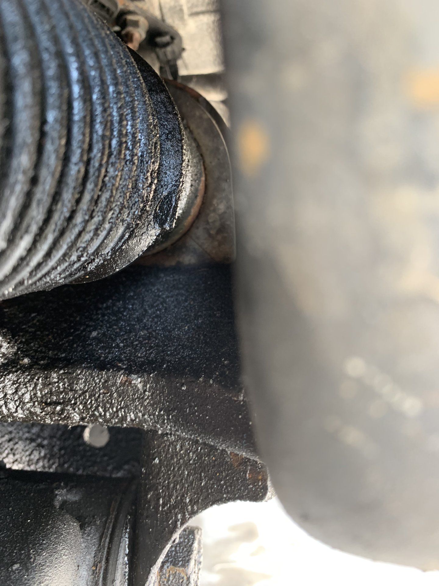

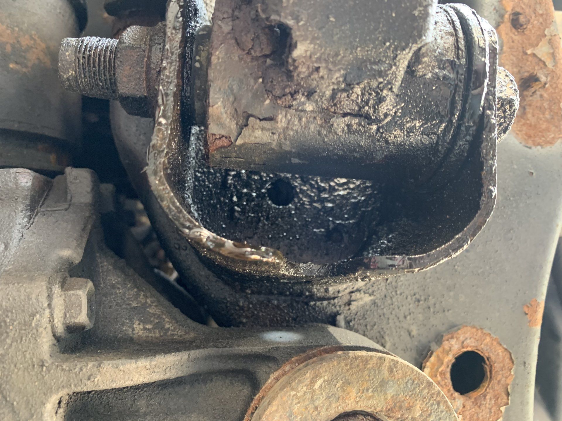

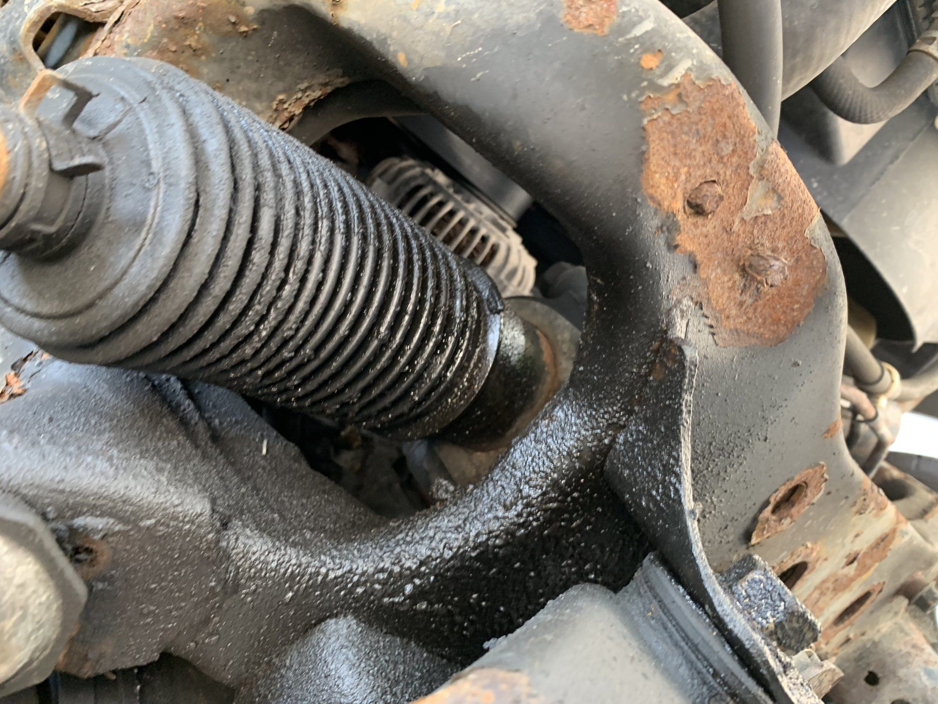

Also saw leaking here, is this due to the vcg leak or is this the steering rack in the death throws?
It is a gold badge model, which I think i'm the only person on mud who likes them.
Wrong. Gold package is best package. I wish my LX had it.
That looks like a steering rack leak to me. But you also have a little grease seeping out of the CVs too.
You might be able to put some AT-205 into the rack and stop or slow the leak and buy you some time.
You mentioned in the first post that the pump is whining? Did you check/change the fluid? That may be where the leak is coming from too, check all the hoses. Mine recently needed a new clamp for one of the hoses off the tank and was seeping down the hose.
