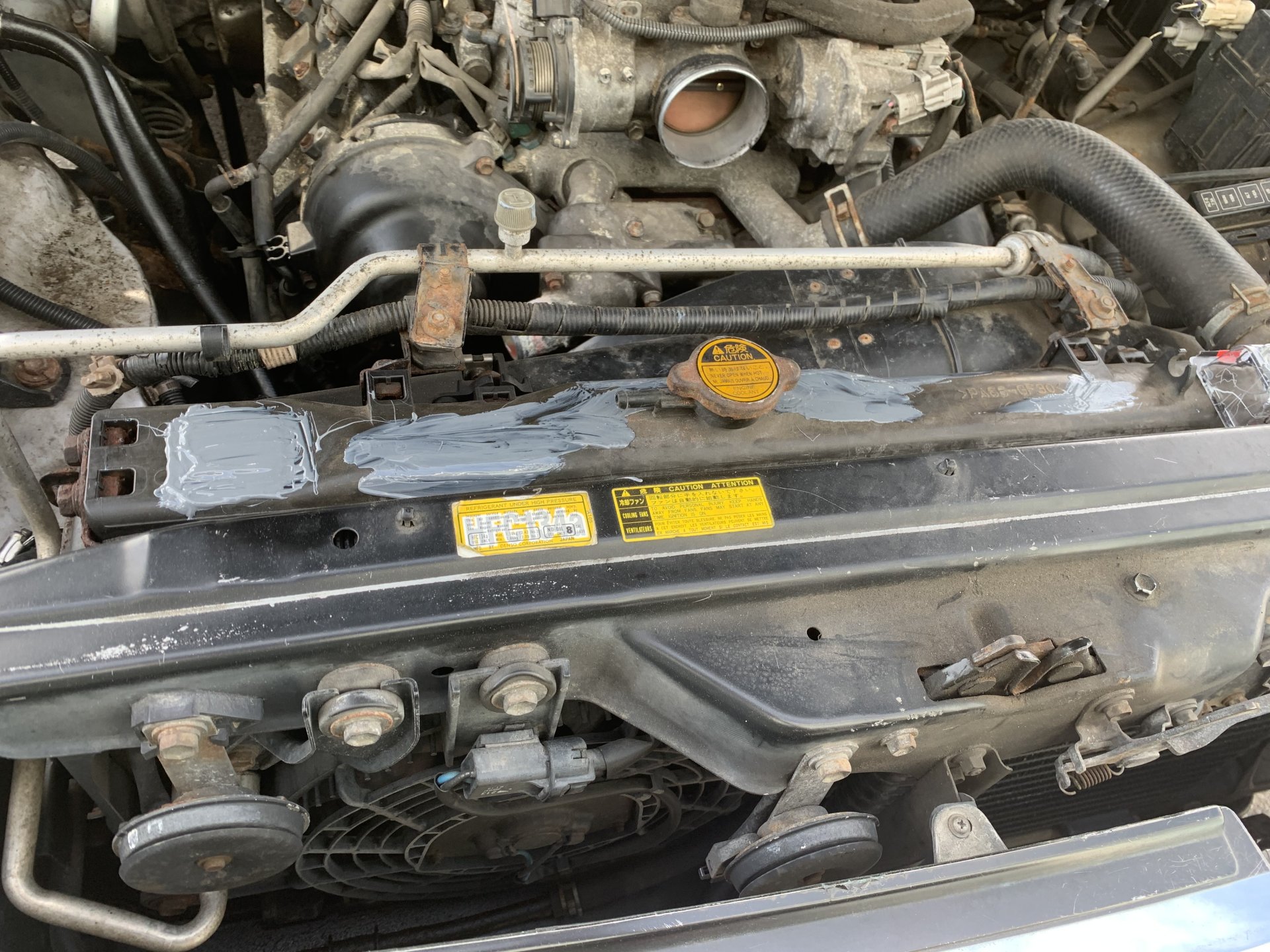

Slathered the radiator in JB weld, lets see how long this crutches me along. While I should've replaced it when I bought the truck, too many expensive replacement parts in a row and my wife may think the Cruiser is unreliable :flush:
I've been putting off changing my original radiator that has turned brown, but you just took it to a whole other level! :beer:
Yeah it’s pretty bad and the rusty cap doesn’t help. It’s going to be the next part purchase presuming nothing else goes sideways

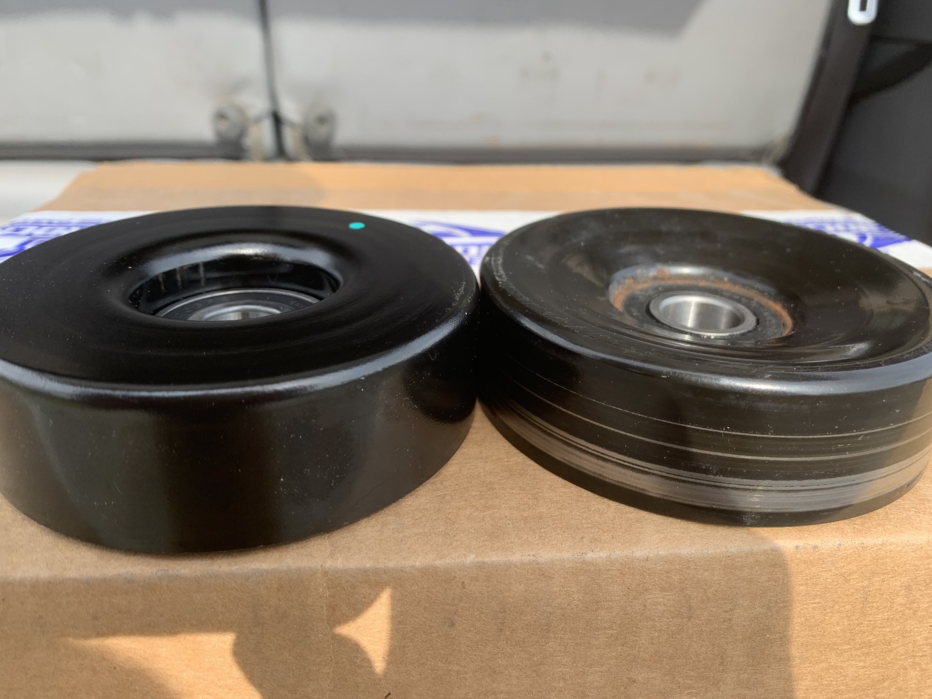

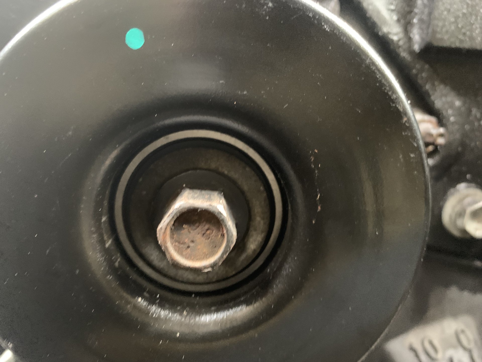

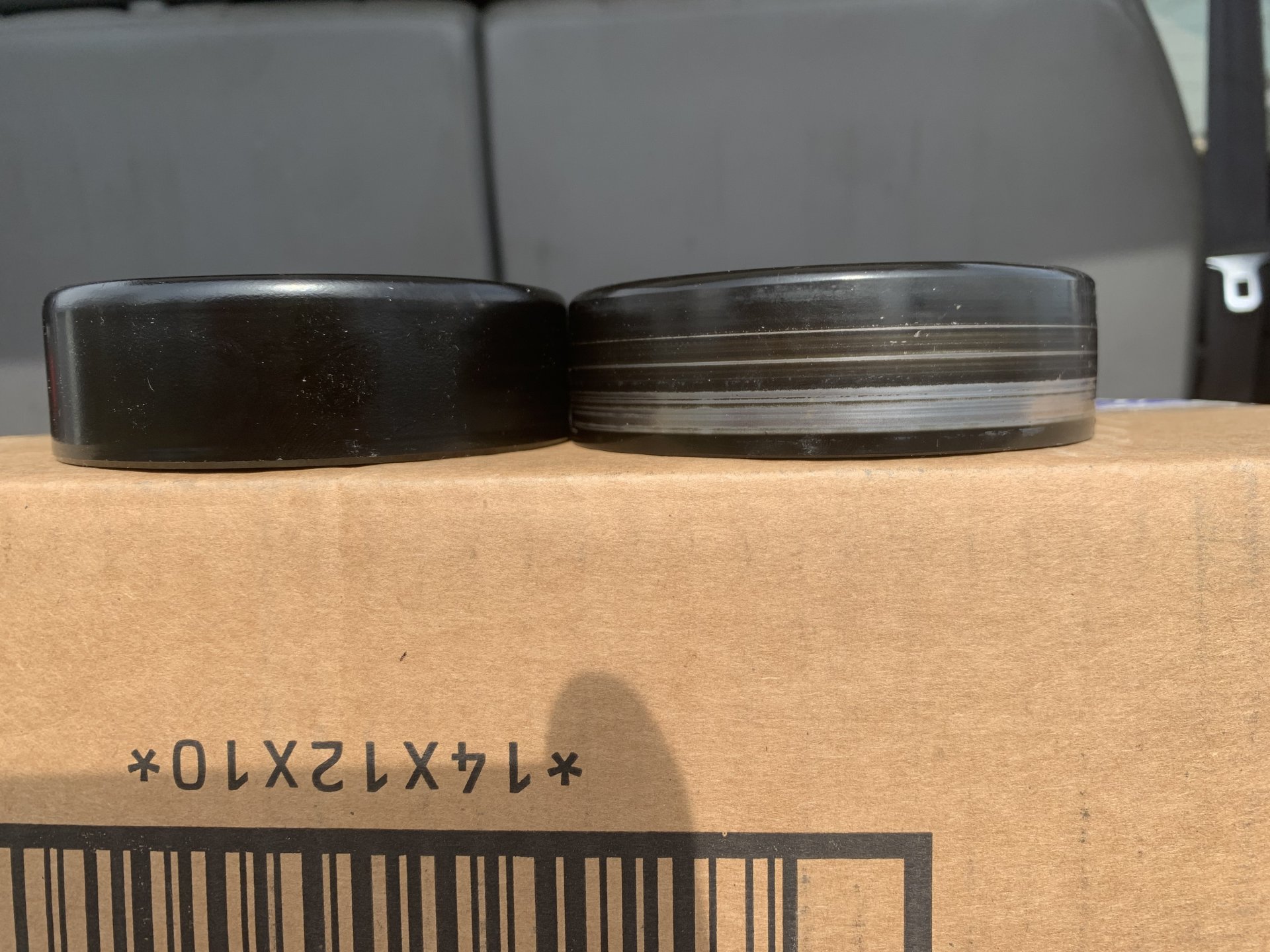

Got it all buttoned up. The pulley wasn’t a 100% match but it went on ok.
I put a cheap China tensioner bearing in (Dorman) as the tensioner was changed by Toyota and the OEM bearing is a smaller diameter (doesn't fit on the original tensioner swing arm). I did order the OEM one to put on during the next timing belt job, but just wanted to chime in here to say that the dorman part started failing after 15k miles. My OEM bearing had lasted 185k. I threw another China bearing on there, and am just counting down the days until its warmer and I can get the OEM tensioner in.
Something to keep an eye on as they say.

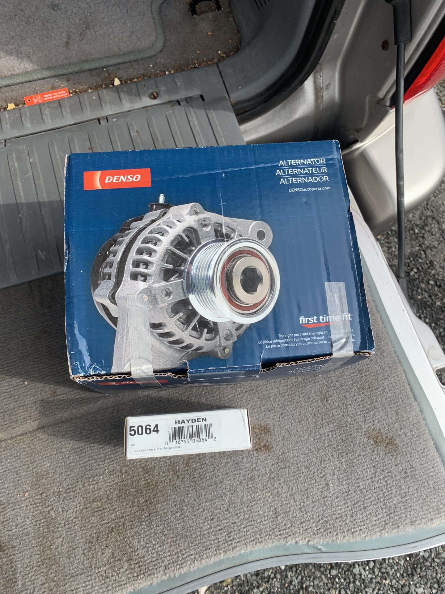

I was reading the alternator threads on here and looking at non OEM parts because honestly I don't have $100 for a pulley atm and it seems the Hayden one that I got had decent reviews. One person said it failed about 10k miles in, but my thought is I have put about 9k on the truck since I got it two years ago, so i'm not as concerned really because I should have $100 between now and the next 9k to buy a new pulley.
I do appreciate your insight though
So after driving the cruiser for about 20 miles post fix, some observations:
-It seemingly has a lot more get up and go and responsiveness. I would assume because the new serp belt, pulley and alternator is spinning better?
-My driver window, while sometimes unresponsive to the window button, rolls up and down a lot smoother and faster than before.
-Despite my slather of the JB weld, there is still a small amount of coolant on the top of the radiator.

It's possible that one or two of the alternator diodes had given up and the others were picking up the load resulting in the lower output and dimming lights/loss of performance?
I was wondering about this. Point in case, I towed a trailer that weighed about half a ton and could barely push it above 45-50 on a straight road. Whereas I’ve seen guys on here tow 2x that weight no problem.

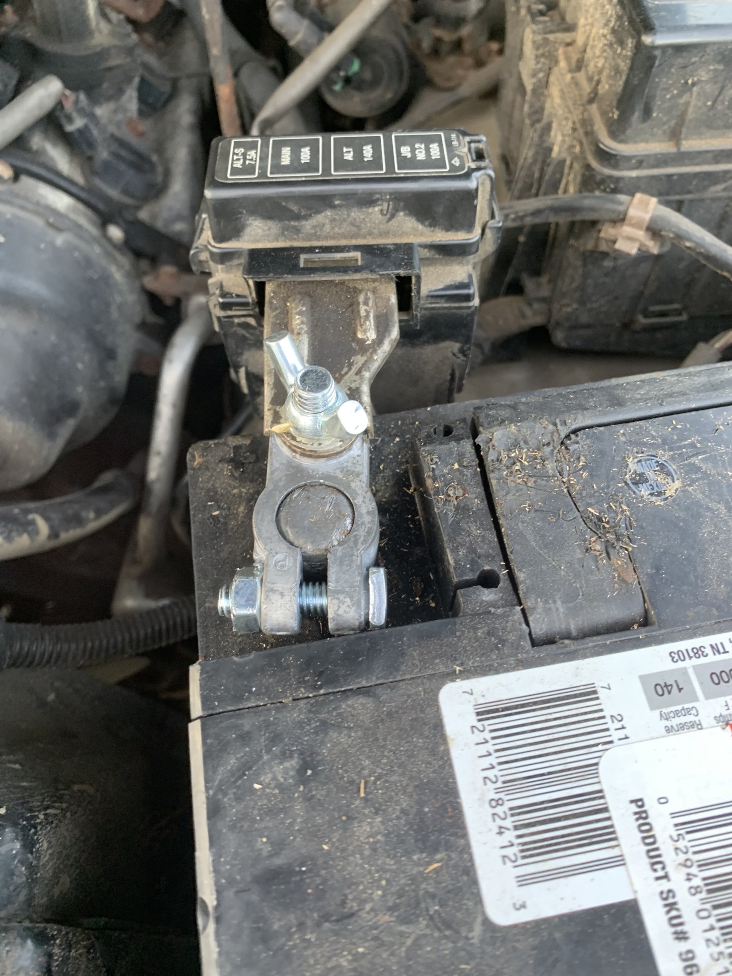

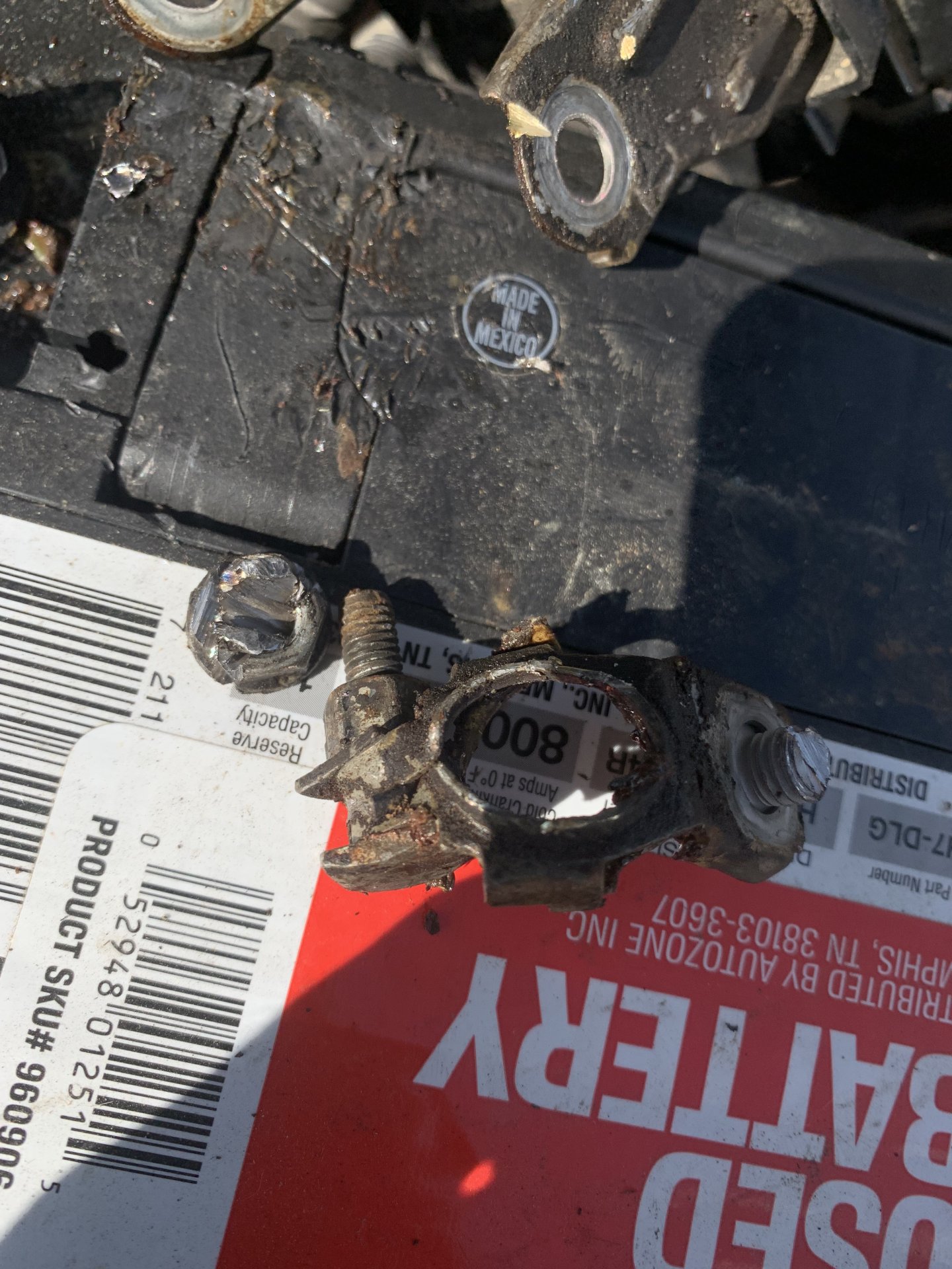

Well I had the thought that maybe the battery light is due to the positive terminal on the brink of disintegration....
Got the disc grinder out because nut was seized:
Stuck a heavy duty marine terminal on it because why not:
