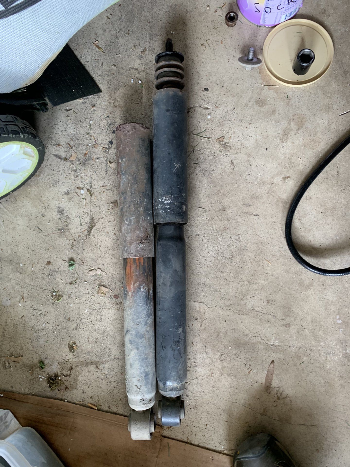

Busted my driver rear shock. Saves me the trouble of trying to unbolt it.
Figured out why it bounced so bad back there
Crawled under today and got the new used shock in place. Dropped the spare for accessibility. Used large channel locks to keep shock from spinning. Was able to fit a ratcheting boxhead in there.
Spare was from 07 and had 2-4 holes in it.
Was very surprised when the spare tire crossmember let down the spare with no problems. Blasted some lube in there til it was dripping out.

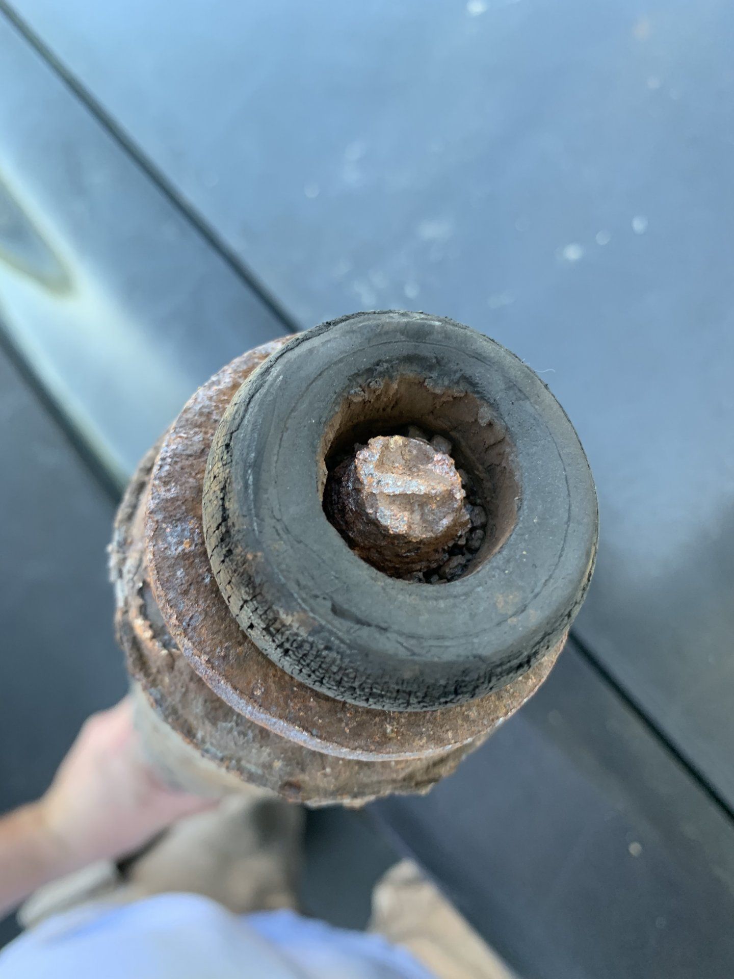

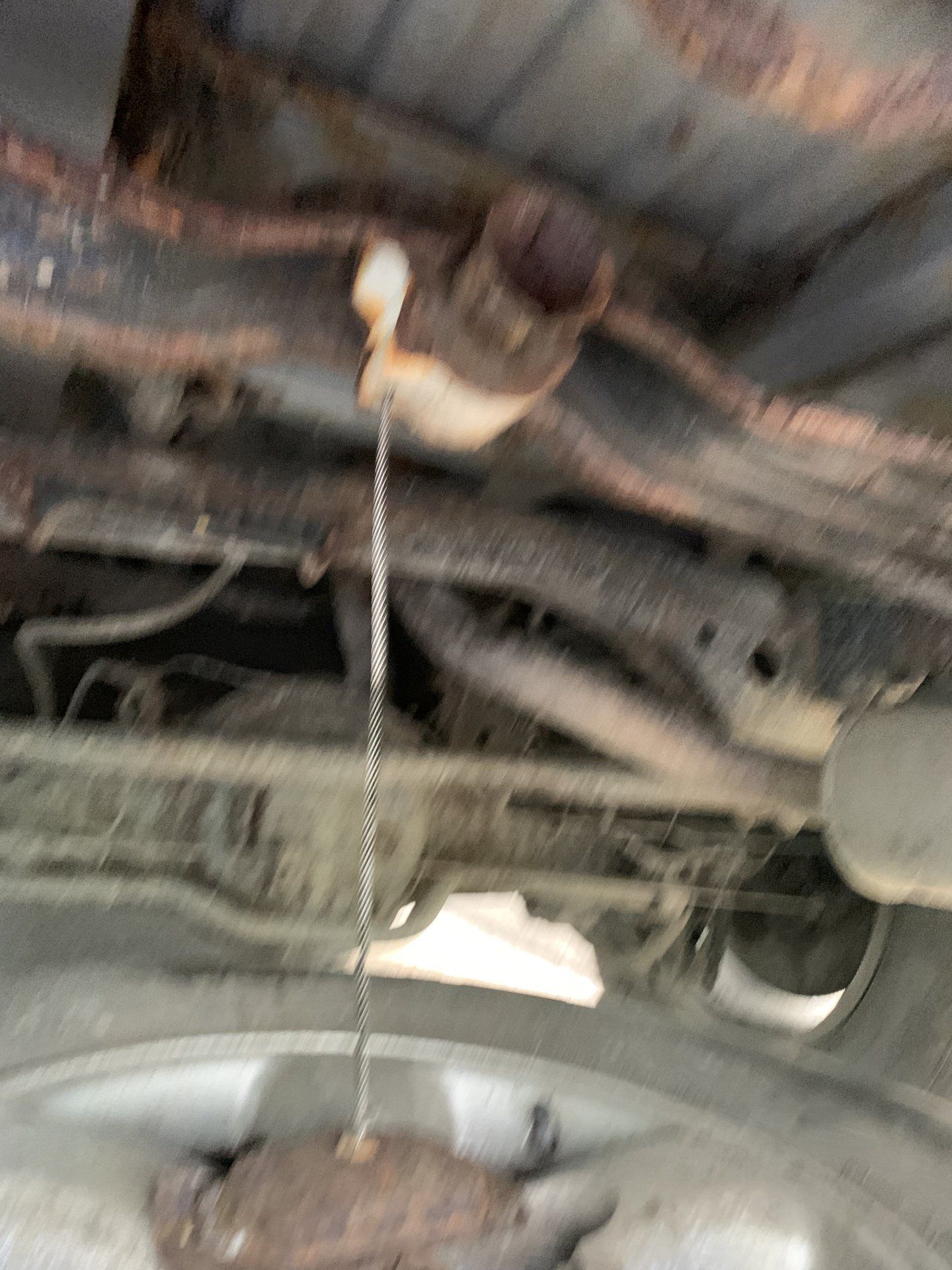

Passenger side is broken off below the frame hole so it’s going to be more challenging.

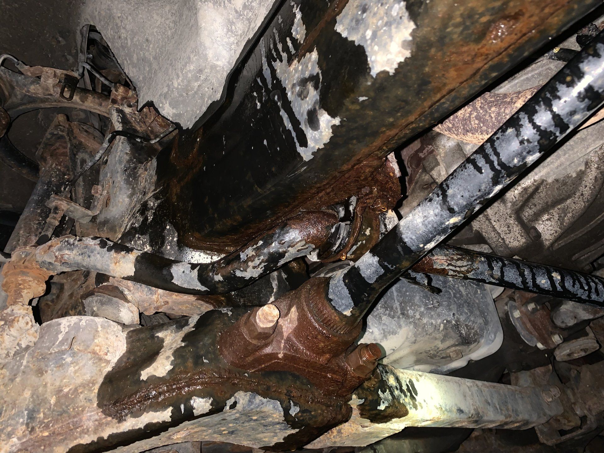

Tackled the passenger side today. Ohh boy.
Shock broke off below the bushings making this much more difficult.
Spent about 4 hours and 2 trips to Lowe’s for tools and pblaster. Quickly realized that I couldn’t just unbolt it w the ratcheting wrench I bought.

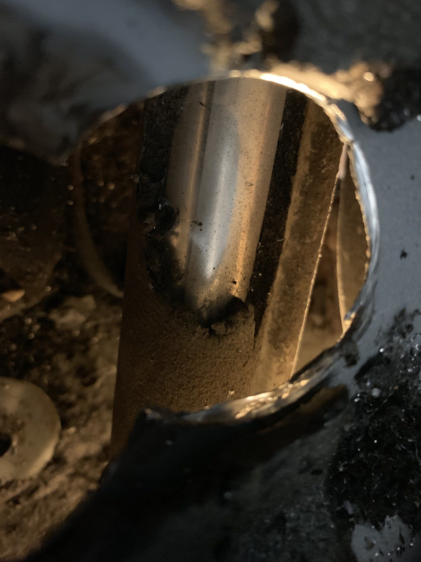

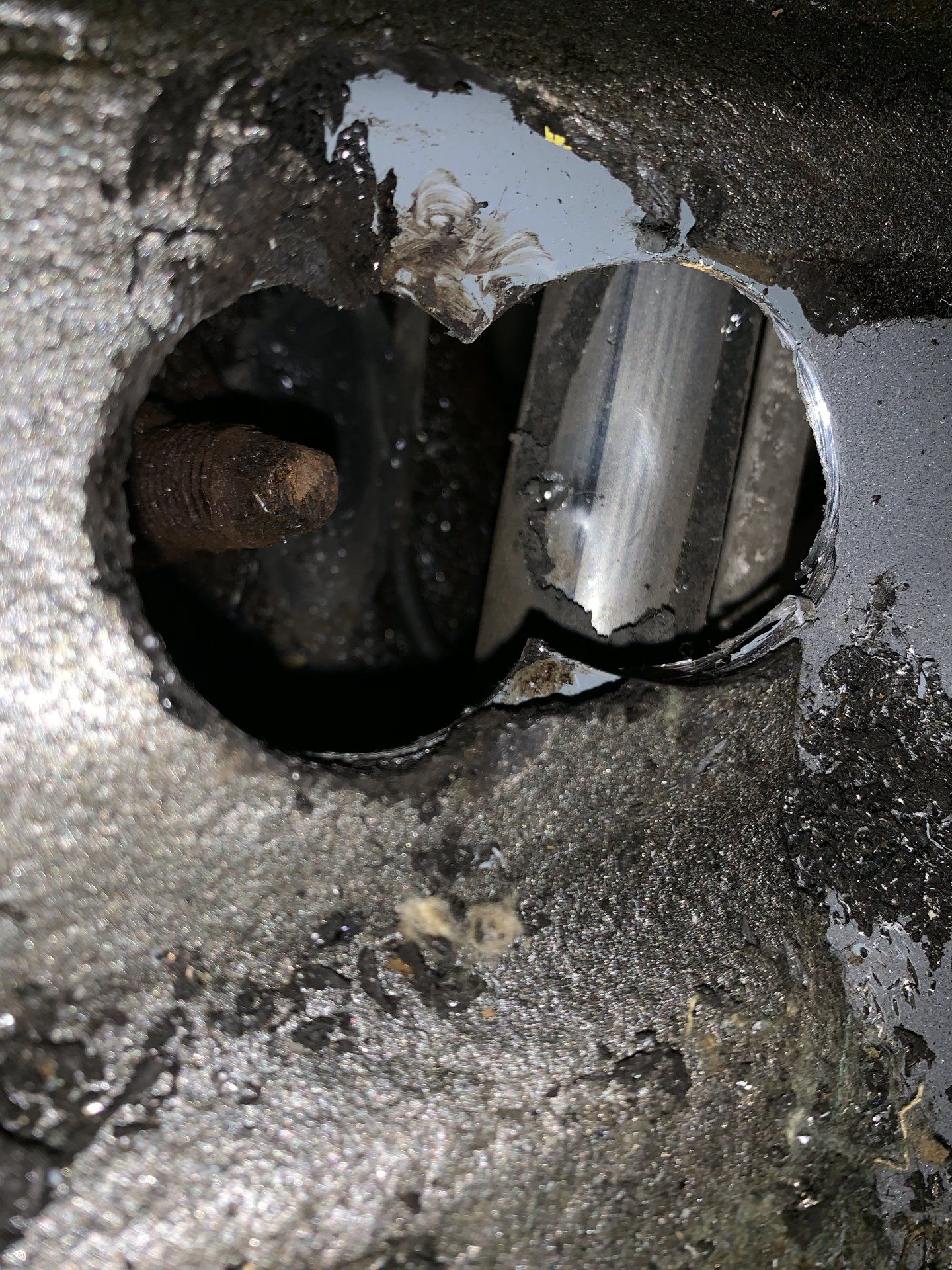

Bit the bullet and decided to do the top down approach via drilling access hole in the body.
After measuring and doing some pilot holes I took the plunge and drilled a 1.5” hole into the floor. Astonished it worked I proceeded to try and get an impact socket on there, only to find out I was just too far over.
Frustrated with my mistake I went half inch over and drilled again. This time I could lay the impact socket onto the nut, and also managed to nick the outside of the rear ac line..absolutely furious I pressed on (if anyone can get an idea based on pics I’d love to know if the line is still usable).
Insert 1-2 hours of me using my pneumatic and electric impact guns and socket with breaker bar. And one and a half little cans of pblaster.

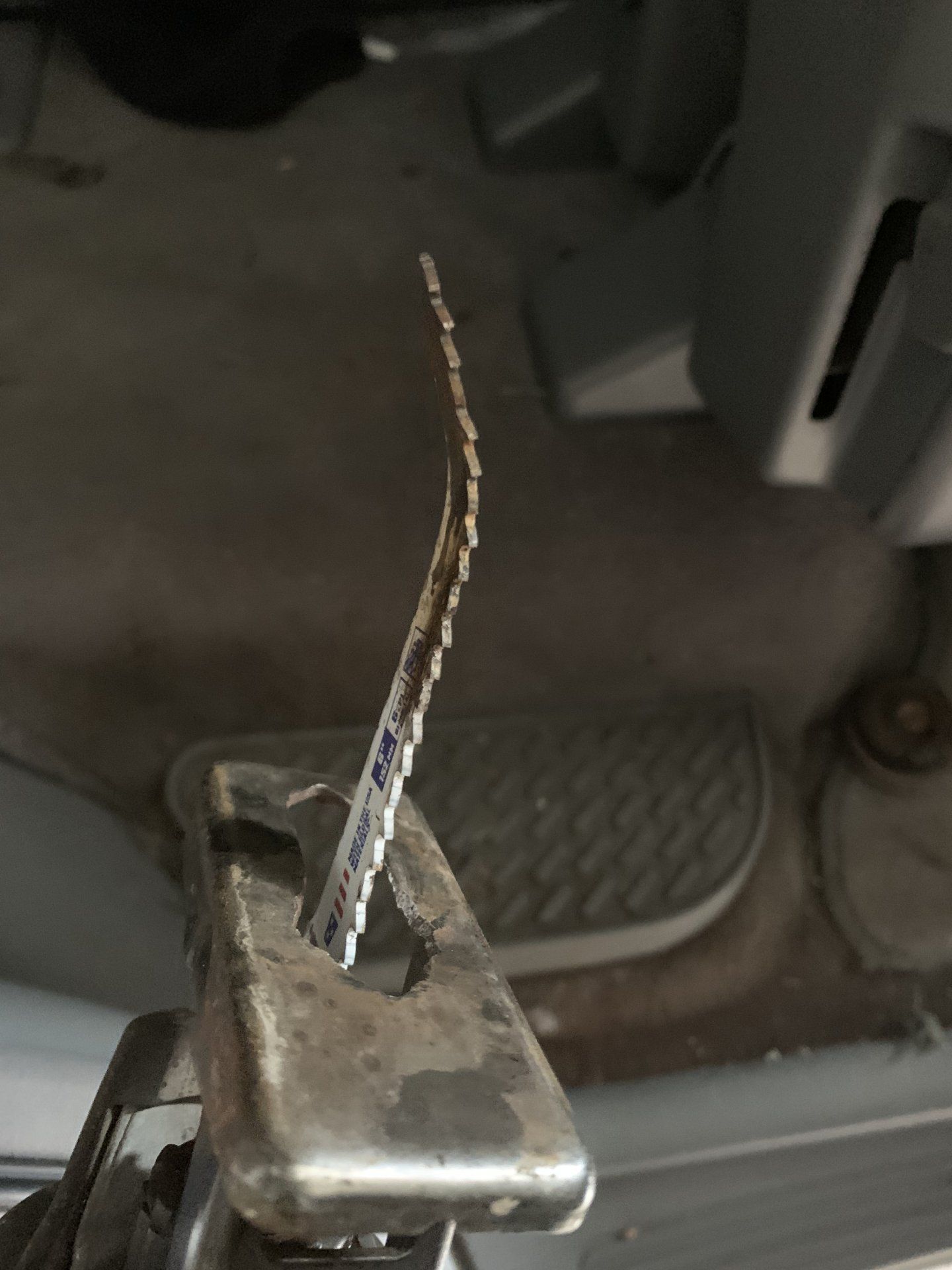

Finally dawned on me to drop the spare and see if I could reach it from the back. Lo and behold I could with my sawzall. Not even 5 min of sawing with a new blade the bottom bushings and plate were off.

-crawls forward and get sawzall at the ready, place new metal cutting blade as close betweeen the frame and top lower bushing as possible.
-cut and keep cutting despite smoke and crust flying.

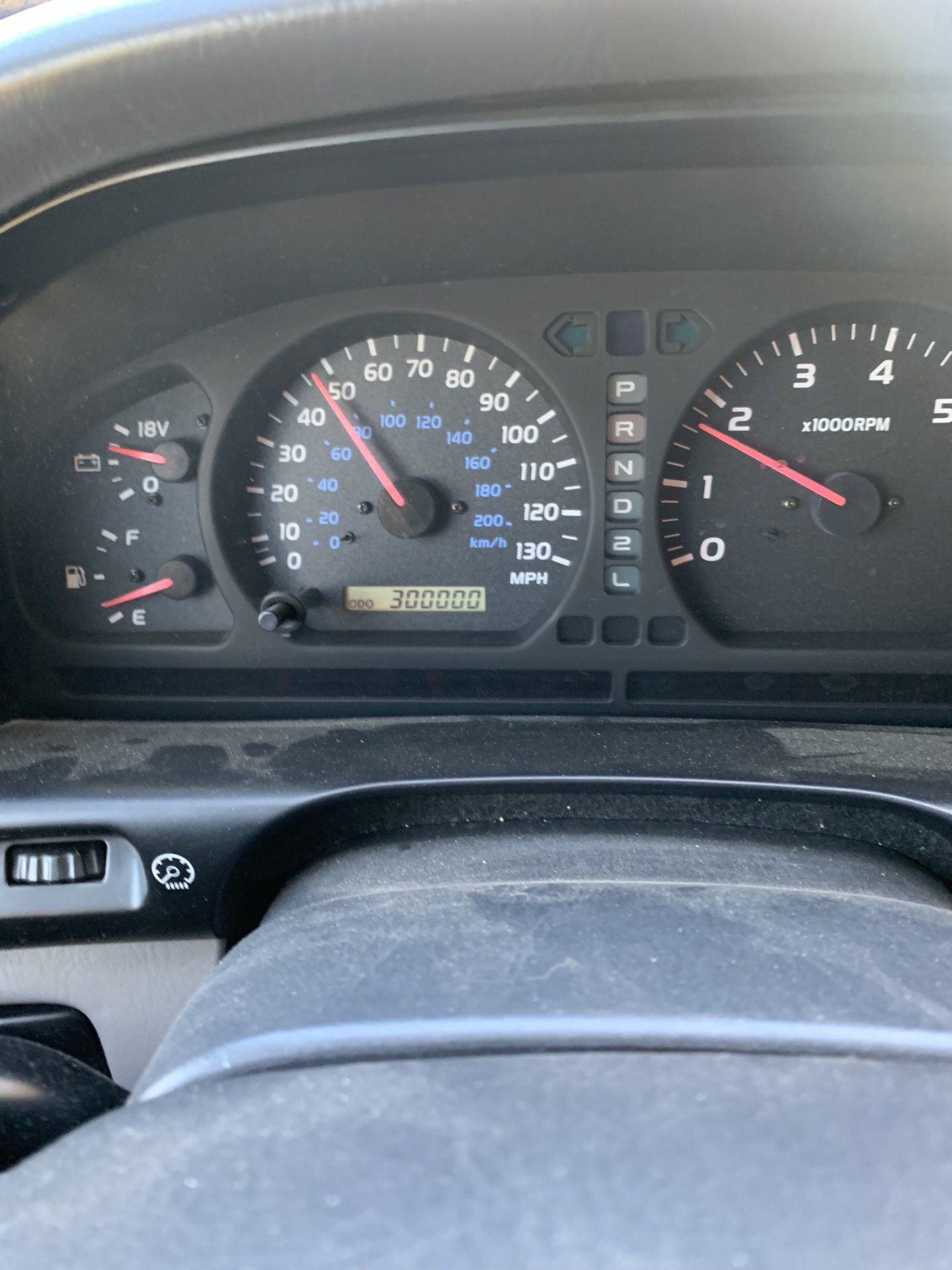

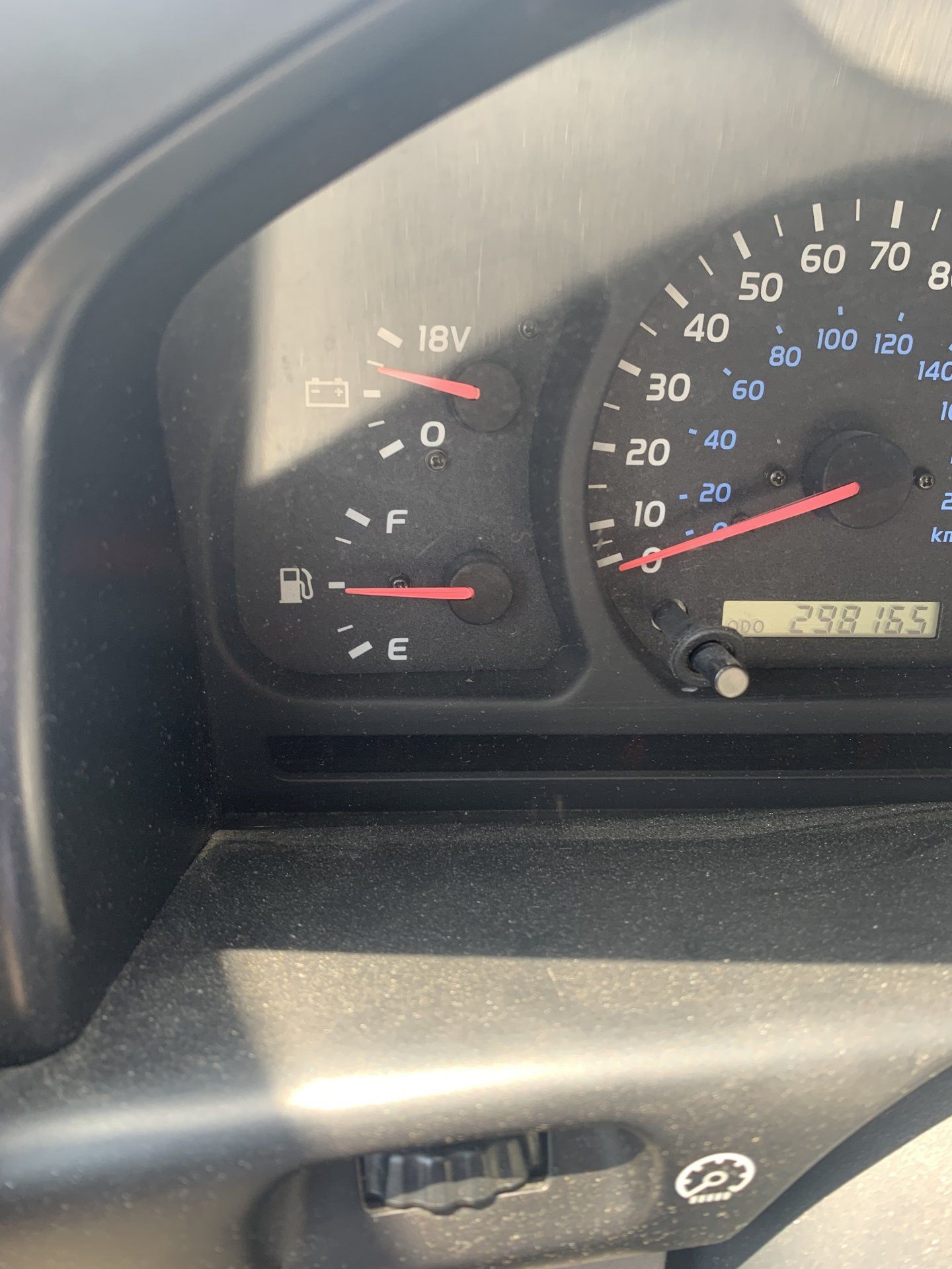

Was out and noticed the voltmeter (gauge?) was pegging this high. Is this normal range? Indicator of anything?
Cant use the OEM gauge for anything other than if there is some voltage. But yes while running a healthy system will be 14-14.3V give or take. That looks totally normal. A Scangauge or the like is best to have.
Yes, should be pushing 14v or better.
Thank you for the input. I thought it was, just never remembered seeing it get that close to 18v before. I won't worry about it then.

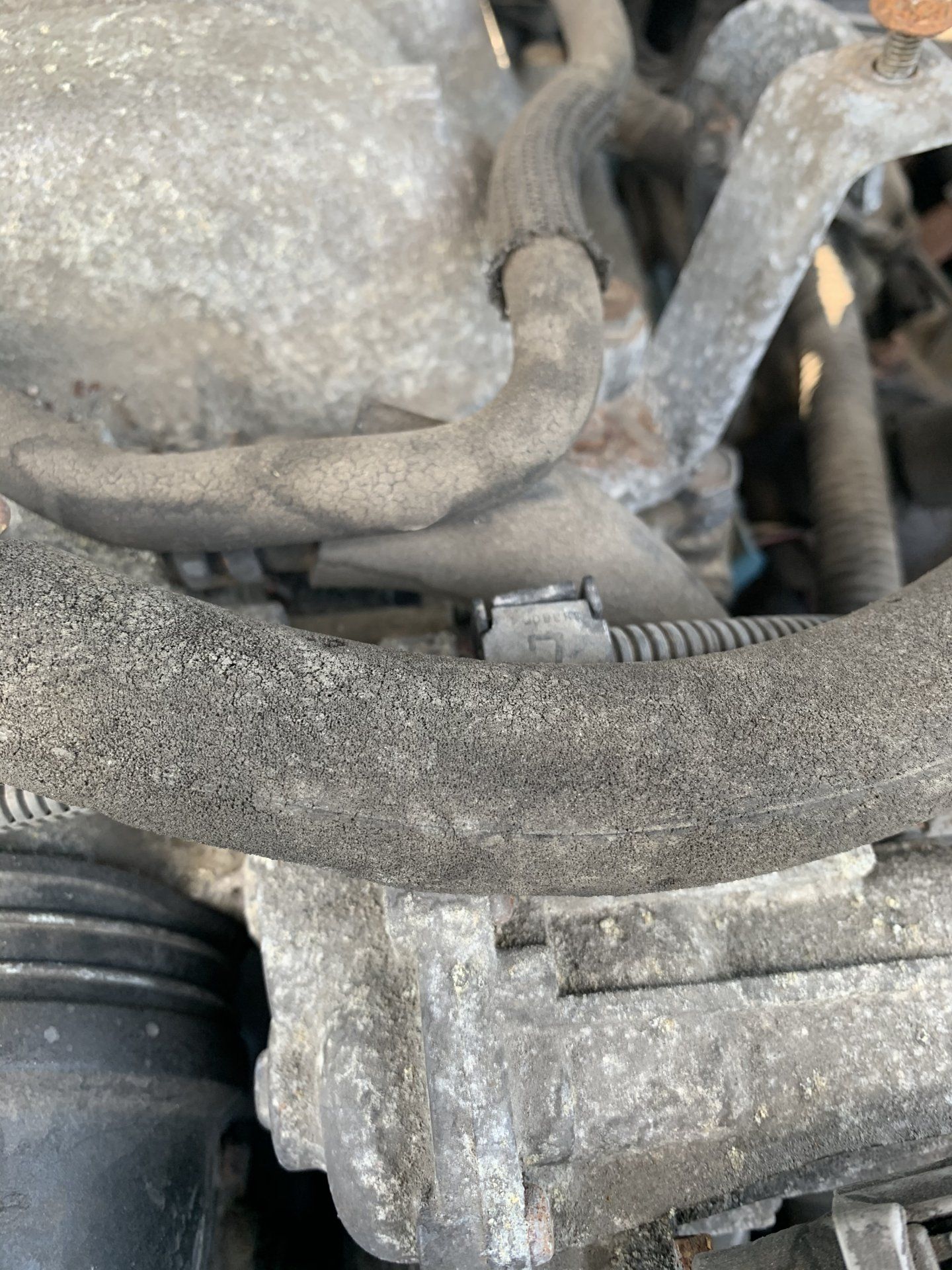

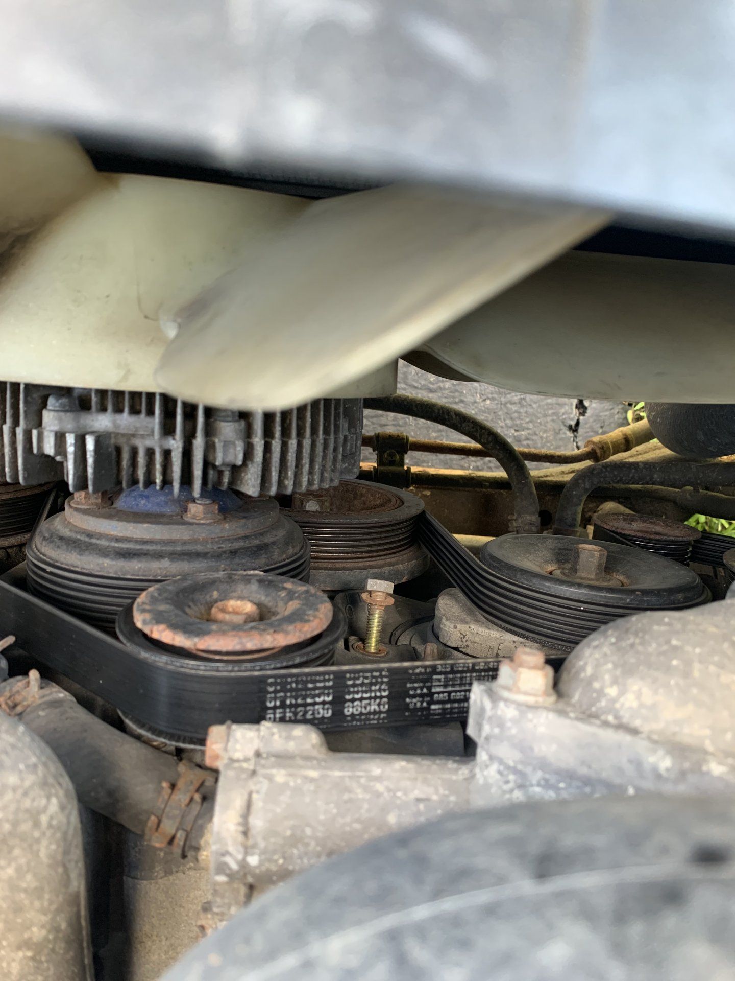

Made some discoveries today,

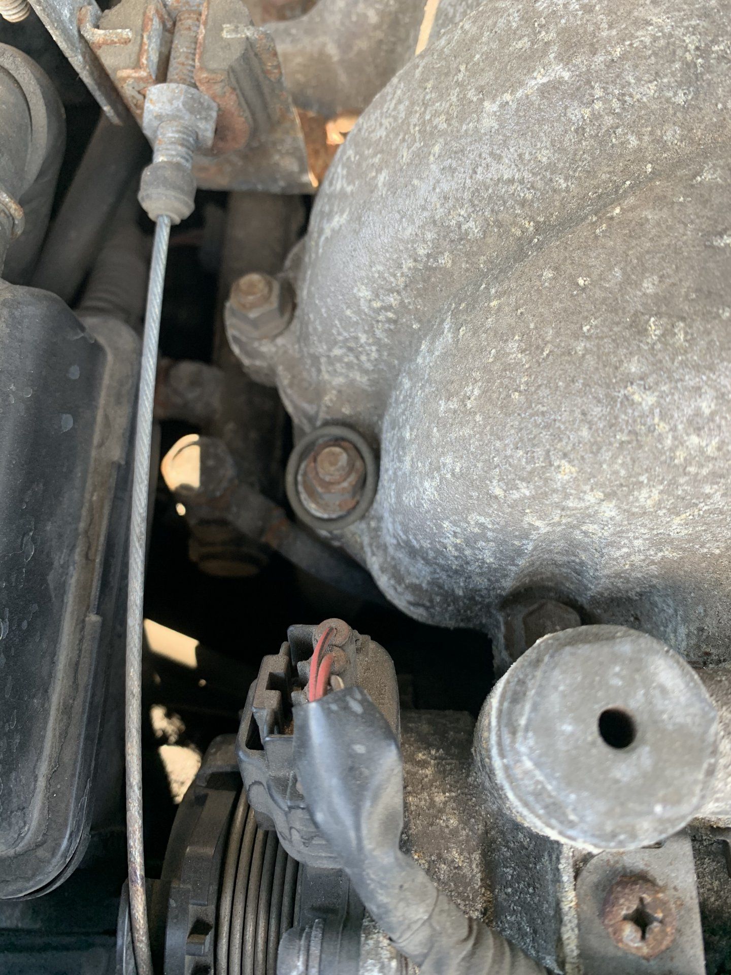

Namely condition of hoses under engine cover (yes. I just took it off), hopefully only a sticky throttle body- got the intermittent unresponsive in drive Symptoms.
Results of t belt job not done right and a mystery o ring
