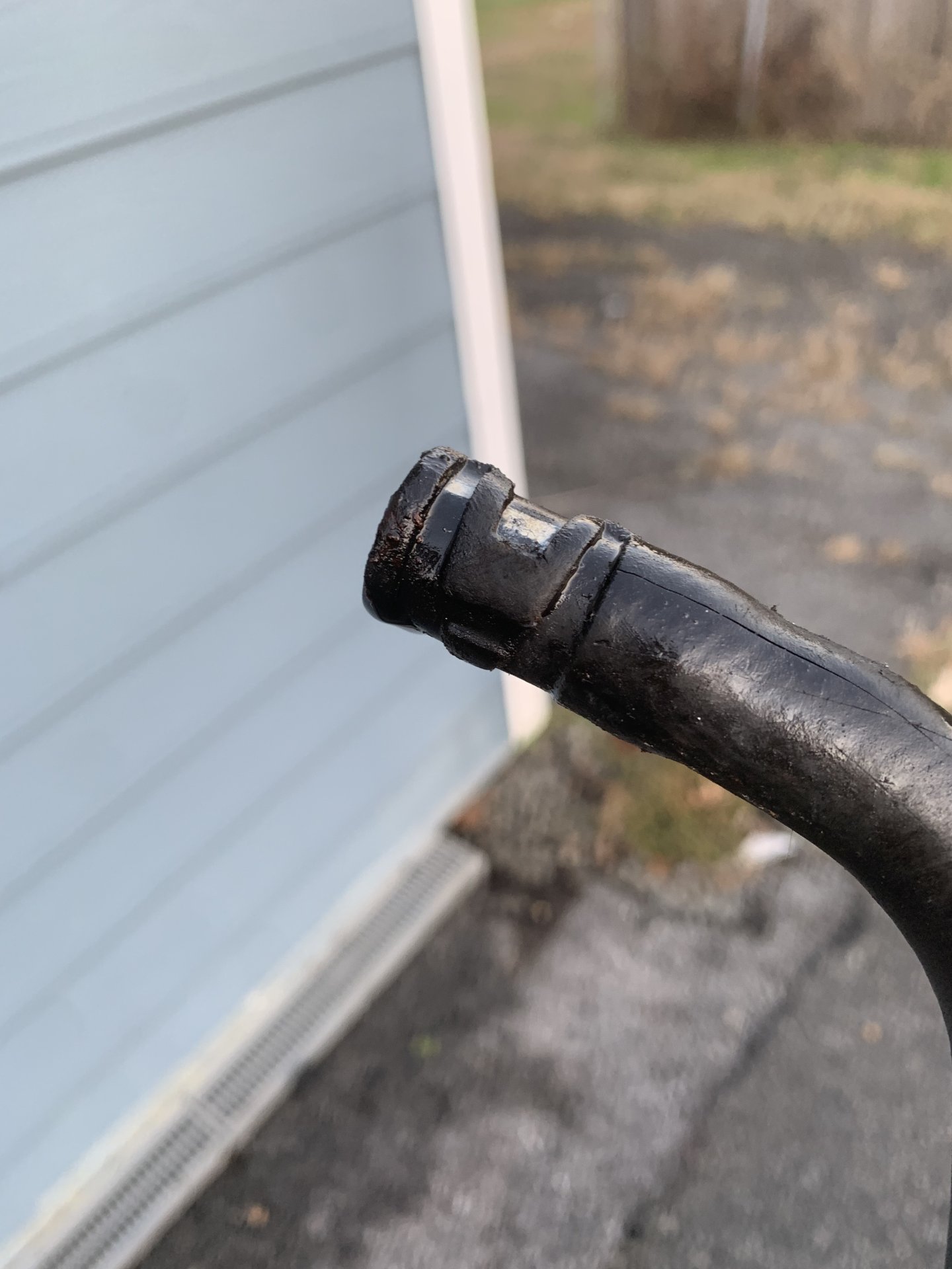

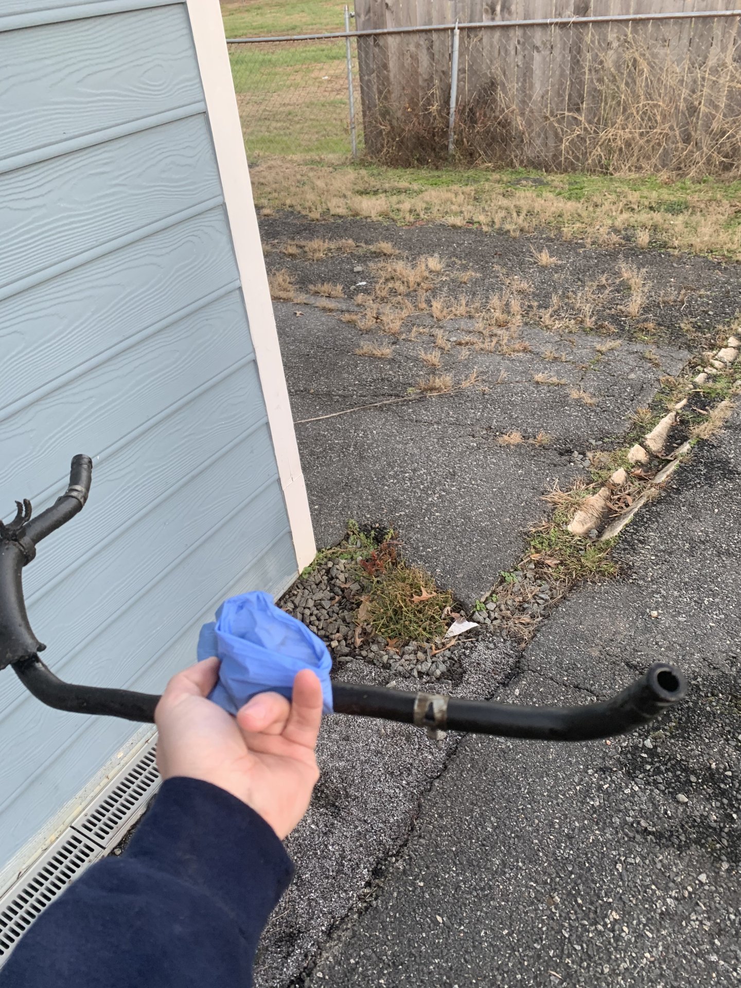

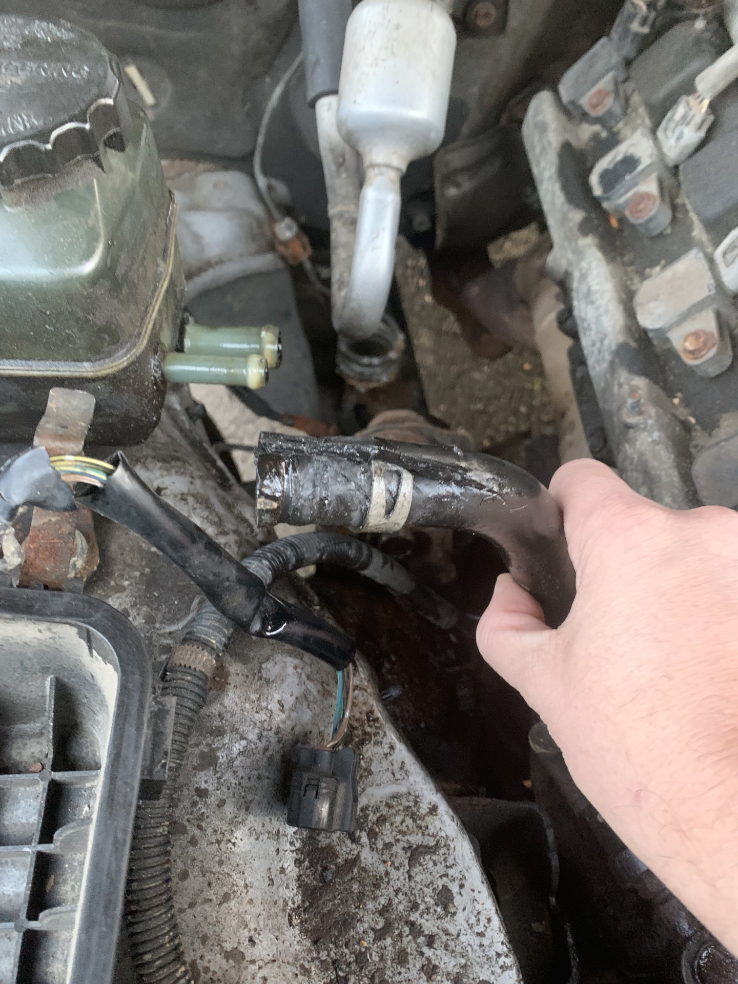

Made some headway today, sort of.
Got the hoses off the power steering reservoir, had to cut the band clamp or whatever it’s called:
Side I was able to remove without cutting. Guessing these have never been replaced…or it’s been 150k miles and 10 years…
