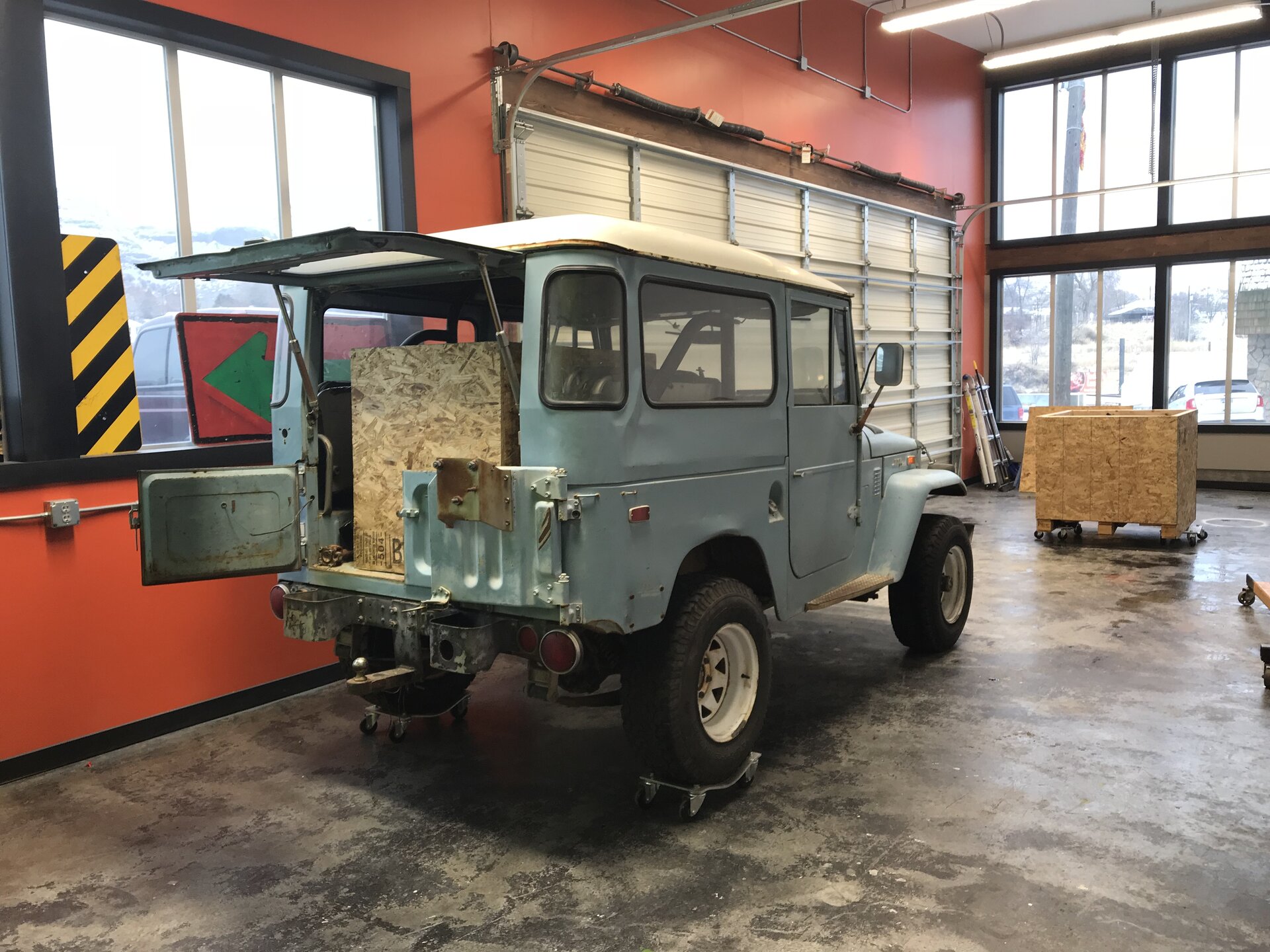

The FJ40 at her temporary home

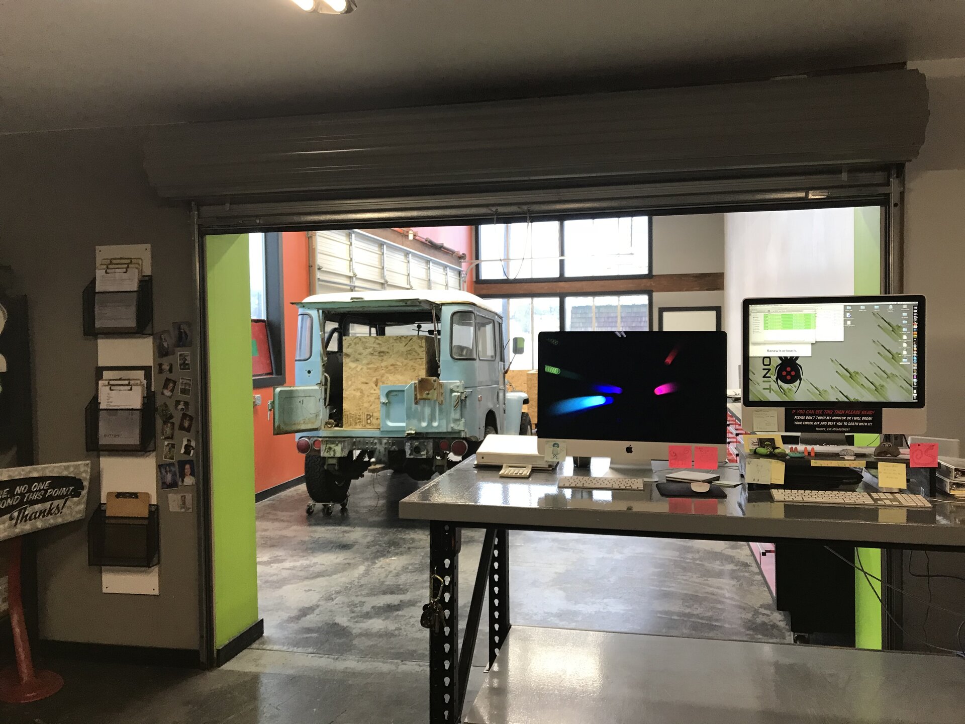

Ready for the magic to begin..

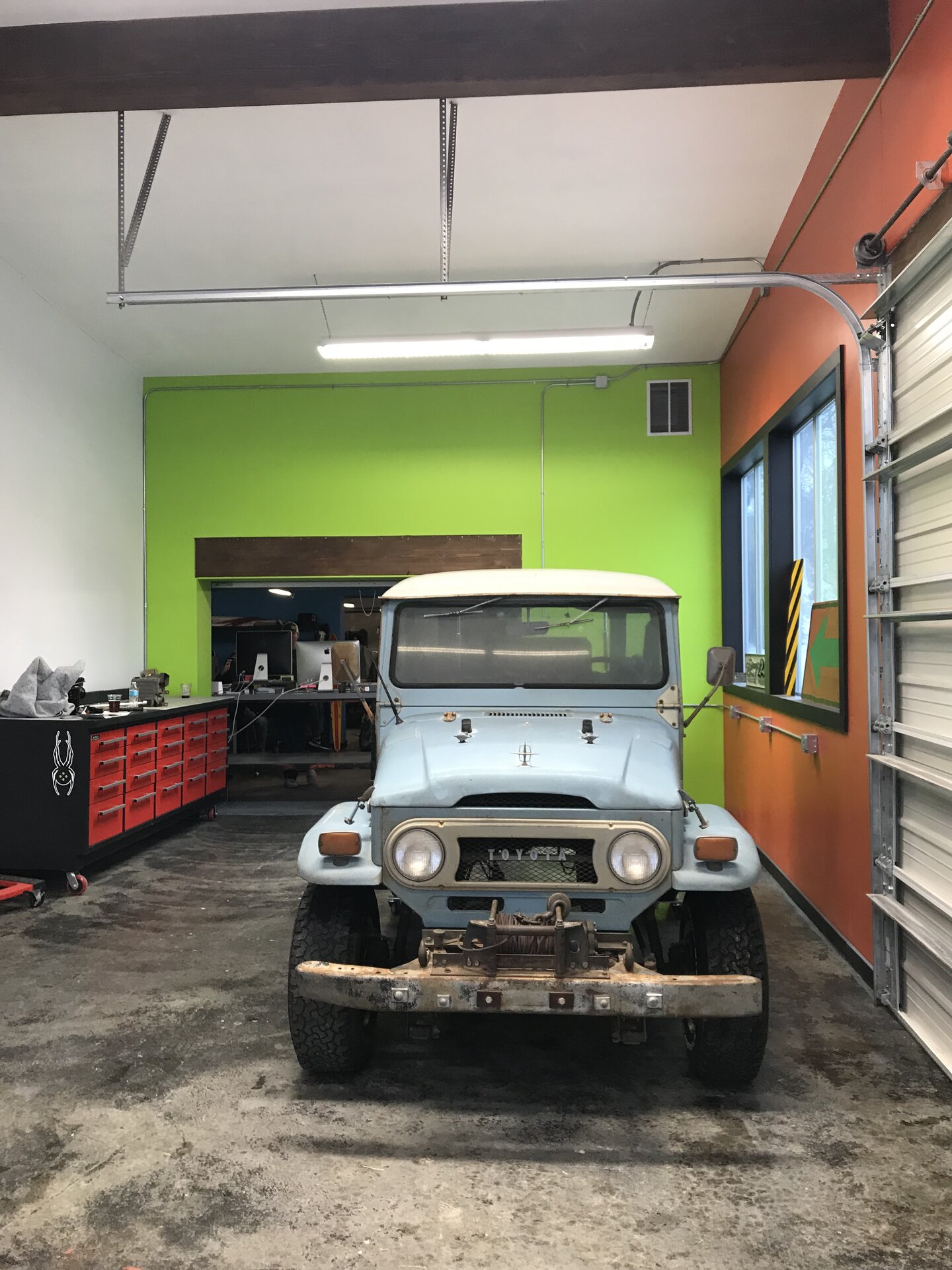

Killer shop space.
