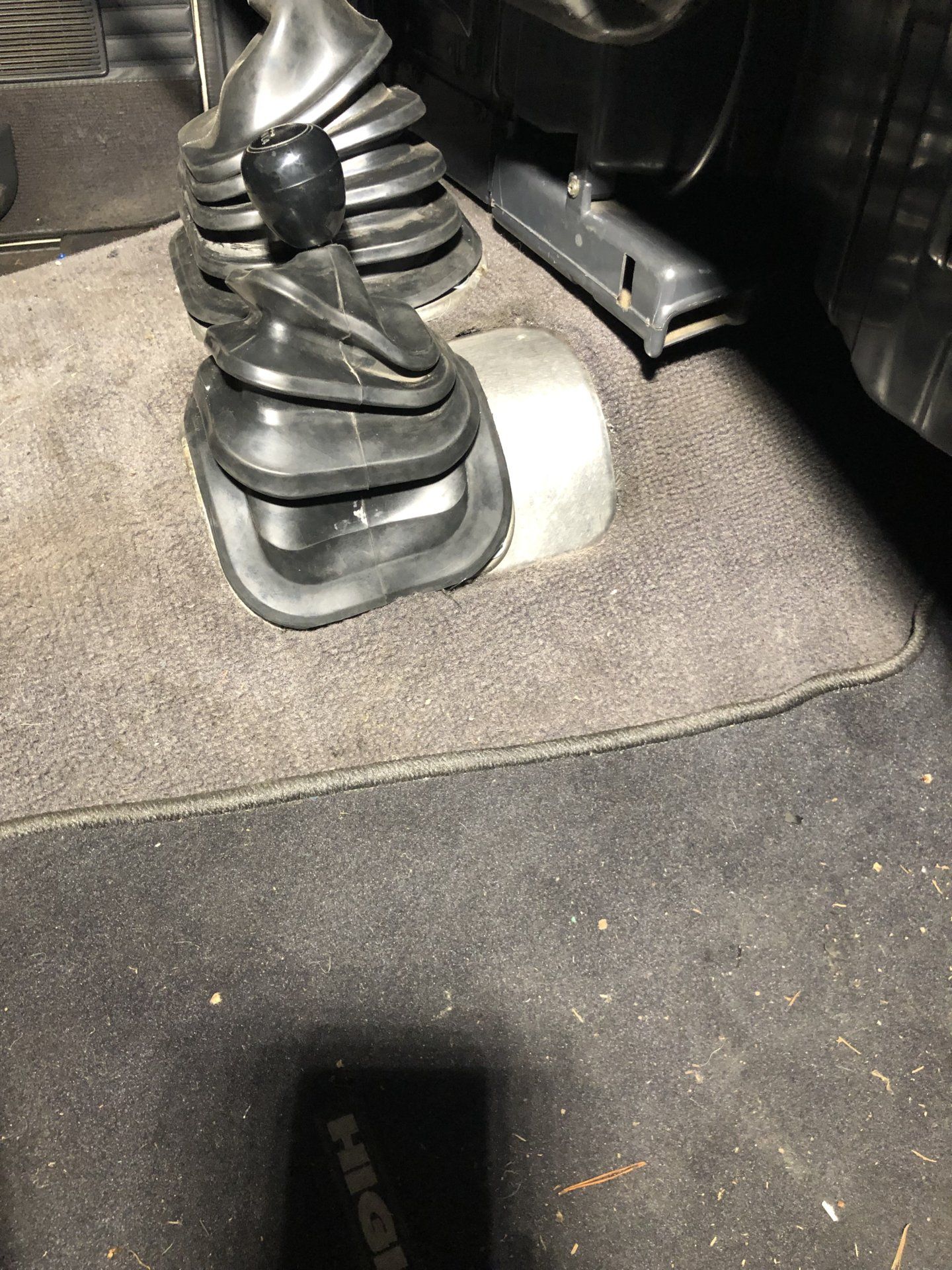

Things still to finish, bump and steering stops, lower the transmission mount on the crossmember to stop the transfer case from bumping under the console. Wire the reverse lights, the switch and pigtail are in the NV4500. Finish the emergency brake... I know... I know, but I’ve just been parking in gear. While it was at Josh’s the oil pan was removed and the drain pan drain was moved so oil wouldn’t drain all over the front driveline.
Fresh oil and filter. New fuel filter. New drain pan gasket. Grid heater was installed at the air intake. Got the diesel rejection flapper out of the fuel filler line. Made a plate to block the hole in front of the 4WD shifter.
Saweet. Do you have sound deadening?
i don’t most likely in the future but it’s a whole lot better with the 4WD shifter hole blocked. While at Joshs his brother Caleb and I found a old stainless steel lid and made it. What a difference. Going down to Klamath County tomorrow to look for property east of Crater Lake.
