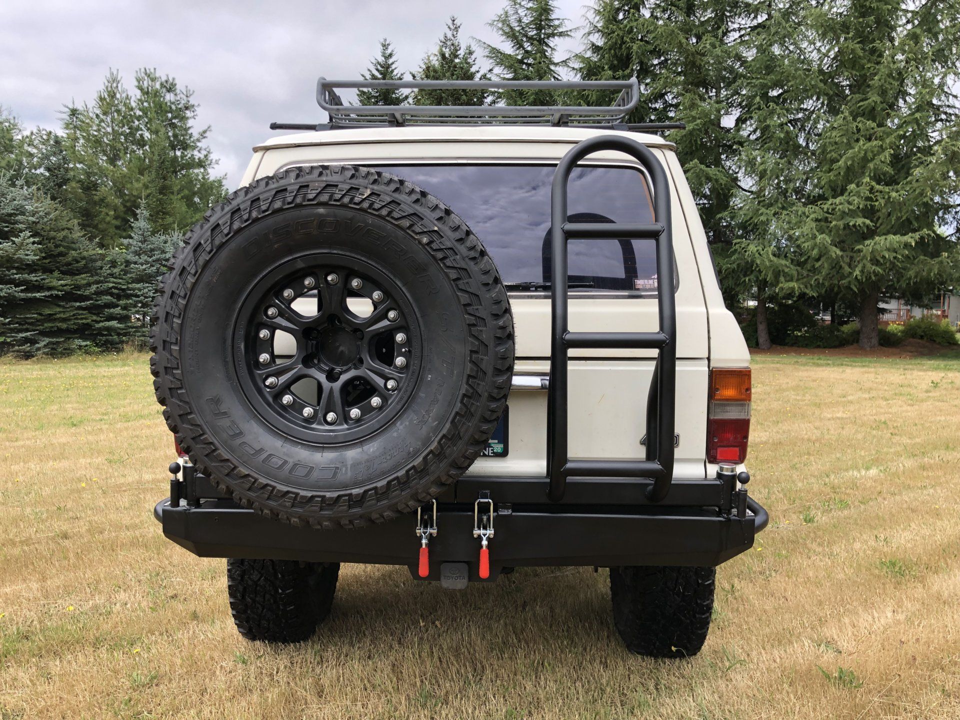

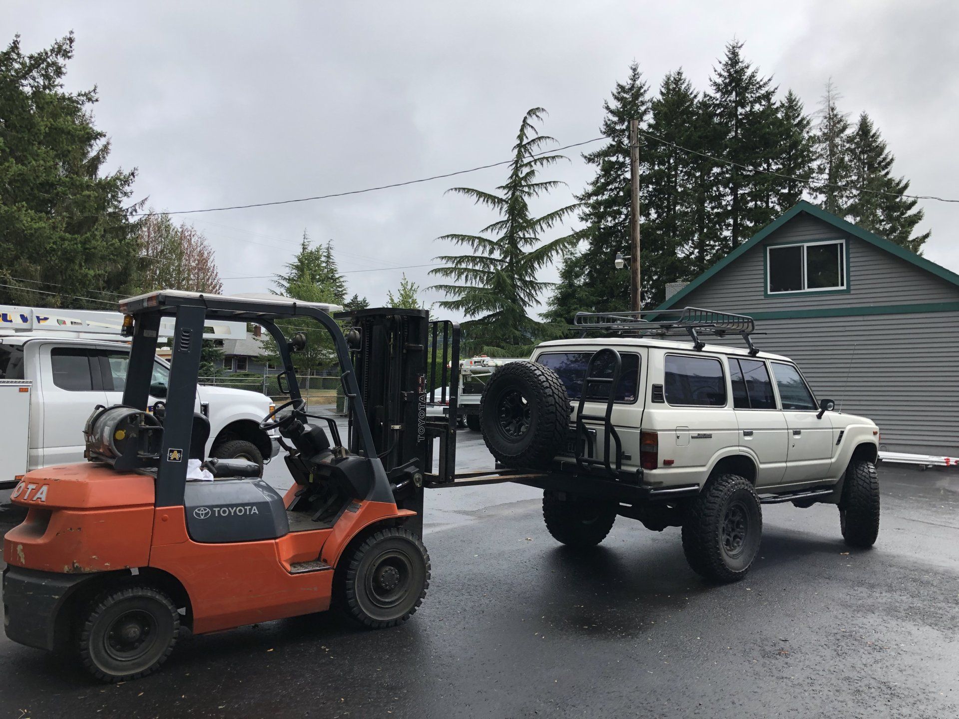

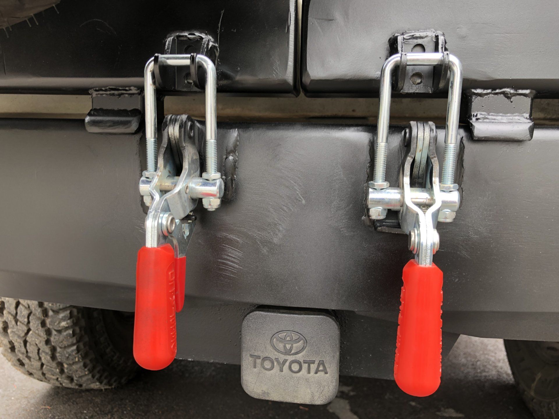

Picked up Toyota wheel studs.
Drilled the holes to 9/16” with drill press
The studs went in tight which was a good thing. Checked on my spare and they lined up nicely. Tack welded and checked again. Fit so welded the wheel stud heads.
Mounted the tire mount and used forklift to get the beast mounted.

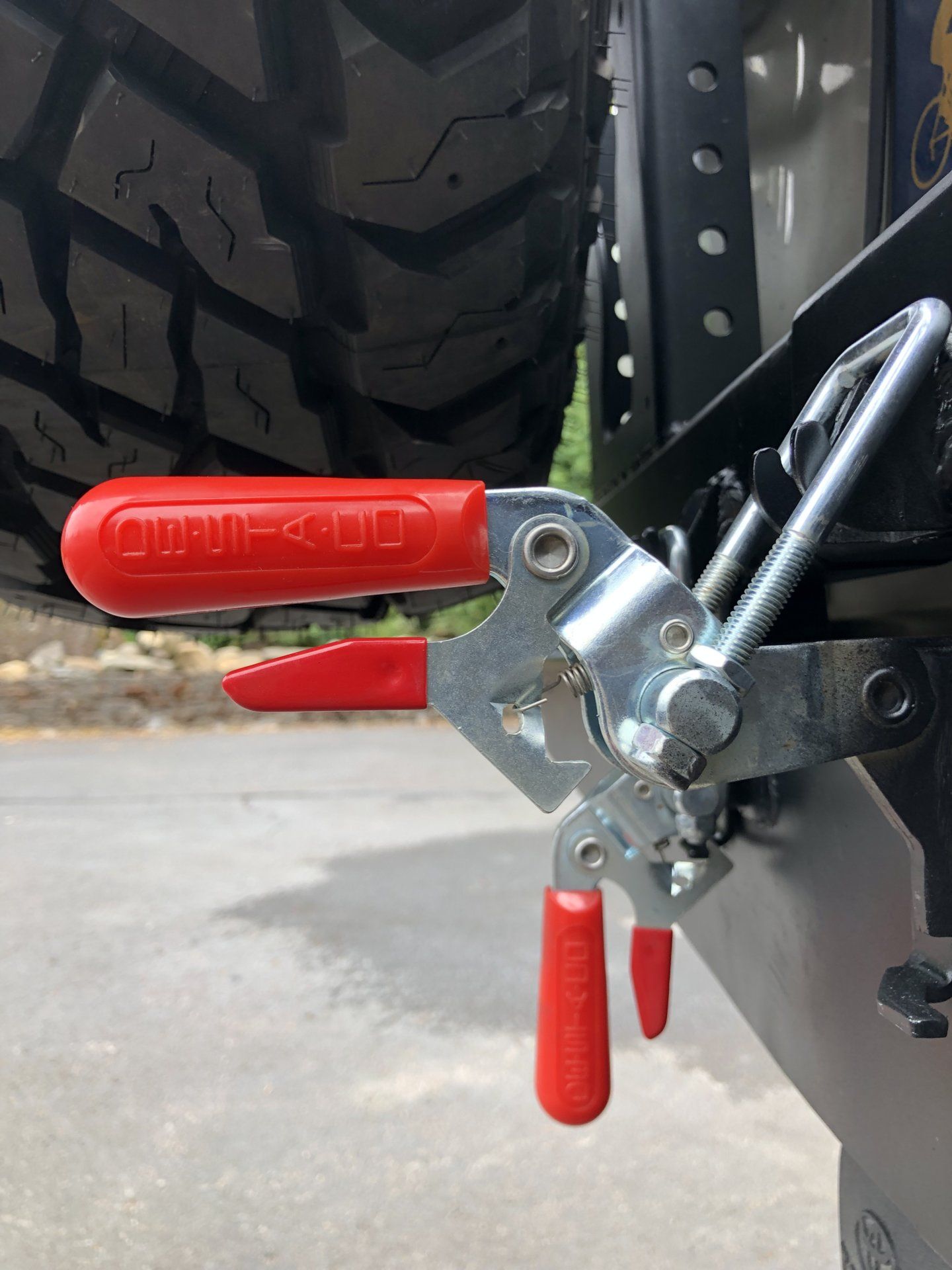

Next it was time for the latches.

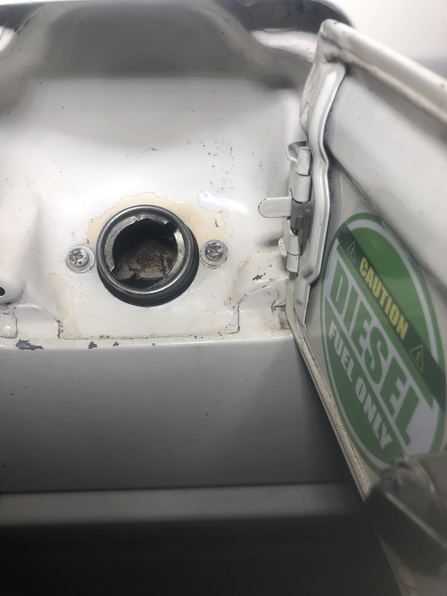

Wife’s at the county fair this week with kids showing their show animals so I have time after work to work on the 60. It was time to remove the fuel flapper in the fuel neck.
Remove fuel line vent line and screws holding the fuel neck into the frame.
Remove the old hose clamps and pulled the fuel hose and removed the fuel neck.
Drilled out the spot welds and welded in the holes.
New fuel hose and T-clamps
Reinstall with new OEM Toyota gasket at top of fuel neck and where the neck passes through body to the tank.
Will be awesome to now fit the diesel pump nozzle into the fuel line without needed a funnel.
