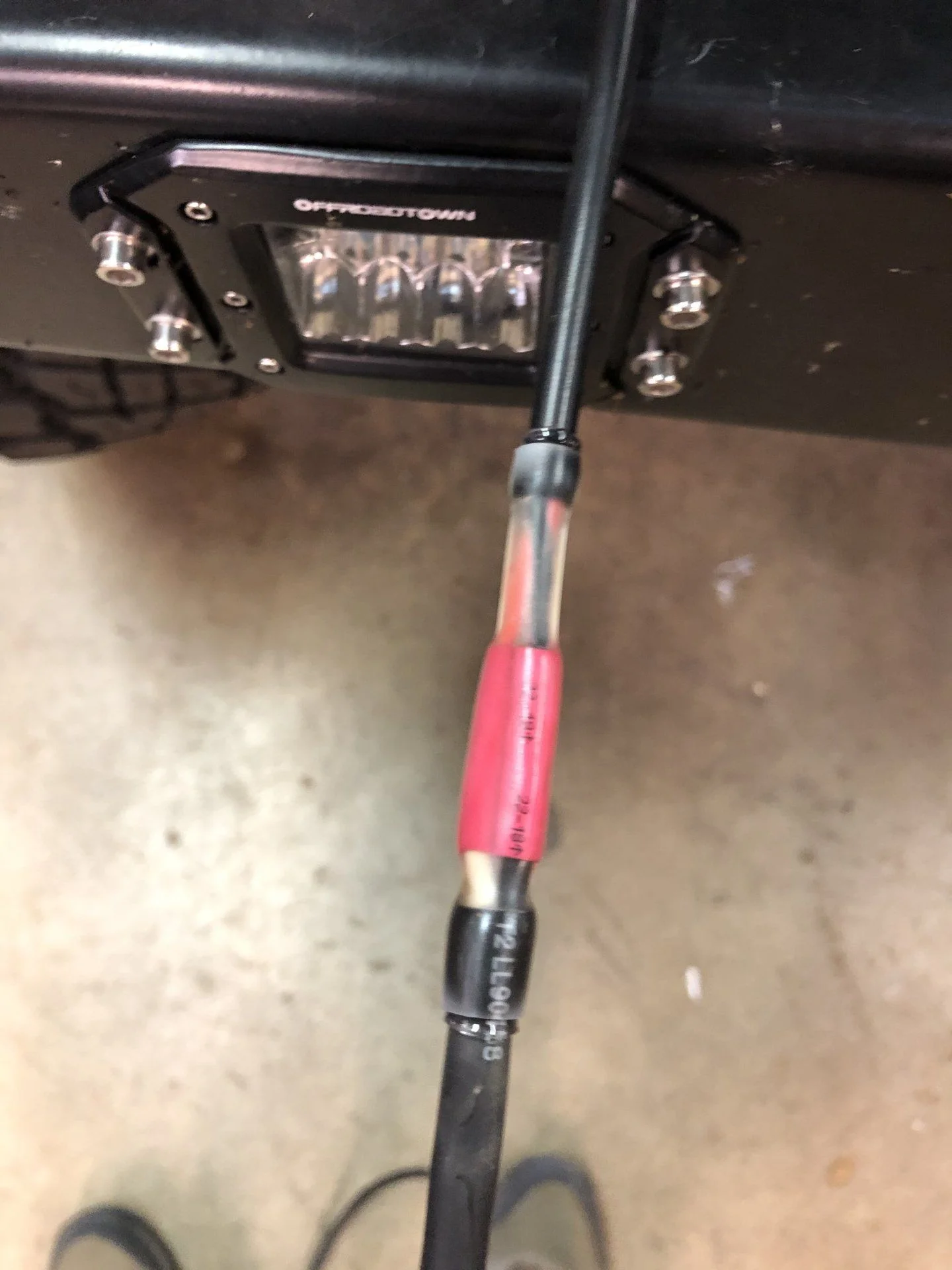

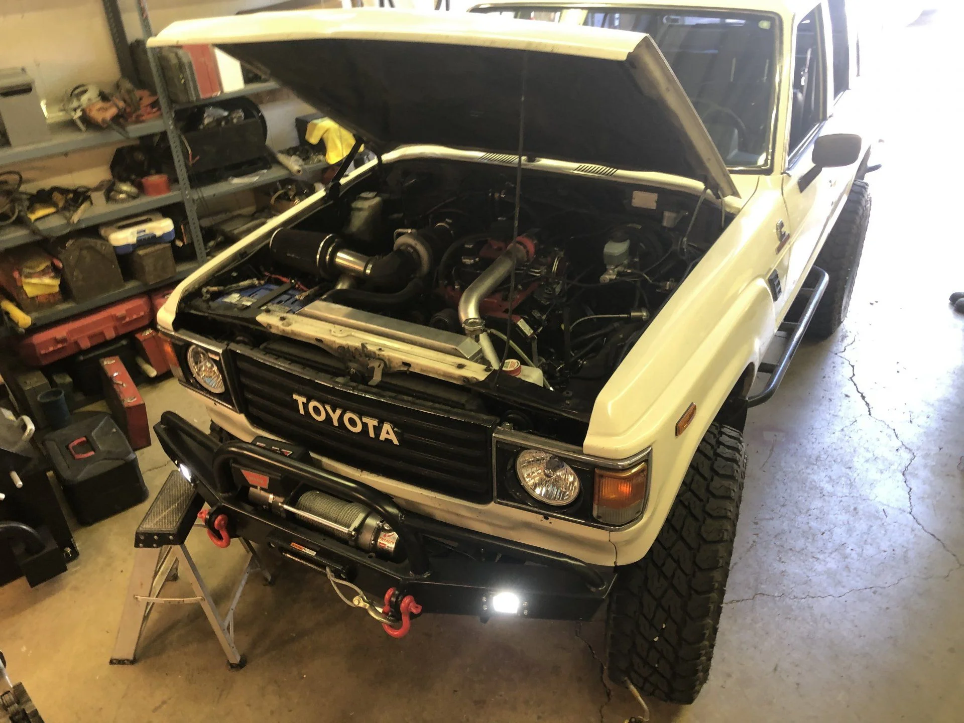

Today was hot with a heat advisory. Since I figured I’d have emergency service went into work and worked on the 60 waiting for calls. Thankfully I only had 2 calls, one a septicissue and the other a leak in a house, luckily we don’t do either so had time to wire the front and rear LED lights in the bumper.

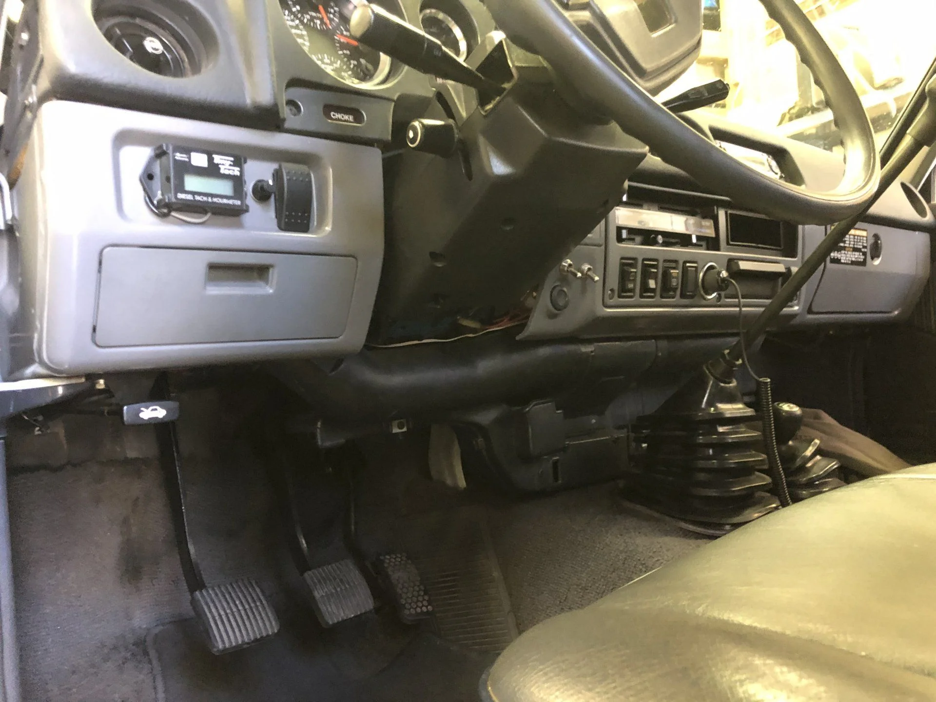

Used butt connectors with a heat shrink splice tube over all the connections.
Ran power off the starter solenoid to a fuse holder. Ran 3 conductor wire into the 60, one for power feed with one for front and the other for back LED lights.
Trying to keep the factory look so decided to mount the toggle switches on right side of steering wheel. Left is front and right is rear LED light.
Ran the wire down the drivers side to stay away from the exhaust pipe.
Put in a 5amp fuse and there’s front and rear working lights:bounce2::bounce::D

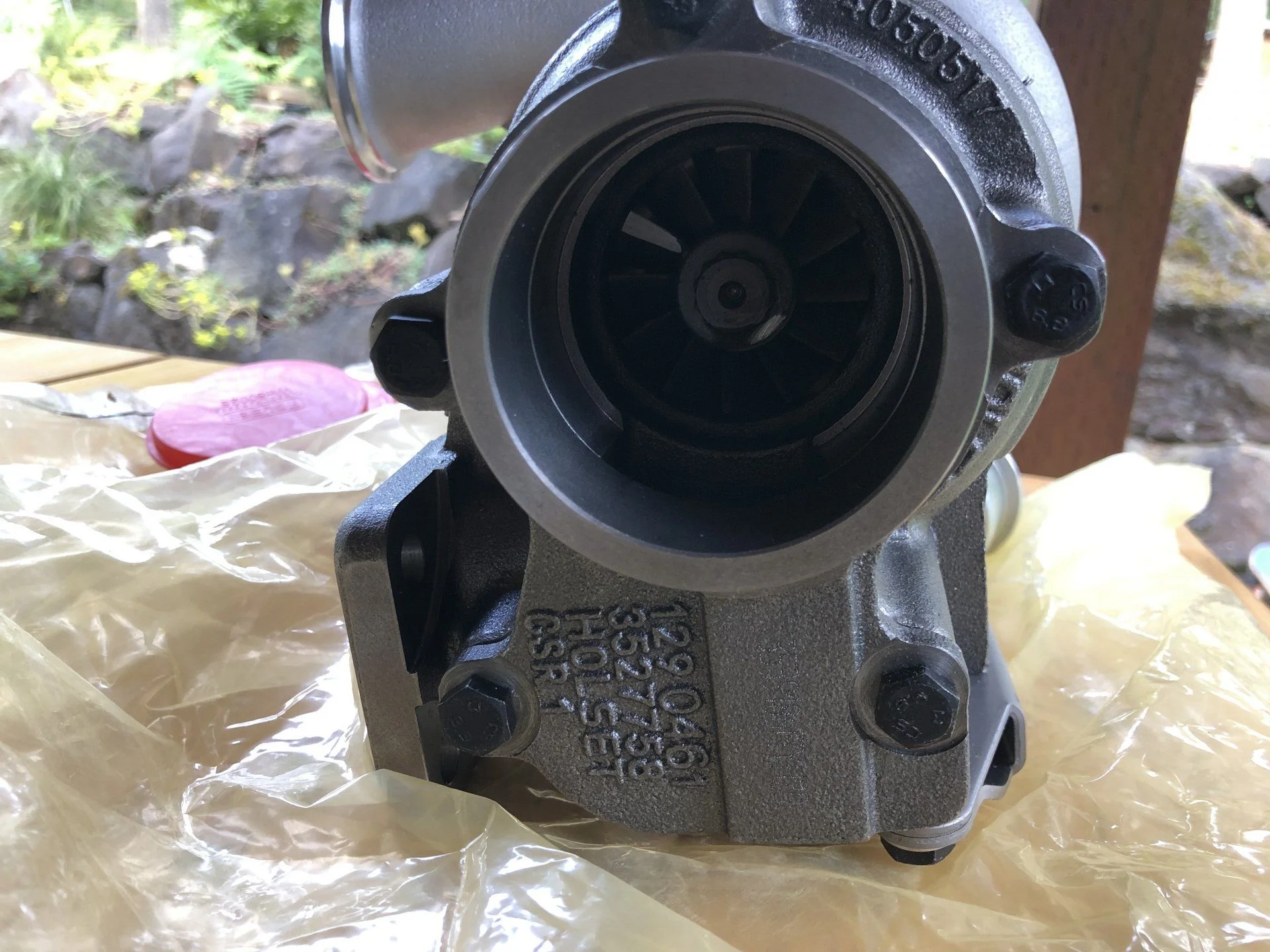

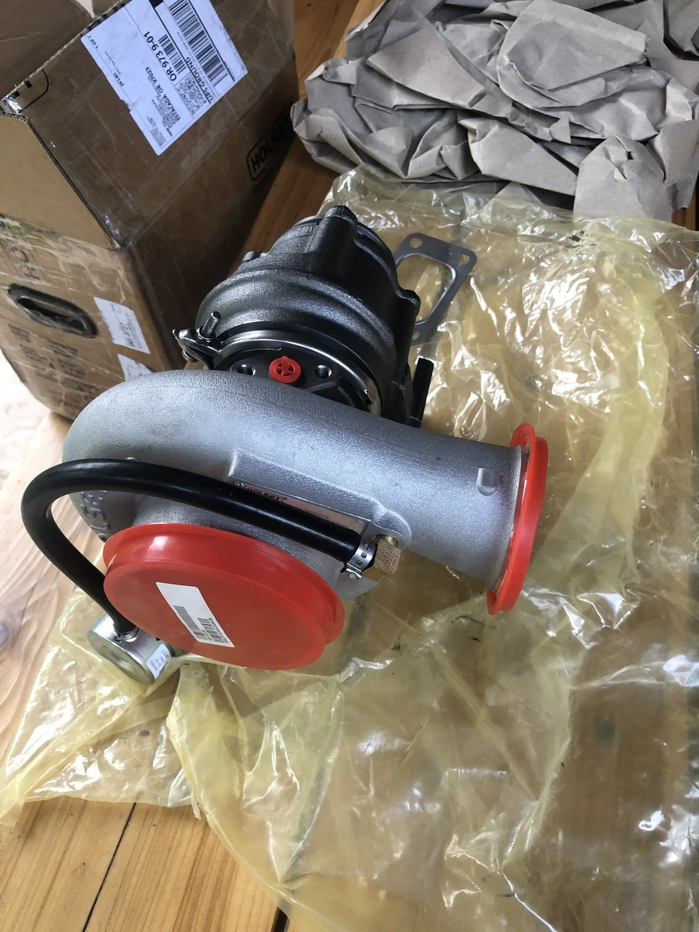

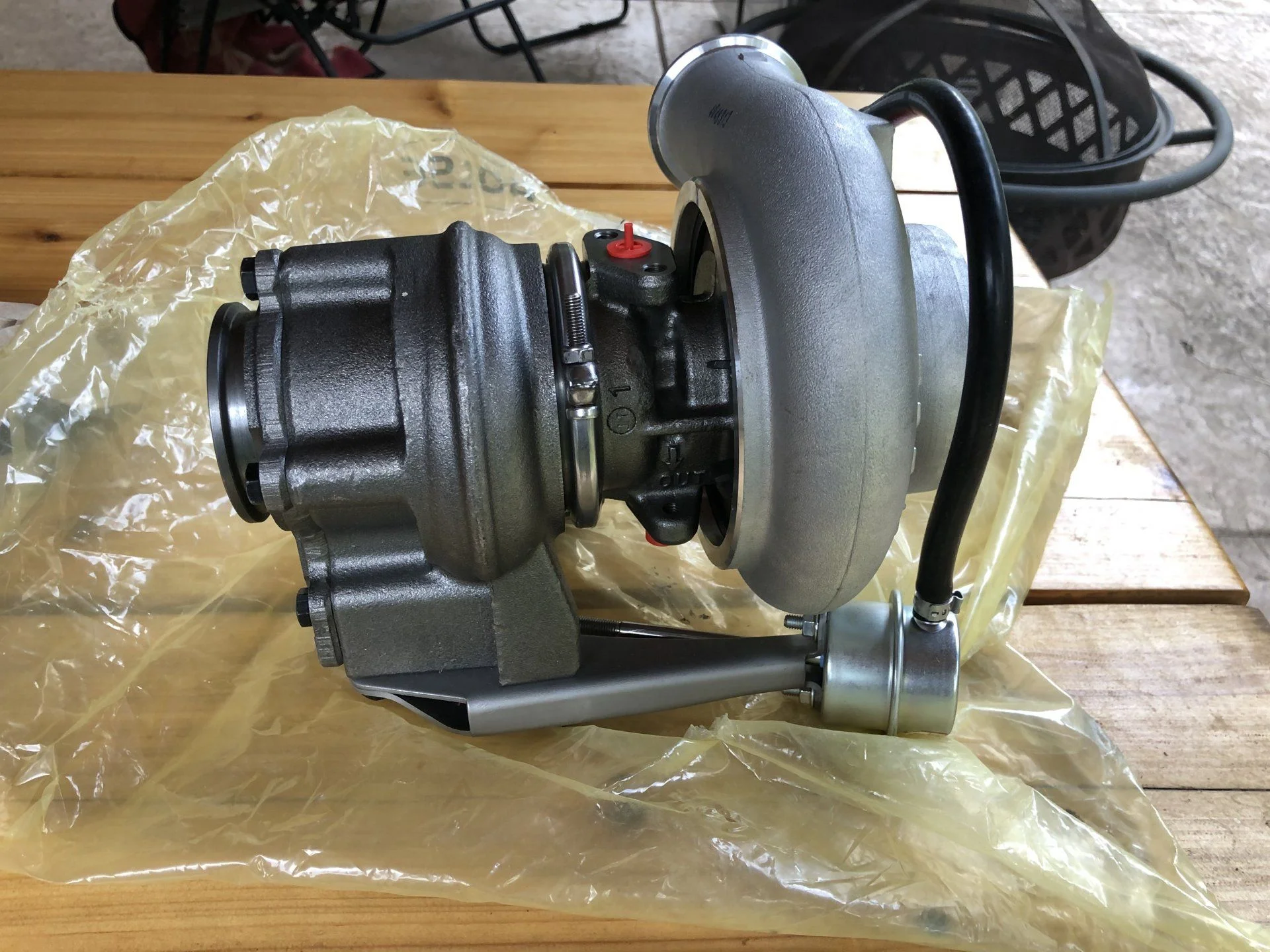

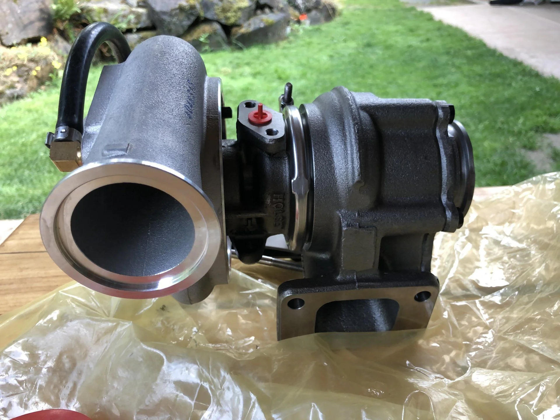

HX30W SUPER Holset turbo showed up this evening.
Holset HX30 Super accessories
Ahh yeah!! Stoked to see this bad boy mounted!

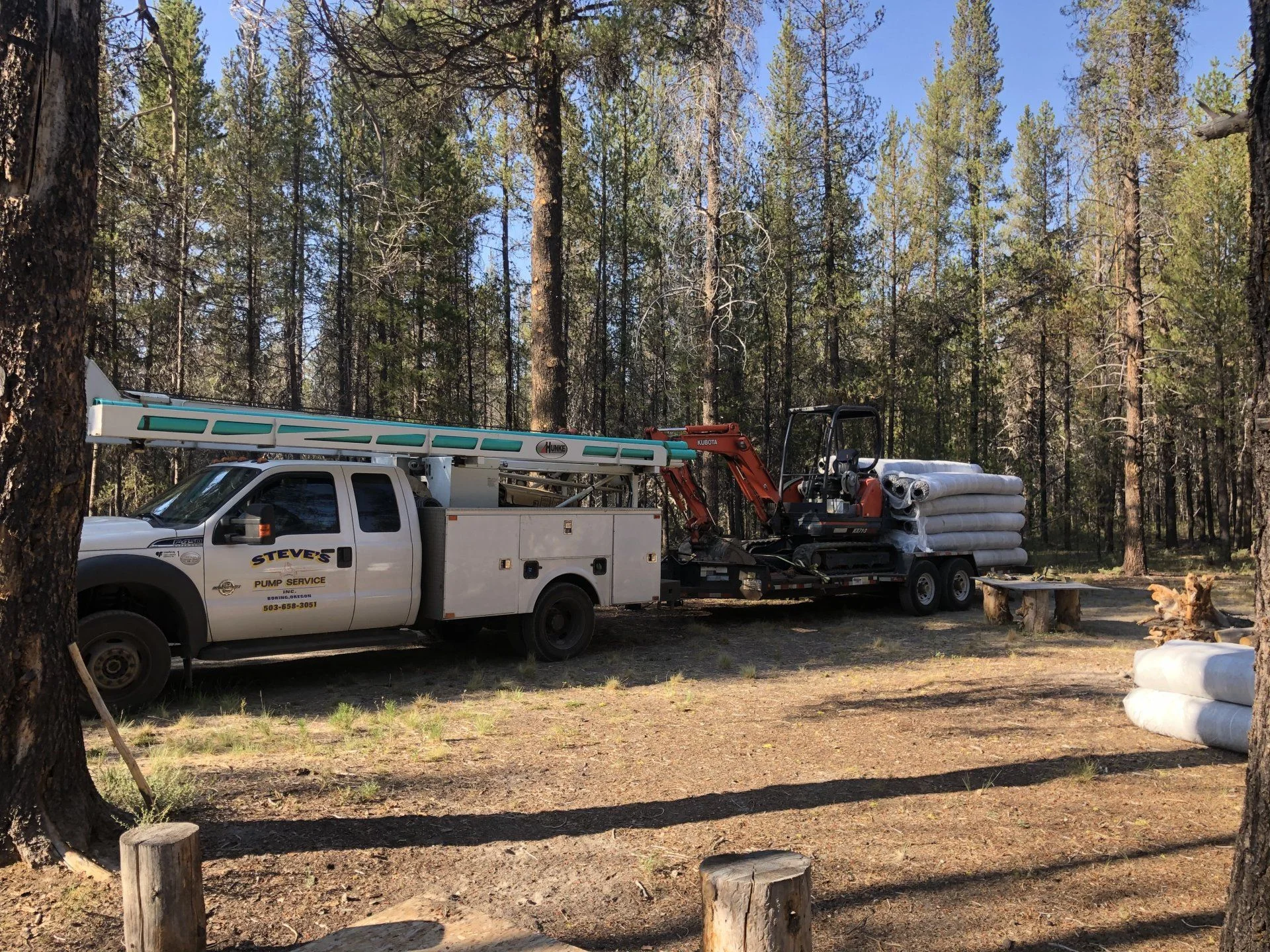

Loaded up my gear and headed into work to loadup and head to pickup septic material from HD Fowler in Redmond, Oregon. My buddy Rob is the manager there and got me his cost for material on both Travis and my septic system.
The drive to the property is 244 miles from my house. I love Central Oregon.
Mt. Jefferson 10,495’ from the Warm Springs Indian Reservation.
101F in the parking lot in Redmond. The employees wonder how I’m going to fit 450’ of EZ Flow septic on the trailer???
Well this is how you do it :rofl:
2 HR drive to property from Redmond.
Arrived at the property without a hitch. Started unloading. That night was solo so slept on my thermorest mattress under the stars.

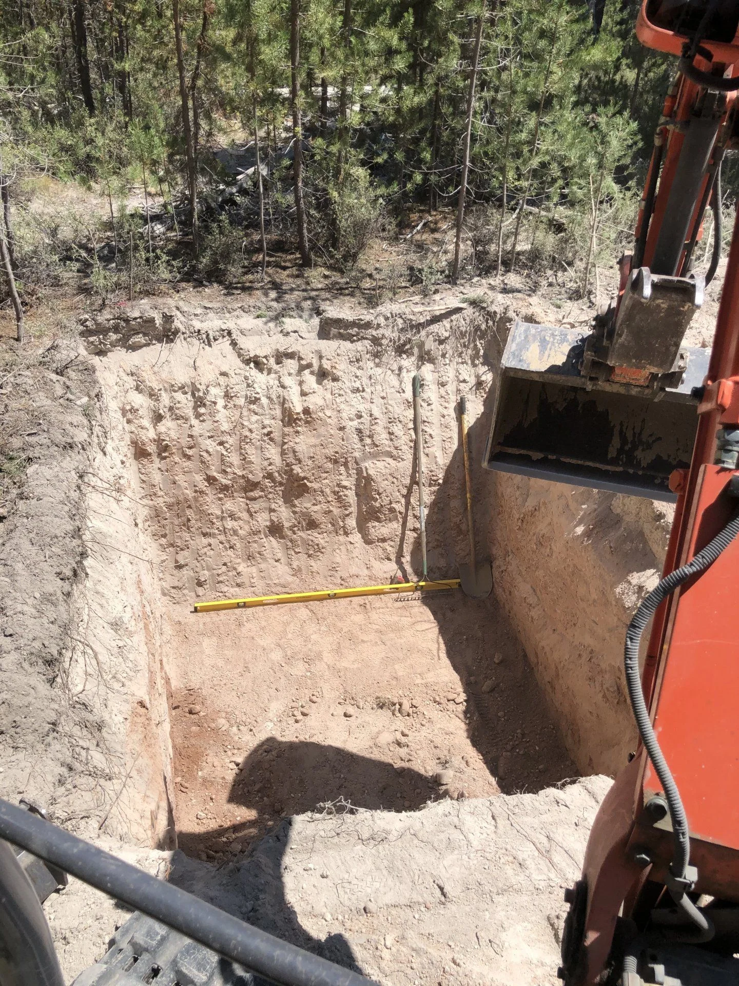

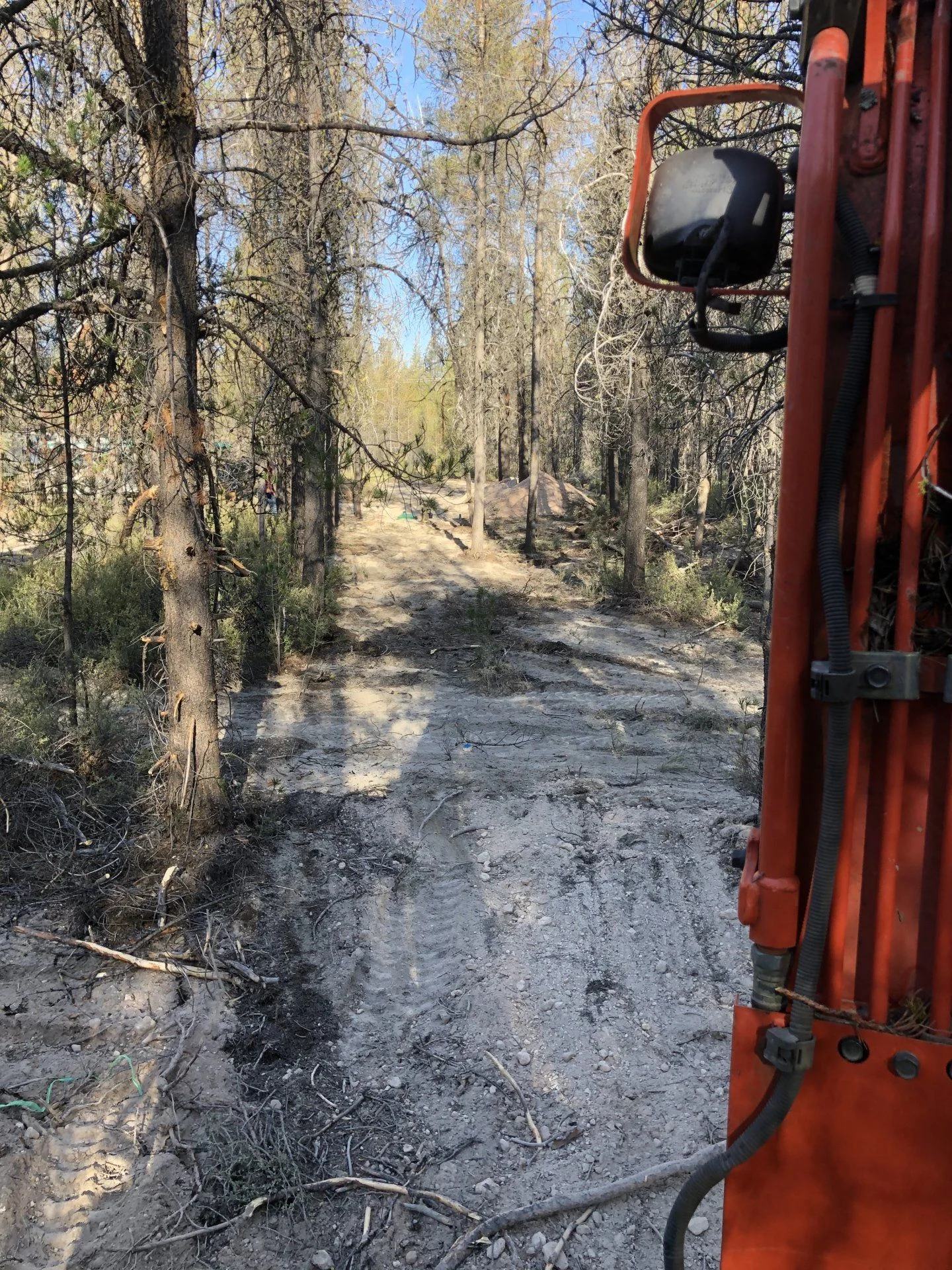

Worked last Saturday cutting and clearing trees for my septic tank.

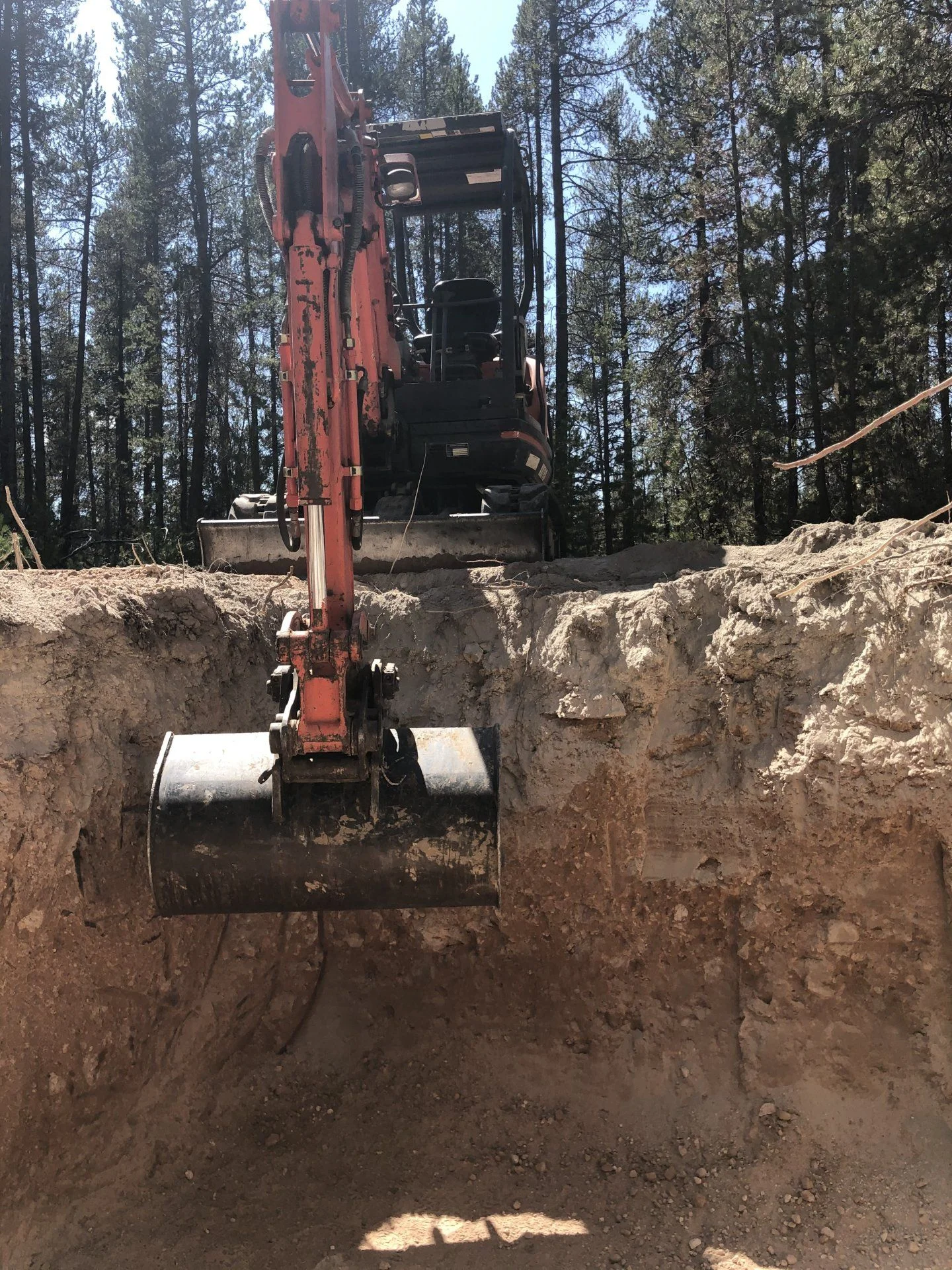

Hole needed to be 80”W x 110” L and 70” D to fit the tank.
Used the red pumice soil I dug out for a nice red dirt road into the property.

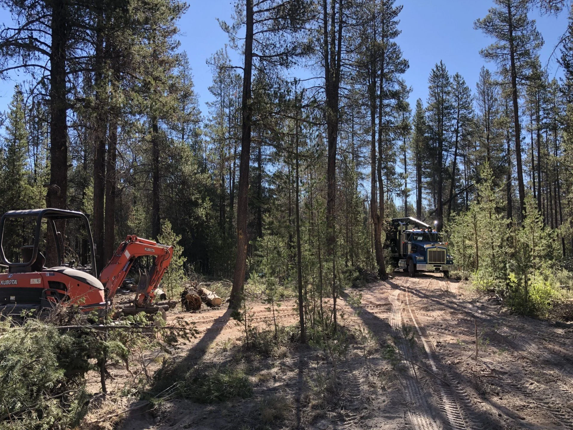

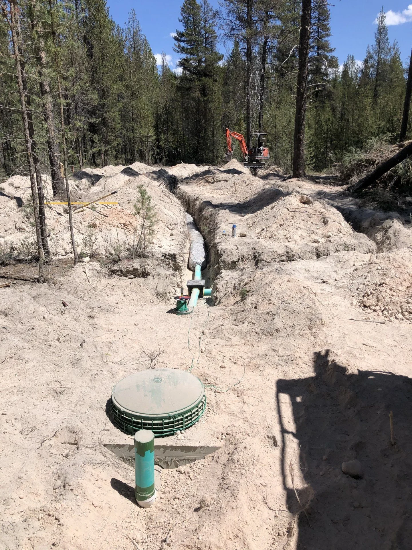

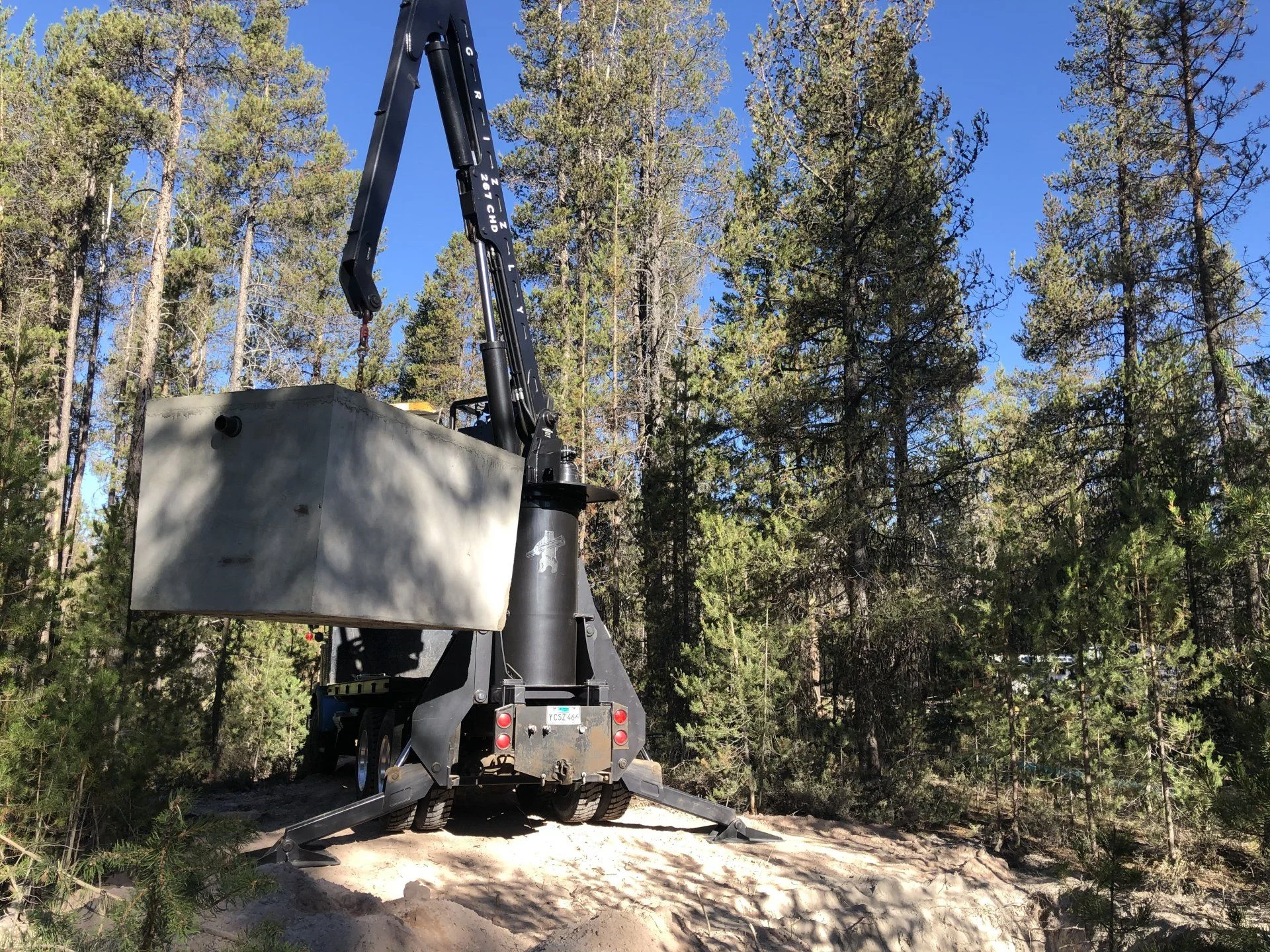

Monday morning the septic tanks were delivered and installed.
After setting the tank had to clear out the area for the drain field.

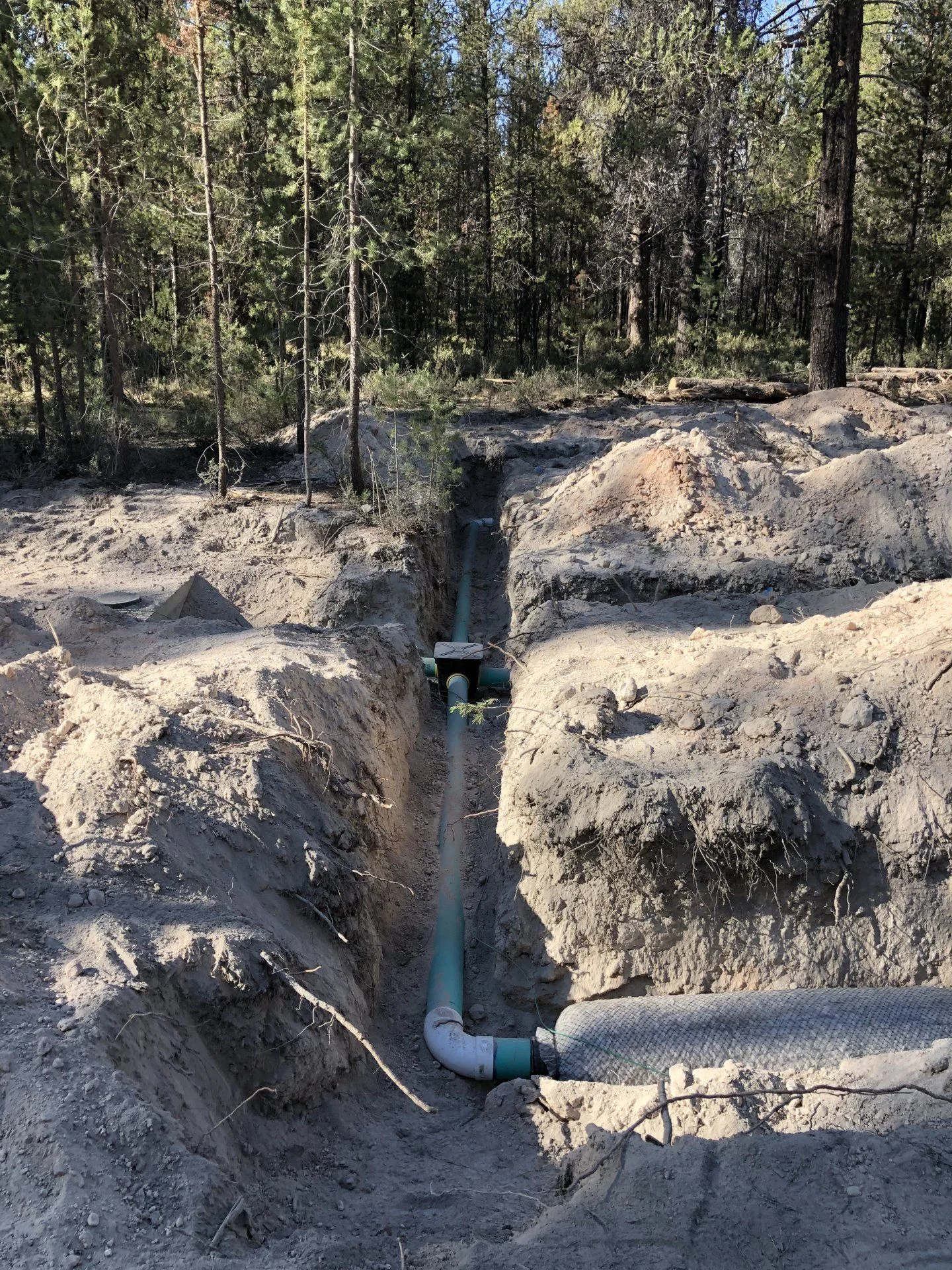

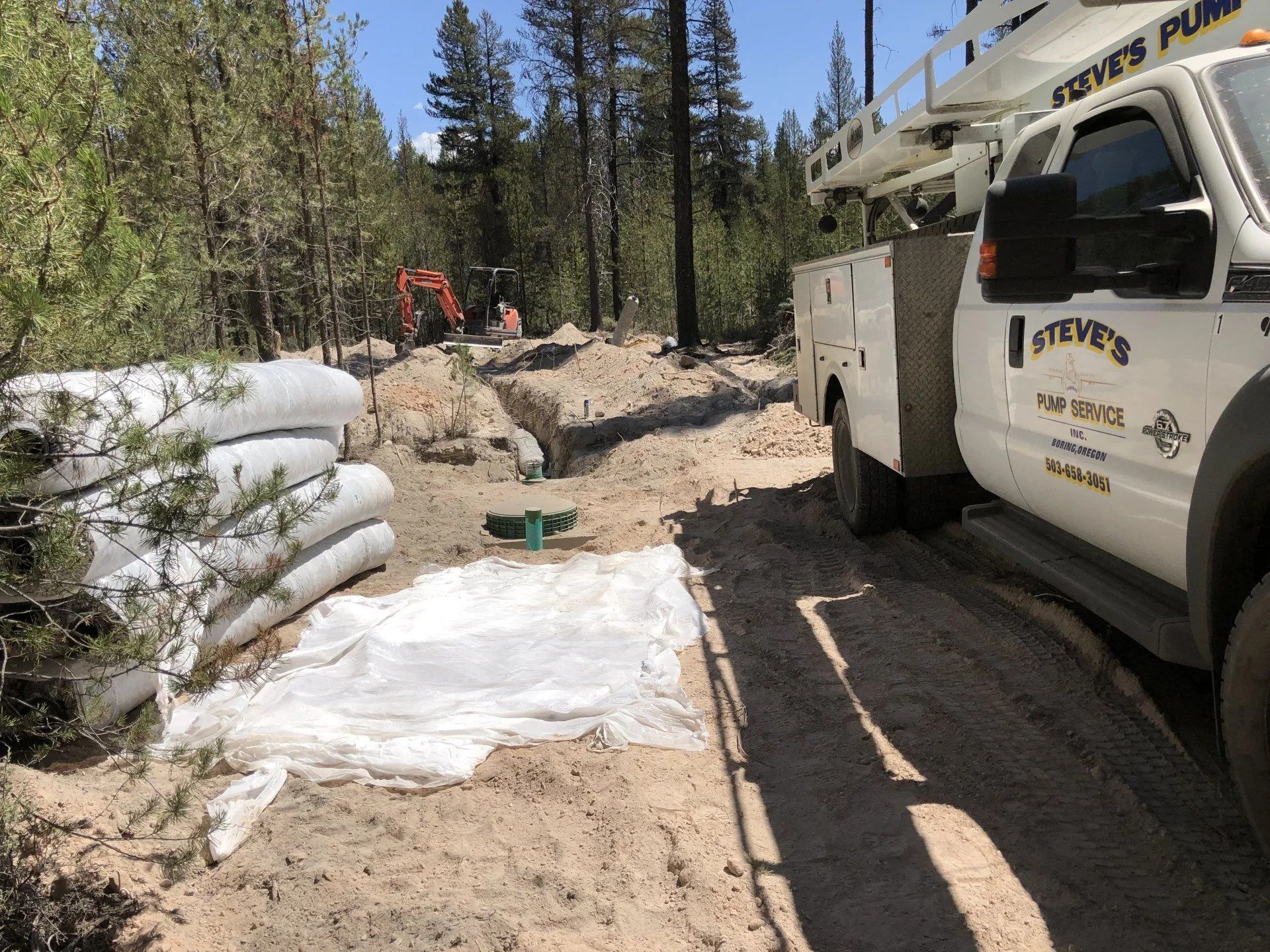

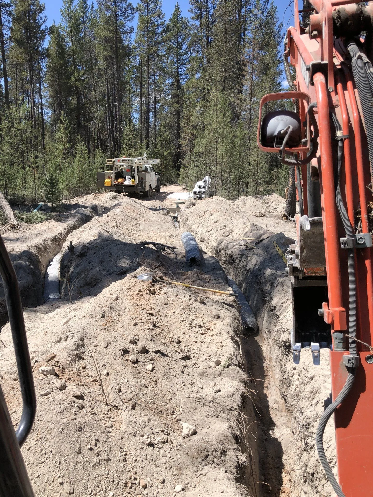

Worked late into the evening trenching and laying pipe.

Tuesday we worked on finishing my septic system.
Had a bucket of cold well water at the handpump to wash up. My buddy Travis went to clean up and found a chipmunk had fallen into the bucket. We pulled it out as it had shock and hypothermia. We got it warmed up and some granola. It finally was able to scurry back into the woods.

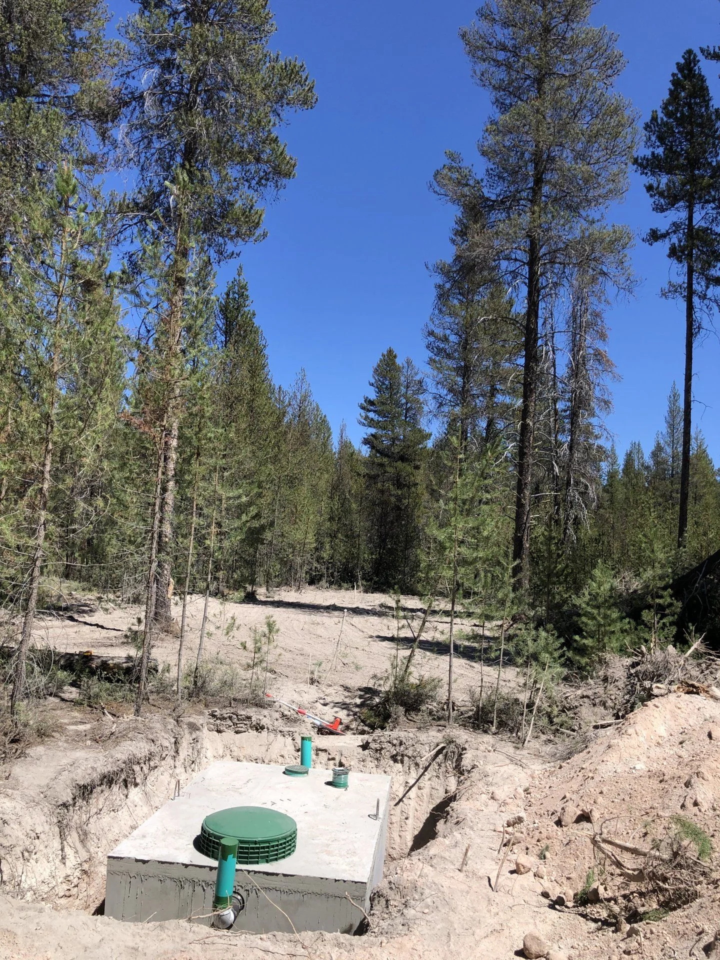

System finished up and ready for inspection and cover later in the week.

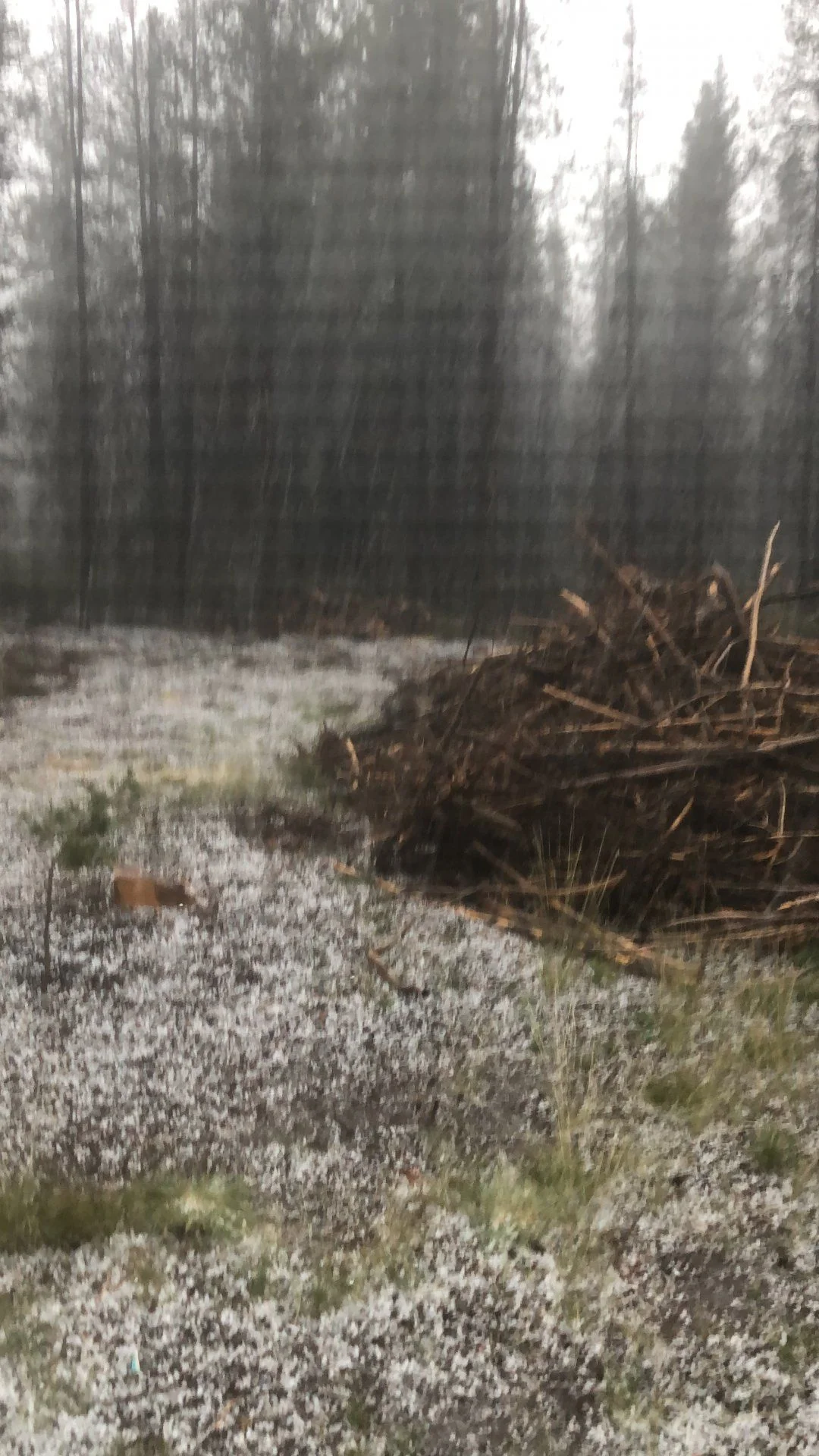

That afternoon was hot so we took a break. Fell asleep for a couple hours and woke up to rumbles of thunder. Went out and worked a couple more hours when a black cloud was seen moving toward. We cleaned up as the wind picked up and were hit by a monster hailstorm.
It was mid 80s but the storm dropped the temperature into the low 40s with wild winds and heavy hail and rain.
The wild storm gave a good reason to get out and drive on HWY97 to Diamond Lake Junction.
It went from a summer afternoon to winter in 2 hours.
