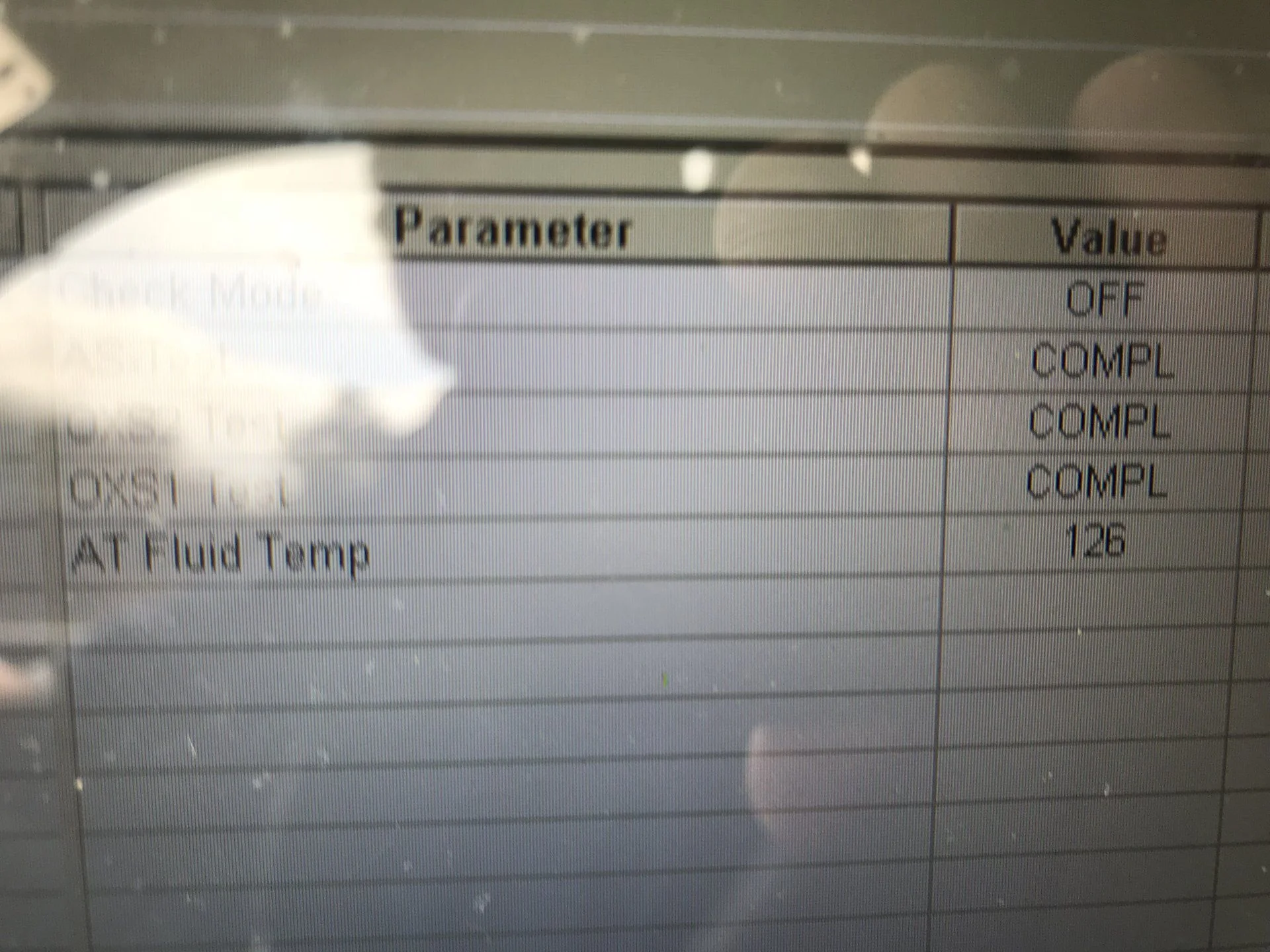

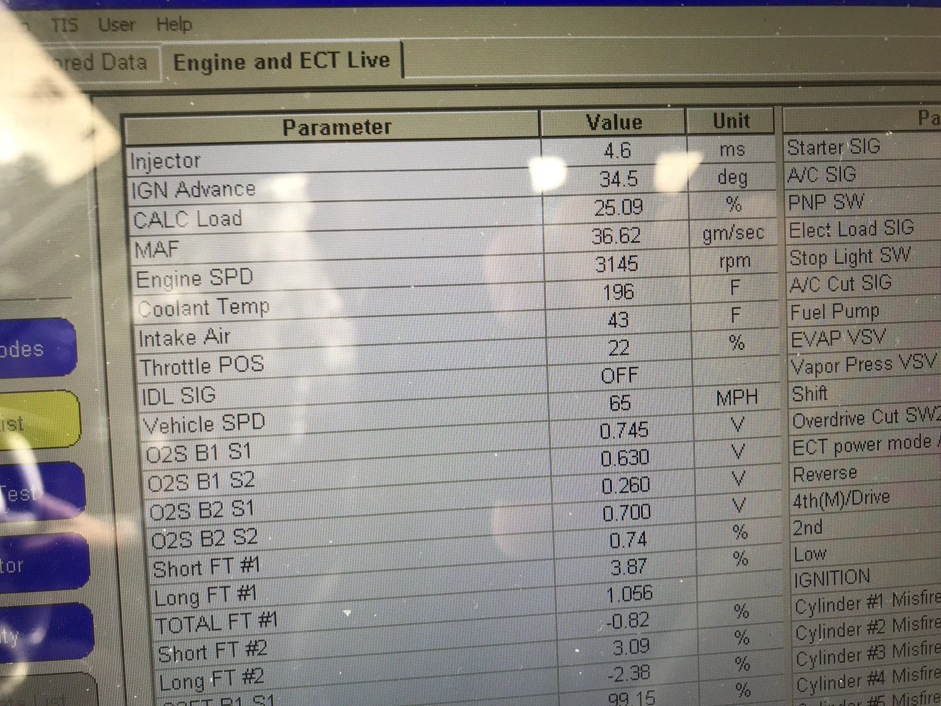

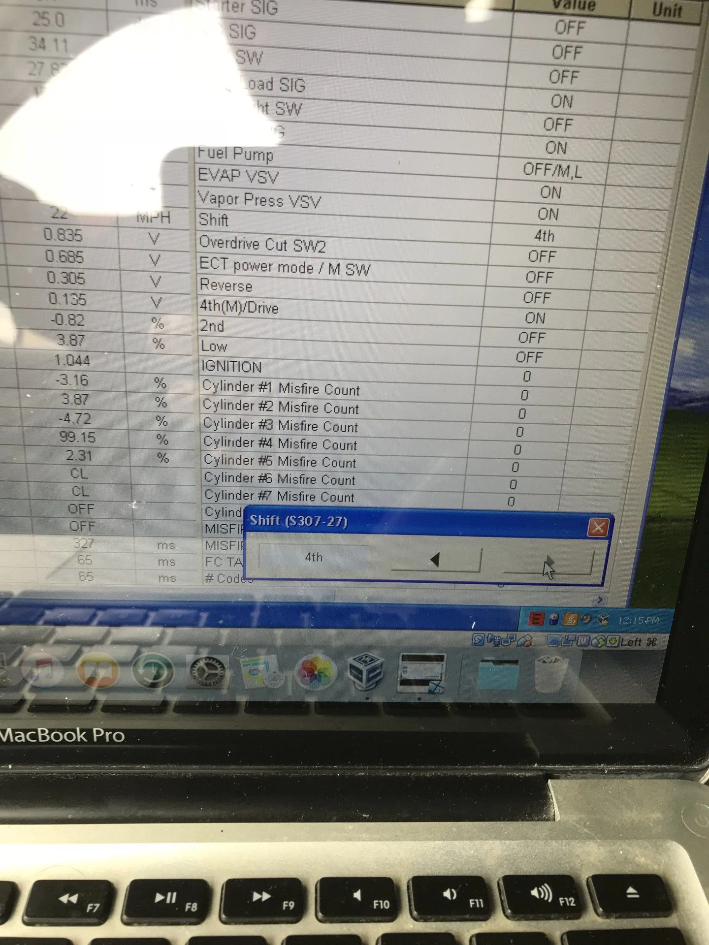

The journey continues. Figured I’d keep this updated in case someone experiences the same issue. So, I finally hooked up techstream. A lot of great information this program displays.
I was trying to take pictures without running into someone else on the highway. So they’re not greatest shots. As you can see my temps are working fine.
1919582
AT temps seem to be fine as well but that shouldn’t matter it not be able to shift to O/D.
1919583
This screen shows that I’m in 4th. O/D switch (button on the shifter) is not pressed out. Not sure what 4th(M)Drive is.

Lastly, I went into active test mode to manual shift. Here’s where it gets interesting.
This test requires to drive less than 30 mph. Each shift up I physically feel the shift and see the drop in rpms except when I go into 4th. I don’t feel anything and rpms don’t drop a couple hundred like the other gears do. The rpms stay the same as they were in 3rd gear. Another interesting observation is when I start to manual downshift the rpms don’t jump up. The tach stays around 1000 rpm.

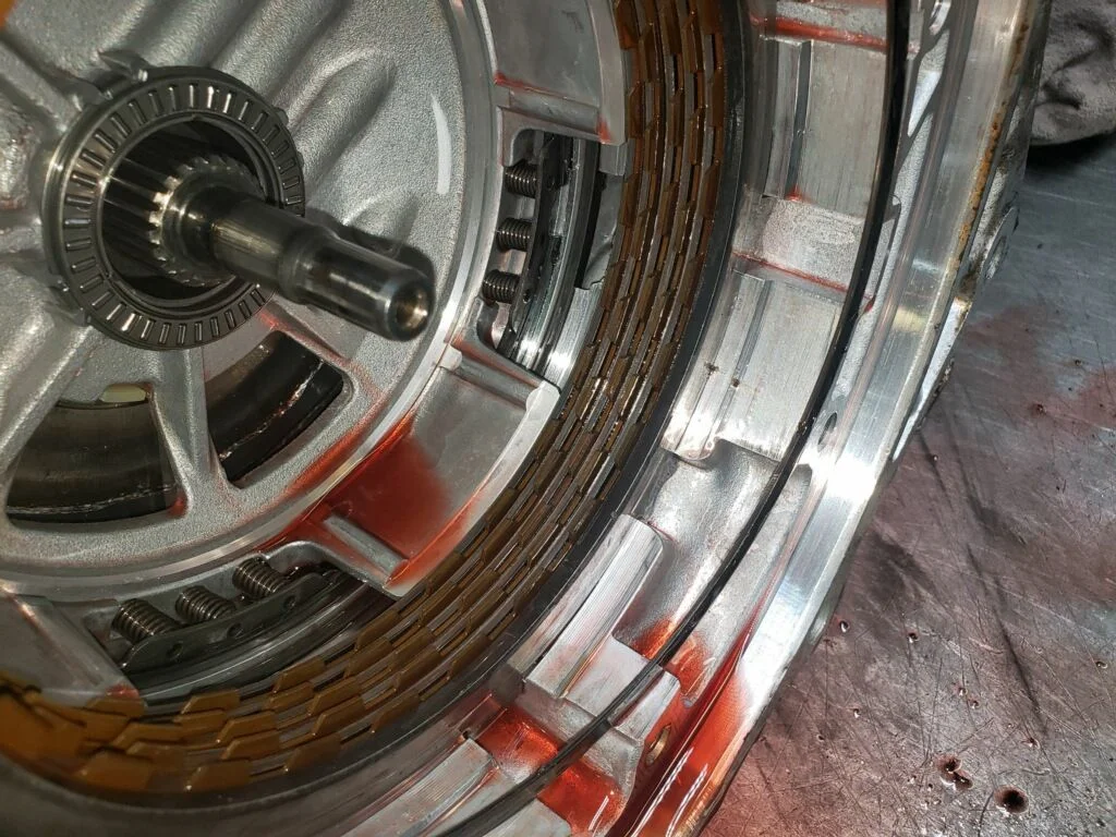

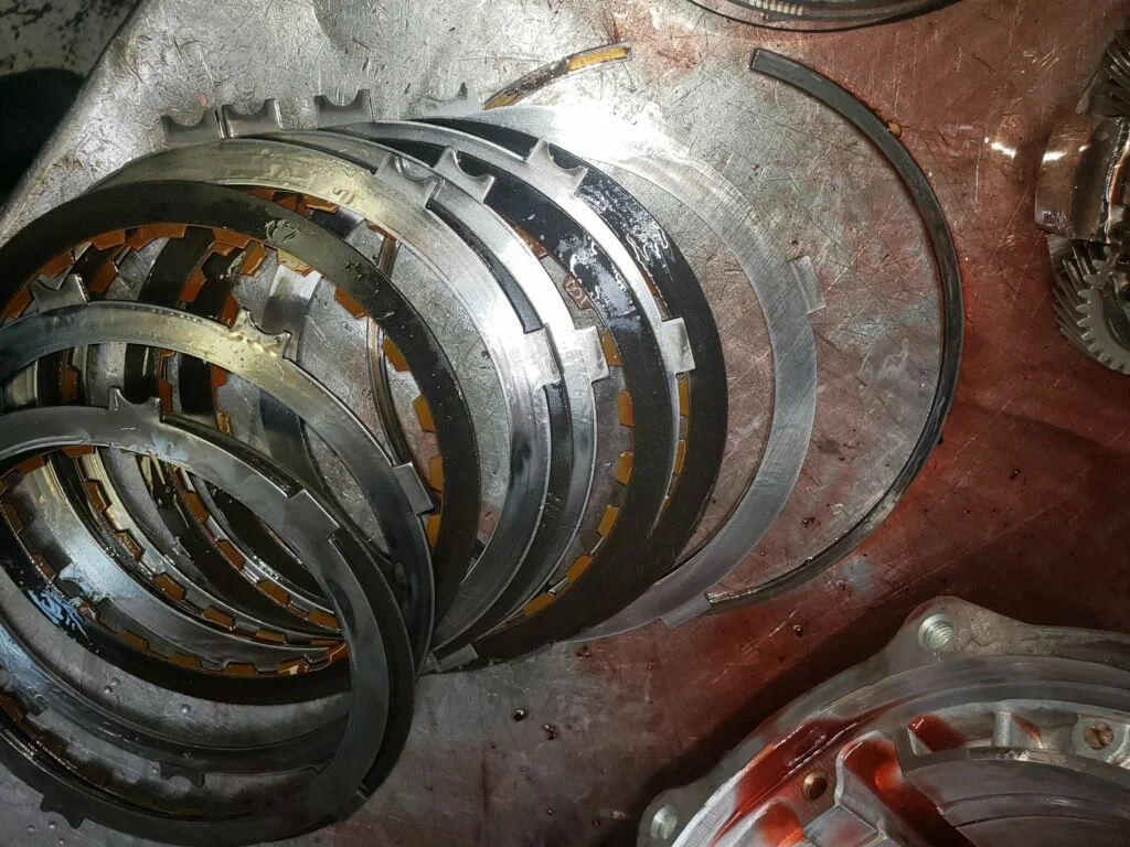

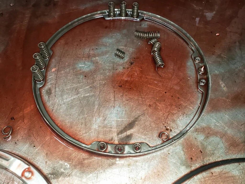

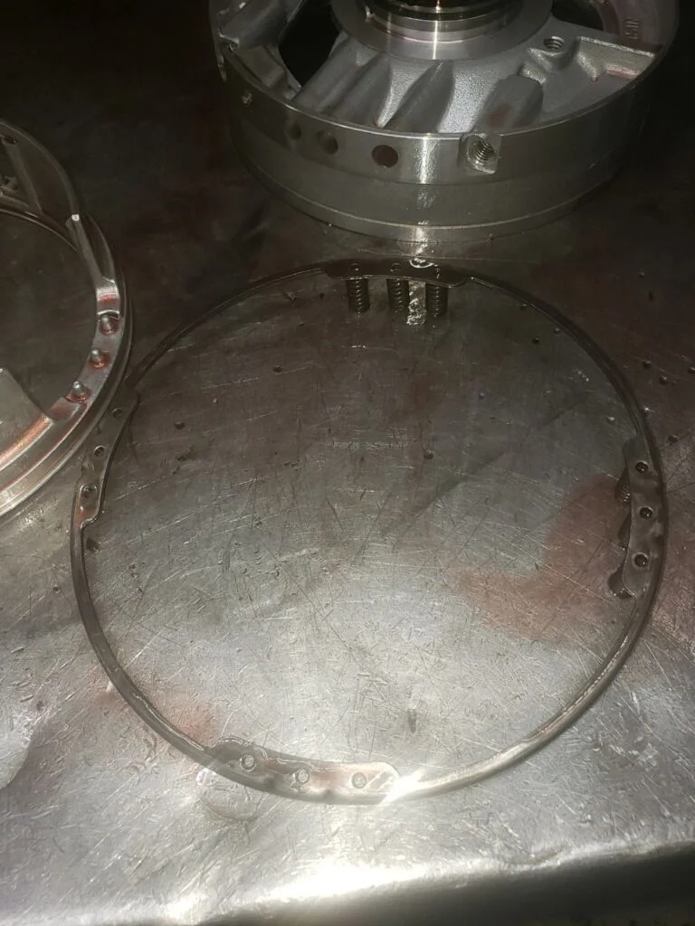

The saga has come to a end. Took it to Landmark transmission recommended by ACC. The guys were great. Price was fair. Plus I have a unlimited mile two year warranty.
Basically what happened is the OD brake snap ring that holds the clutch in the case came out of its groove. This caused the piston that applies the clutch to move too far and cut the o-ring on the piston. The return spring cage was also damaged. Other than that I was told the rest of the unit looks good. Pretty amazing this transmission went 330k + with no issues.
