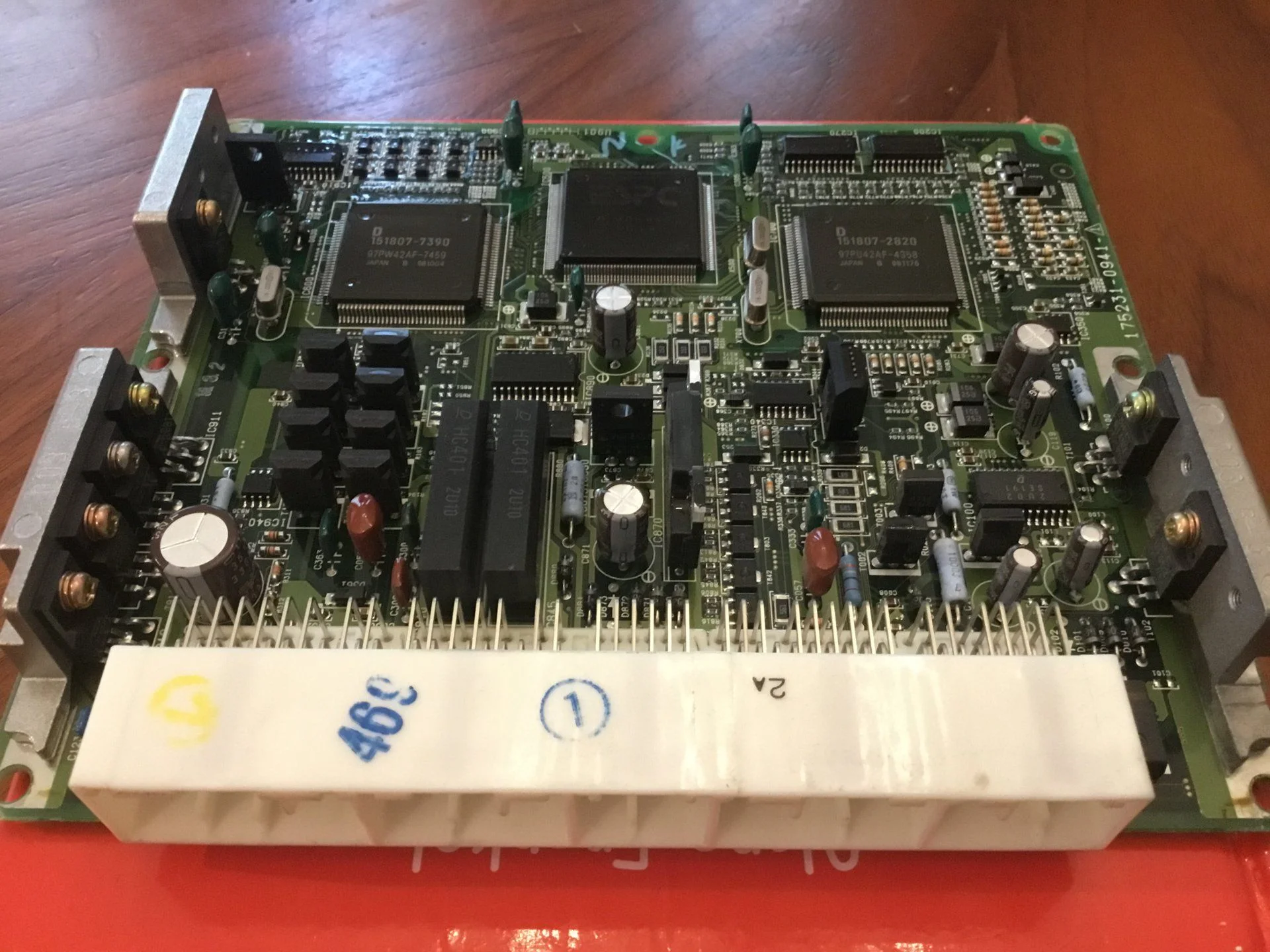

So far I have replaced the fluid twice. Changed out the #2 solenoid, filter, ECT sensor, and the OD direct clutch speed sensor. Those items seem to be the hot ticket to the lack of higher gears. I even pull the ecu to see if I had any burnt or destroyed capticators.

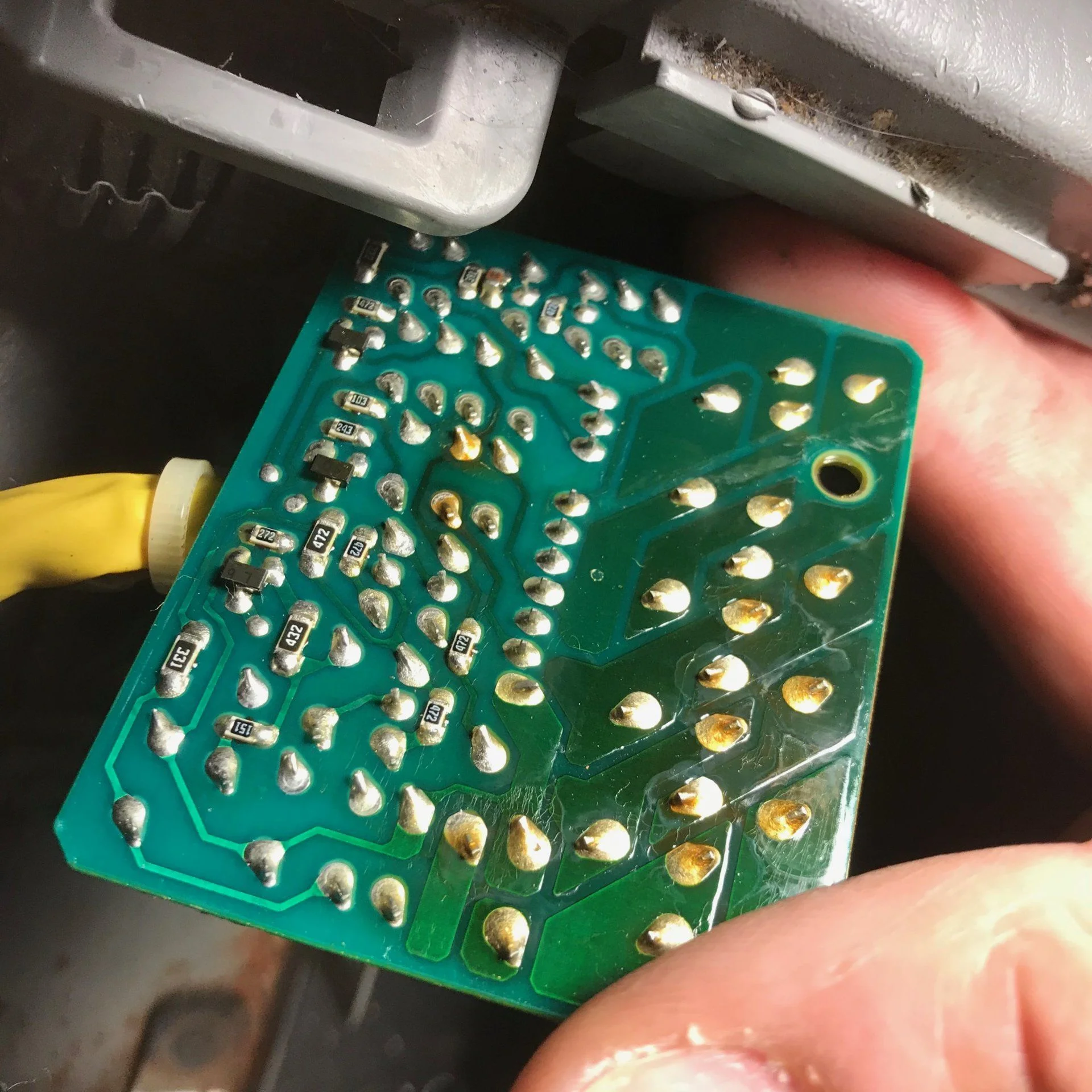

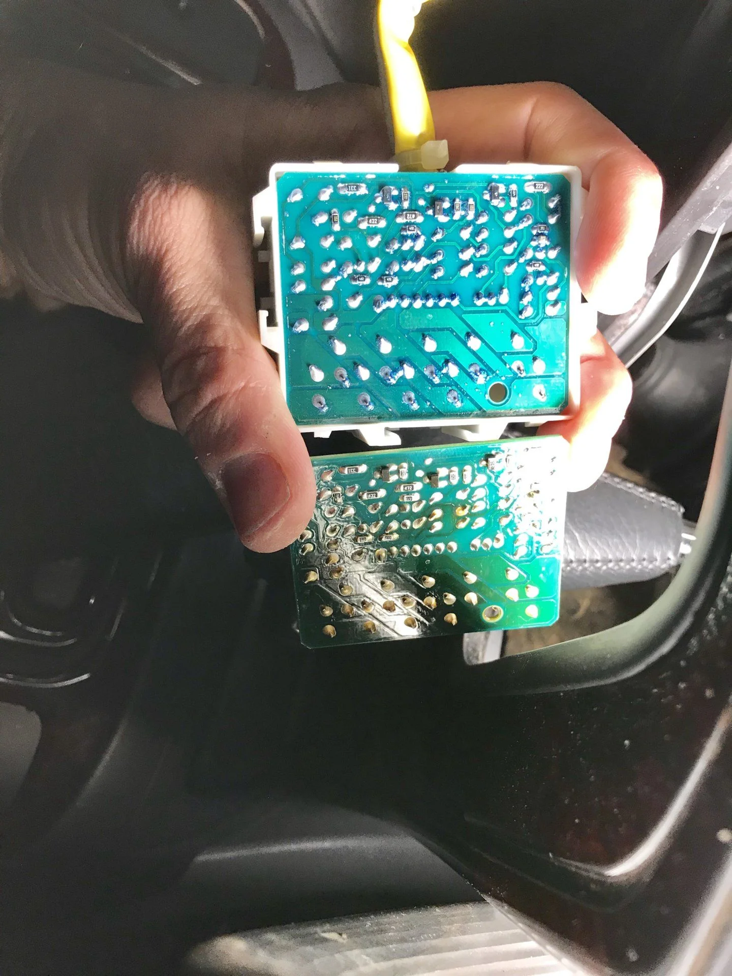

I pulled the center shift console. Checked the O/D main switch and shift lock control ecu. It looked pretty toasty. What do you all think?

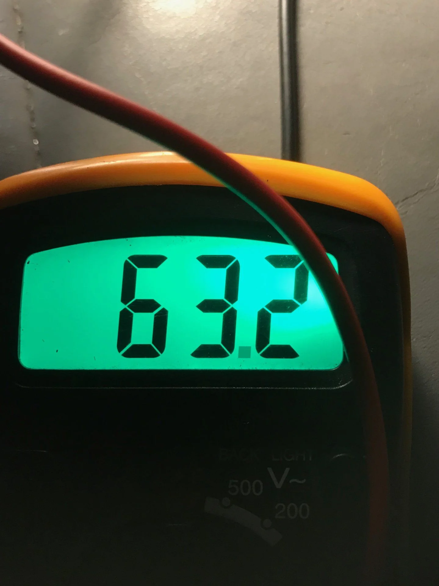

Connected the the volt meter to pin 5 and 10 and this what I got.
