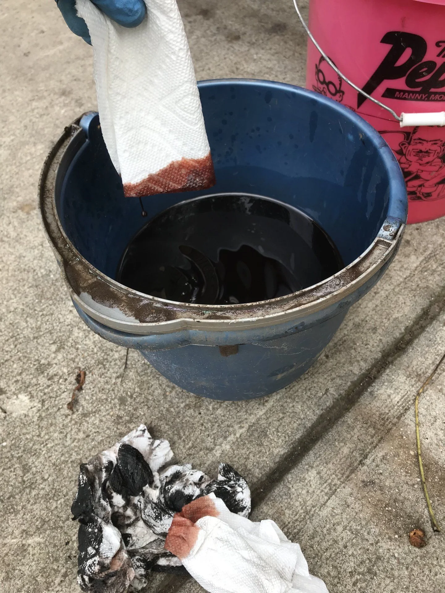

Thanks everybody for the response. So I had some time to drain out the fluid. It was definitely dark red and it smelled like tranny fluid. I wouldn’t say it smelled burnt.

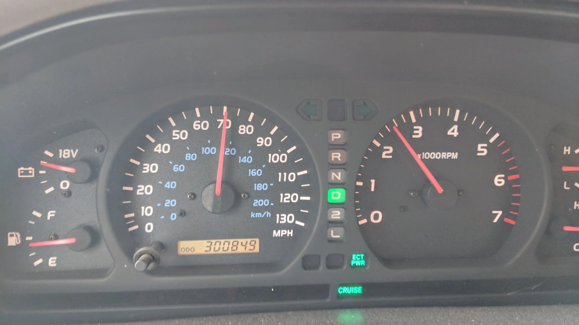

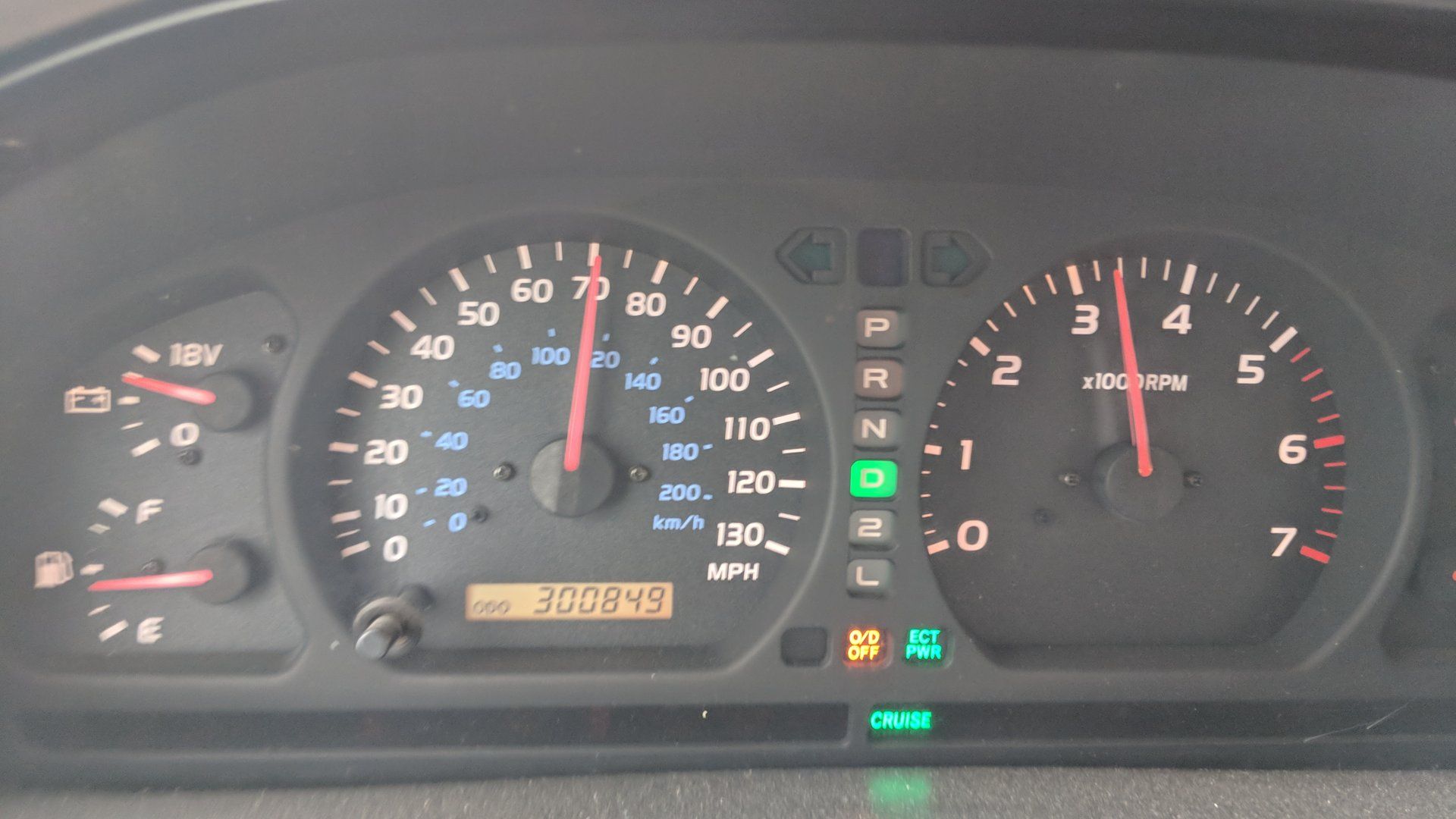

I was curious as to what rpm, so I snapped this pic earlier.
The light works. I get a slight blip in rpms when I hit it.
You should get more than a slight blip in the RPM.
Cruise set at 70 with my 99, converter locked based on the settling of the RPM in 4th.
Exact same situation as above, but I pressed the OD OFF. Converter is locked based on the RPM settling in 3rd.

That’s exactly where I’m at. So I’m definitely stuck in 3rd. When you guys release the gas pedal does rpm’s drop to about a 1000? When you are coasting.
