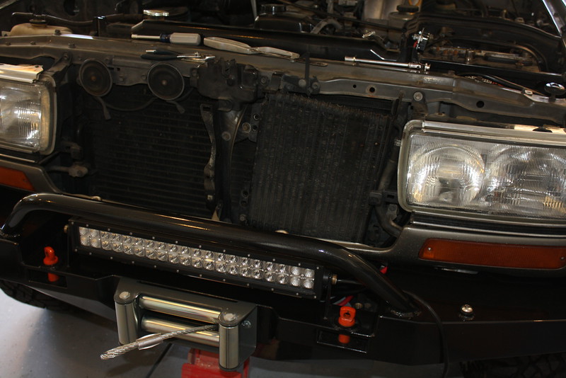

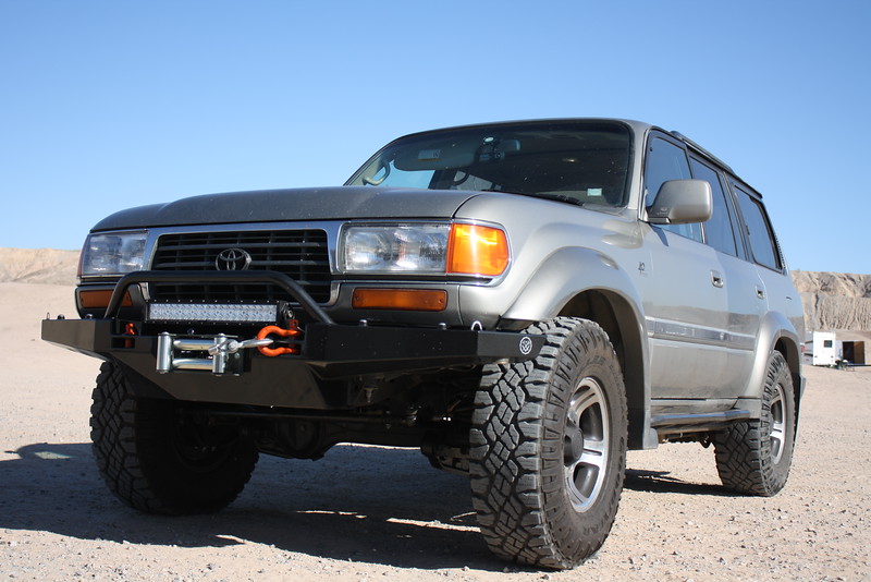

Installed a harbor freight badlands 12K winch into my costa fabrications bumper @RDC76 . They were on sale for silly money $299 so I couldn't pass it up. Had to notch a factory bracket that holds up the lower valance to get it to clear the winch frame. Also mounted the trans cooler a bit cock-eyed to make room for the winch body.

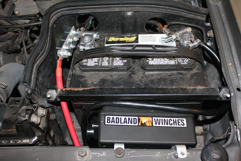

I put it in backwards, so I later had to swap it side/side. I put the control box in front of the battery.
Very happy with the result.

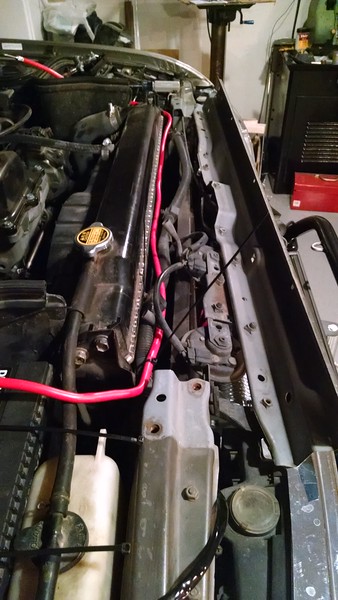

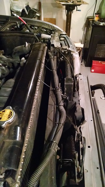

I decide to run the positive lead under the radiator core support for maximum protection. I double insulated it and strapped it to the OEM harness that also runs under there.
Once the core support is back in place, you can't even tell it's there and it's so out of the way you couldn't damage it unless you really tried hard.
Very nice. I saw that same sale on the winch. I was thinking the same on the battery. Where did you ground it?

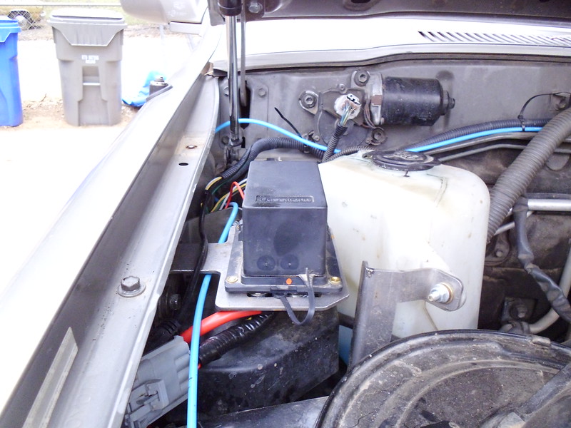

I needed some additional circuits under the hood for things like the dual battery join circuit, my light bar, ARB tiny air compressor (runs the locker) etc... Bought a waterproof bussman relay/fuse box and a whole bunch of metri pak stuff to wire it in. Had a bracket custom fabbed to mount it on top of the cruise control unit. Nice clean install.
Looks great! You should do a write up on how you do wiring.

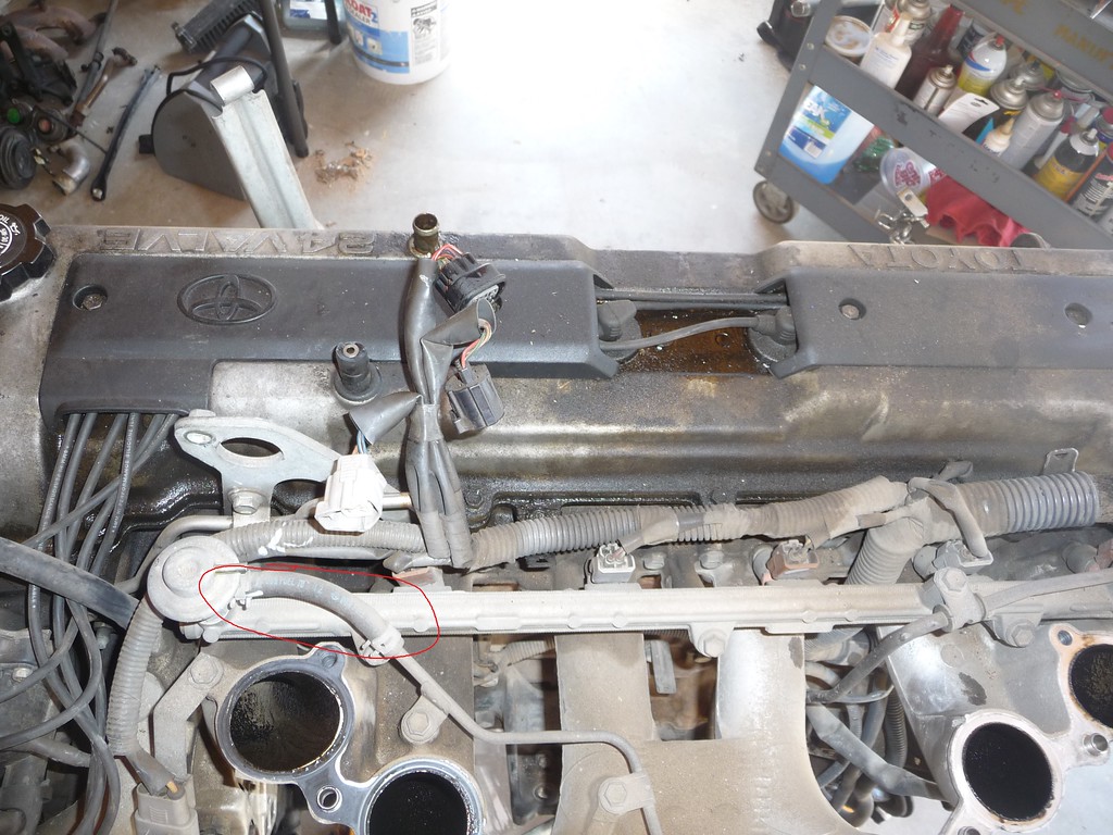

I'm looking for the part number for the fuel return hose that exits the fuel pressure regulator on the fuel rail as illustrated:
Offending hose is circled in red have looked at all the parts diagrams and can't find this one.
95334-06010 if my Google-fu is right.
