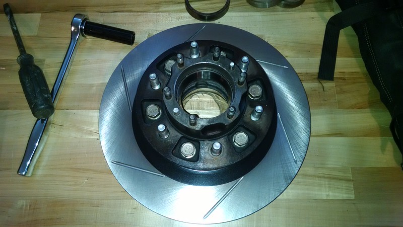

What kind of rotors and pads are you going with? Any tips on pulling the front axle?
The front axle pull wasn't difficult. A good impact gun would be my only advice. That and your trusty BFH. My truck isn't rusty though, that helps a lot, I would hate to have the rust I see on some of the pics here. The ends of the shocks did break off when i tried to drive the nuts off.
Those are 'Stop-Tech' slotted sport rotors. I've used them on other vehicles in the past and had good results. They used to be called 'Power Slot', some guys I know run them in SOLO-II racing and also like them.
The pads are the highest end Raybestos Semi Metallics I could get. They are designed for maximum grab. I avoid ceramic like the plague, terrible stopping characteristics, designed for less dust and fade. I put a set on my S2000 and even compared to old, worn OEM pads they were absolute trash. They don't fade, but they don't have the grip either, I thought they would get better with break in, but they did not. If I am not happy with the raybestos pads, I'll try a set of EBC or Hawk.

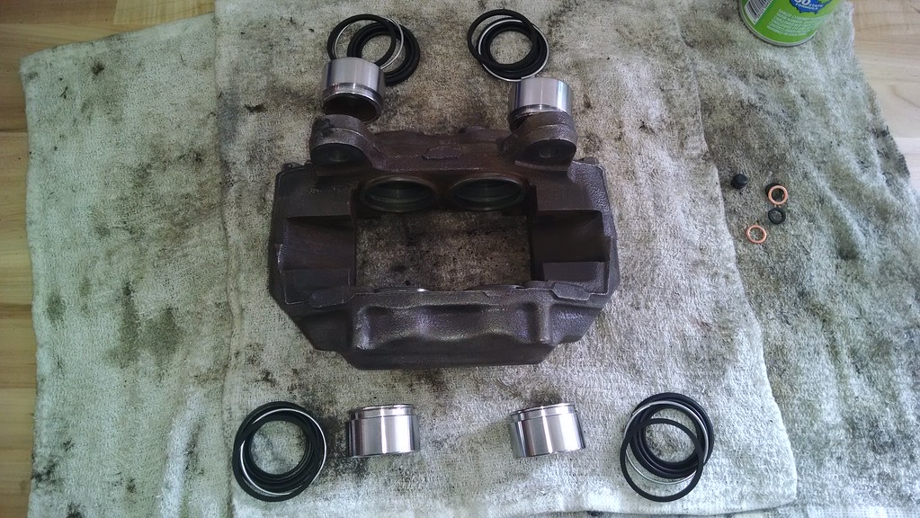

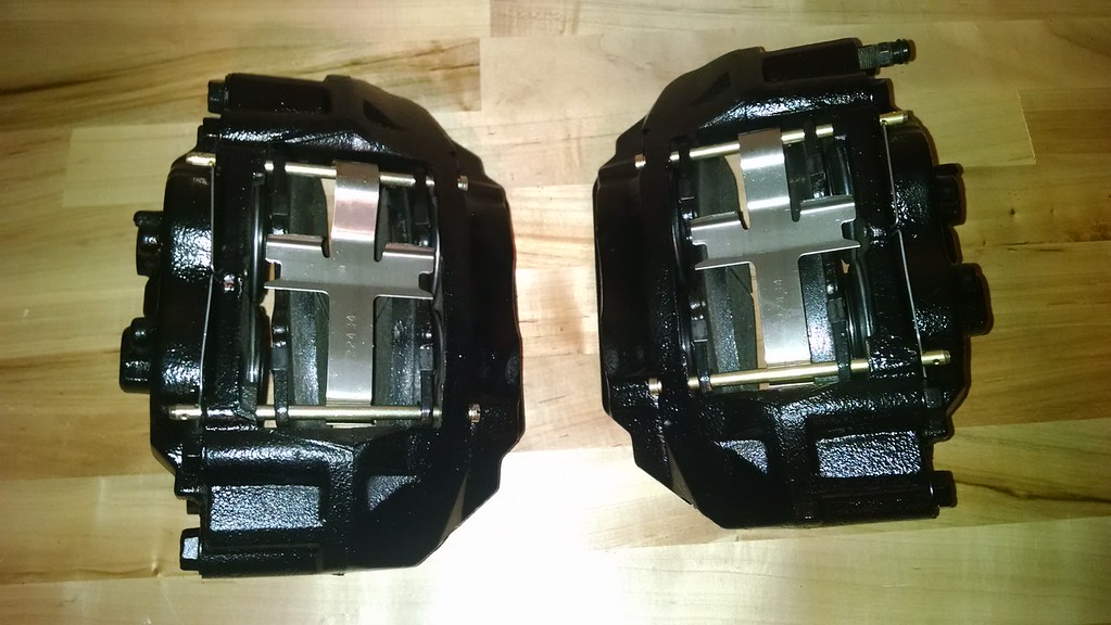

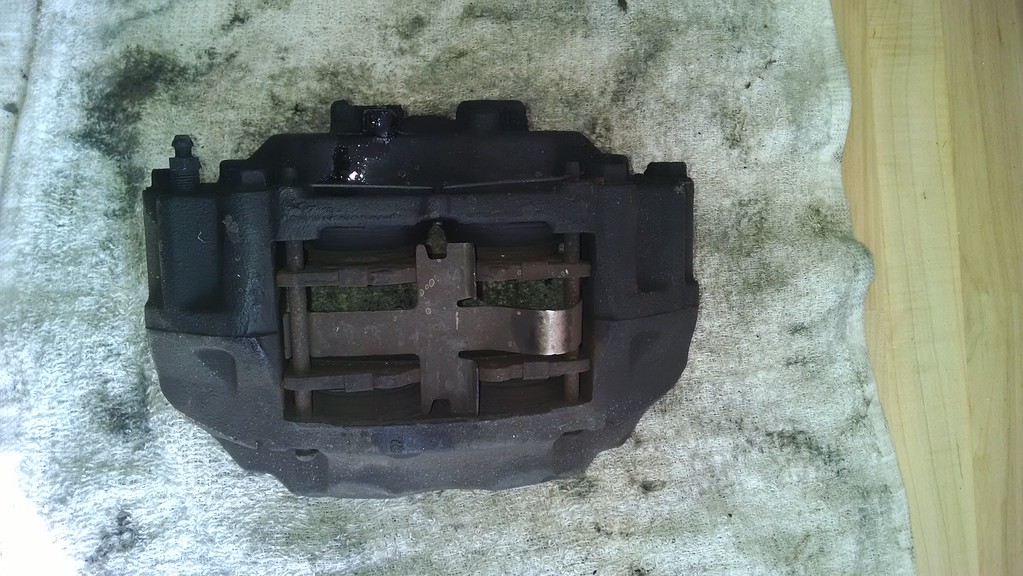

Decided to rebuild the calipers myself. I know hardly anyone does that anymore, but I like fixing stuff. Be more than a parts jockey!
Went from this:
To this:
Required about 1 hour of work per caliper. Saved $50/each over rebuilds and I know for sure what's in there. The pistons and bores were in great shape, just put in new seals, boots and hardware along with cleaning and painting.
Very cool once again! How did you paint the calipers? Much prep work? Primer? Hi temp paint I assume.
I de-greased them well, masked the mounting tabs and pistons and applied VHT caliper paint sprayed on light coats. For trucks, it's important to use black paint for heavy braking. Race cars and street posers need red caliper paint to increase braking, grip and horsepower.

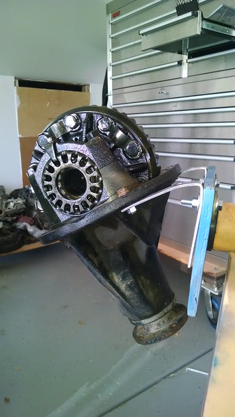

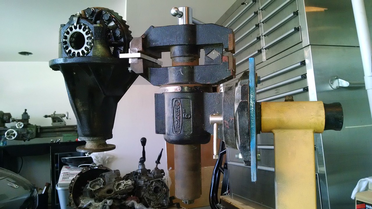

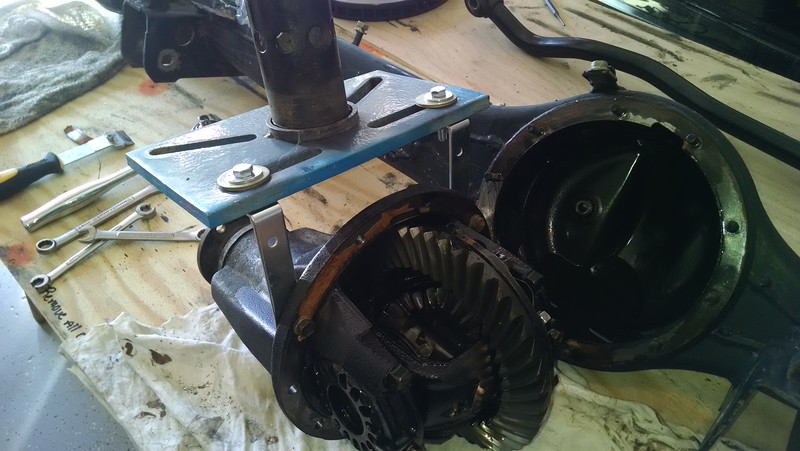

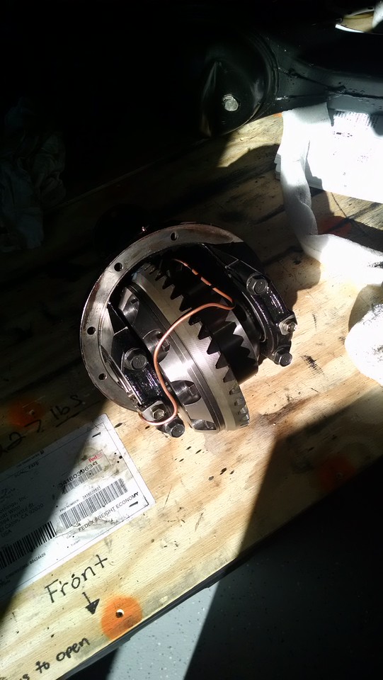

I build differentials in my big vise. But one day, I would like to have a steel bench mount.
