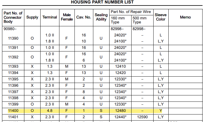

from the toyota wire harness repair guide:
it doesn't list a Male matching part, but i'm sure a Yazaki or Sumitomo number covers it. i just haven't found it yet.
update: is this it? Home » Shop » Connectors / Harnesses » Sumitomo » 1-way TS187 Connector Plug Kit For Toyota Starter Applications 90980-11400 - https://www.bmotorsports.com/shop/product_info.php/products_id/4322
FWIW, when the WHRM doesn't list a pair of connector housings, it's because the connected device, in this case the starter, is fitted with the mating connector, and the opposite side (that is listed) is used in only the one position. The other engine sensors (e.g., knock, temp, O2) are like this, too.
There would be OEM numbers for the mating connectors, but since Toyota never bought them, they didn't make it into the EPC. There's likely a cross listing, because Toyota would have had to give it to the the vendors supplying the "connected" parts, so they could get the other end from Sumitomo, or whoever, but that's in the bottom of someone's desk drawer, most likely. If it hasn't been round filed.

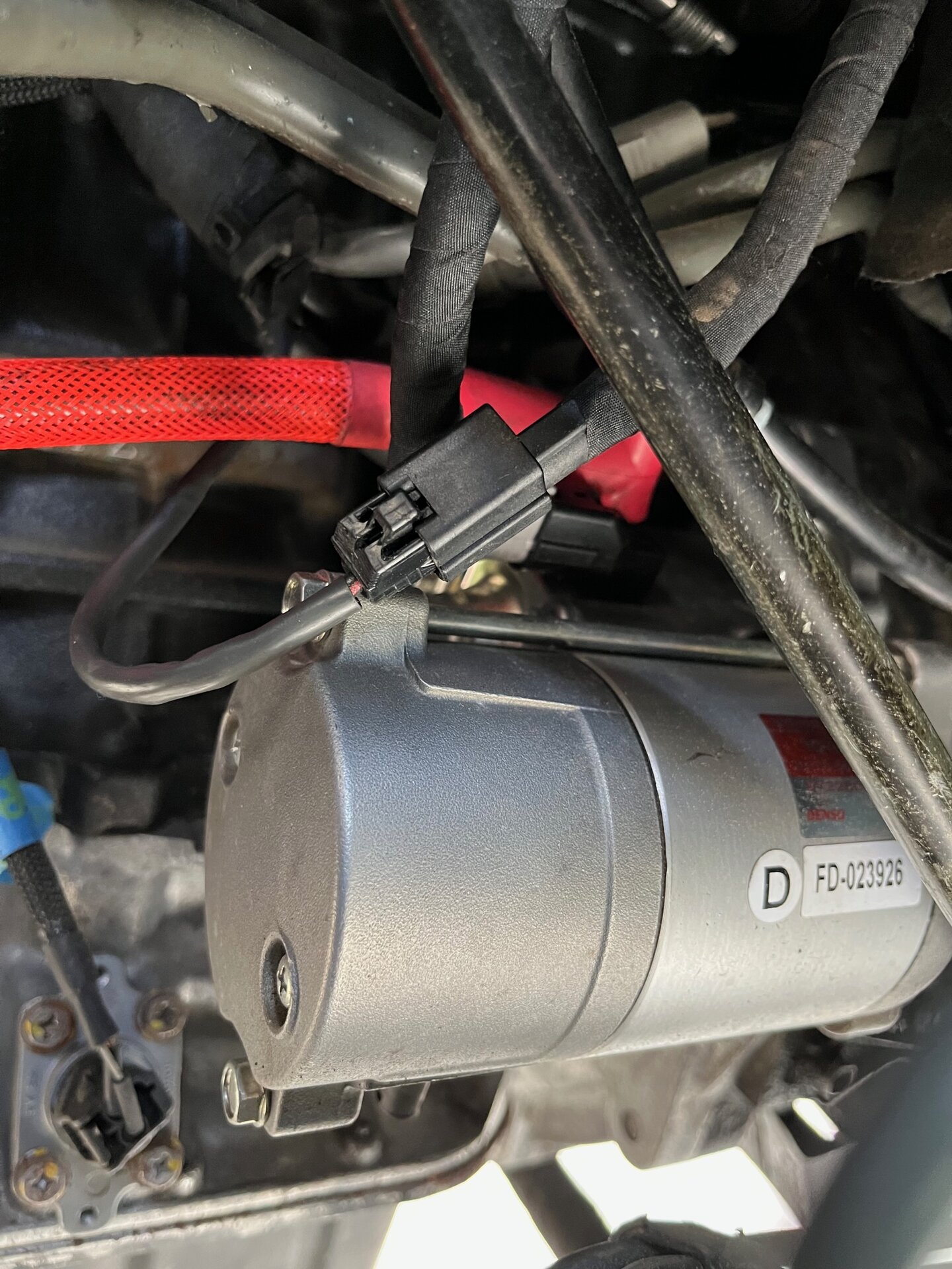

AND could be the terminal at the end of the wire into the solenoid. I just replaced the terminal at the end of the wire into the solenoid and the starter sounds stronger than ever. (I have replaced the ignition switch. I have not done anything to the wire from the ignition switch to the terminal.)

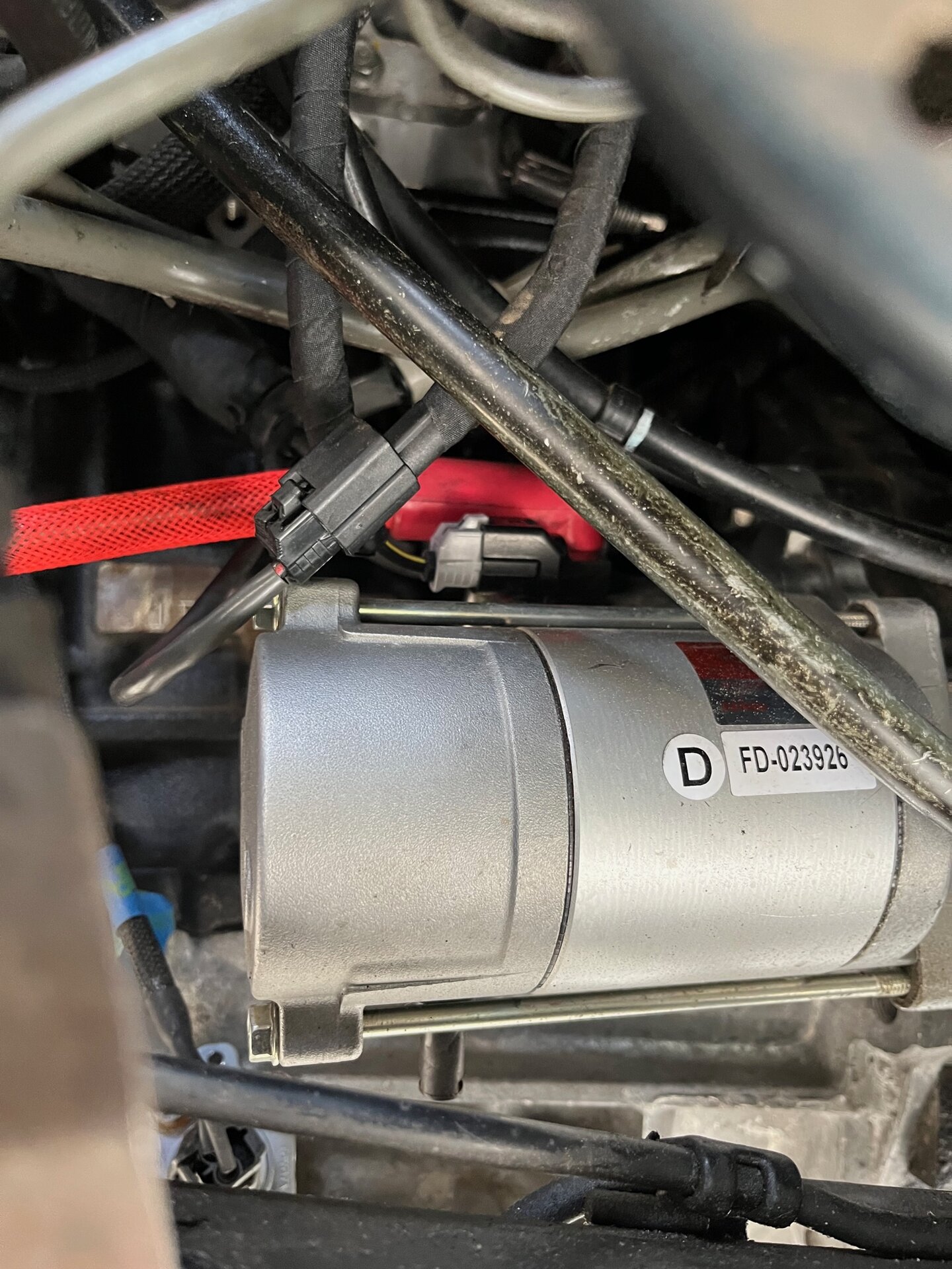

Easiest way to diagnose it is to make sure it's off and in Park, unplug the ignition wire at the starter (The little connector one) turn the key to "ON" then use a jumper wire that you can use to touch the positive side of the battery terminal and the starter solenoid connector. If it fires right up then the issue is that the starter isnt getting enough juice to crank.
Below is a jumper wire I use for testing and also a good backup in case something fails. I just used 6ft of 12AWG with an OEM starter connector on one side and generic terminal ring on the other. Plug into the start and with the key "ON" touch the battery and it should start.
A year later still starts solid.
Solenoid terminal with pigtail 82998-12480
Solenoid connector 90980-11400 (only needed if your latch is broken like mine was)
Has anyone else tried the $15 for these two parts before all the other stuff?
