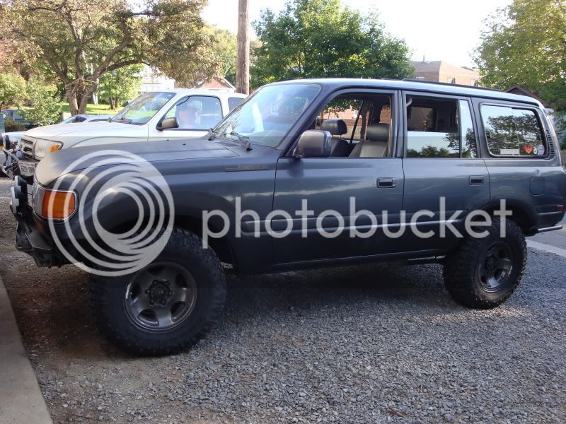

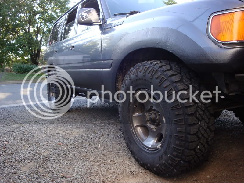

Got new meats on it today and thanks to, im guessing, Kerry (the man) I have a 285 spare. Thanks man, owe ya one.
The new tires ride awesome and my steering wheel vibe is gone. Goin for a rip now.....

Nice meats...guess you were tired of those old 265's eh!

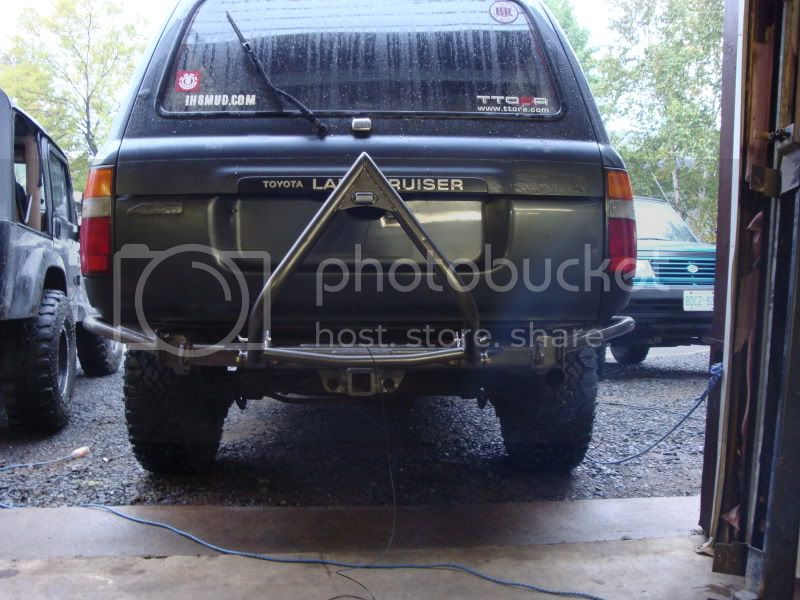

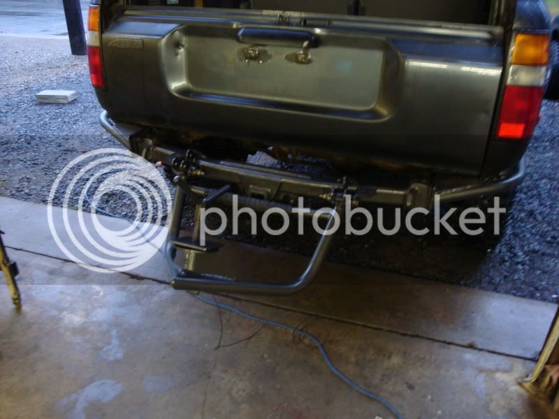

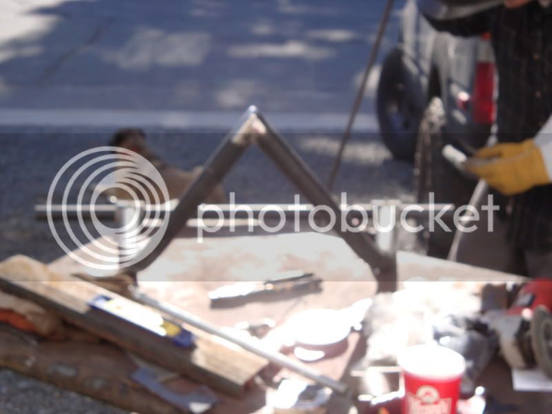

Im thinking about bumper mounted pivot points which would swing down instead of sideways. It would kind of look like a stinger on the rear but it would follow the rear tail gate and hatch lines.....if that makes any sense. I have the parts to do this so thats what inspired me.
D

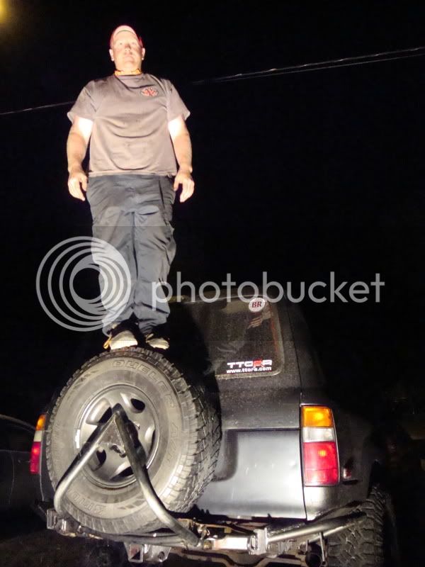

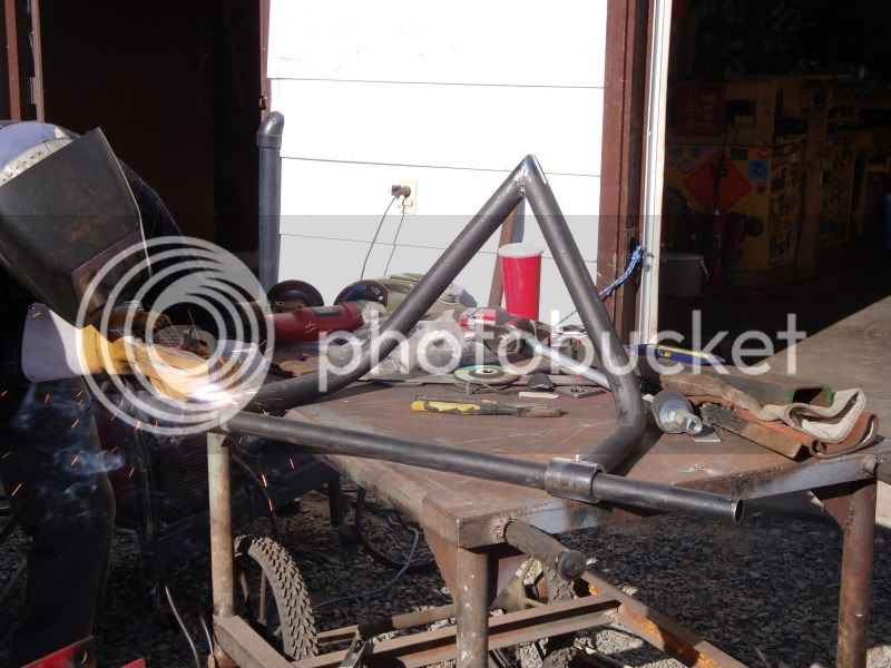

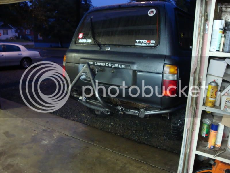

Did the rear stinger/tire carrier/evil spike today. Sam the welder man was key to the project and a big thanks goes out to that guy. Pete and stretch were here but were just in the way lol.

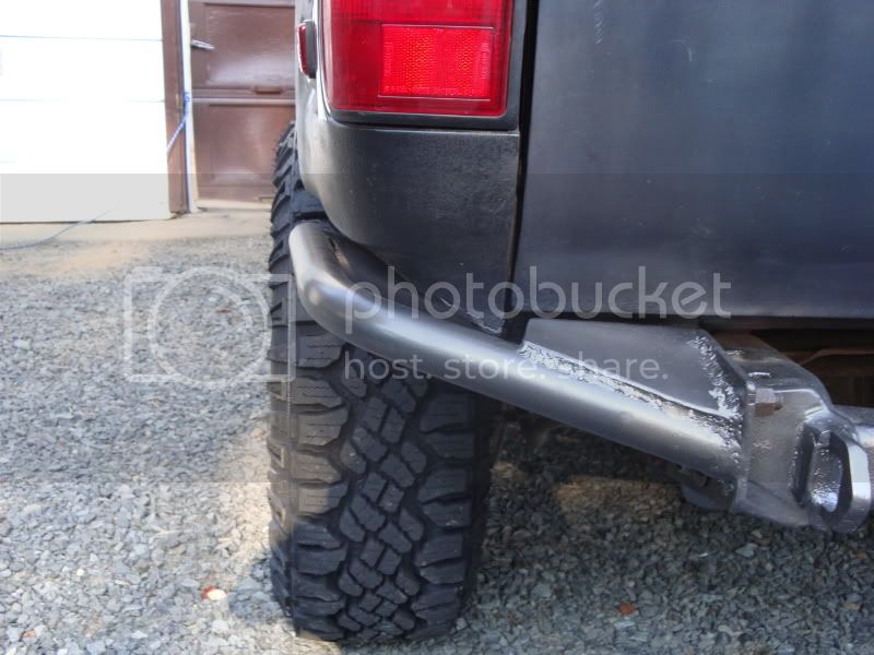

Anyways, its mounted to the mid section of the rear bumper and swings down. I can open the hatch and tail gate once its lowered with clearance to spare. 2 Receiver pins/side hold it in the up position via 6 tabs, 2/side on the carrier and one per side on the bumper. The tire is held on using a threaded rod which is welded to the back side of the evil triangle. The rod is sleeved with a piece of tube and capped with a beefy washer that lets the rod stick through. Theres a backing plate in there somewhere too. on the back side there is a 1/4" thick square plate that acts as a washer which is sinched down with a big assed nut with handles welded to it........
Hope that makes sense..
My 230lb ass on it. Thats what you look like after a day of fing around.

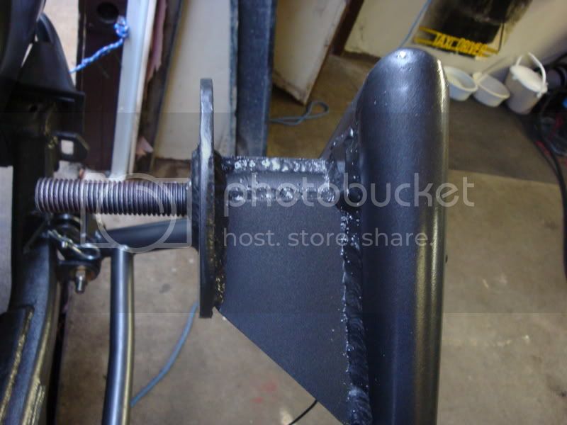

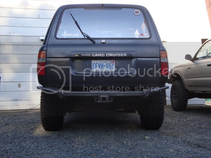

Finished er up today.
Gusseted the crap out of it and primed/ painted.

The van made it to ottawa with no problems. Tire carrier is rock solid and did not budge/rattle/shimmy one bit.
