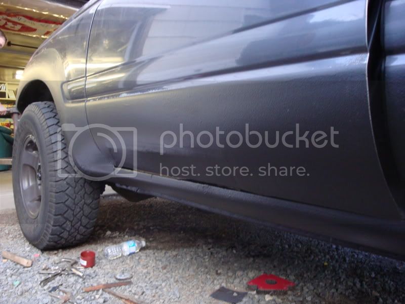

Well i managed to somewhat improve a huge rust blister on the ps rear door. Looks a little less like crap now. Did the bottom of the rear hatch and deleted the toyota emblem but kept the LC badge. There is also a small dent on the tailgate that got some lovin. Same as before, take down to steel, prime, bondo (satan invented that poop!!!), sand, bedline/paint. I kind of gave up on the bondo and it shows lol. No more rust and that was the main goal here.
Mounted the front plate to the bumper and removed one rear jump seat. Lubed ds door window.... I think thats it.
Before/during/after pics.

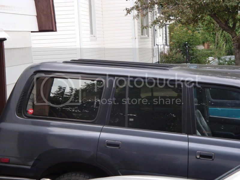

Well I started out wanting to remove the roof rack to repair the rust but ended up deleting it altogether. Two of the screws were stripped out, I proceeded to drill the heads off thinking that would do it. Nope the screws are frozen to the steel sleeves of the rack. By the time we got it off the tacks on the nuts in the roof were broken and the screws were cut.
F it, delete. I still have the ribs so I can go with a rack that clamps onto the gutters if its ever needed.
Not the best job in the world but it wont leak or rust....... for a while anyways lol.

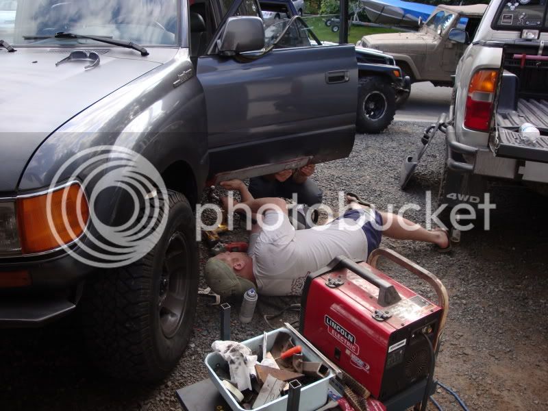

More of the same. 3 of 4 doors are done now, I left the drivers for last since itll be the biggest ass pain. Touched up the tailgate a little, did the ds rear door sill, did a couple spots around the rear sliding windows.......
This body work s***'s gettin old, I want to do a rear bumper and sliders! Maybe a skid...... Some 1.5" stock just fell into my lap (along w some 1/8, 3/16, and 1/4" lol), just a little piece, but now I have something to make recovery pts for this proposed rear bumper

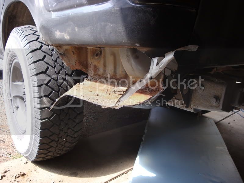

Did the ds door and it turned out to be a hornets nest. Holes everywhere. Had to patch it and redo the inner part of the door as well. Turned out ok. At least its not a fist sized orange abyss.
WTF??

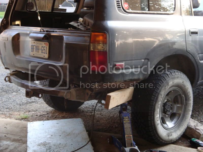

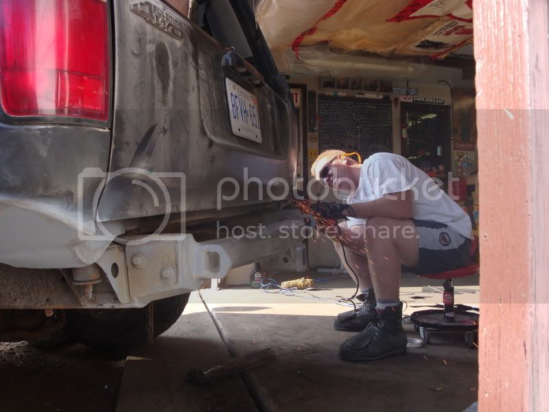

Well, got up too late to go wheeling with any of the 10 groups goin out today so I hacked at the cruiser some more. Yes pete stopped by for a bit. Yes by hacked I mean hacked and theres more hacking to be done.
Cut off the oe hitch, cut off the oe x member/rear bumper, hacked about 3 inches off the frame, relocated the reciever to frame level, bolted it all in for now. I plan to incorporate some kind of tow hooks at the frame horns, and do some kind of wrap around corners. Oh and Im looking in to cutting the rear 1/4's up at the tape line in one of the pics.
weeeeeeeeeeee!
The dog posing. What a whore.
Planning on welding the tow hitch to the frame then making bolt on wings if all goes according to the "plan".
Feel free to critique.

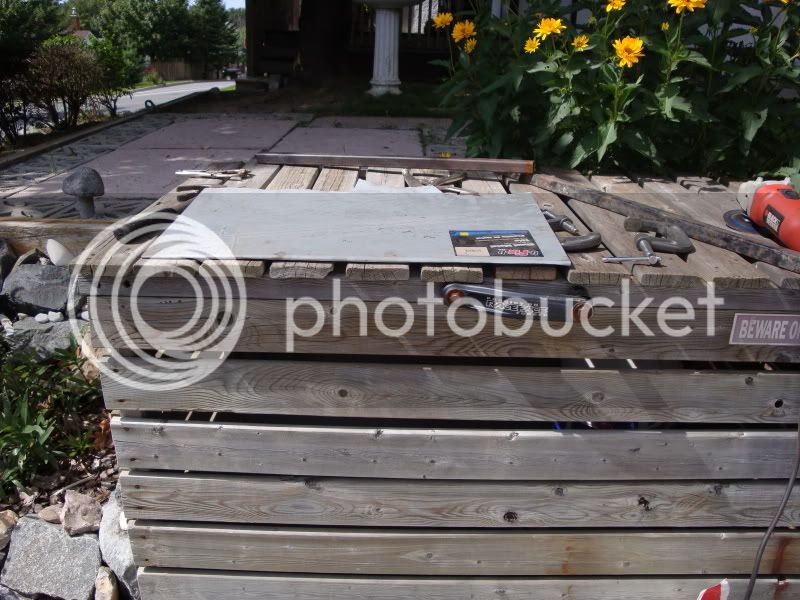

Cut the outer panel w a grinder then did the rest w the plasma. I used 1/8 to plate.

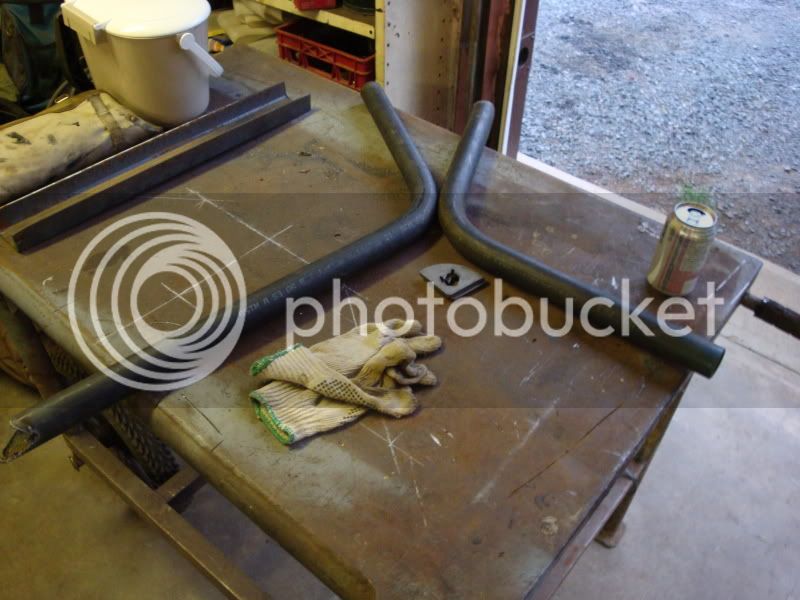

Finished the tube wings yesterday.
They fit ok and best of all are simple to bolt on/off with 5 bolts/side. I had to notch the ps strut due to the shoddy 1/4 chop I did last weekend. It was off just enough that the strut hit the bottom of the 1/4. I have an inch of room now with the notch.
Im still thinking of running a plate about 6" tall from the struts, along the main tube, to the rear bend. Opinions?
Id also like to eventually add some side protection using smaller dia tube but due to laziness its staying like this for now....
Half assed but I like it.........
