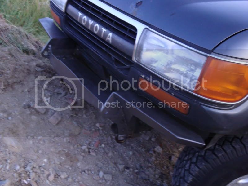

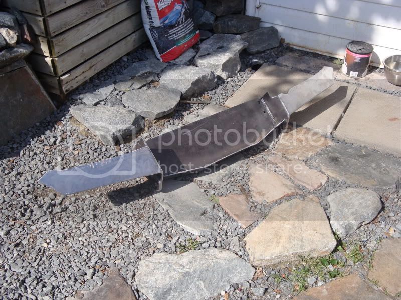

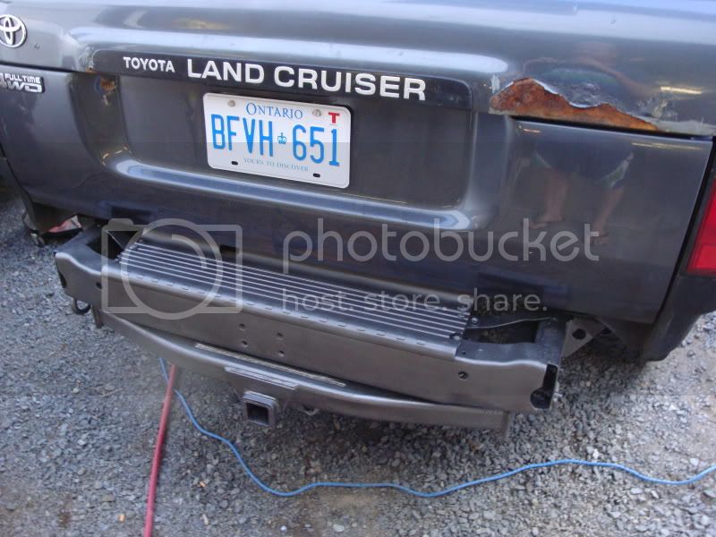

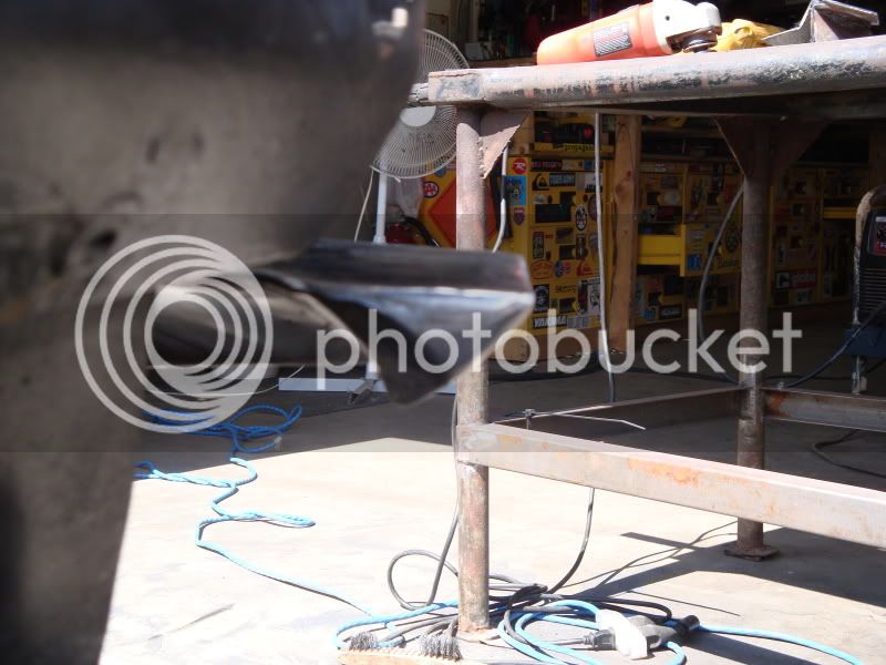

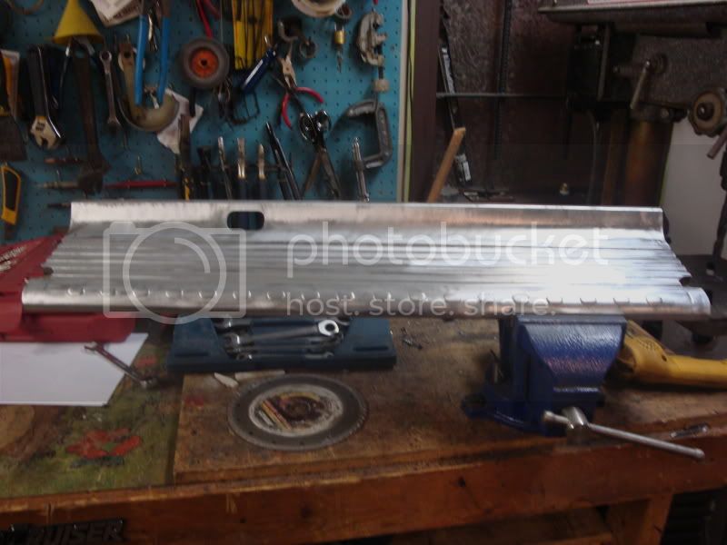

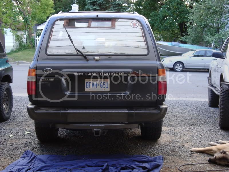

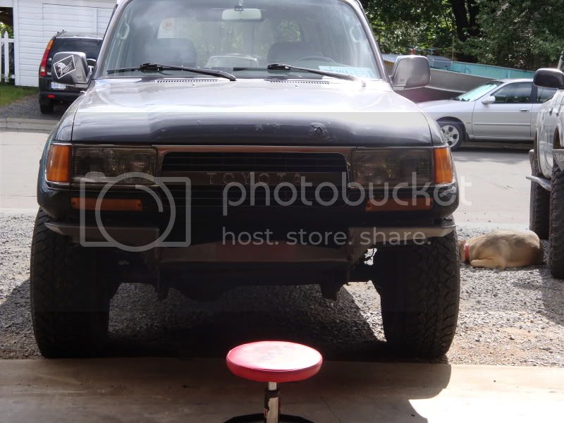

Well finished er up today and I must say I really like the way it looks. Glad I took the time to buff it out before primer and paint. Just need Sam to bend me up a lil piece of tube in his spare time to connect the 2 sides of the winch box and act as a little stinger/light mount like the taco has.
The front of the van doesn't look so welfare now and all I paid for is cutting/grinding discs and wire.

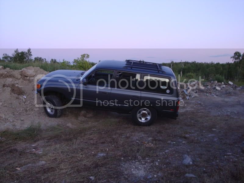

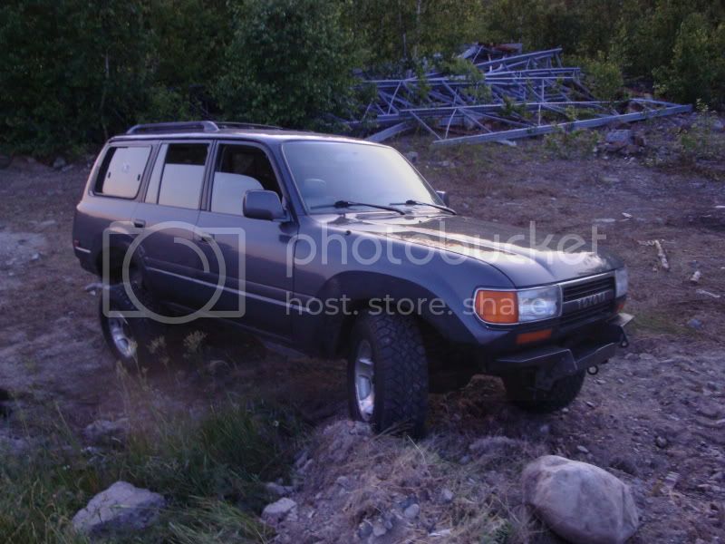

Oh yeah, did the poser flex thing and tried out the low gear. Lifted the rear no spinnage.
I really really like this thing man.

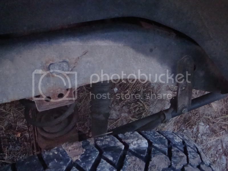

Actually my bolts turned out to be 12mm...... I had a buddy at the nut/bolt store come out and measure, sure enough a 12mm fit prefectly. Again these are the 4 bolts, 2 on the top of each frame horn.

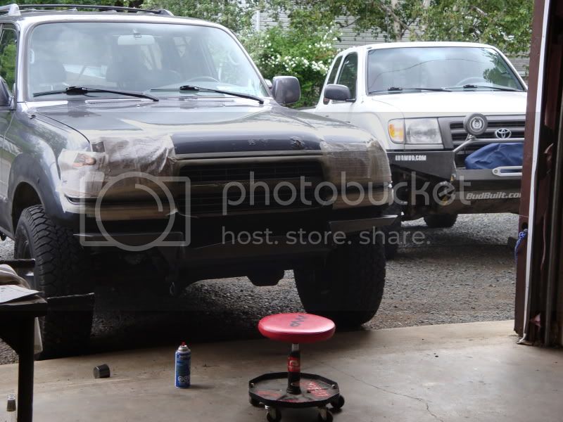

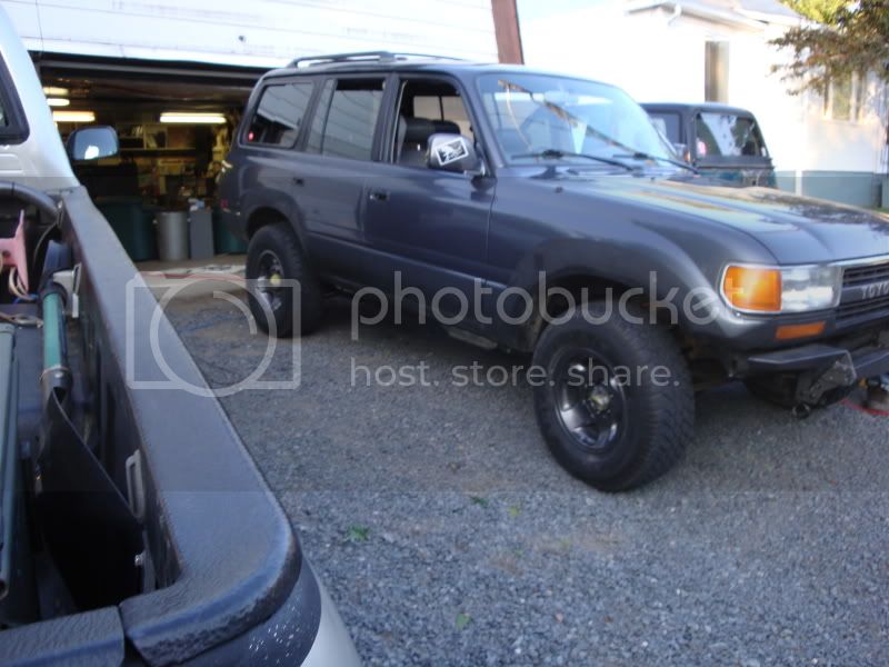

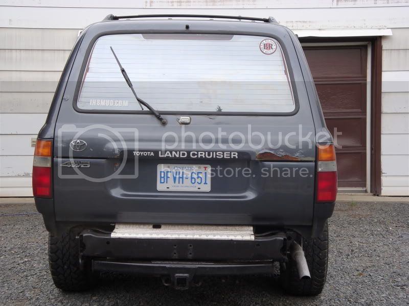

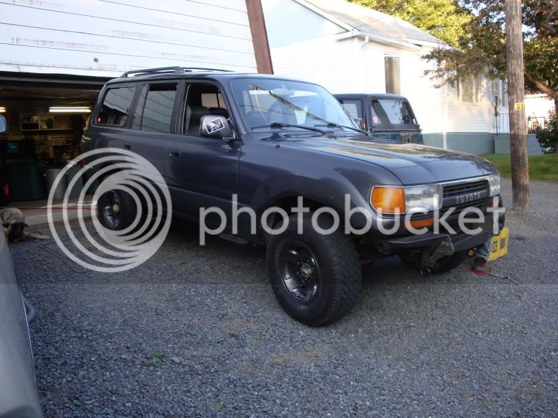

Spruced it up a lil more today.
Painted the wheelchair load out on the back if the bus. Pete stopped in and I put the bastard to work scuffing up the rims. Primer, paint, and clear. They look like new rims. Also cut the huge assed tail pipe down a little, it sounds deeper now at idle.
Got a new rear diff breather fitting and ran it to the engine bay beside the one for the front axle.
I think thats it for today.

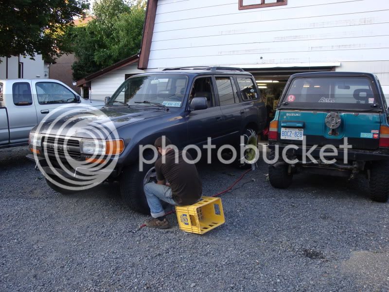

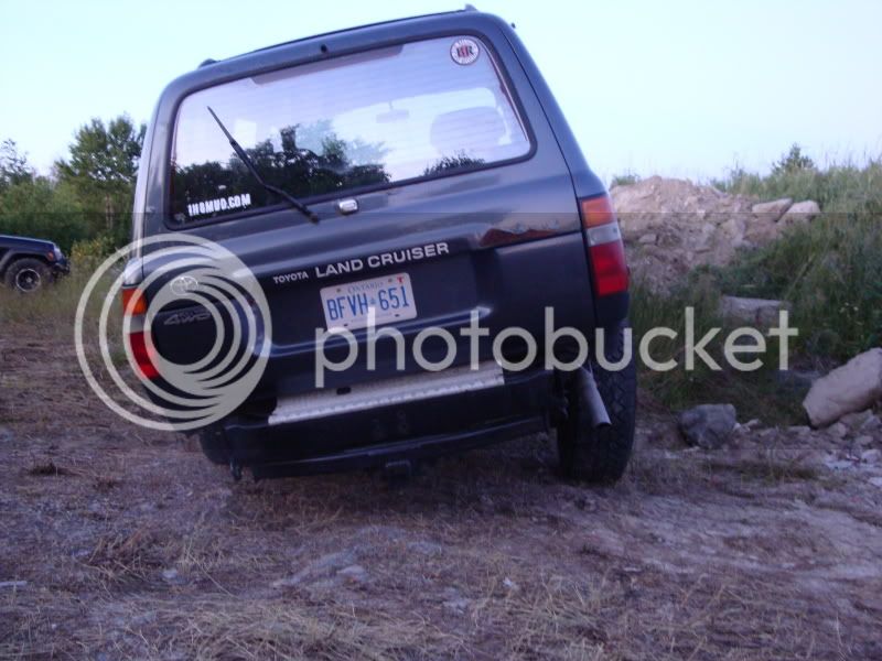

Well played hockey today and ended up messin w the LC afterward.
Masked and painted the front grille, fixed the rear hatch handle, fixed the glove box, and put on the stock rear bumper plastic till I figure out whats gonna happen back there.

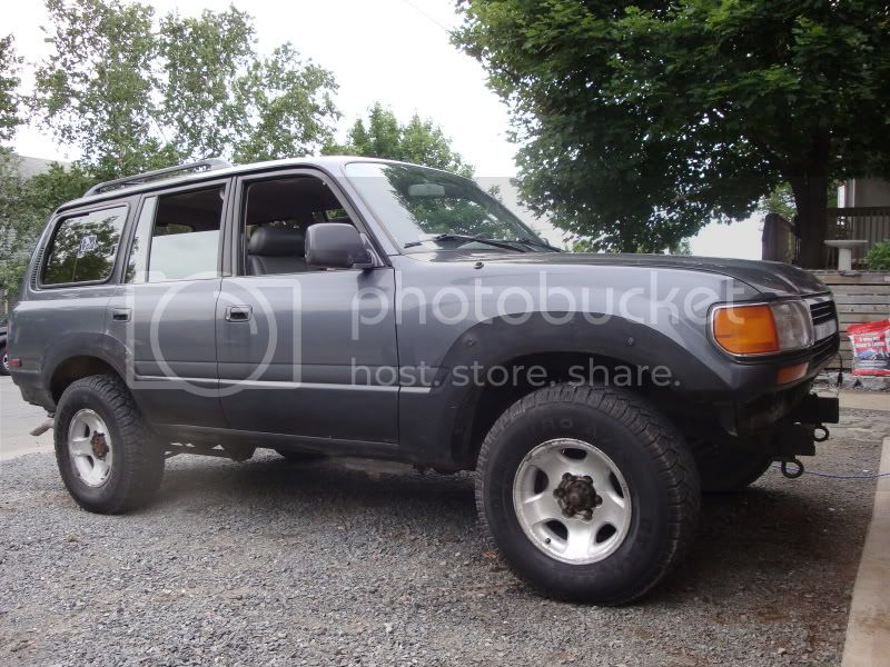

Before and after. Little more respectable now.
