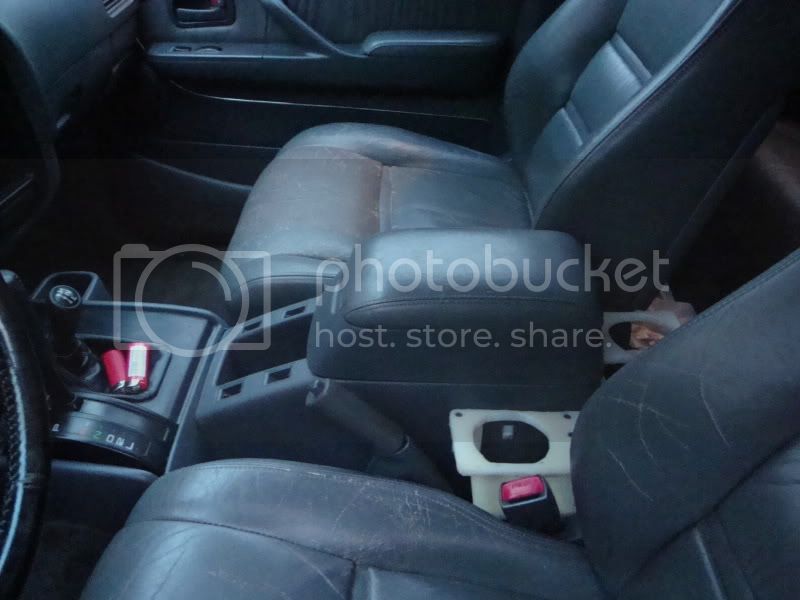

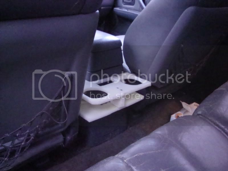

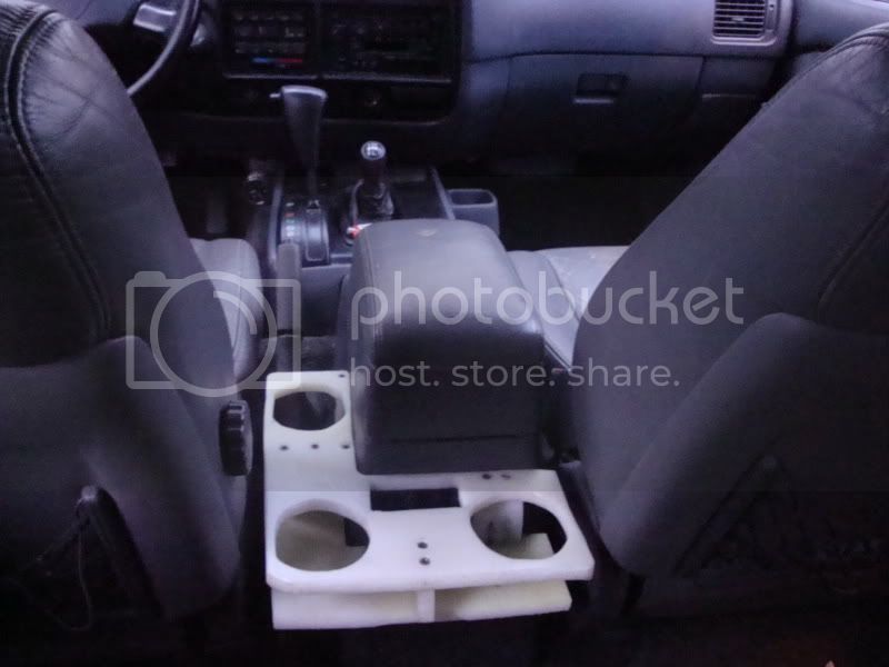

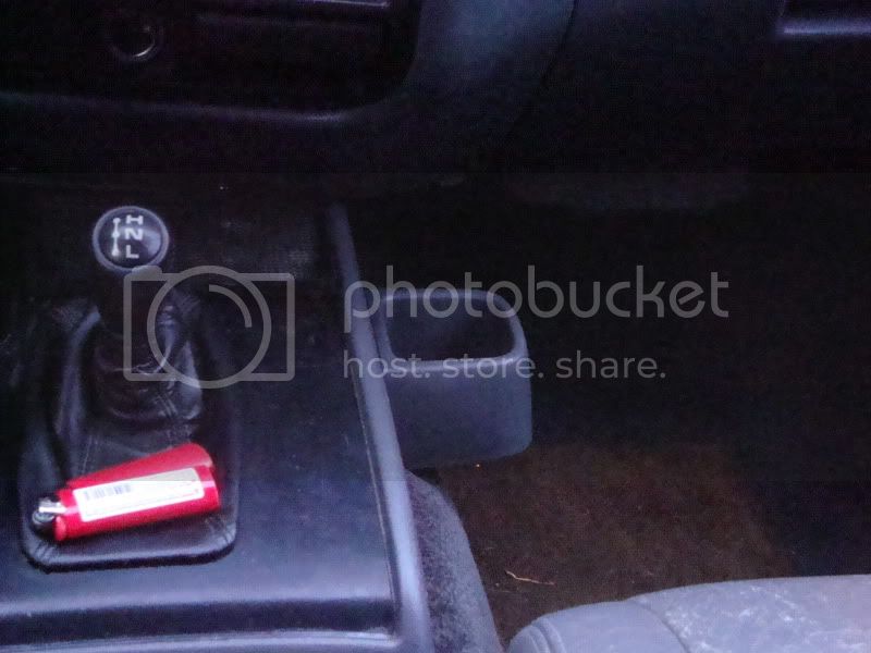

Dealt with the lack of cup holders today. Moved the drivers side one to the pass side and hacked, i mean hacked, together this monstrosity.
I made a bracket for the front one out of the white plastic and used the metal bracket on the drivers side it previously occupied to attach the rear holder. Its sturdy as hell and I had all materials in the garage.
I really do have to clean it up a bit one day........... or just sticker the crap out of it.

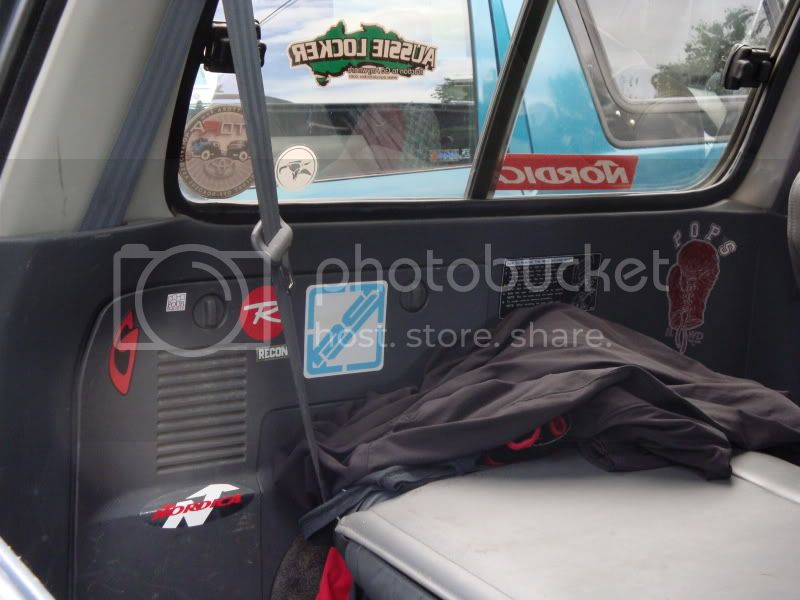

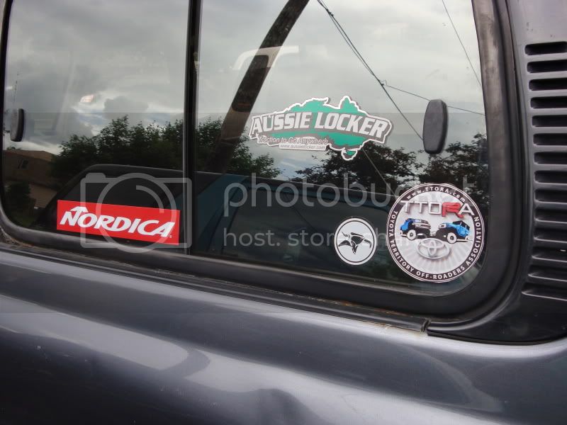

Added some badges to the fenders, painted the ones on the hatch and gate, and stickered the crap out of it. Gonna be a ski wagon soon enough lol.
I really have to get to the body work soon. Its been raining off and on all week and the damn thing is to tall for the garage........

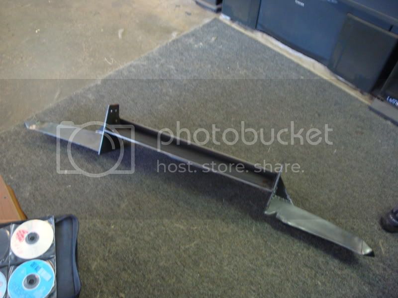

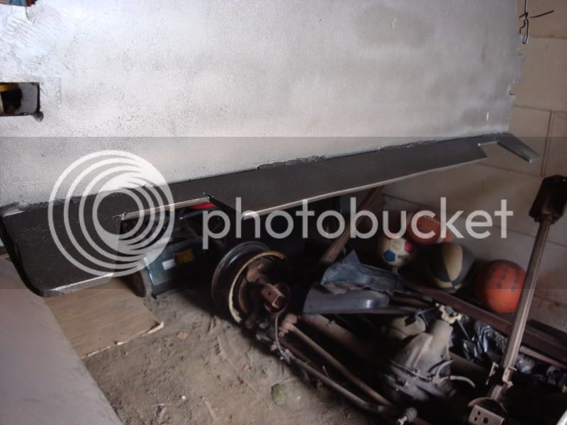

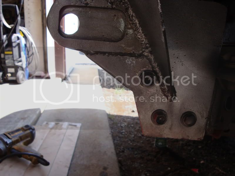

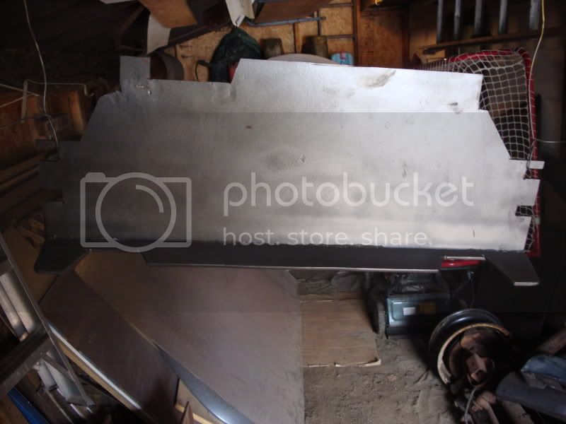

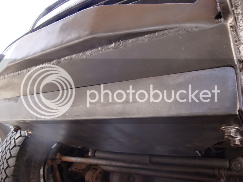

Made the front skid today. Its pretty, 1/4" hardened steel pretty lol. Lifted the front of the 3 ton 80 w it and it did not bend. Thats without the angled piece welded in....
Should do for gettin in and out of the driveway this winter.
Cut the frame flush.
Templated it up.
Cut/weld (Army Steve stopped by). Couldn't drill the hardened w/o killing all my bits so I just slotted it and used nice thick washers.
Grind, paint and bolt on.
Voila
D

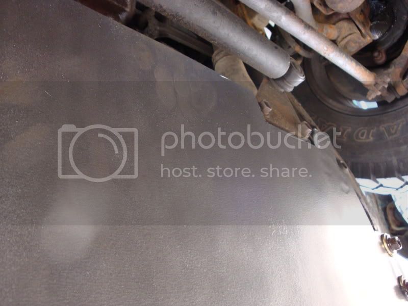

Watch for power steering over-heating. You just cut the air flow to the cooler off.
Really? Im guessing your referring to the two lines under the rad? If so I'll have to speed hole it up a little. Has to wait till I get the plasma back though, this crap is too hard for a hole saw. There is still a good 2" gap at the end of the winch plate in front of the rad and you can see said lines so I'm thinking air can still circulate........
Maybe some hilift holes in the front, hmmmmmm.
Thanks for the heads up.
D
Yup, the big "paperclip" thingy is the PS cooler.
Gotcha. Speed hilift holes it is. I dont really drive much so it can wait a couple days.
Thanks again.
D
I took Dan's advice and cut out a portion of my skid so air could get to the ps cooler. Makes it look better too.

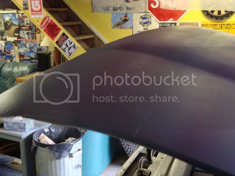

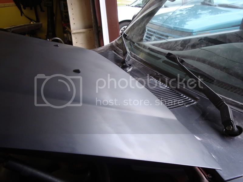

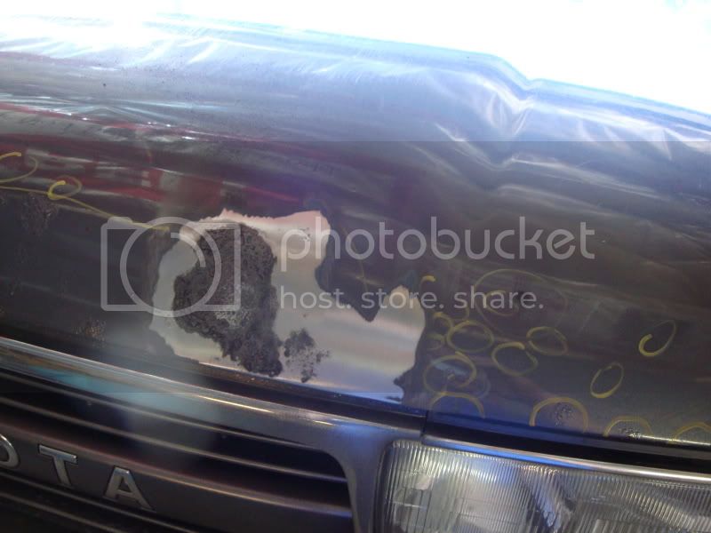

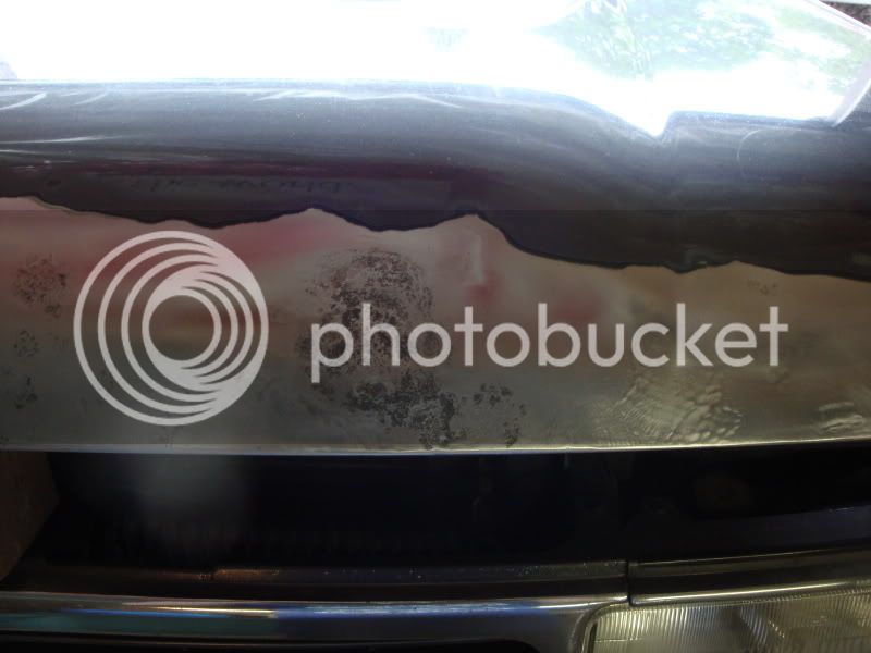

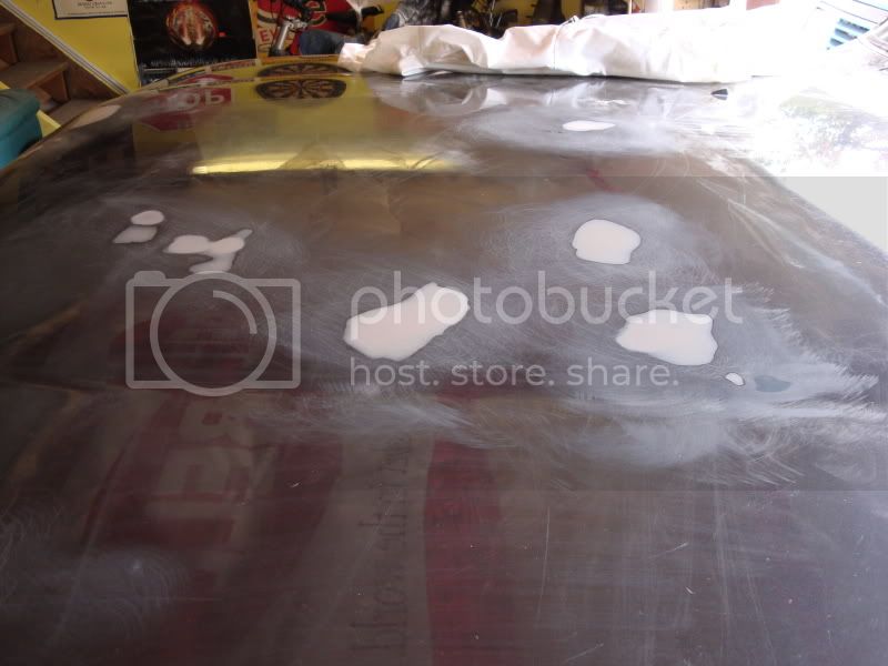

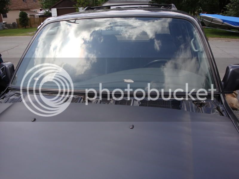

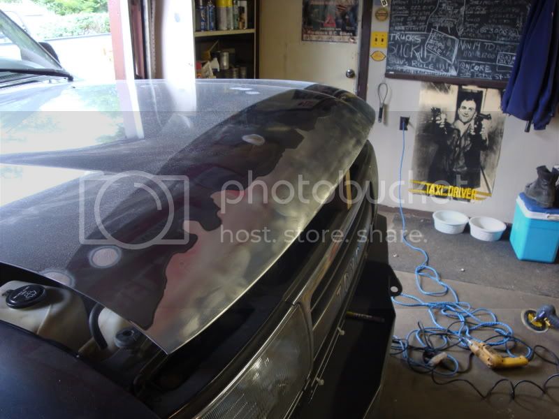

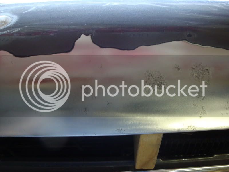

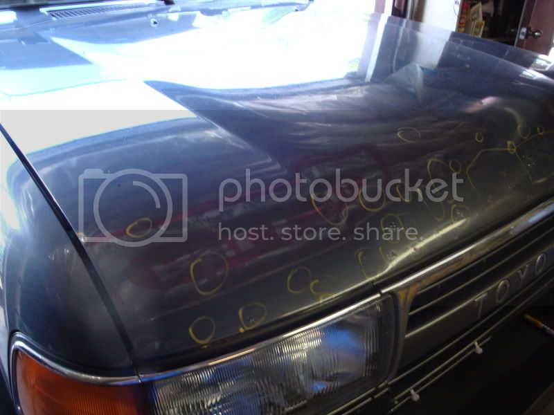

Messed around w the hood today. I took it down to bare steel wherever there was a rust bubble then applied a thin coat of bondo, sanded for about 25 hrs, primed, rockerguardeded, and painted.
Turned out half assed. F'ed up in a couple spots but now I know what to do next time. I still have to do the clear but am going to wait till a get a few more panels done.
Circled all the bubbles.
The worst spot.
Bare steel.
Bondo.
Primer.
Rocker guarded the nose and painted it all.
Looks like
up close but stand 5 feet away its decent lol.

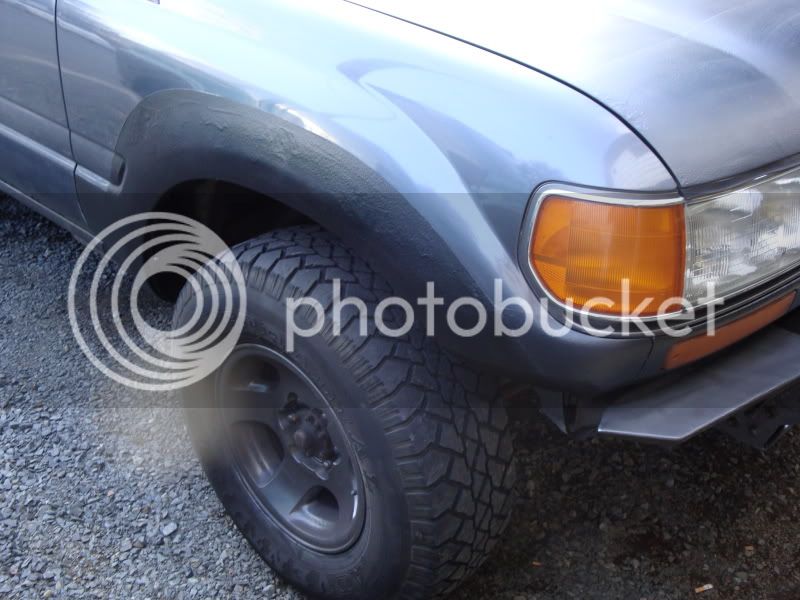

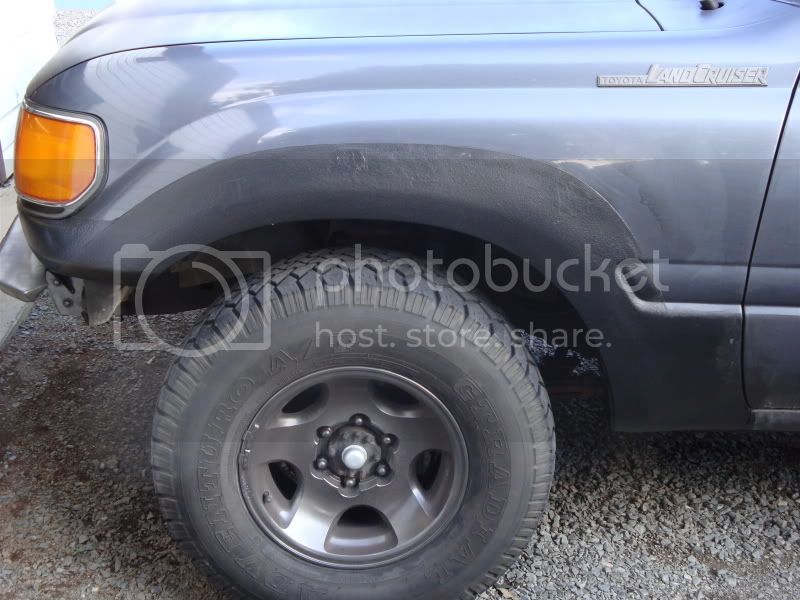

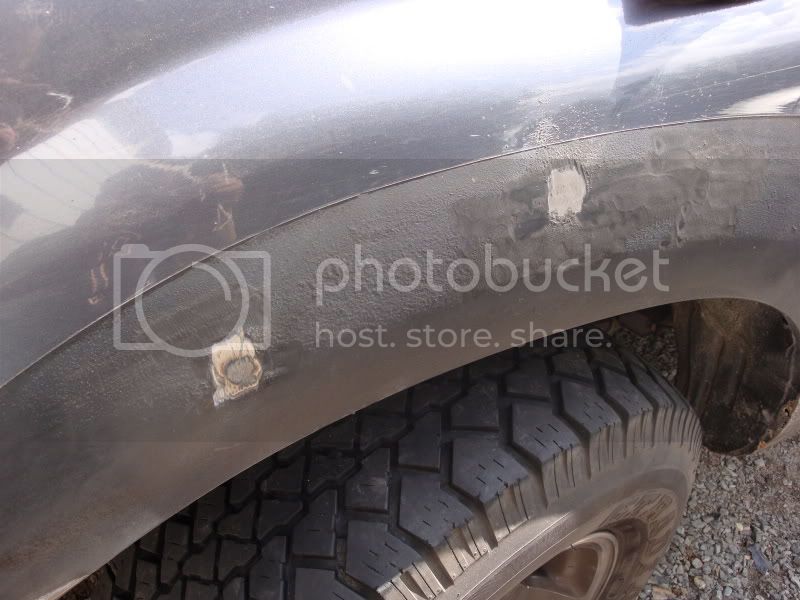

I have to decide what to do about a couple things now. One is the fender flare mount holes. The p/o covered them w tape then rocker guarded them. It seems to have held up ok but id like to do something a little more permanent since the flares will never go back on there. I could go all out and weld them up but that seems like a pain although it would be best.

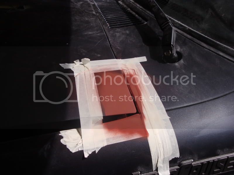

Oh, I managed to fix the rust and paint the cowl between the hood and windshield before leaving friday. I'm considering working on a couple other areas today if hockey falls through.

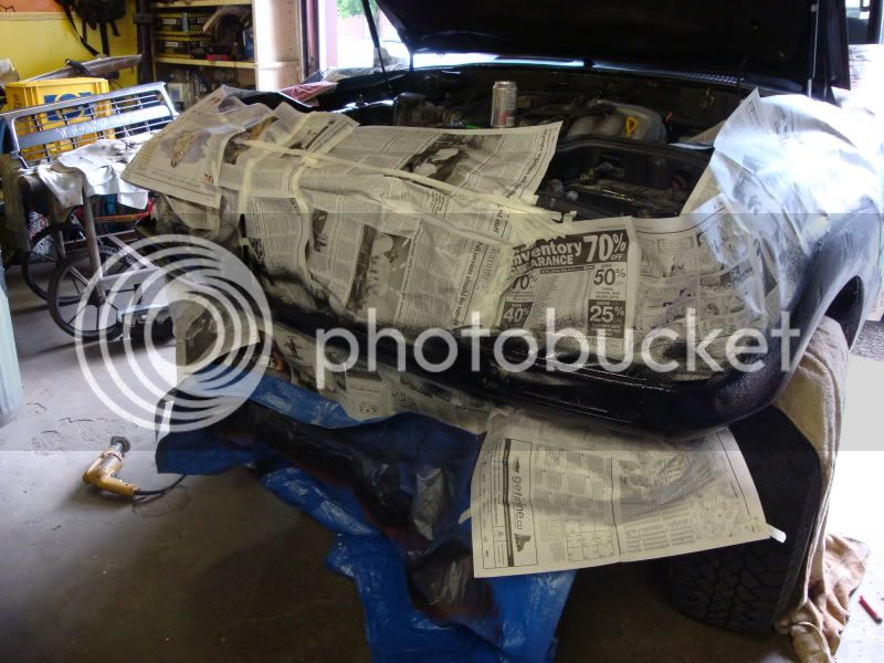

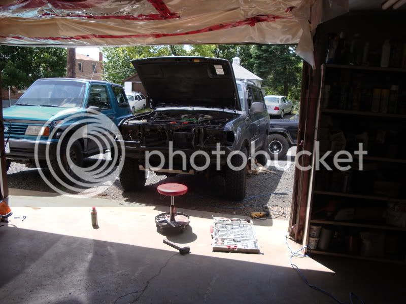

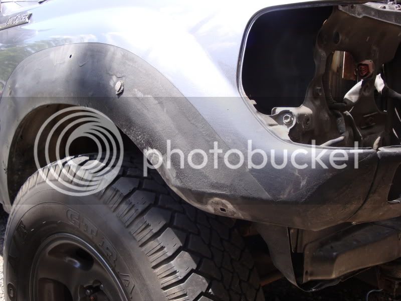

Well Pete came over and motivated me do dig into the body work again.
We ripped off the bumper, lights, signals, grille and markers so we could get at the sheet metal under the grille. This area was prepped while I welded the flare holes shut. We dealt w all the wheel well rust as well. Primer, rocker guard, paint (under the grille and lights) and another half assed job is off the list.
Cowl work from friday
Couple shots of the bumper while it was off
Hack job in progress
Before
After

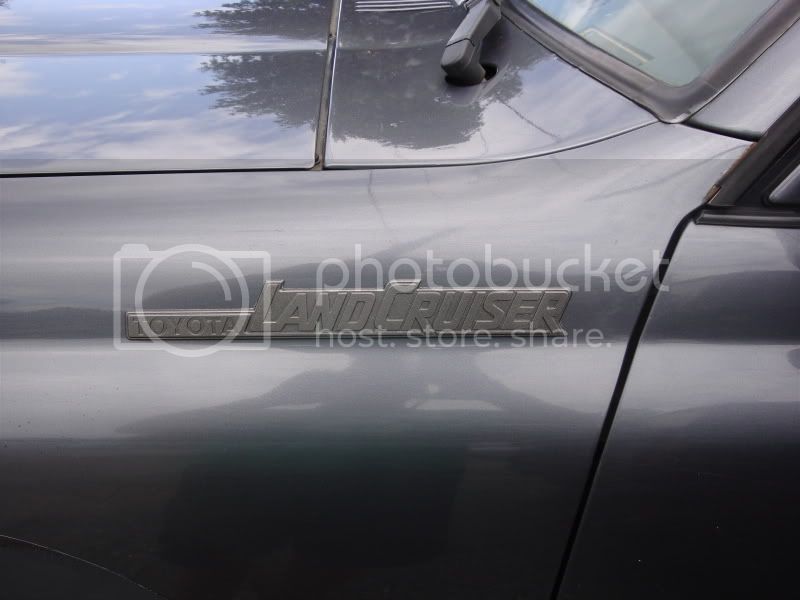

Well i managed to somewhat improve a huge rust blister on the ps rear door. Looks a little less like crap now. Did the bottom of the rear hatch and deleted the toyota emblem but kept the LC badge. There is also a small dent on the tailgate that got some lovin. Same as before, take down to steel, prime, bondo (satan invented that poop!!!), sand, bedline/paint. I kind of gave up on the bondo and it shows lol. No more rust and that was the main goal here.
Mounted the front plate to the bumper and removed one rear jump seat. Lubed ds door window.... I think thats it.
Before/during/after pics.
