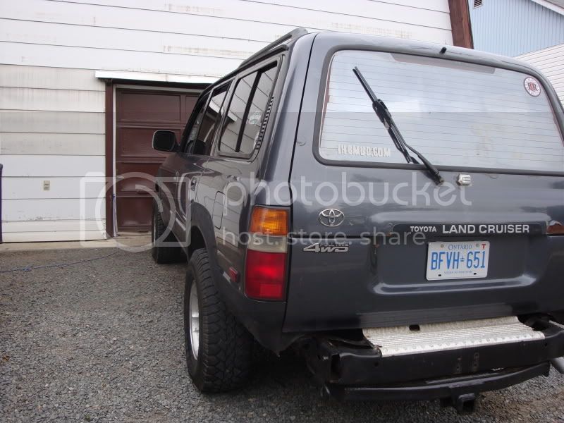

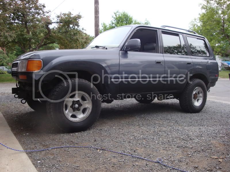

93 FZJ80 LC. New shocks, brakes, birfs, top end of motor redone last year, 231xxxkm, 4.5 inline 6, seats 7 adults or 19 midgets, full float rear axle, discs all round............rust..........old leather... no elockers but its got an aussie in the rear and the center diff lock.
All in all its surprisingly sturdy and rattle free on the road. It drives straight although I do get vibes around 80km/h. Going to get the tires balanced sometime soon.
Plans so far are to get rid of as much of the rust as I can, find a windshield, and give it a paint job of some sort. I need a new diff breather fitting for the rear axle as the one on there is sheared off, gonna search for that pt#. I also need to search to see if I can get my 15" taco steelies w winter tires on there somehow. Maybe grinding the caliper will work........... Lots of fun. I have some steel so I might fab up a front bumper eventually seeing as though it doesnt have one.

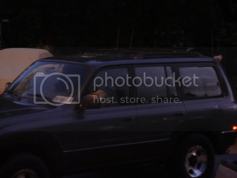

we loaded up the bus last night before our super extreme hack session. the rearmost seat is being shared by pete #1 who is 6'4" and pete #2 who is........ shorter.
busses are cool. not as cool as tacos but close.

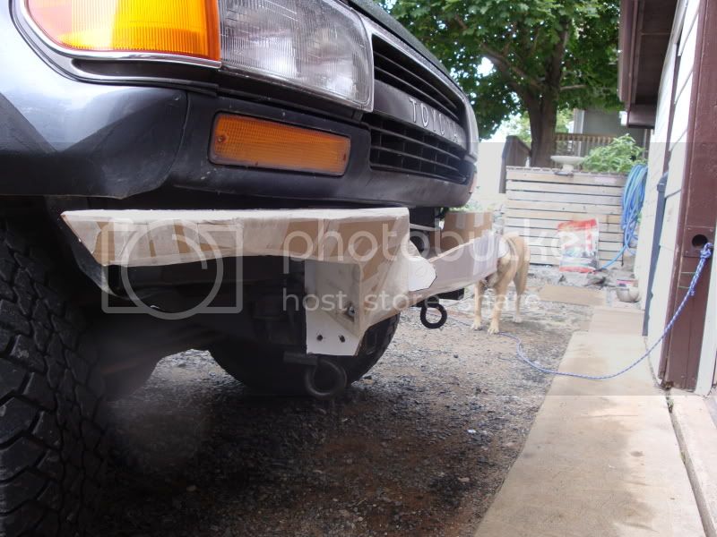

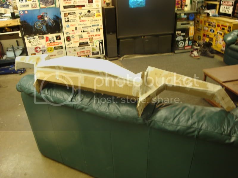

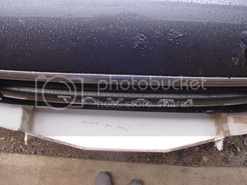

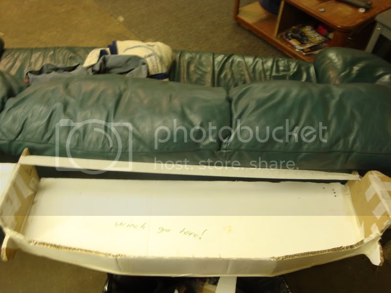

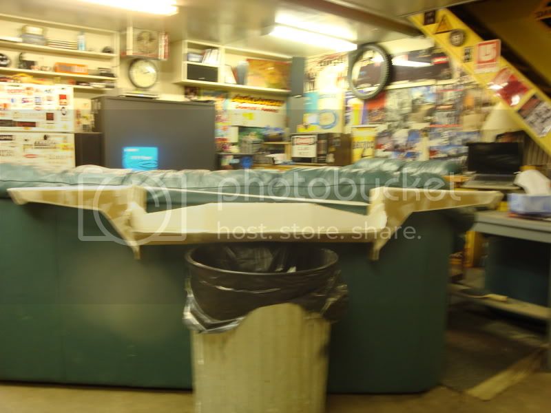

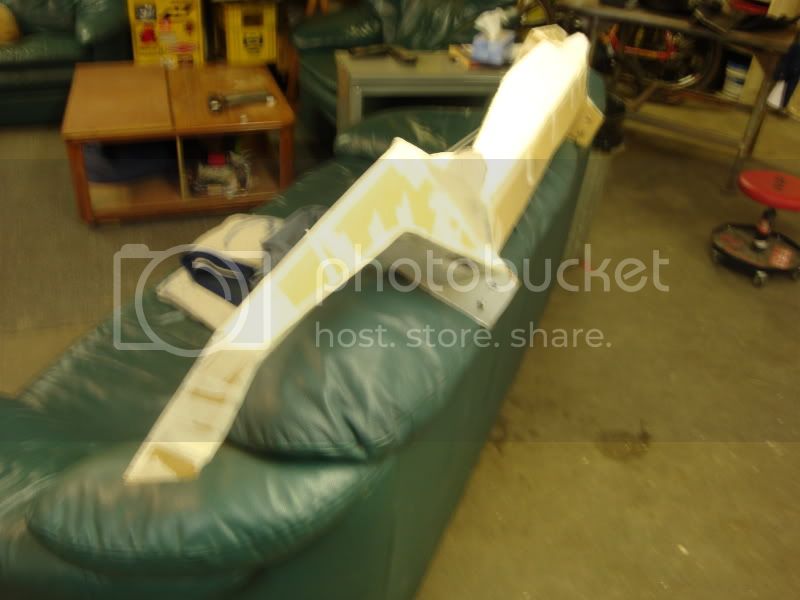

Made a fake bumper today to get an idea of what it will look like..........with one. This is just the first draft but i like it.

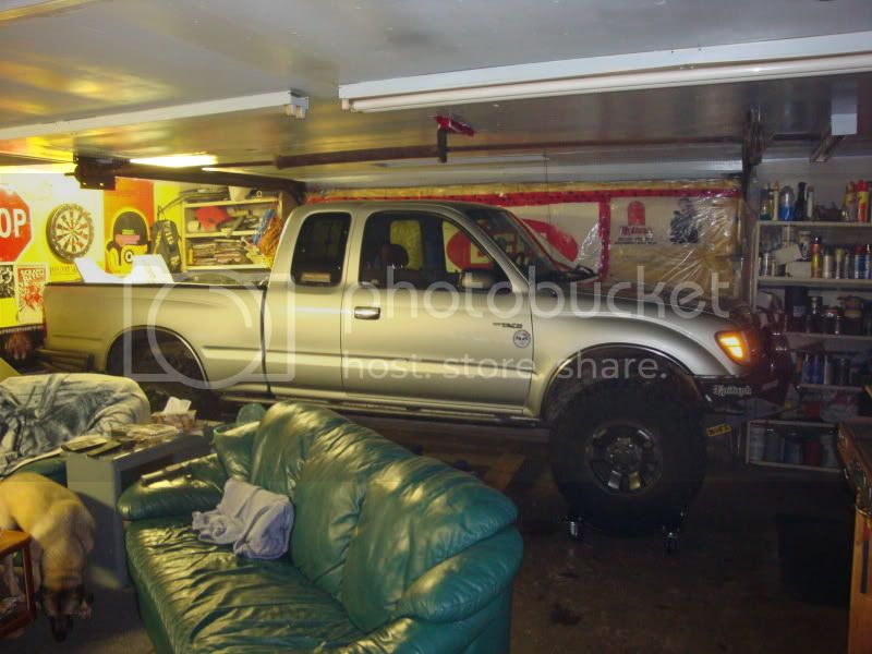

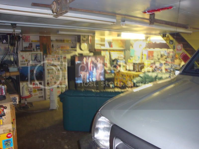

Thats my garage in the pics. Its set up with couches/tv/stereo/intrabox and makes for a cool place to chill out. Especially when you have messy bastard friends who spill beer and such. They dont even step foot in the house.
When i want to pull my truck in (not the van cause its too ginormous) i just move stuff around a bit and it reverts back to being a garage. The only bad thing is i spend way too much time in here........oh and theres no bathroom, that too.
Theres a sweet loft upstairs that provides lots of storage room and partially makes up for the "lack" of head room downstairs.

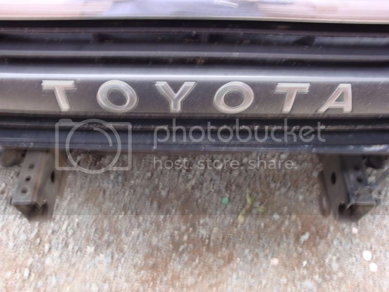

On a completely different note, does anyone know wheat size bolts (size, thread and pitch) fit into the top of the frame horns at the front of the 80? There are 2 holes at the top of each horn that have nuts welded inside the frame that id like to use for the bumper. Using the 3 holes on the outside of the frame, the 2 tow hook mount bolts on the bottom and said top bolts would make 12 - 14 mount points and would be plenty strong.

They are 14mm and any 14mm bolt should fit!

i used 12 of the 14 holes on my front bumper, the size is 10x1.25. like your bumper design, nice low profile/good approach. fibreglass over the cardboard and run it!

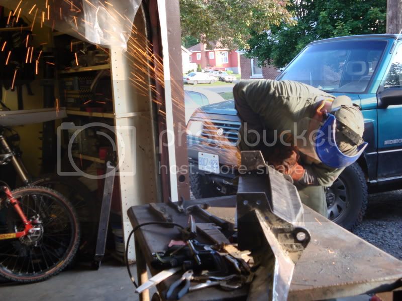

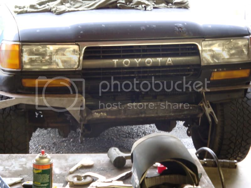

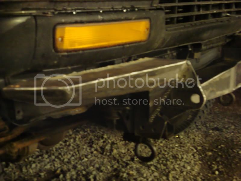

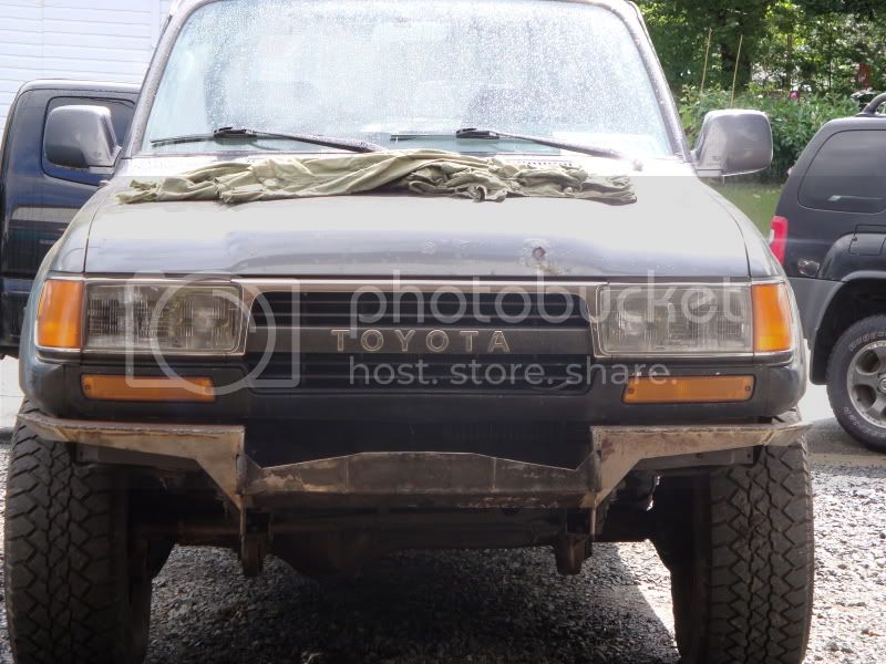

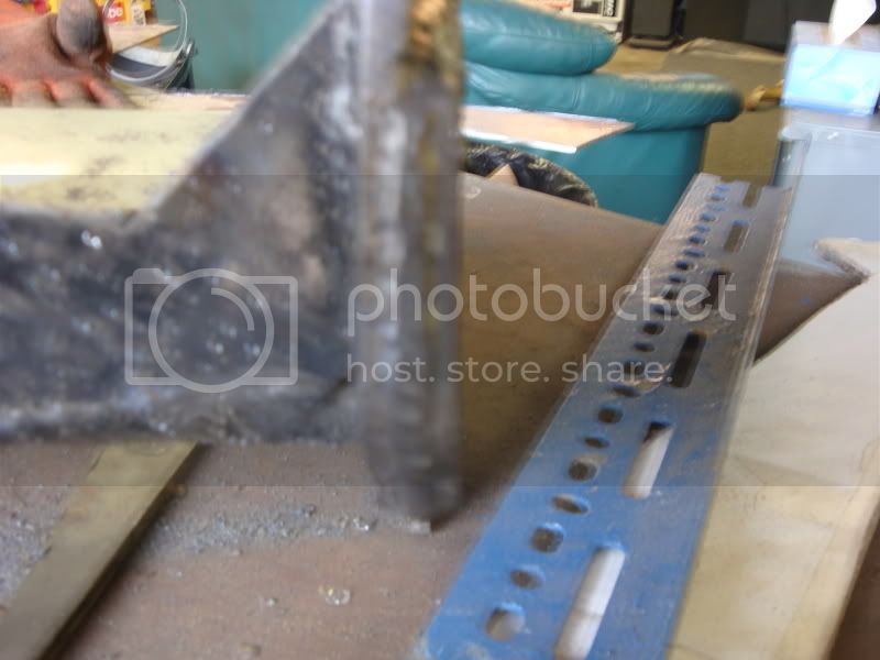

More bumper.
Its turning out ok, end is in sight. 4 more little pieces to cut and weld then more grinding.....
D
Looks pretty cool. I'd put a brace from the wing to the main body on the bumper though. Extra support, ya know?
Kinda like this:
meh, the brace would interfere with those low shopping carts and id het hung up.
dont worry, shes boxed now and a gusset or 2 are going in.
