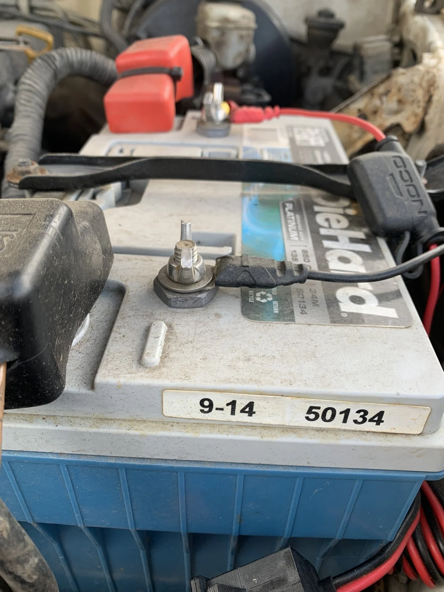

After 7yrs my battery finally died with no recovery. Is this battery still the best solution or are there better options out there?
I’m gonna look in my manual since I can’t find info online, but curious if I should stick with the same CCA and RC of this one. Worked good for years, but without any real accessories and now I’m adding a winch and some minor lights.
Finally settled on a battery after looking at about three options this was the best fit overall. Fires right up instantly, which leads me to believe the other one was going bad for some time.

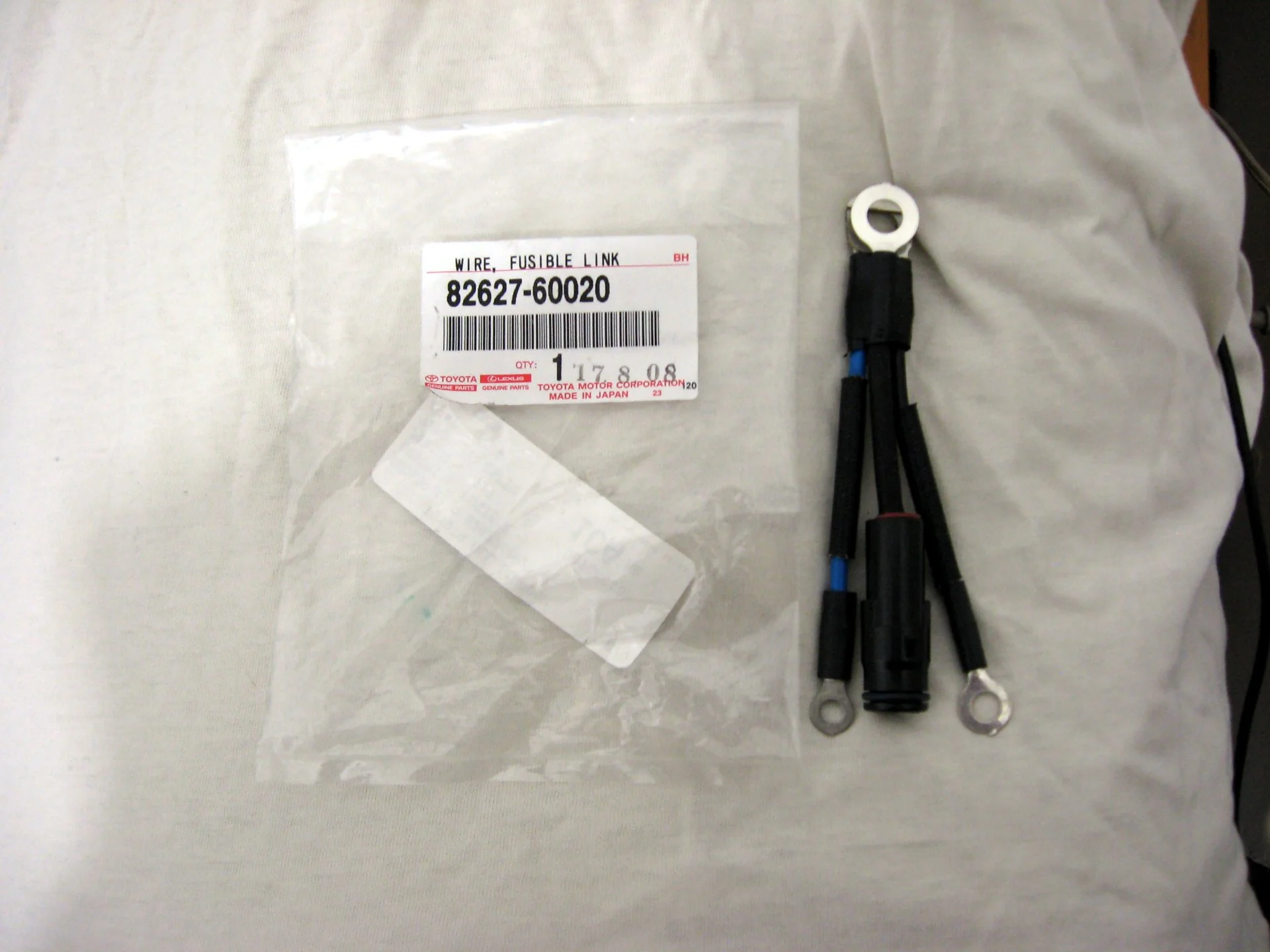

Hello,
This may seem obvious but I will mention it anyway.

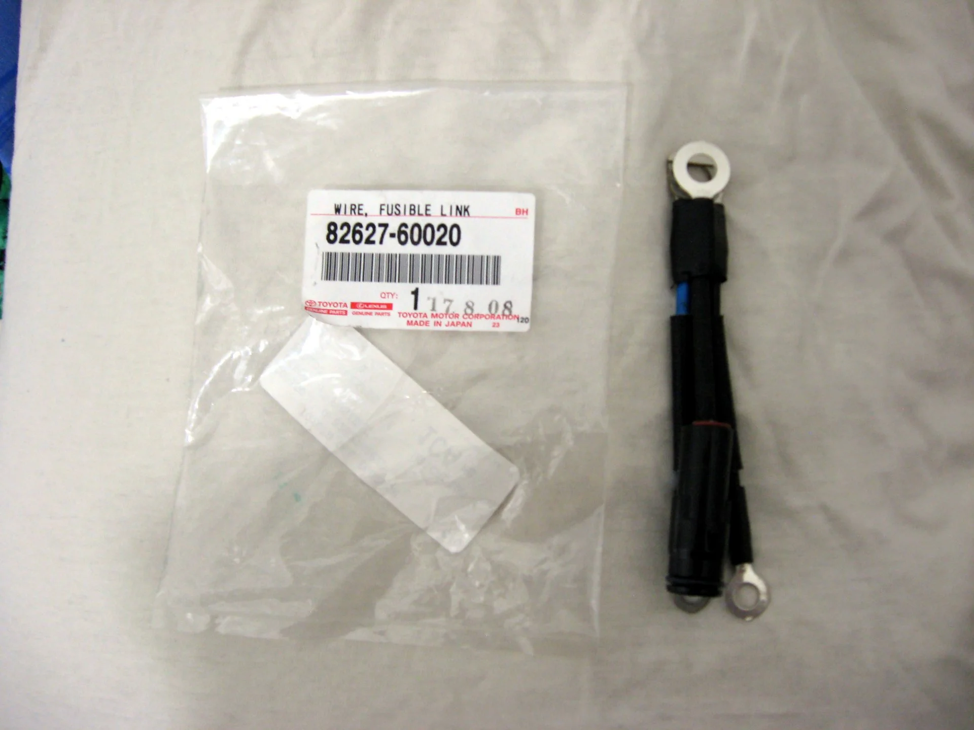

Make sure you change your fusible links as well.
1HZ fusible links have three cables with terminals. One has a round connector, the others are flat.

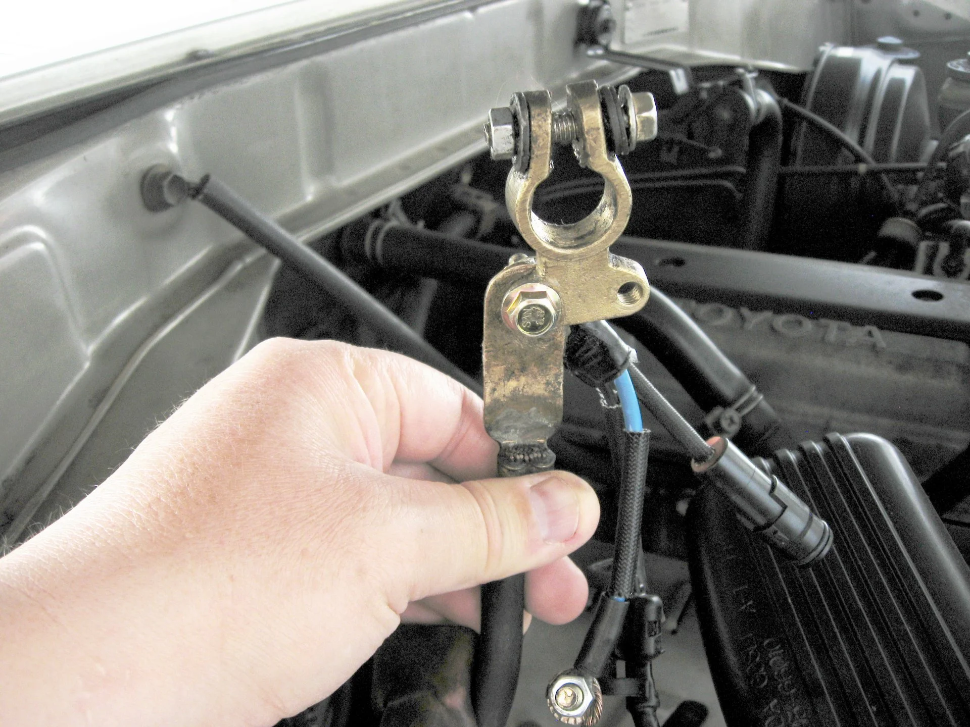

Positive terminal to fusible links. One flat terminal to the alternator cable. One flat terminal to the electrical system. About the round connector I am not sure, but if your truck has it, plug it in.

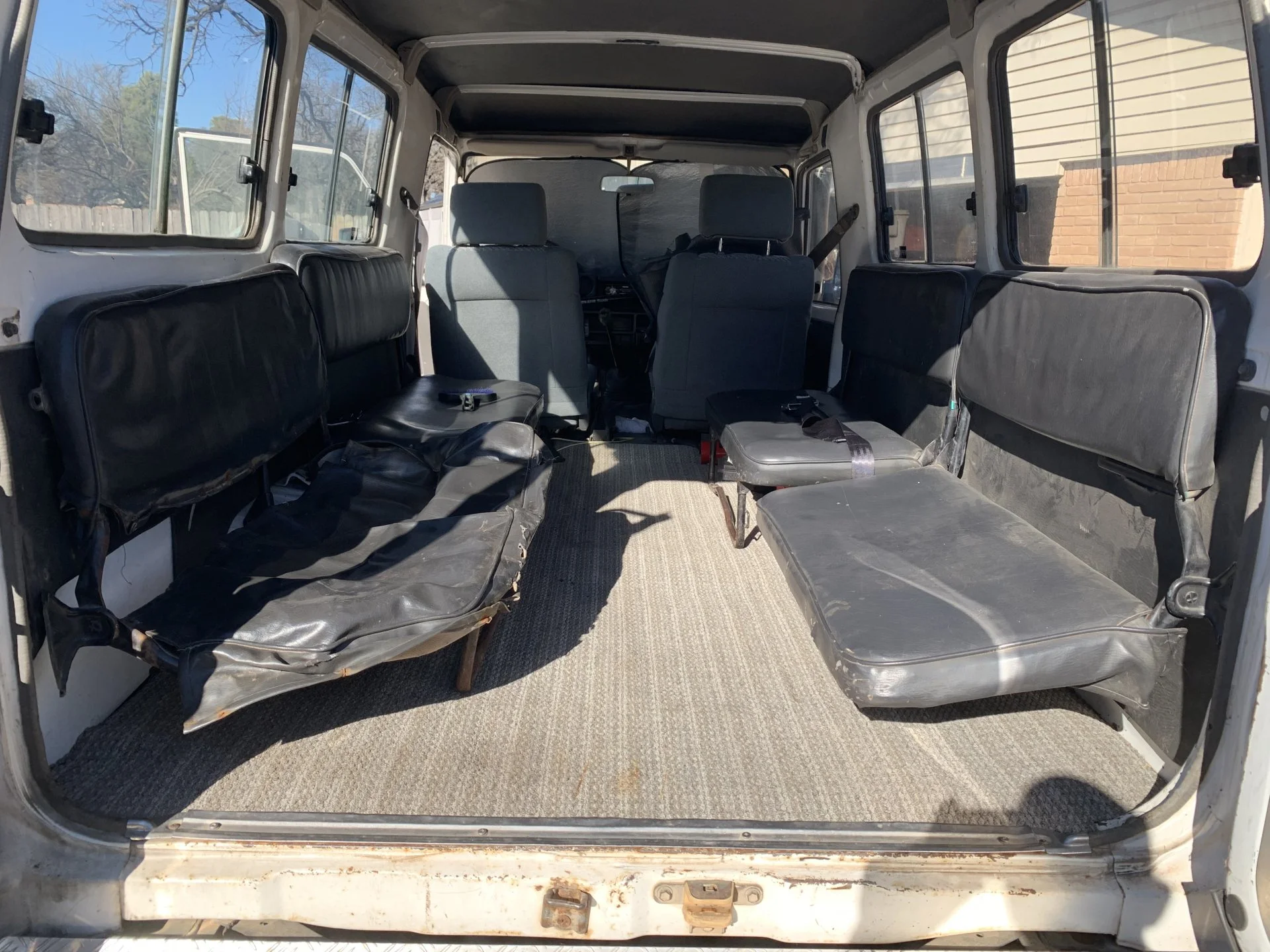

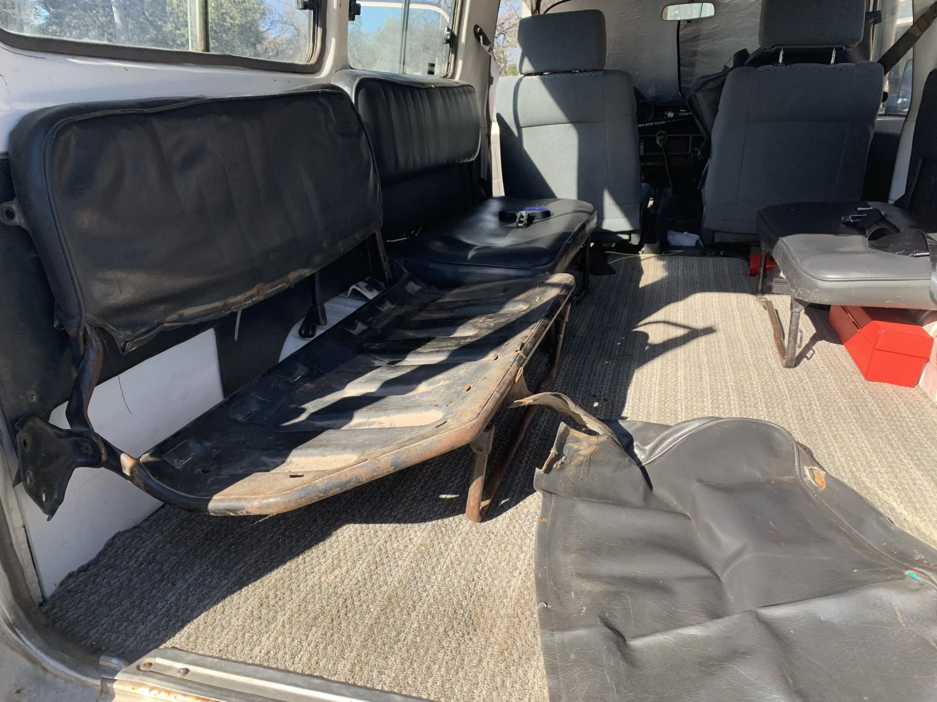

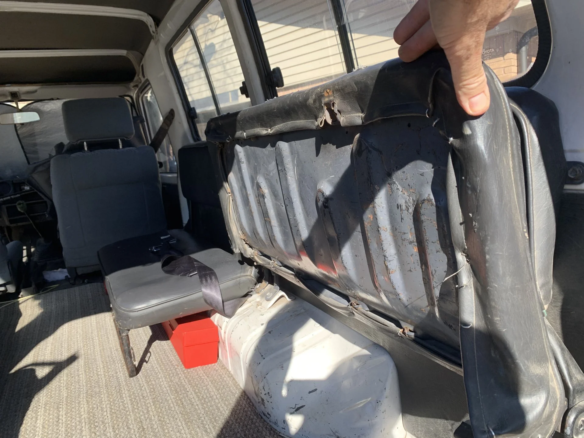

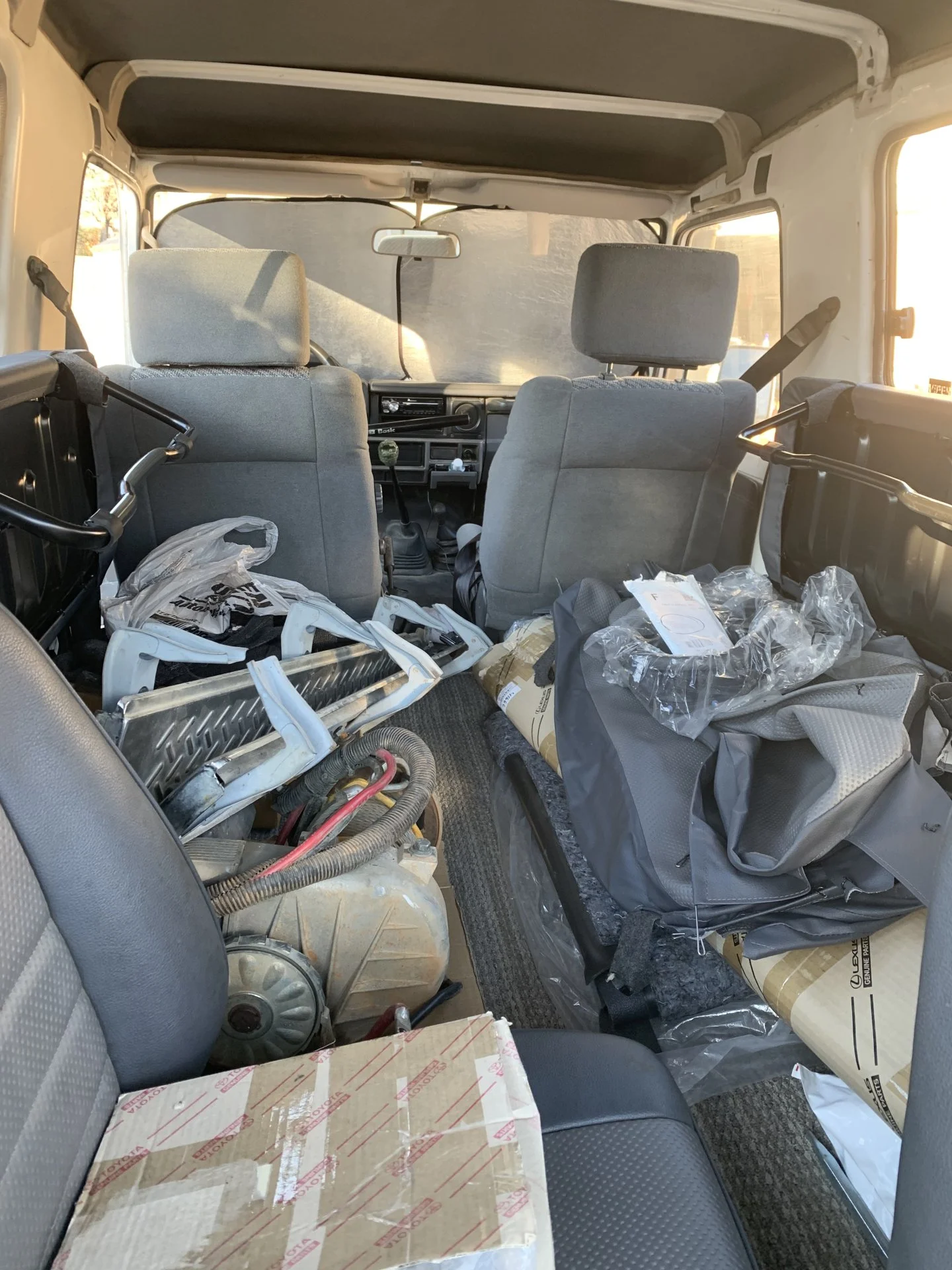

Put in the new seats from a newer HZJ75. They seem to fit just about right. Some came with seat belts, but I think some stuff might be missing, so I’ll have to look into that online later.

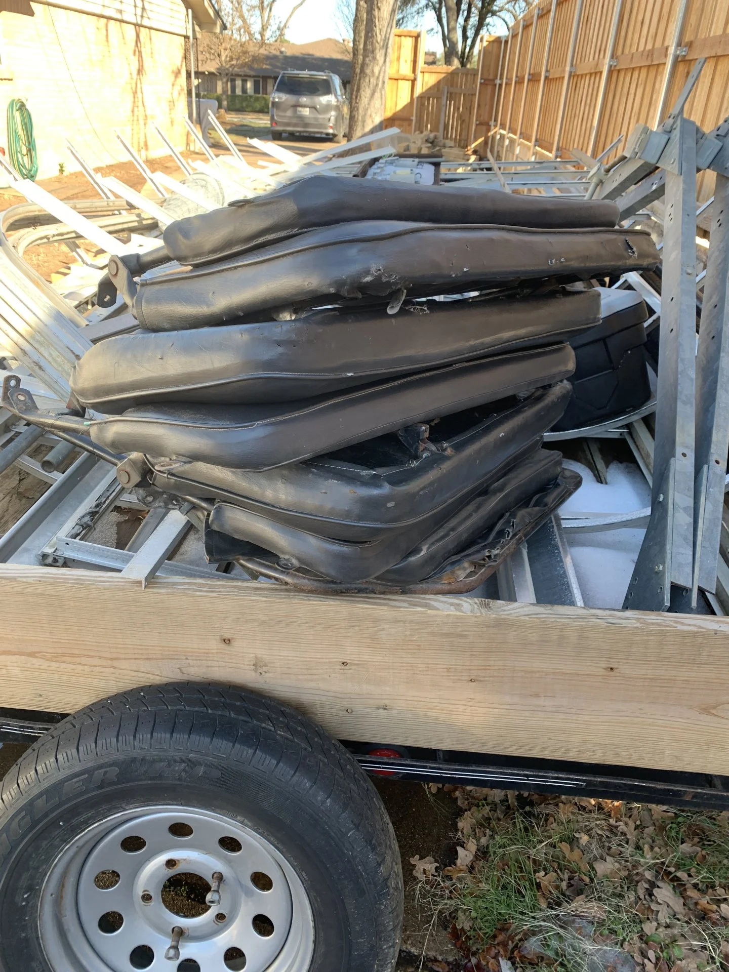

If anyone needs some old beat up seats let me know, I’d rather not just trash the old ones.

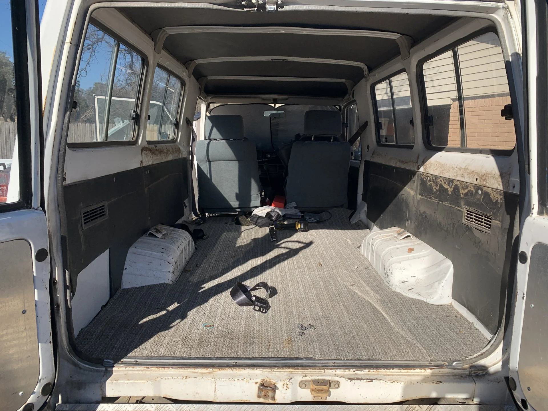

Reorganized the back with stuff waiting to go on.
Are those new front seats to be swapped in? Are they buckets that bolt right in or will you have to modify them?
Yes they are “new” 70 series buckets. I have to order brackets, but should be bolt in. What’s there are 4R seats with homemade brackets. They will be given away or trashed.

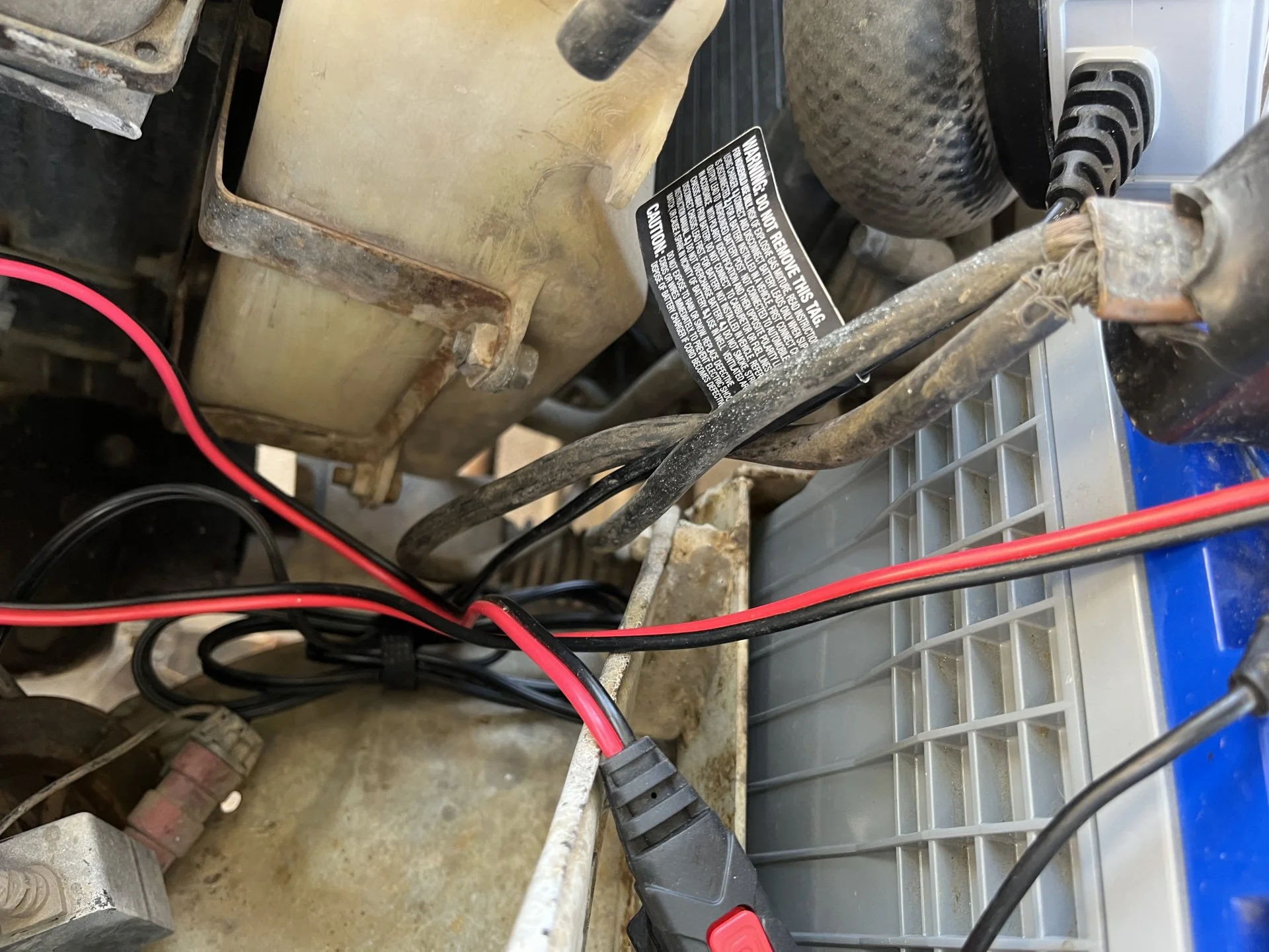

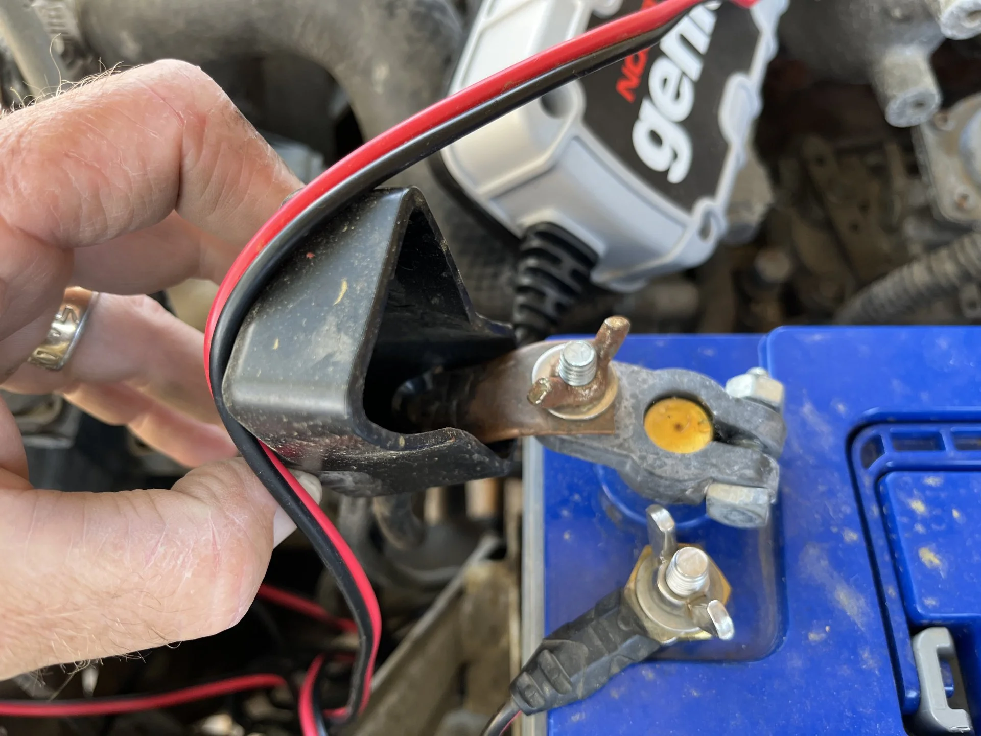

Does this seem right? I see the positive goes to the starter and then I have two grounds going to one spot on the frame. Anyone know what this should be like? I want to redo these, but do them right. Lol
