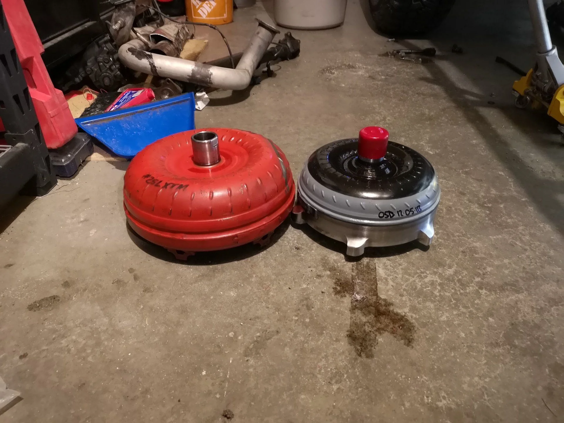

anyone talk about converters yet??? i did not stick to anywhere near stock power hahahahahaha
ran into the issue where i need a 2800-3000 stall, showing up any day, ill be running a triple disk billet converter, just curious what others have ran for converters. I had originally went with a 2000 Hughes XTM but its just not enough
Ugh, you should have said something. I have a brand new 3k, billet, triple disk lockup from Circle D that i want yo sell, as if i do an ls swap, itll be stock.

yup quite easy, i prefer to have my stall sized according to the power range, being under stalled really affected my torque bump, id get to the obstacle and push through the stall and brakes
literally what just showed up at my door and I installed hahahahah circle d 2800-3000 triple disck billet converter
if anyone is looking for an every day stock friendly converter i would HIGHLY suggest a hughes 25LXTM the sheer extra fluid volume is worth every extra penny!

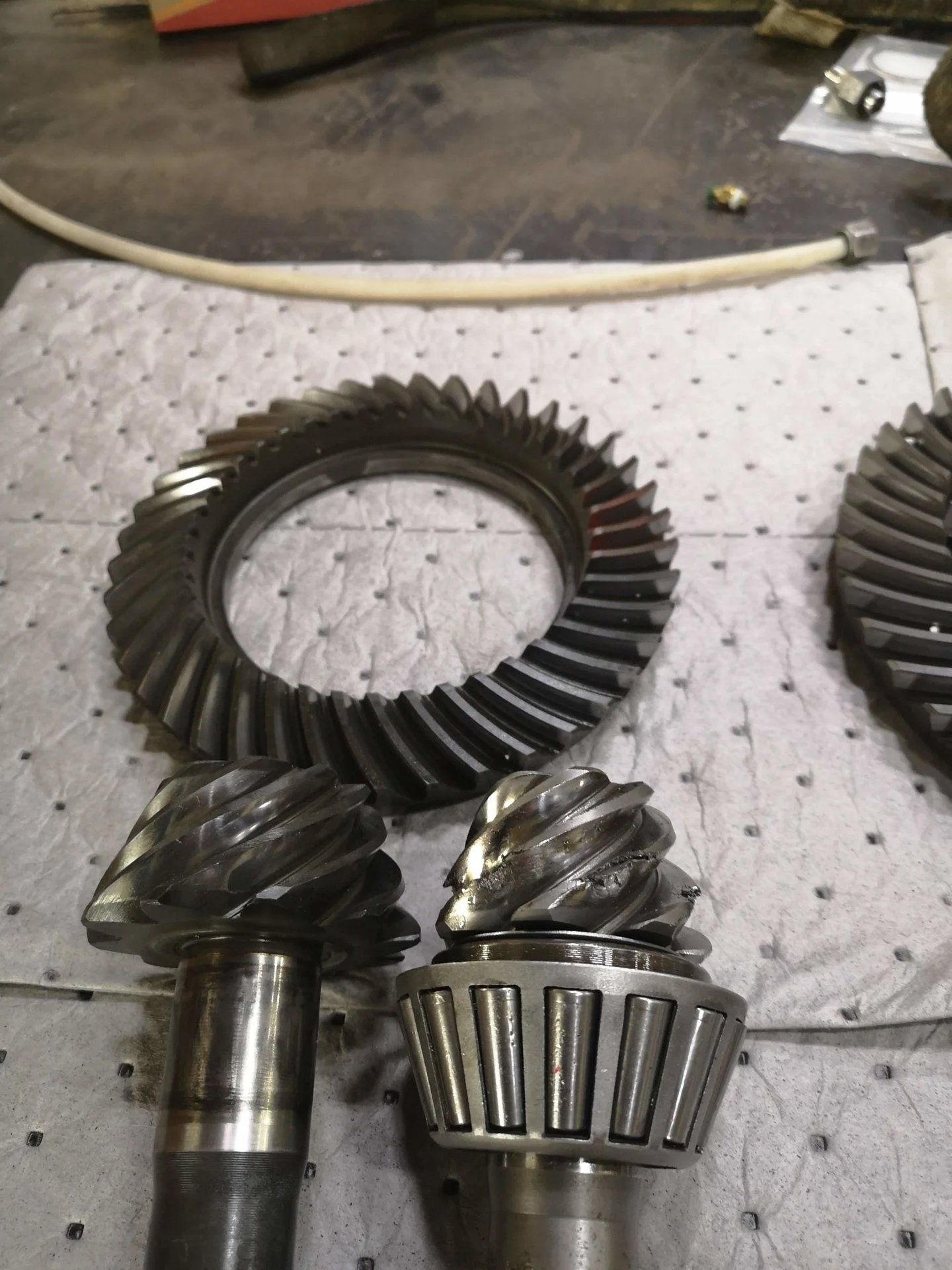

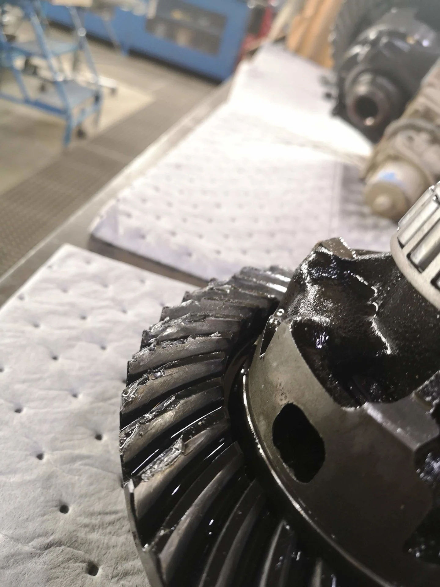

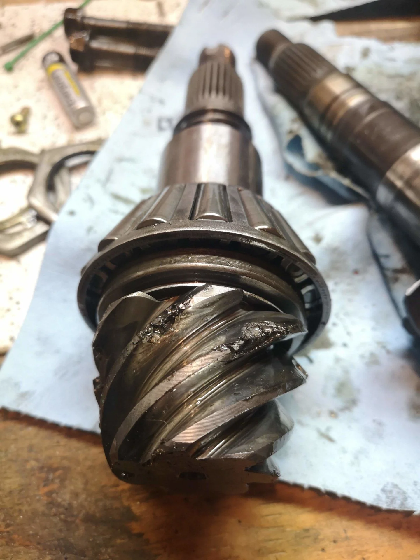

and why 5.29s and my ls did not last long hahahahahaha
I would probably go with a 9.5 diff just to make sure it holds up.

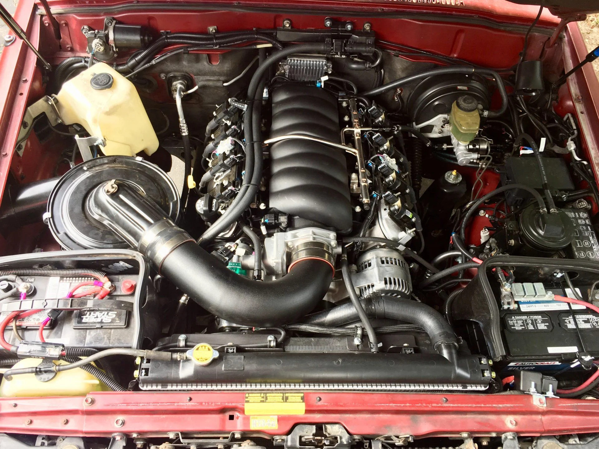

What intake pipe is this? Custom job or off the shelf? Looks like a perfect fit.
Off the shelf tube (135 or 150 degree maybe?), cut to fit. Stole the idea from @azcrackshot ’s build.

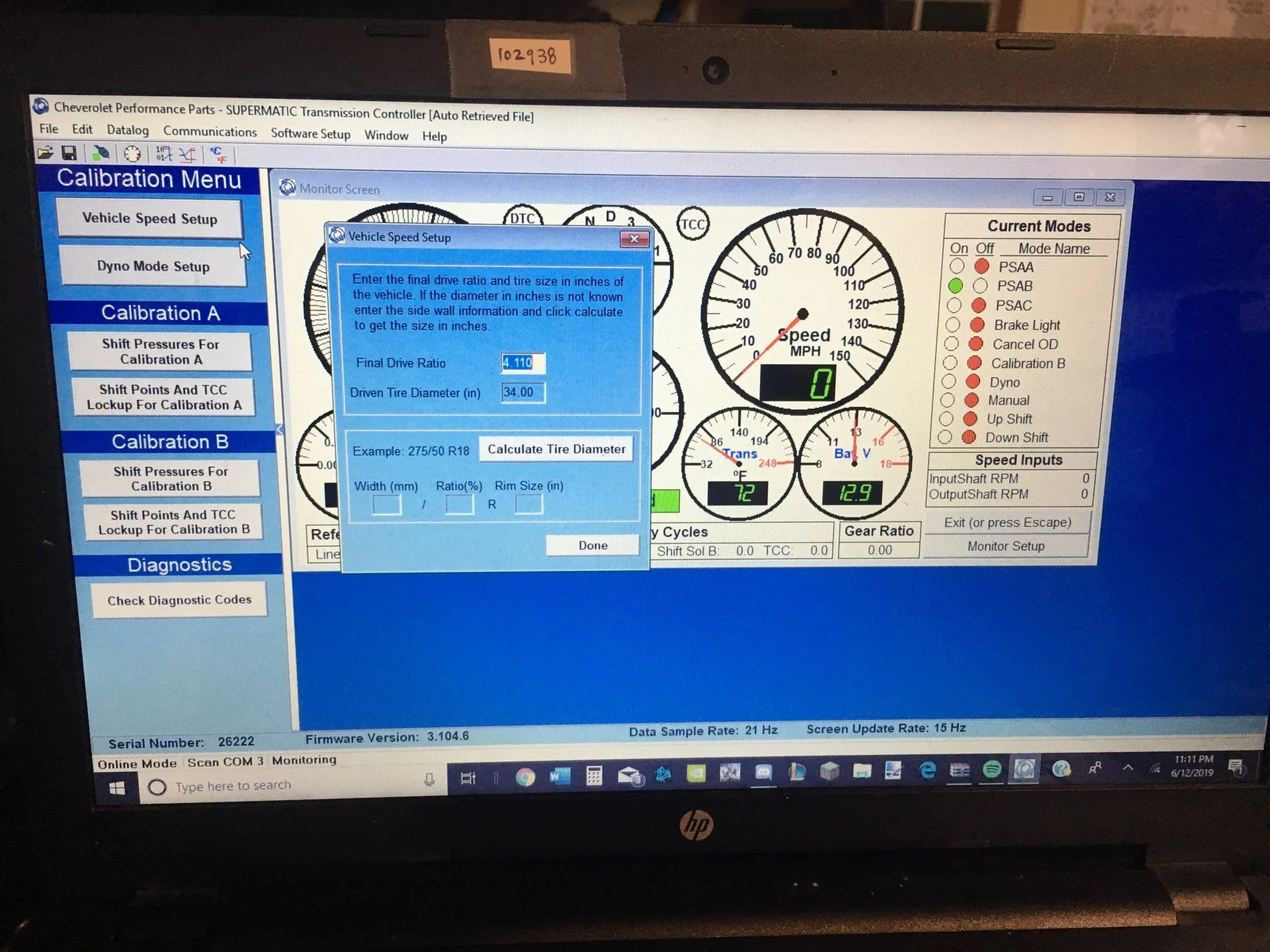

Also pretty cool that I could see the Cancel OD button and B Shift Calibration working through the transmission controller software.
I only opened it up to enter the tire size & gear ratio. I don’t know enough to improve the shift points... but if I did, I’d play around with the B Calibration. It’s not that much different than A right now.
