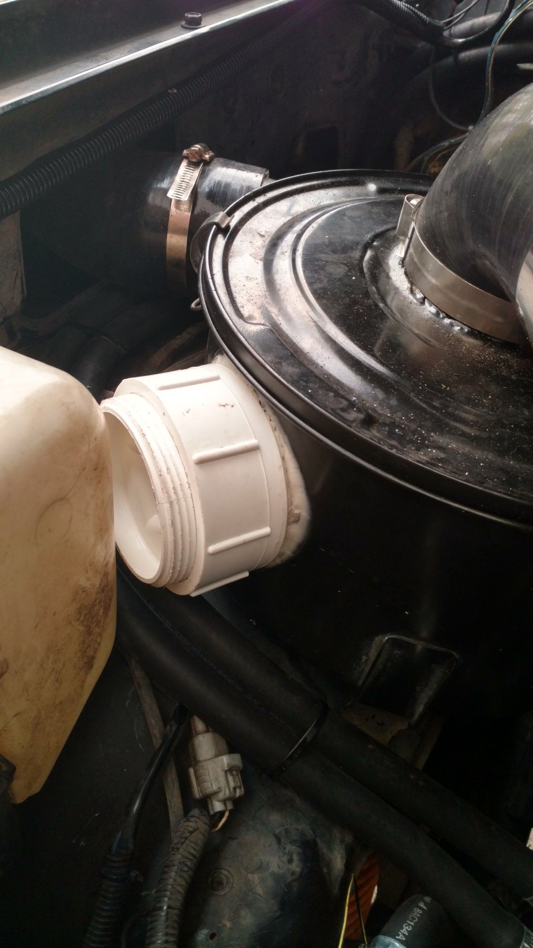

Did some unscientific testing with adding a port to the airbox. Testing was done on a the same strip of flat road with the engine already hot from running errands all day and an ambient of ~95 degrees F and 90% humidity all done with the torque lite app. I did several 0-60 tests monitoring time, intake temps, and intake pressure. From MY testing with the LQ9 4l65e combo with a cheap amazon snorkel with a 4" PVC cleanout in the factory airbox testing with and without the plug in, I found the following. (I removed the washer bottle so there was no restriction.) 0-60 times varied slightly but the best time of the day was with the plug in; overall the results were inconclusive. Intake pressure had on average at WOT a .5psi difference with the plug-out pressure being higher. The intake temp showed the biggest difference. While cruising I found that with plugging the hole and just using the snorkel intake temps were 15-20 degrees F cooler.

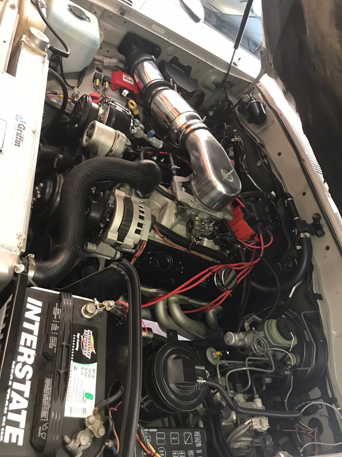

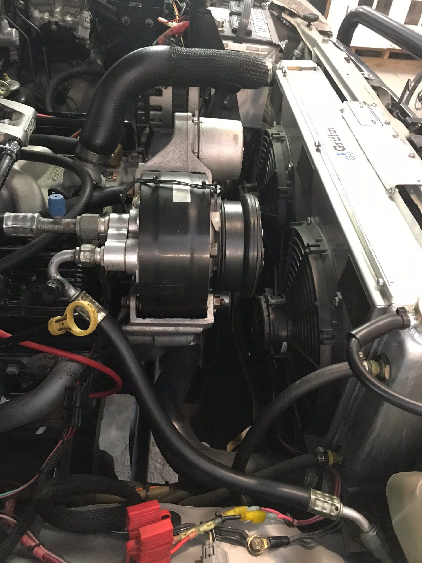

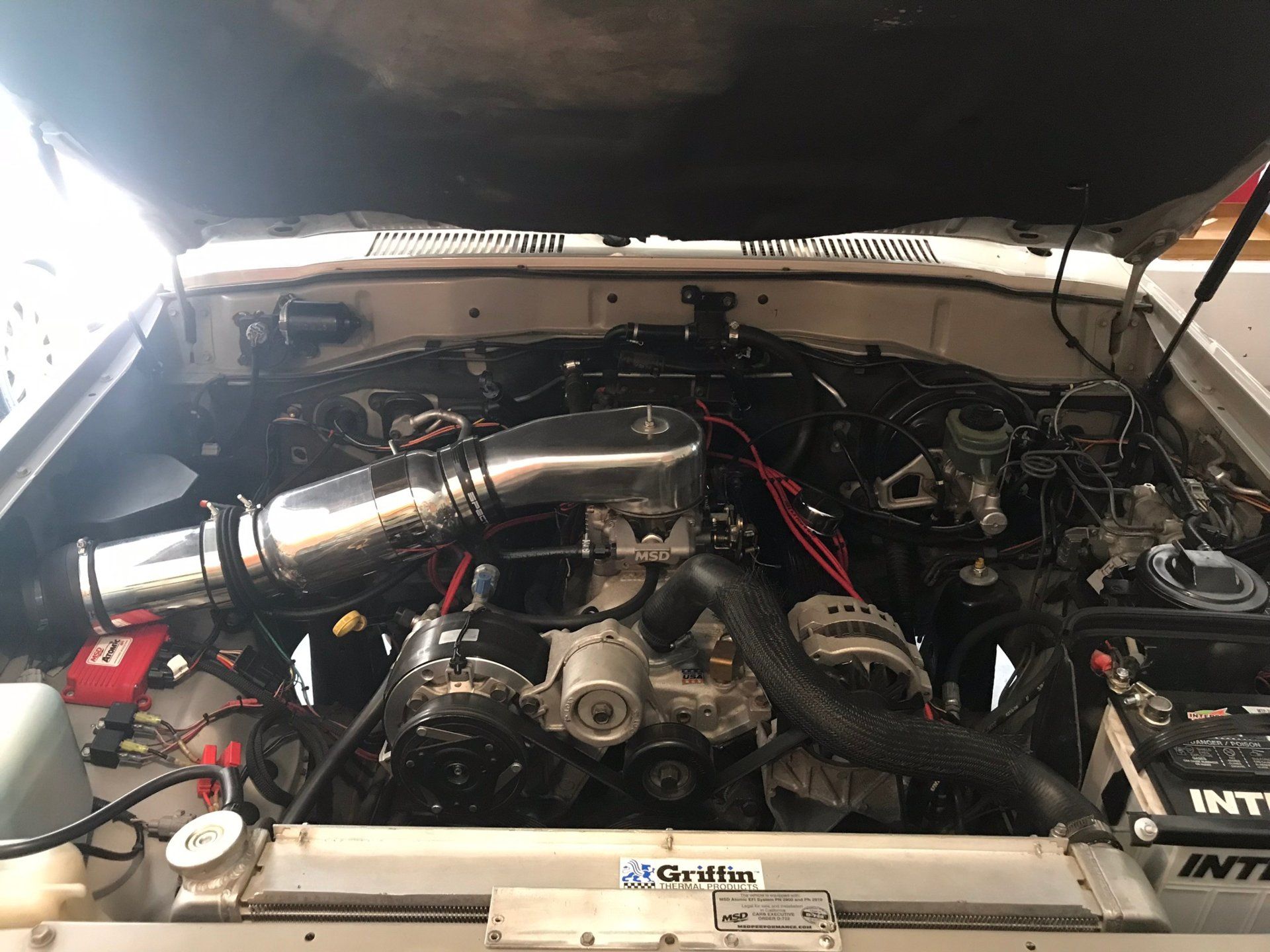

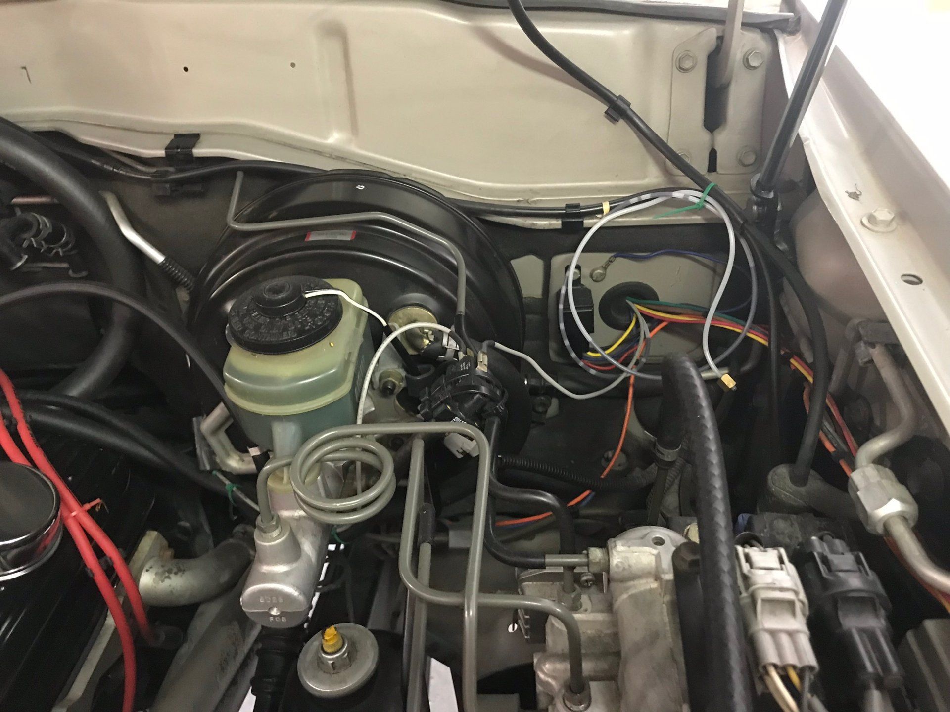

I thought you might like to see my friends v8 conversion. My understanding is that he was almost complete with the fine tuning but unfortunately passed away prior to finishing. I am going to finish what he started and then take the truck to Colorado to wheel just like we planned to do with the finished truck.
Things under the hood seem to be in order besides hooking up the oil pressure gauge. There may be more but this is over my head detail wise so slow going. Working on finding someone local to look it over as well.
I have been reading a bunch of threads about v8 swaps in hopes of finding someone who did the same conversion that Troy was finishing. The truck came from Idaho and is crazy clean.
how you can get pressure in the intake manifold on naturally aspirated engine ?? or you calling VACUUM the pressure
with that hole open you supplying hot air from underneath the hood to engine i m surprised the temperature increase was only 15-20 F but not way more
It's vaccum, but on the app they just call it pressure.
The way to do it and measure for restriction is to monitor the map sensor and either take notes or data log it with different air intakes. At wide open throttle the map reading should be close to the same reading as atmospheric ( key on engine off would be your reference) It will vary depending on your altitude. Any restriction, and there will be some due to air filter etc , will appear as a higher reading, just like when engine is idling and throttle blades are creating restriction. It's n my list of things to look at too
With the 4" clean out in my intake I clearly noticed a lot more grunt at 2500 rpm and above. I didn't compare full throttle runs. WOT in mine is a bit much for my suspension set up.
