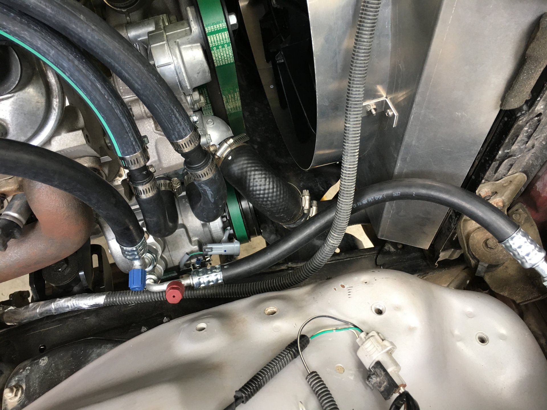

First, thanks @Squad1 for pointing me to coldhose.com Those guys are awesome. I ended up calling the number to place the order so that I could check stock on everything.. the lady taking the order was super helpful.
First, a list of everything I ordered
part number, description
2-feet BH8 (#8 regular barrier hose)
3-feet BH10 (#10 regular barrier hose)
SB3002 12mm to #8 metric straight compression adapter fitting
SB3003 14.5mm to #10 metric straight compression adapter fitting
AA0738-AA0739 Denso 10S17F 10S20F Suction and Discharge Compressor adapters
(be careful on the next parts, there are lots of options for reduced barrier hose, aluminum vs steel, etc)
SB1313-3 45* female o-ring adapter to #10 hose with R134A suction port
SB1322-3 90* female o-ring adapter to #8 hose with R134A discharge port
The top two fittings allowed me to cut the stock hard lines and convert to the standard "barrier hose" sizes. I'm not completely confident that vibration won't eventually cause these to leak, but for now it's working great.
I did end up doing what Squad said he would have done if he could do it over.. I cut the stock discharge line under my passenger side battery and kept the hard line going through the firewall.
This is after I stripped the rubber hose off the stock toyota hard line forward from the firewall and am cutting it with a small tube cutter to get a clean end. The fitting on the left went on here. Cold hose didn't provide specs for how many turns on the compression fitting, but I just went to town on it. Seems to have worked.
Compressor adapters including both top and bottom orings. I had to break out the bolt bucket for an M8-1.25 bolt to hold these in. Be aware there is a pretty narrow range of correct lengths.. too long and it'll bottom out and not compress the oring, too short and you strip it. Sorry, I didn't measure the length of my bolts. Also these are so close together the nuts for the suction and discharge lines are extremely close.. but they do clear.
My suction line has a 45 and turns back toward the engine.. this is to get around the "tuna can" on the stock air cleaner and keep the line away from the exhaust manifold. I ended up adding some DEI heat sleeve to the suction line since it is subject to radiant heat from the manifold on this side.
The discharge line fits nicely.. clears my PS battery tray better than the factory line actually.
Note that a local hydraulic shop wouldn't crimp them.. apparently these use different dies. I found a shop in town that does custom AC lines so they crimped the lines up after I marked the rotation. With the compression fittings rotation isn't as important but with the bend of the upper line I wanted to keep the natural bend of the hose oriented the same.
I really think the smaller of the two available compressors would be fine.. this big "20" model is designed for an escalade with rear AC.. basically it doesn't need to run for very long before the amplifier shuts it down. It also noticeably drops the idle of the truck when it kicks on.. so far no stall but I'll play with upping the idle a little in HPTuners to see if it smooths things out. To clarify I don't think the "17" model would necessarily help.. just that the 20 isn't really needed. The stock GM ECM controls the compressor clutch with input from the climate control module over GMLan.. needless to say I won't be using this whole system. That also means there isn't a traditional "AC Clutch is on" input to the ECM.
I don't have electric fans so didn't need to use Squad1's special fitting to incorporate the GM system pressure sensor so that the ECM can use the fans to help cool the condenser.
I also haven't had enough time in it to determine whether my HD truck fan clutch is enough to cool at low RPMs and vehicle speeds.. but I plan to put a small condenser fan on it anyway. That might also get used for an oil cooler.. haven't started planning that out yet. Need to get the transmission rebuilt first.
Let me know if you guys have any questions.
