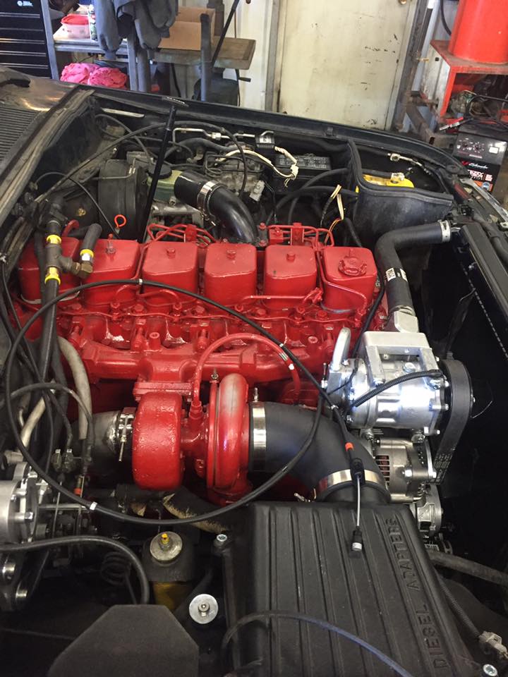

anyone run a diesel adapters air box for a better filter than the factory circle?? If not well stay tuned Ill be doing it! I bit the bullet today and talked to Dustin, he was very intrigued to see one go on the LS and get results!!!
I am pumped to ditch this giant piece of metal.....
I always thought the stock filter was actually really good. Centrifugal action built in, water drain, pulls from the fender.. my only concern was whether it would keep up with my engine that has double the stock amount of power but for me the benefits outweigh the drawbacks
