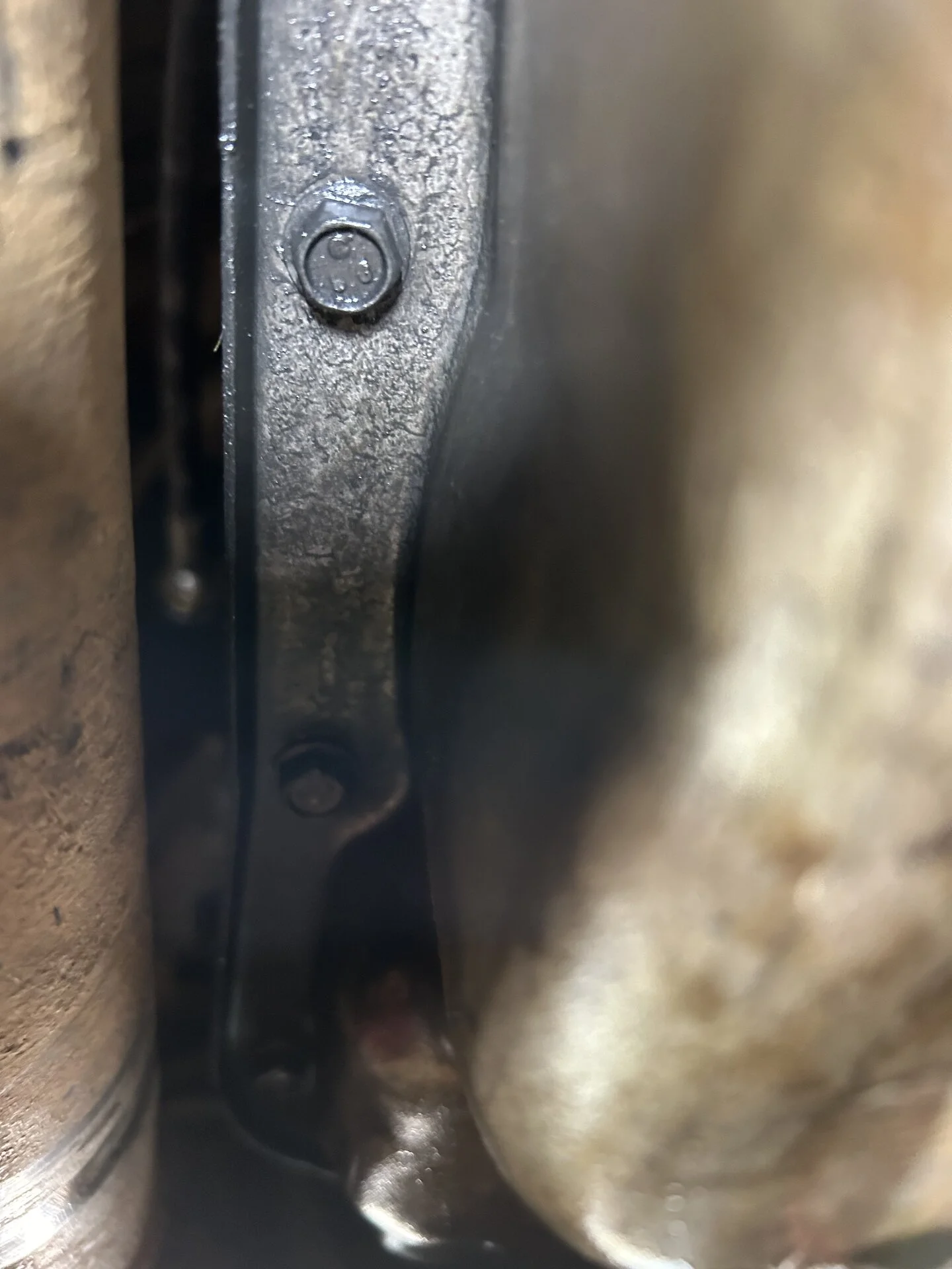

Does anyone with a 6l80/90 have any pictures of their front drivelines? I’m looking for inspiration. Did you use your stock shaft, or did you have to downsize?
Seems like there’s a bit more room than with a 4l80
I used stock shaft which I have found rubs. Gonna look at it this weekend
If you could share a photo that would be greatly appreciated!
Do you have a 6l80 pan or 6l90? I know one corner is different, but not sure about the rest of the profile.
Mine is a 6l80, I’ll get a picture for you

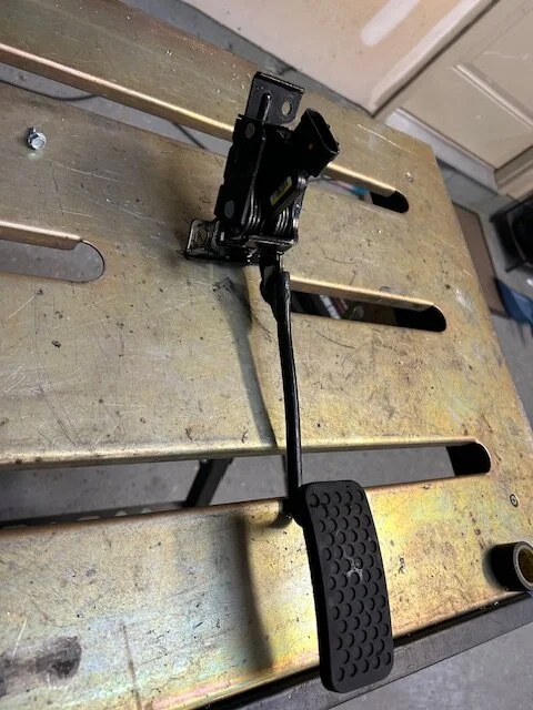

Okay, what about dbw pedals? Which one has been successful? I’m currently thinking a trailblazer or corvette pedal might be what I try if no one has advice.

IMO, use whatever pedal the engine donor had and weld the LC arm to it in a position you like. I know some are plastic though

I have a Gen V L83 in mine, but used a 09-13 corvette pedal (GM 19417903). I cut off the "pedal" portion and welded on the lower section of my stock 80 pedal so it at least looks proper.

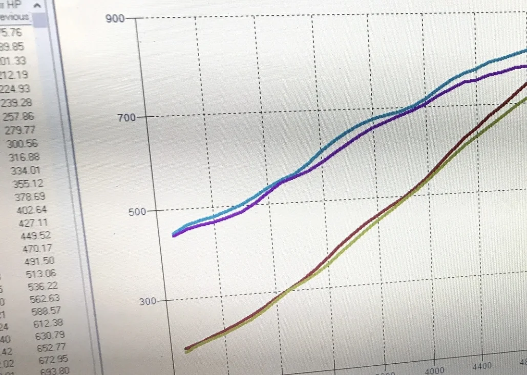

I’m a tech by trade and enjoy the wrenching aspect as much as I do wheeling itself. Just for fun, here’s the boring half of the chassis dyno from my other LS build.
Appreciate the info guys. I like the idea of modding that pedal and welding the oem pad on. Just looks right!
I have a 6l80 it rubs on the shifter bracket when suspension is really compressed, so that will be a easy fix. Sorry one problem I have is vertigo when looking up
so I have to take pictures quickly while the world is spinning.

Did you have to change connector on wire harness to use 09-13 Corvette pedal or they use same connector?
Honestly, I don’t know the answer to that. The place that I got my harness and computer from also supplied the pedal. I opted for the corvette pedal specifically because of the metal arm. I don’t know if they included a different connector or if that’s a standard GM item.
