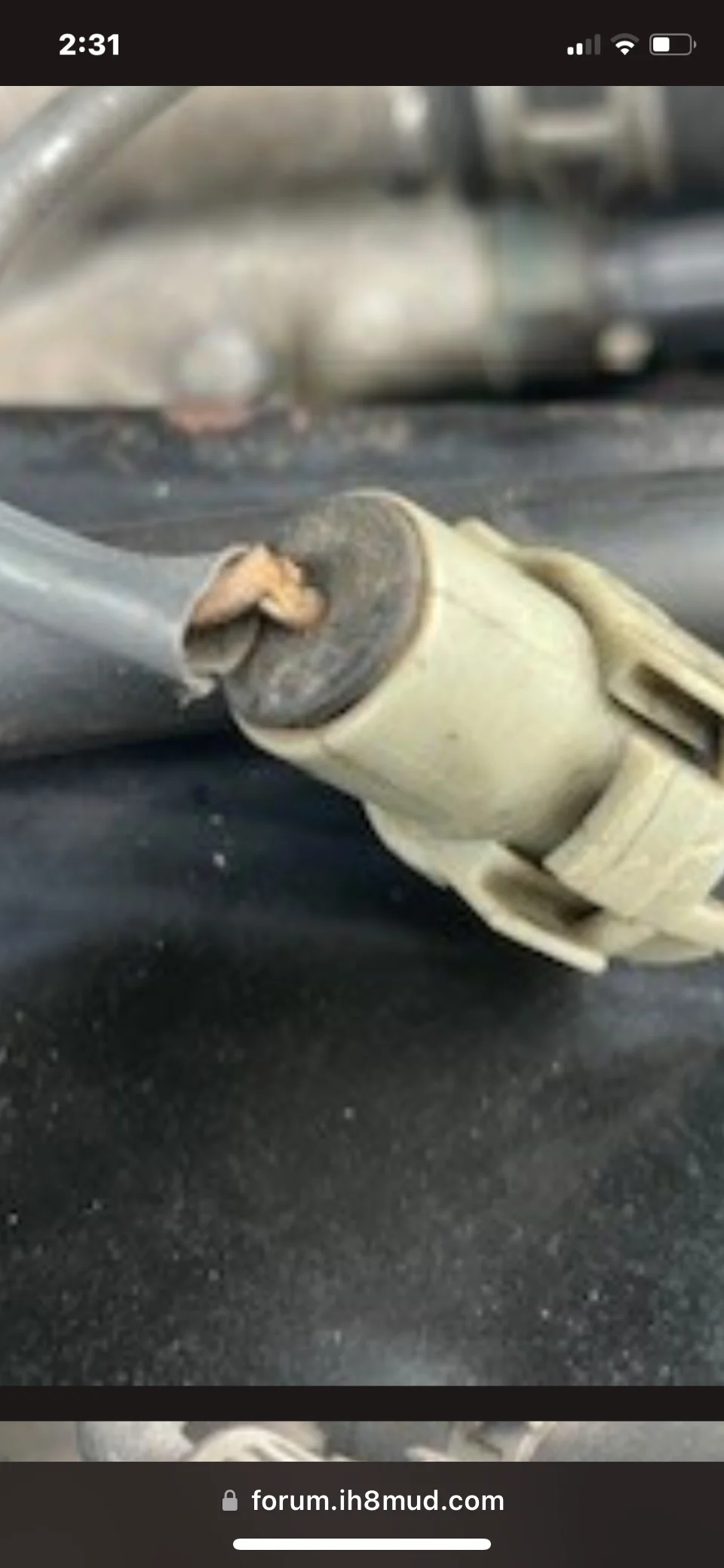

I just read your other post. I've been having issues with getting my 1988 62 to start since I've replaced my temp sensor. I'm pretty sure that the ecu needs to read that before it'll start. Your connector looks like it's hanging on by the rubber sheathing. I have a new connector and sensor on order from vintageTeqparts.com. Hopefully I'll be up and running soon. I will double check into this but I'm pretty sure that's part of your starting issue.
First of all, thank you for reading my other post. Second, man... two birds one stone?! That would be amazing. Would you mind sharing the link specific to the one you ordered? I picked up one from O'Reilly yesterday I don't know if it is really compatible but going to verify prior to any installation, just wanted to grab something while I had a ride to the parts store. Also, was there anything going on (patterns, temp) that led you to replacing the sensor vs. the thermostat? I appreciate your response!!!

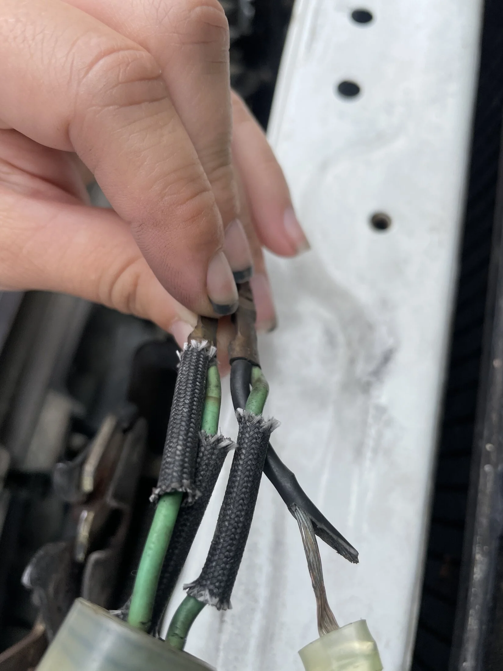

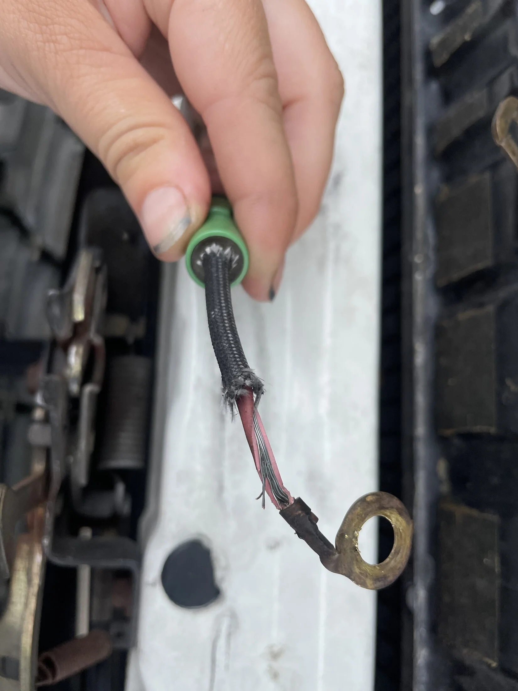

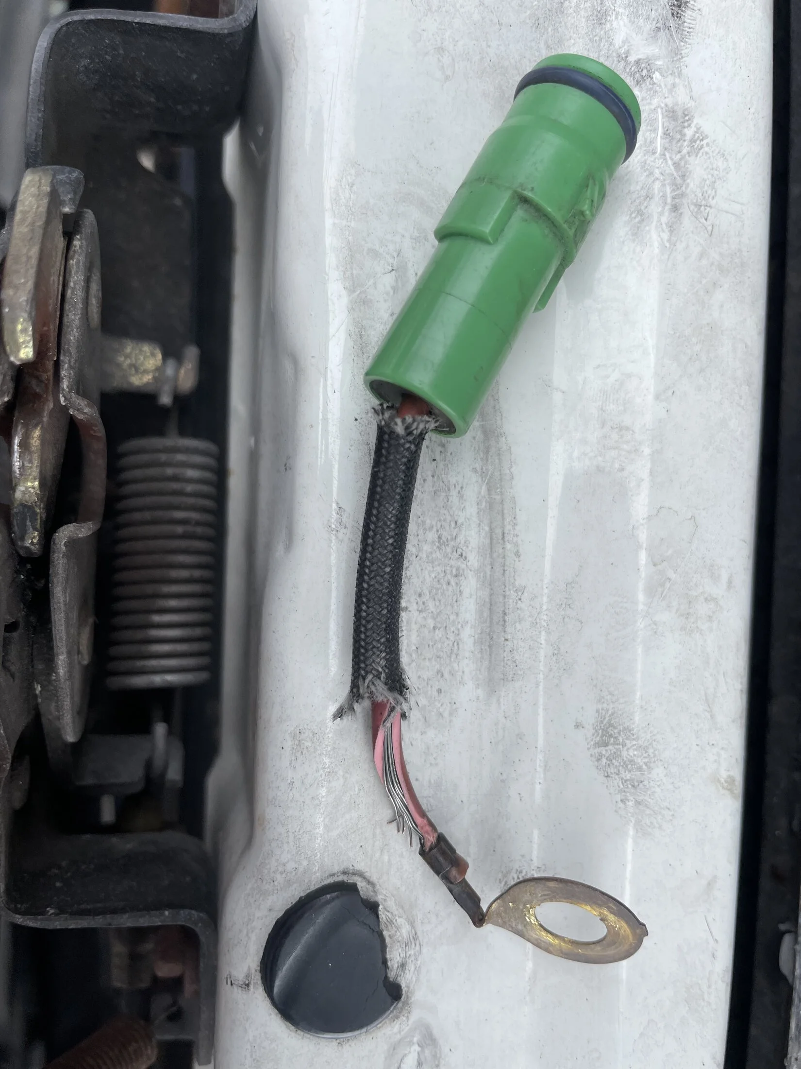

UPDATE: From an outside glance the fusible links just looked old but further inspection peeling back the rubber wiring they look pretty shot. Going to cut and crimp the solo green one but I think I need to replace the wire completely for the other. Looking at the photos can someone tell me which is which (MAIN/AM1/AM2)?
those fusible links look terrible. Have you checked resistance across each of them? We offer a rebuild service for them if you can mail your originals.

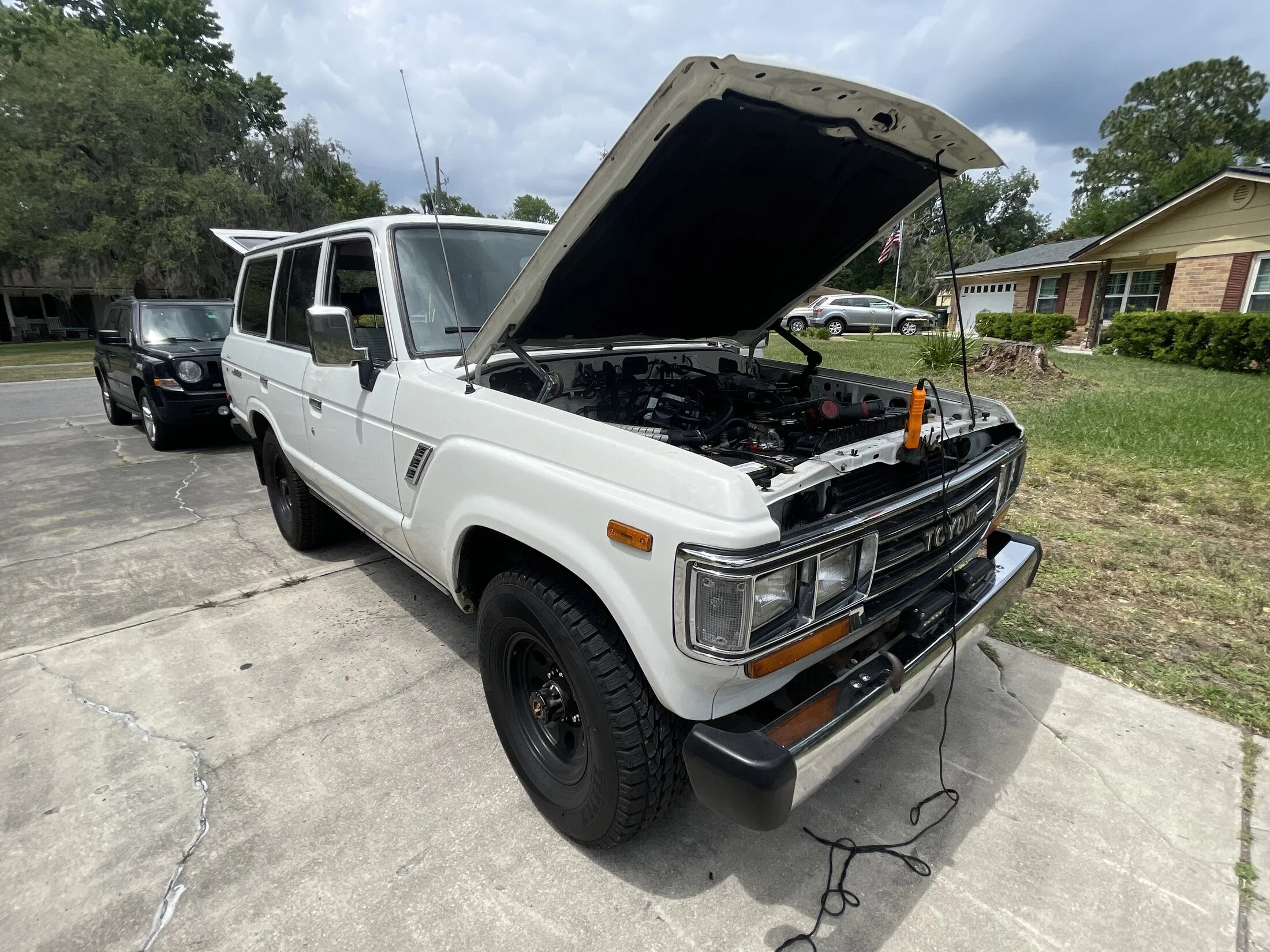

I ended up going out for a little mobile repair on this one today.
Those fusible links, ugly as they were are actually still functional. I did replace them though.
The issue was simply the main power cable bolted to the painted part of the cheapo positive battery terminal. Only had 2v going through it.
It was replaced with a proper OEM style terminal. I’ll let Avery post pics :)
