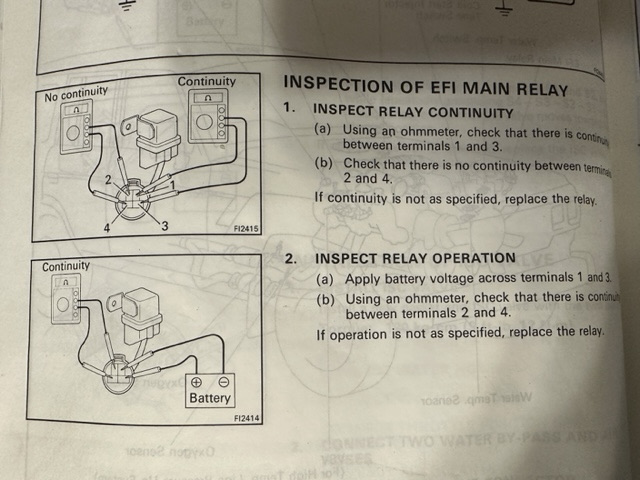

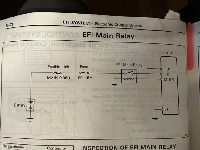

Finally remembering I have read on Mud but cannot find good reference, I looked at the CEL. It does not illuminate either with the key at ON or, not surprisingly, START. So, from the 1988 Repair Manual, p. FI-74, I took a look at the ICU's surprisingly exposed relay - on right wheel well just behind the battery.
When extracted from the vehicle and bench tested, it is nominal when uncharged (see below); applying 12V it "clicks", closing the relay
and indeed get continuity between #a 2 & 4. Great: so the original relay is still good.

===> BUT....where the blazes does one locate that "MAIN 0.85R fusible link" as shown in the upper picture?????? <=== That appears all that remains to test, other than to learn if the entire EFI/ECU is still good:censor:

fusible links are right off the + battery terminal
Right...but I knew that:doh:.
Okay, so I detached the two sets of them:
not knowing the destination of any of the three on the left or the one on the right. ALL of them pass continuity at 0Ω, but, although the one on the right looks perfect visually, each of the three wires coming from the left have cracked-so-bare-wire-shows issues*. I can NOT see any indication of heat damage, other than that the electrical tape wrapped around just aft of the post connector was extremely brittle - but so one would think on a 34-yo wrap. I'm not eager to take off the heavy-duty shrink wrap behind the connector...but should I?
Does anyone know if this kind of link is as unobtainable as so many other 1988 items? Or easily swapped out for a new replacement? Or other testing I should do?
