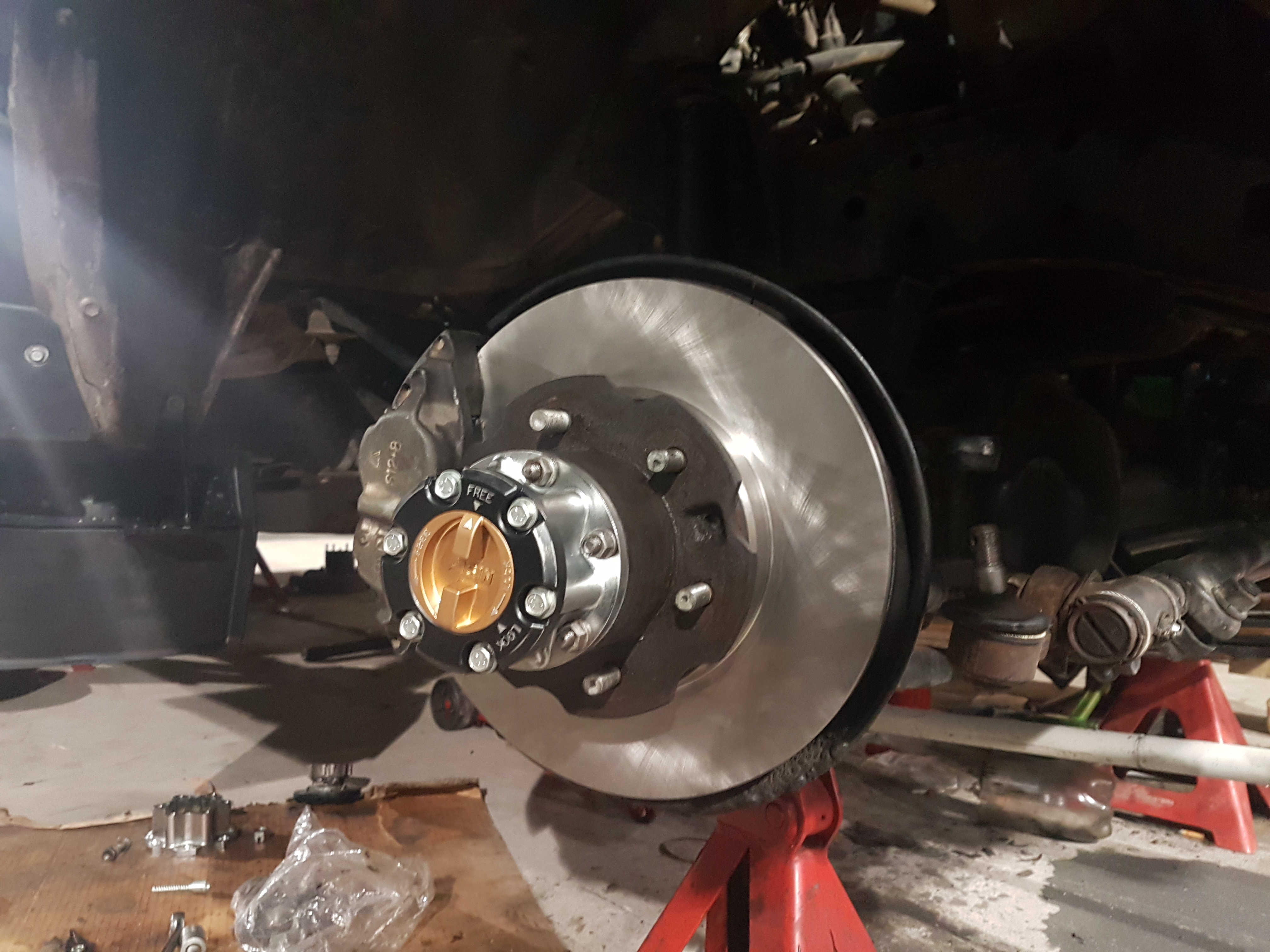

Had my brakes done at the local dealer. Swapped out the front discs for new ones and change out the pads. Rear drums also got serviced.
Do you have the part numbers they used? They told me no stock for them and they can't get them anymore! I could get them from the US but it would suck to ship brake parts by air for maintenance purposes. Heavy parts!

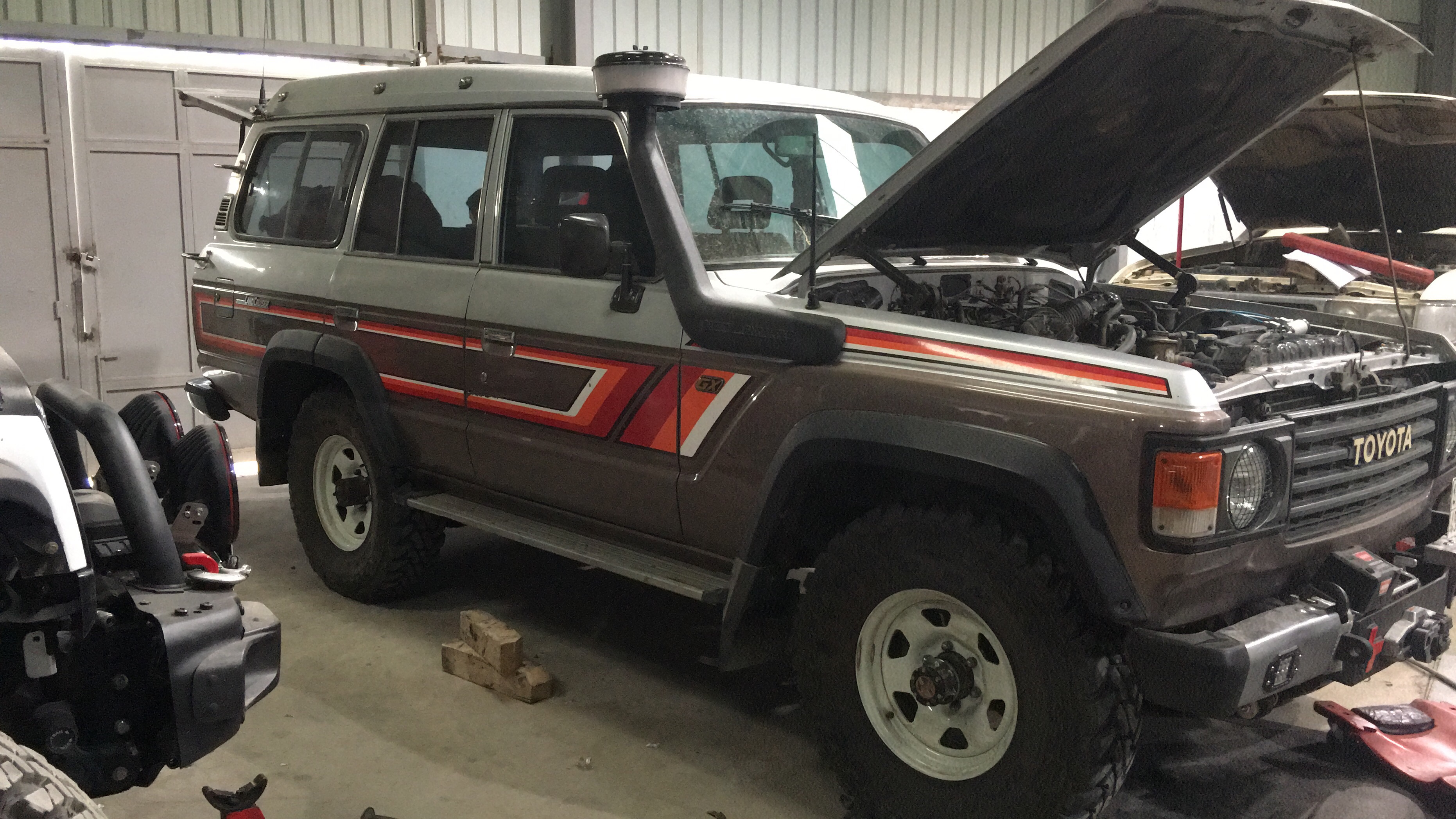

The 70 series is sweet. See it everywhere. No V8 Diesels available here on the 70. And I really hate the rear track width on them. Because of how they are setup from the factory, the rear and front tires track funny. Noticeable on dune driving.

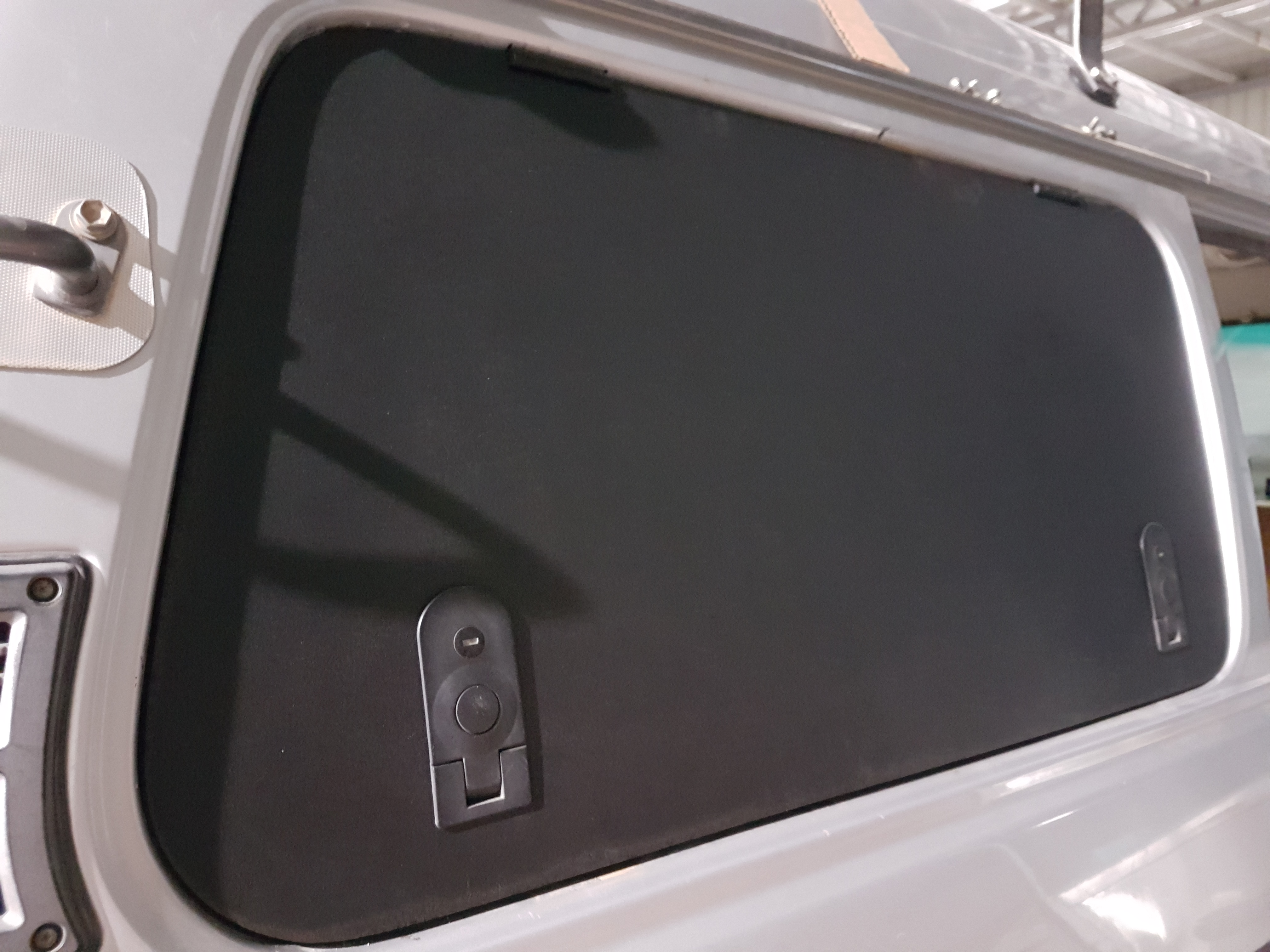

Cut the rear tailgate open to do a storage bin.

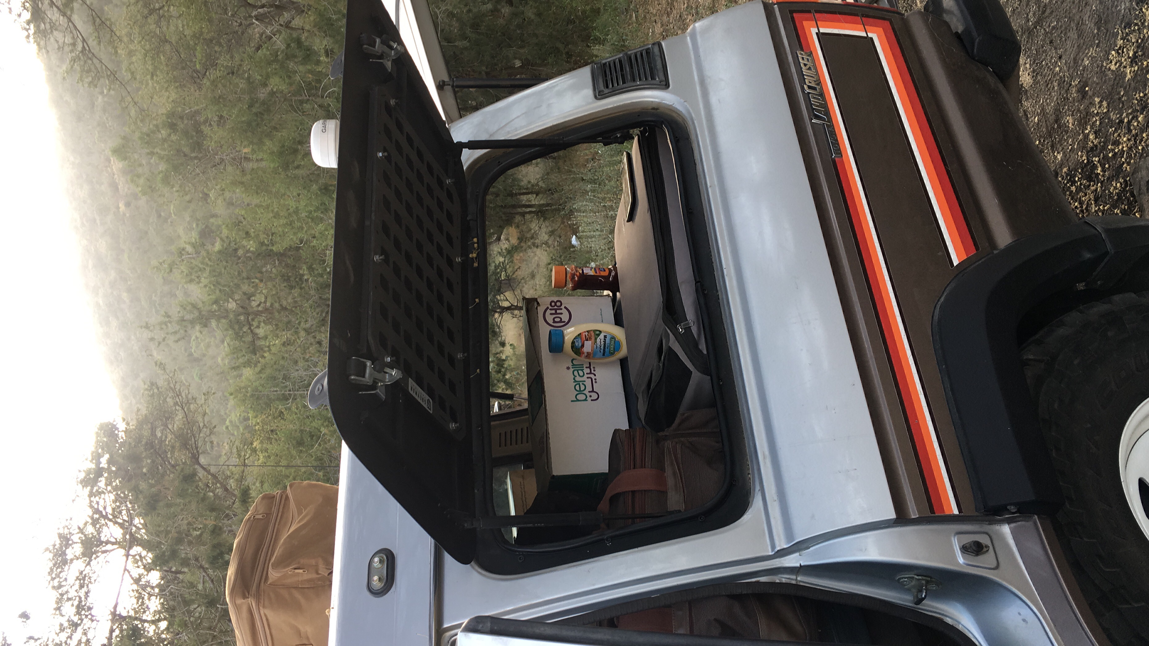

The hinges showed up today! So I'm planning to modify and fit for the flip window setup. If it works and seals good. I'll do it to the other side as well.

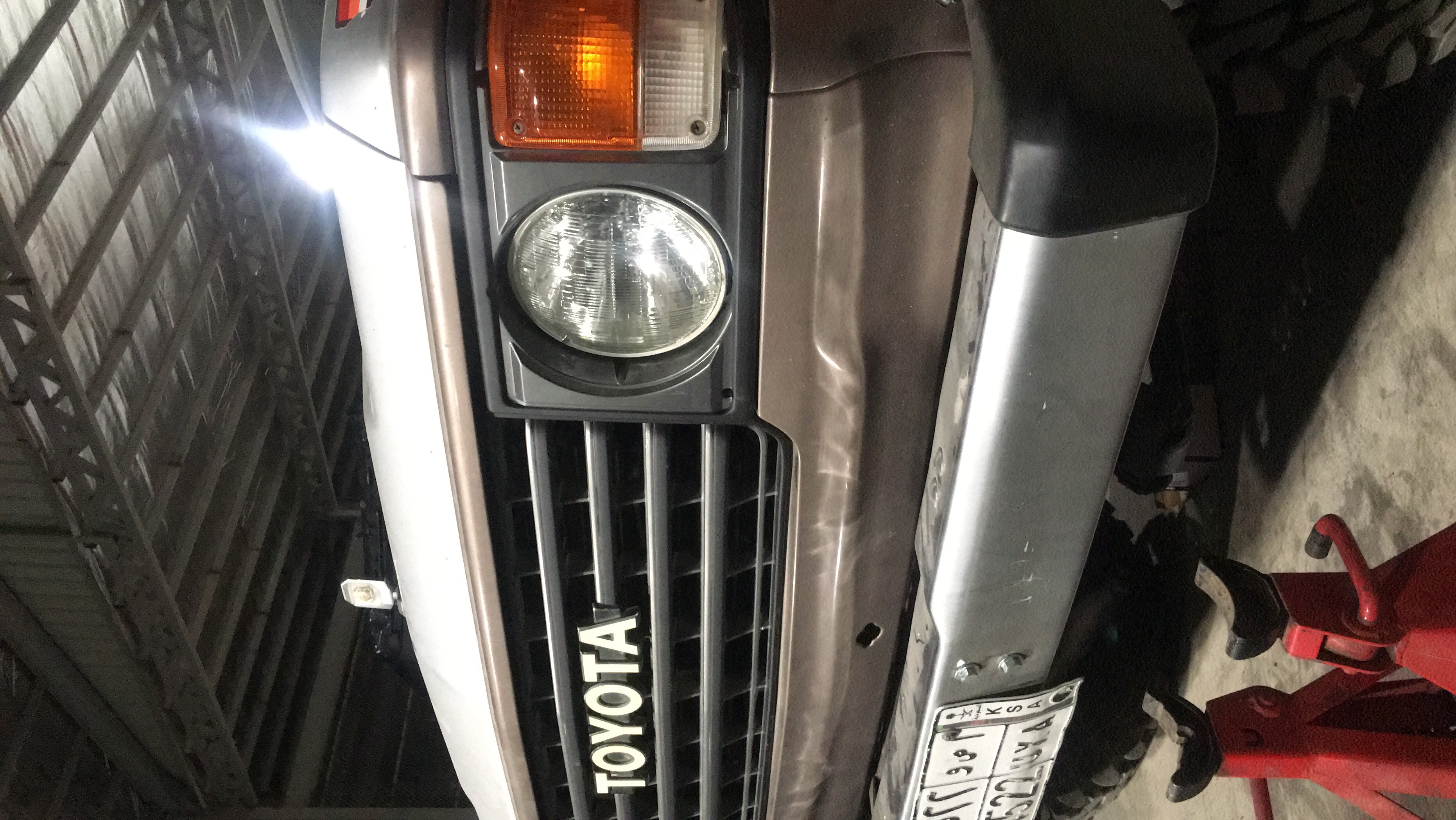

While we were waiting. I got the front bumper out in preparation to make a winch plate. Thanks to @boozewz I'm going to use the same winch he did on his 62. But I plan to add cutouts for D-ring mounts. More on that later.

This is the panel almost done with the hinges attached
The front end almost done with new brakes and new genuine free wheel hubs

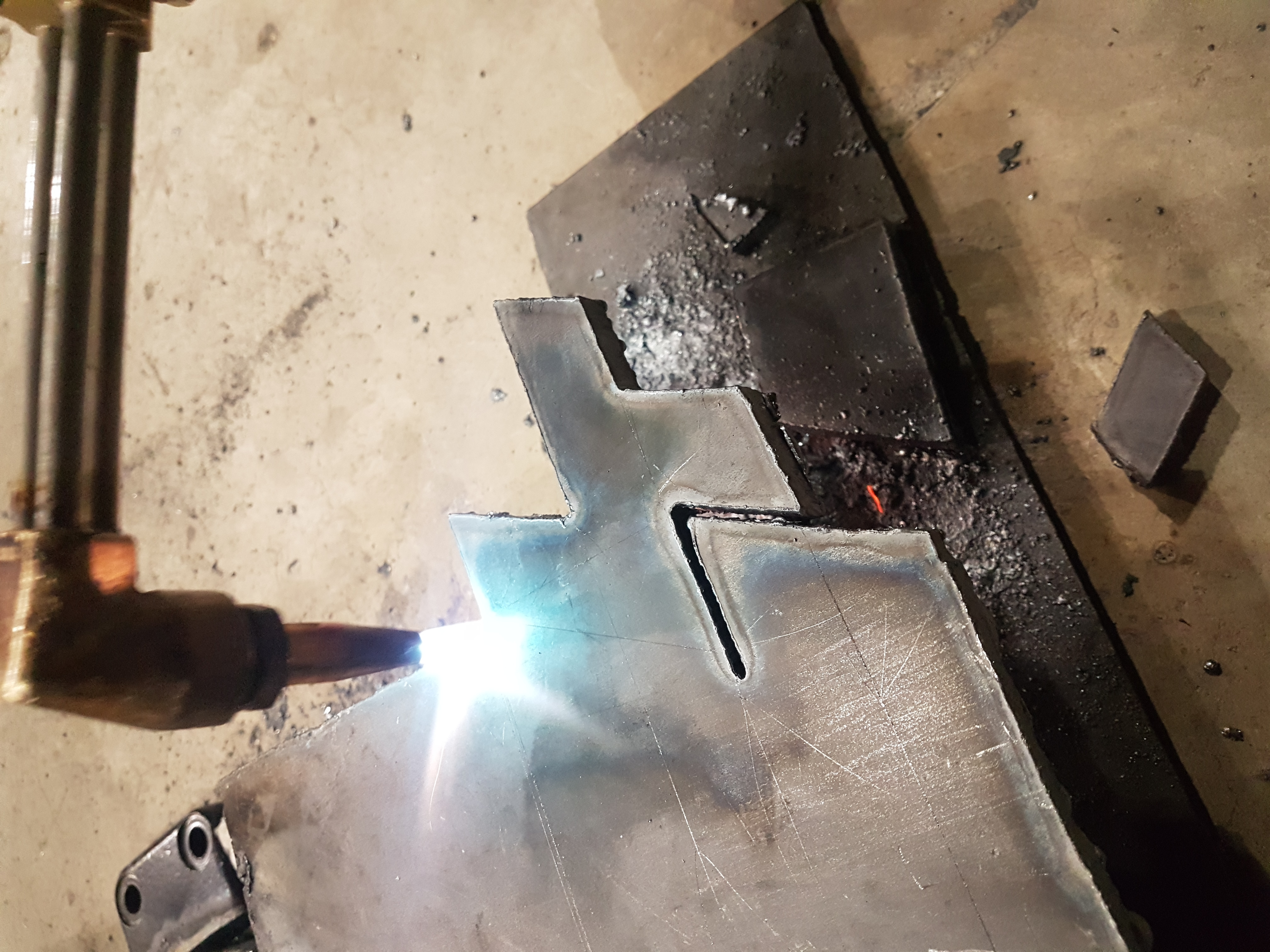

Here we are cutting up a logo for a custom winch bumper I designed that works with part of the factory bumper.

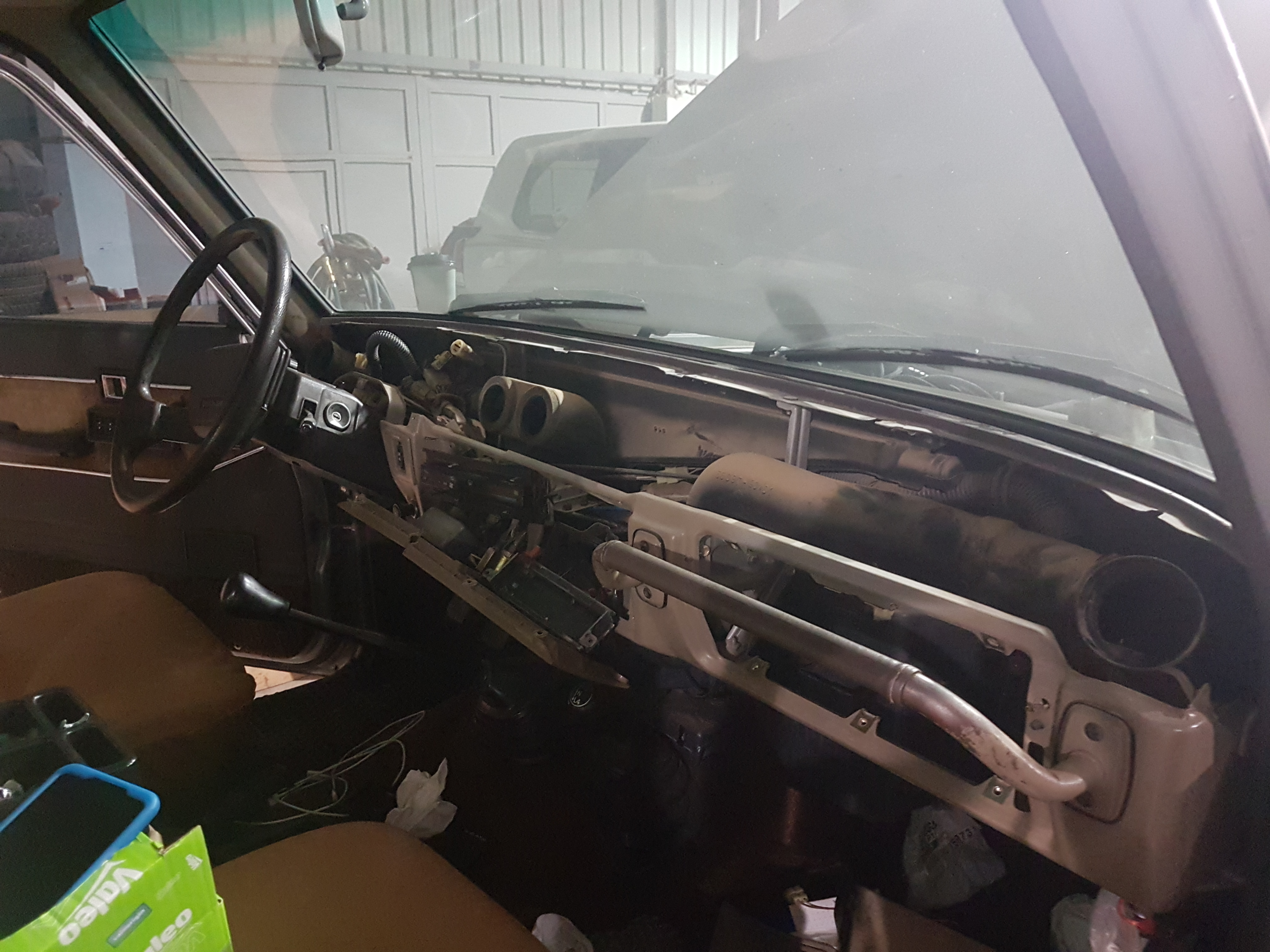

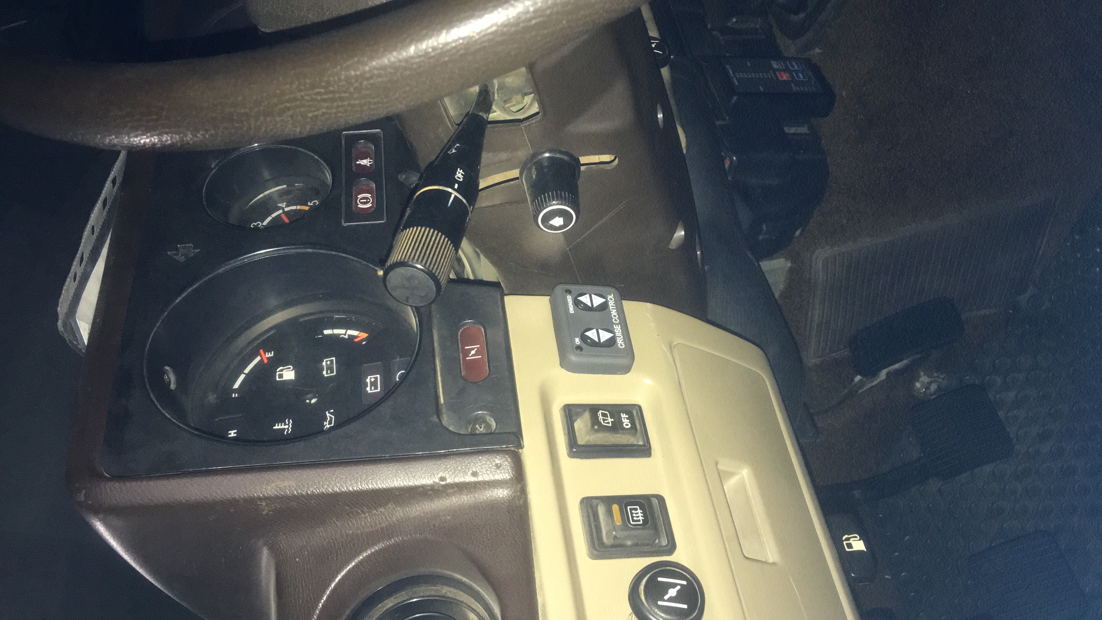

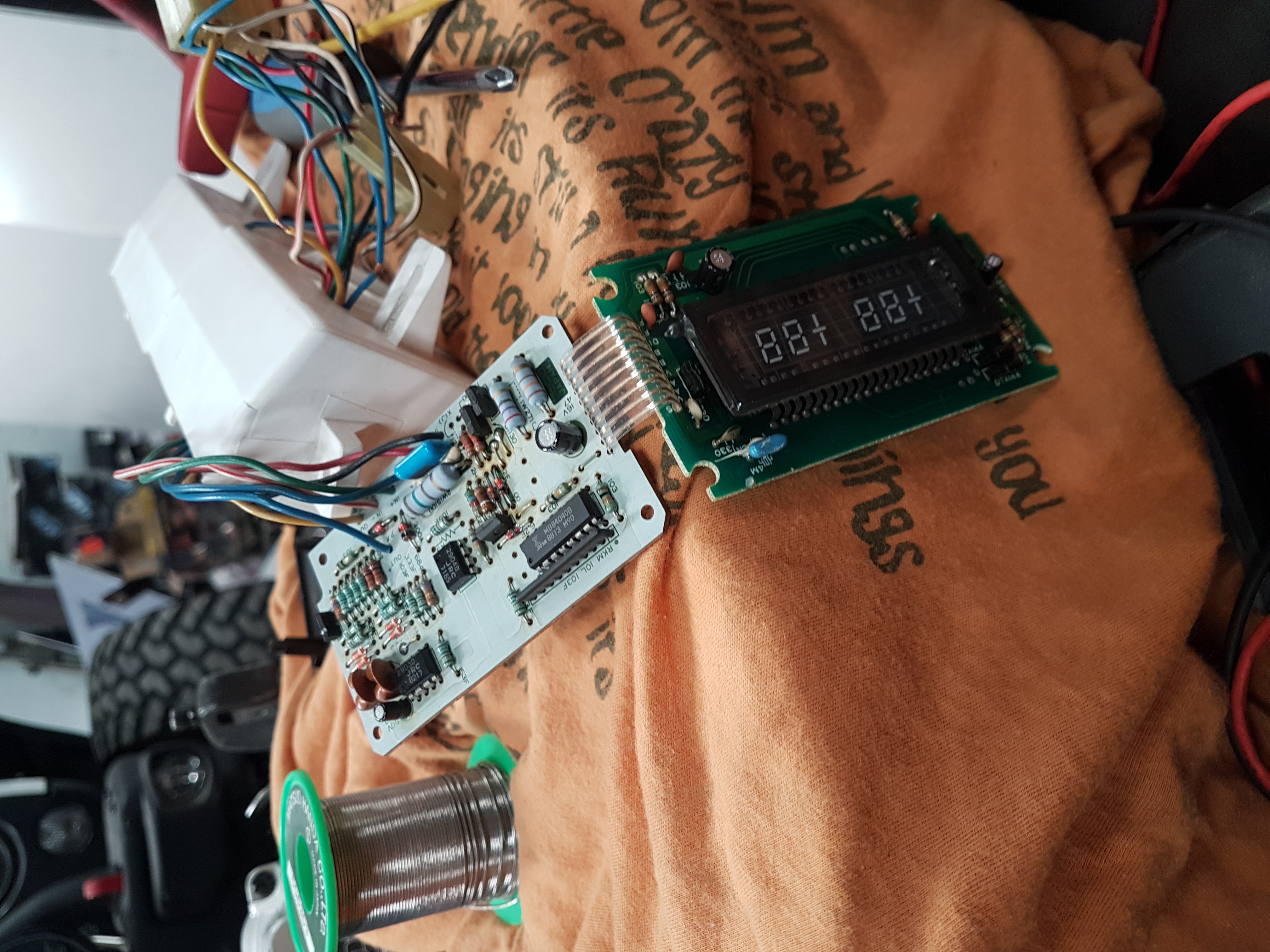

The dash got torn apart to install a stereo and thermometer and Garmin wiring.

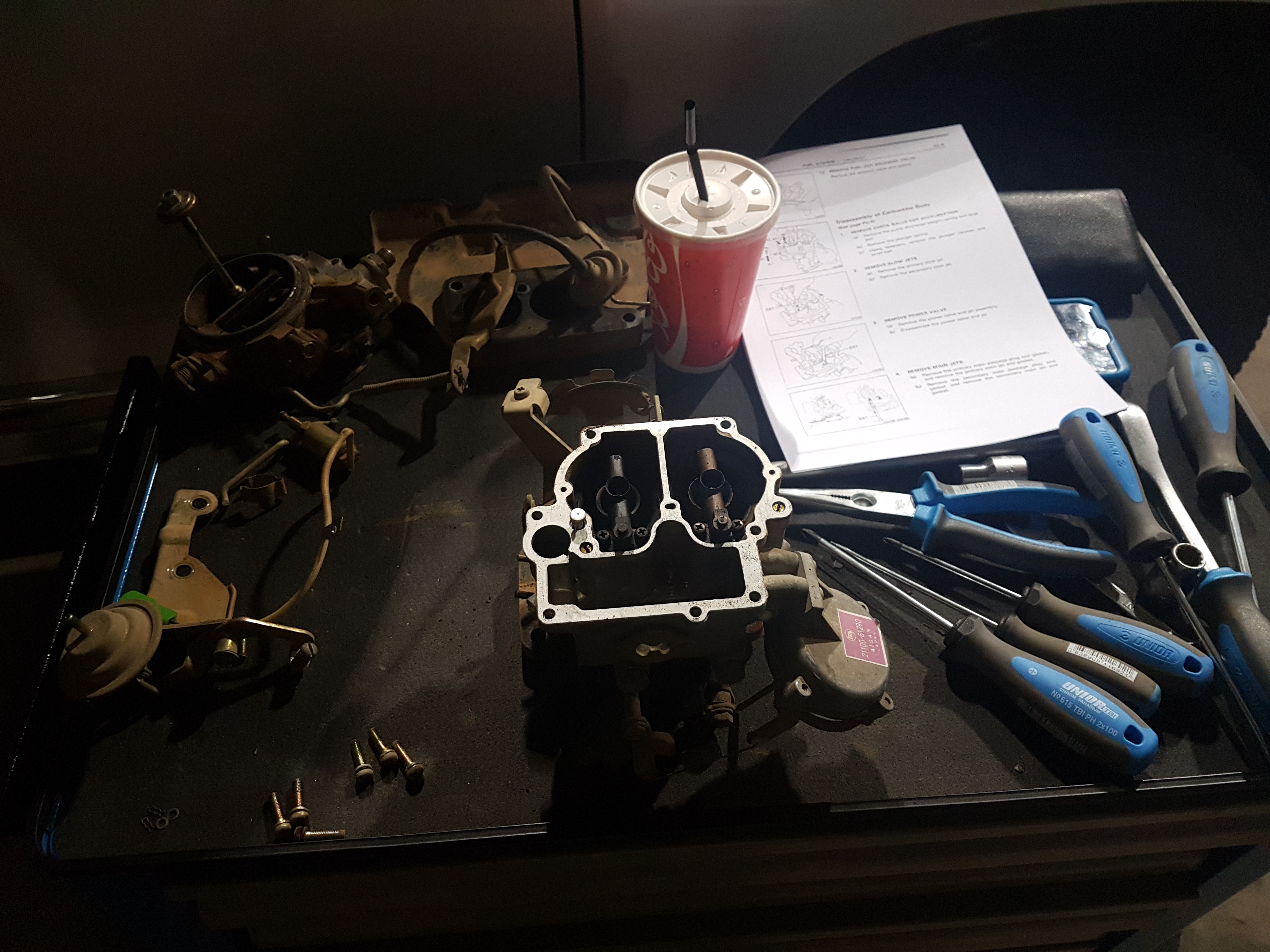

While I was waiting on parts, I took the time to go through the carb and do a complete rebuild. Lucky me, it needed a rebuild badly.

Side shot of the truck with the panel installed. excuse the silly paint on the panel. My powder coater was closed for the holiday.

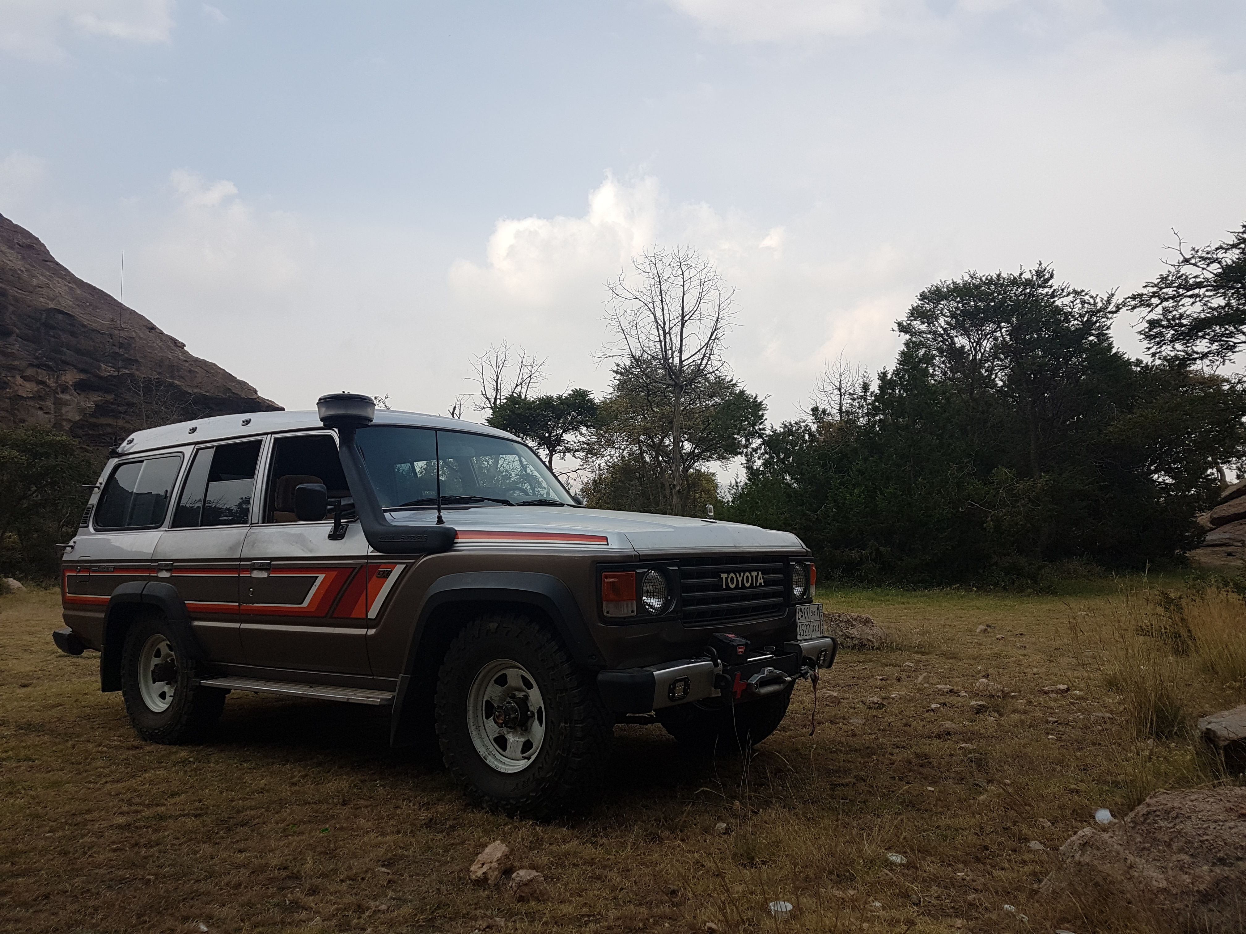

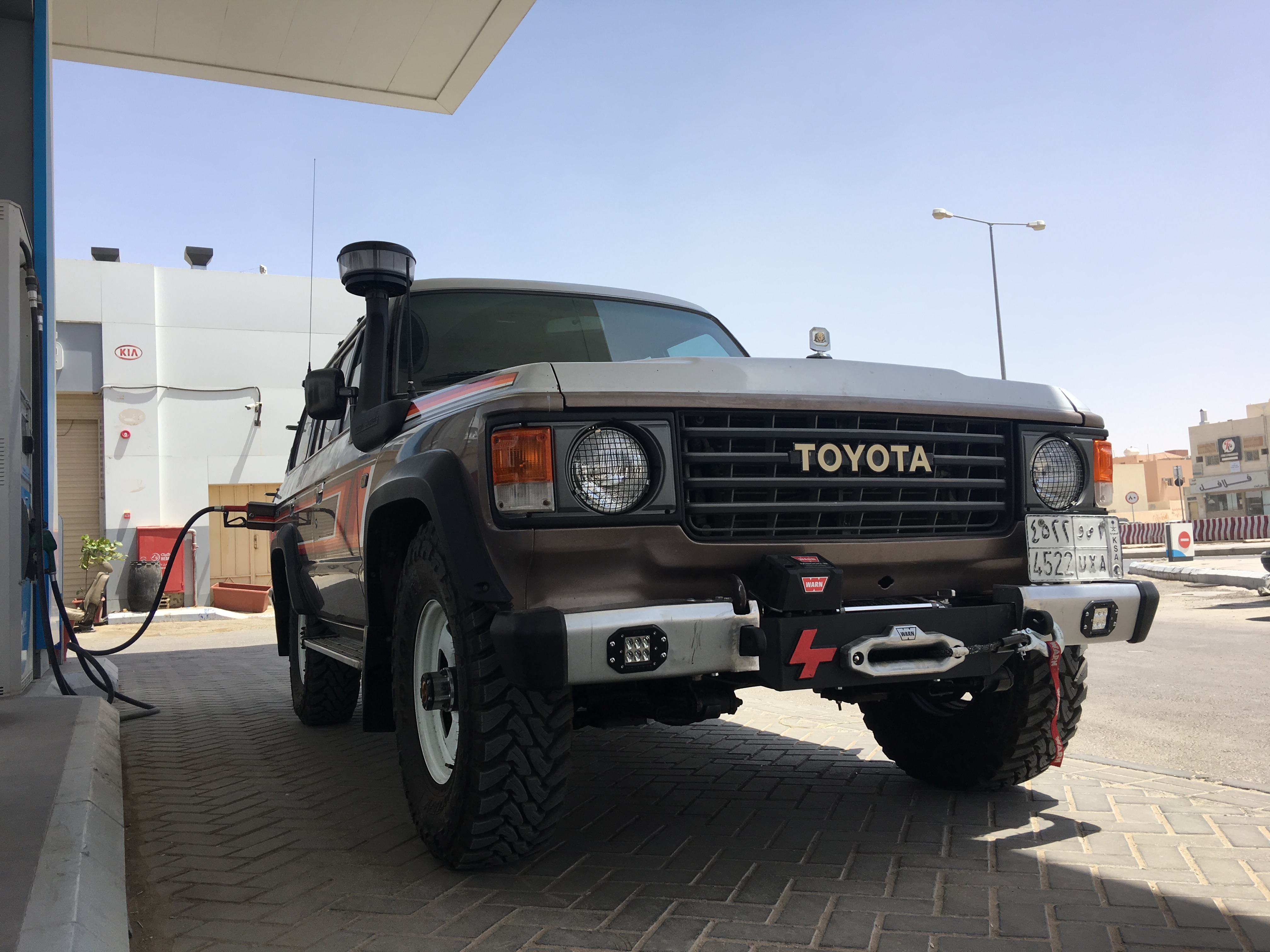

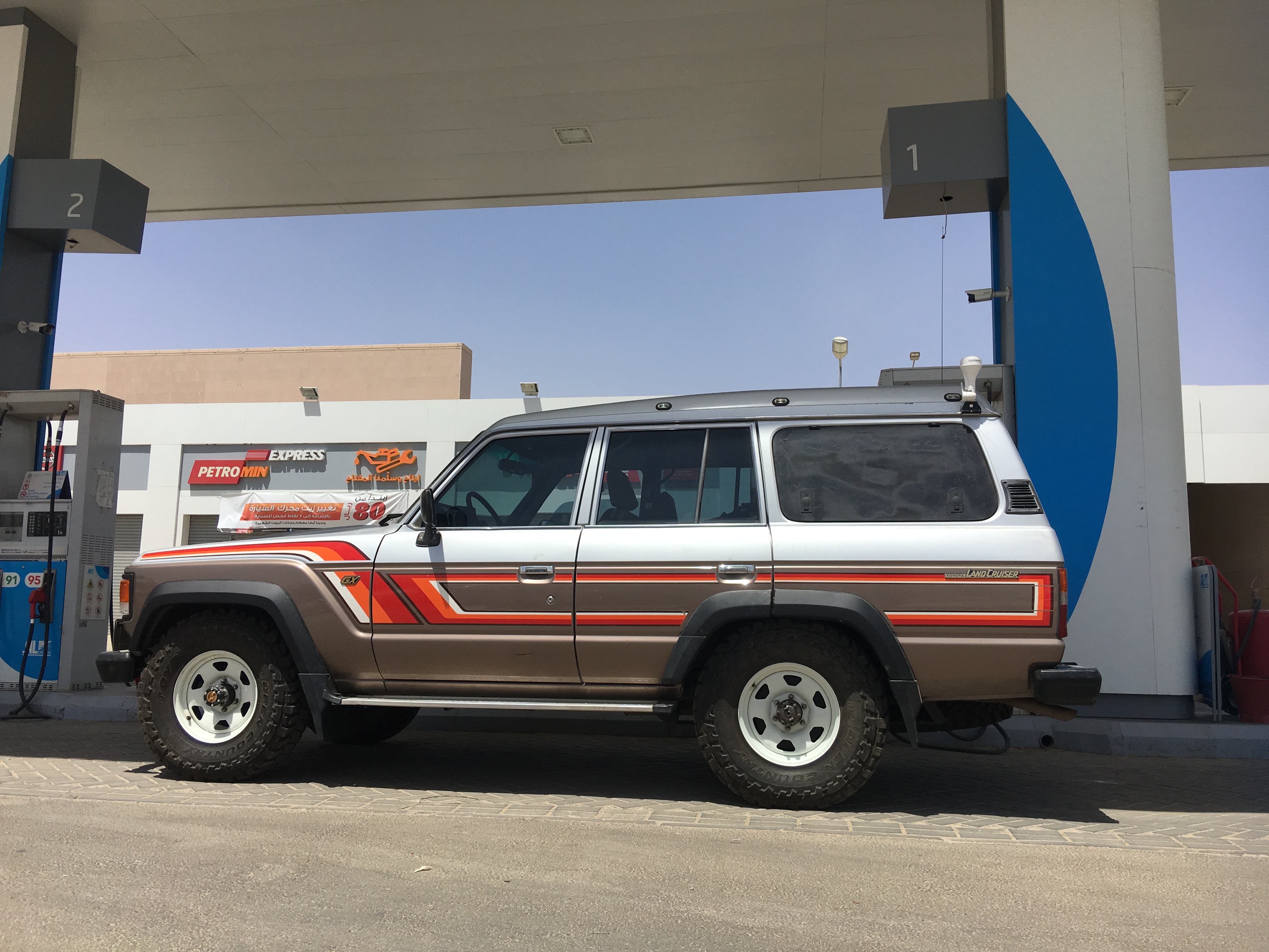

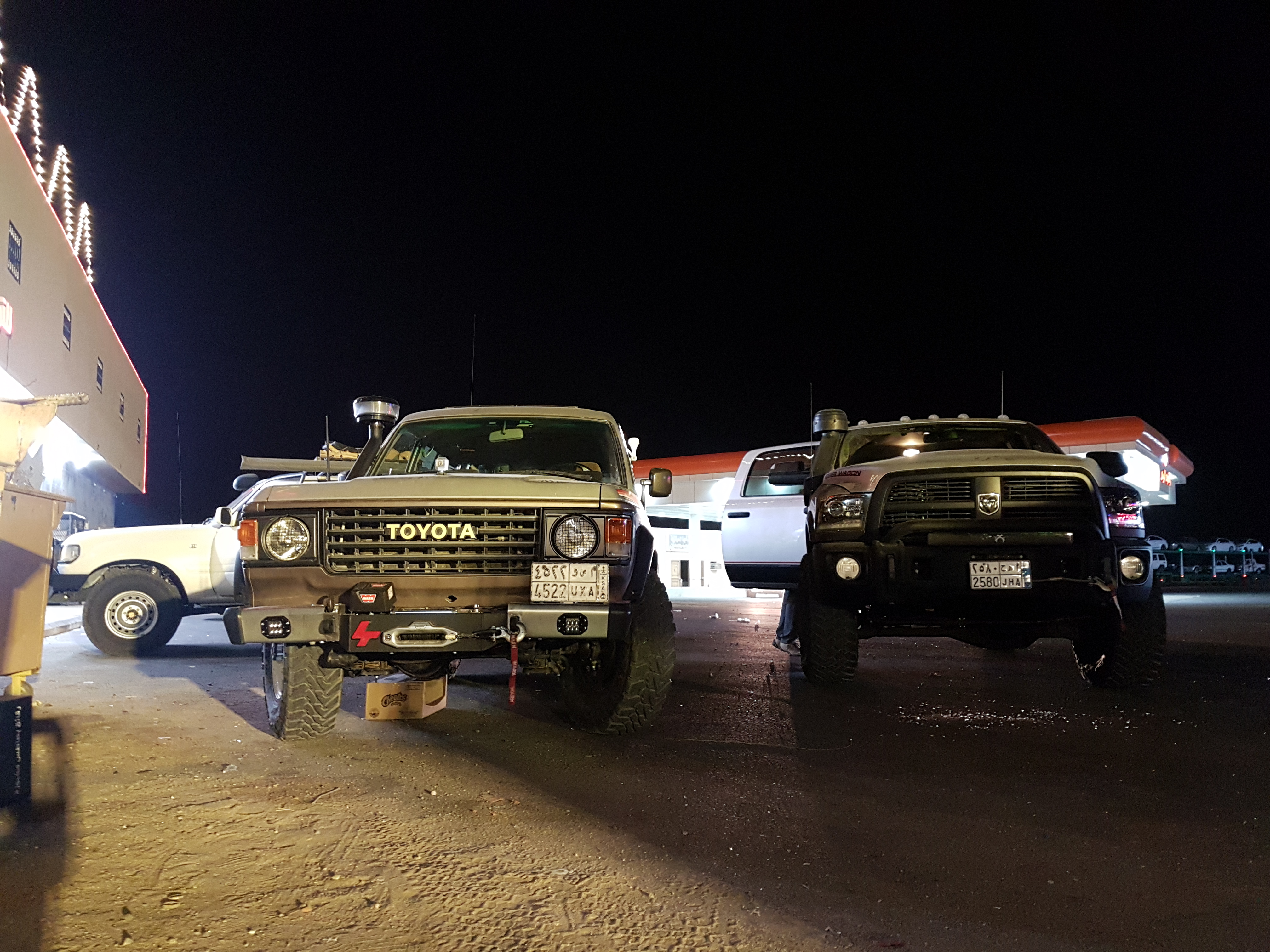

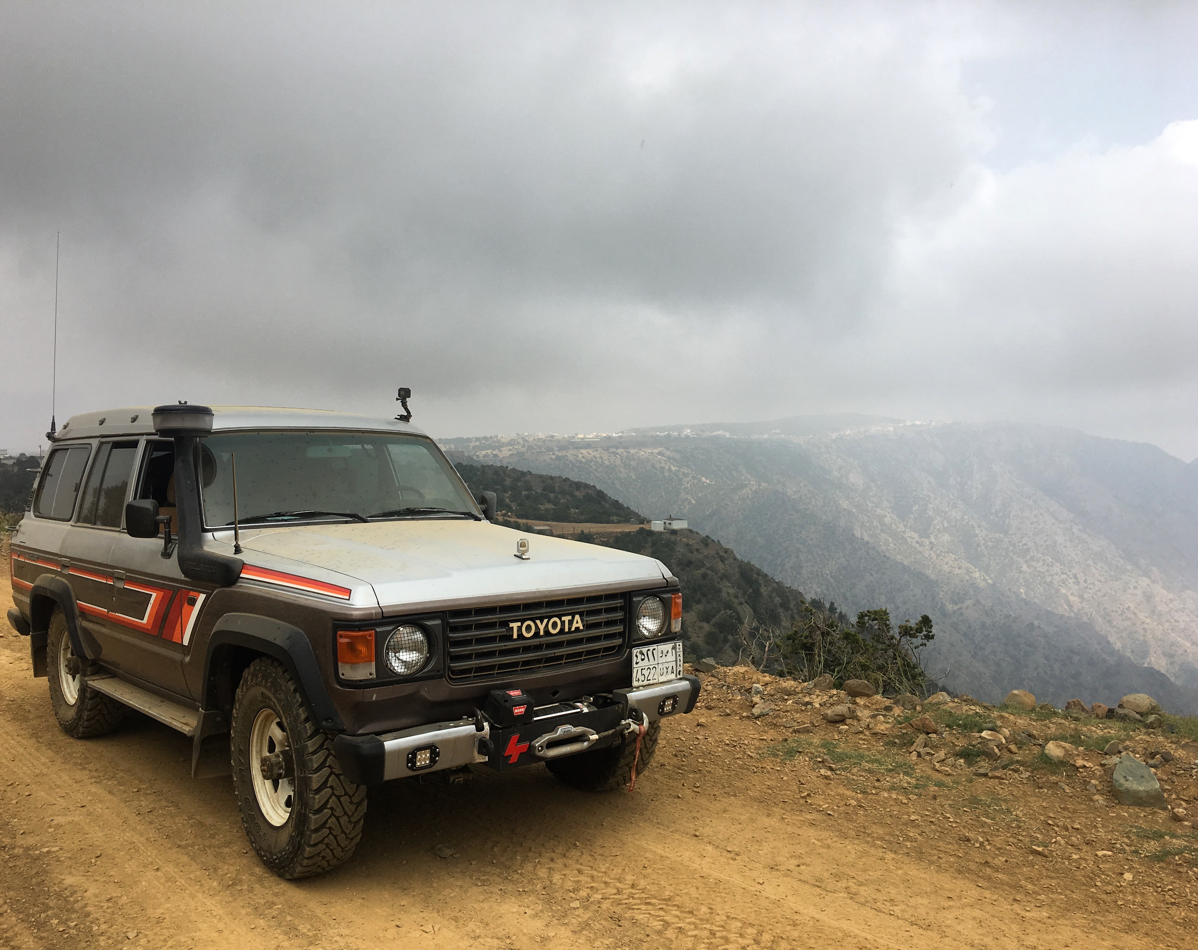

Some 300km on our 2000+km trip, we stopped for gas and snacks. As you can see, my 62 looks tiny next to the Power Wagon.
1000km later we arrive southwest of the kingdom and about 2000m higher in altitude.
Love how low it is. It sucks on bumps though. With all the new weight up front and in the rear, it keeps bottoming out.

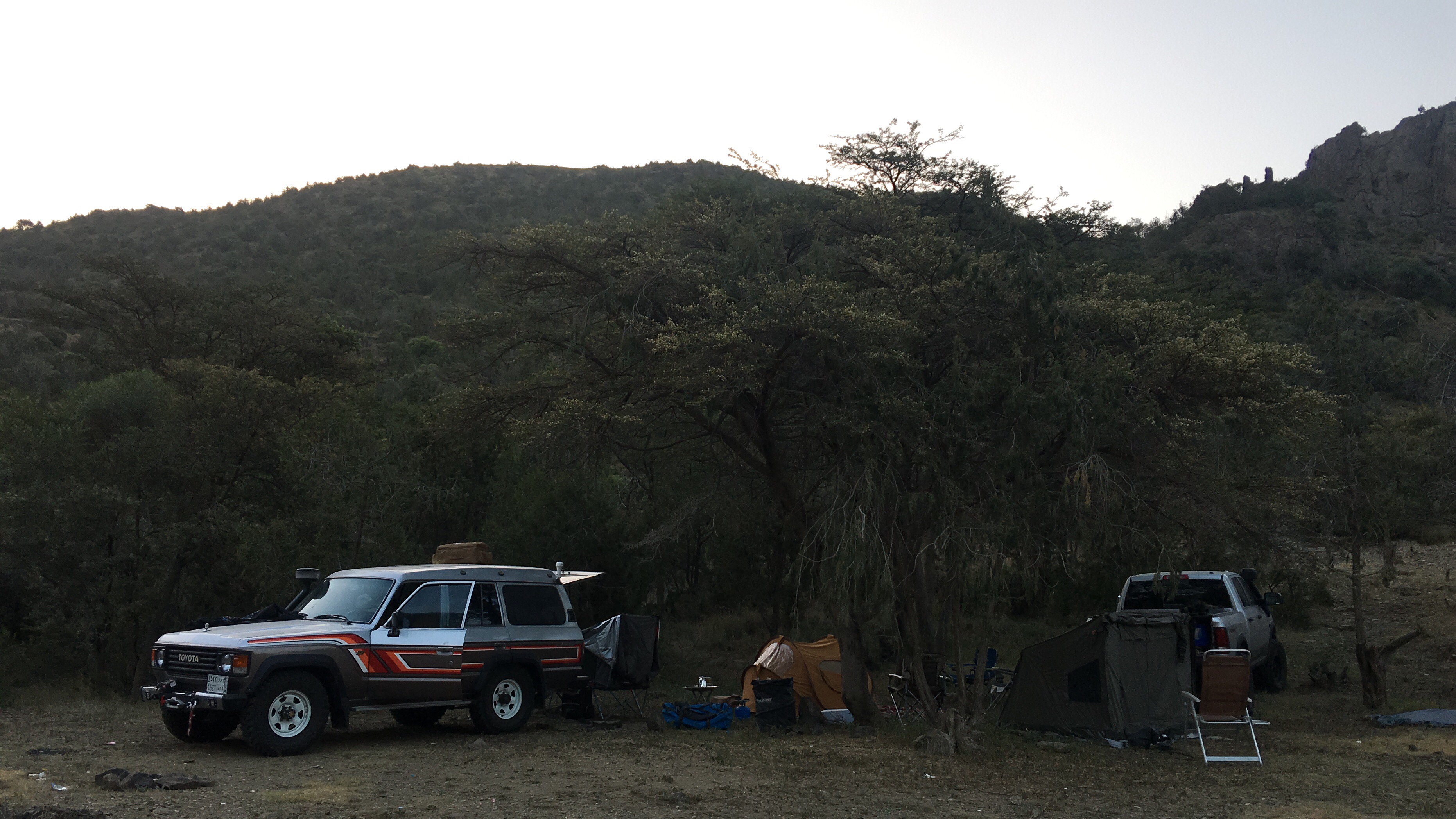

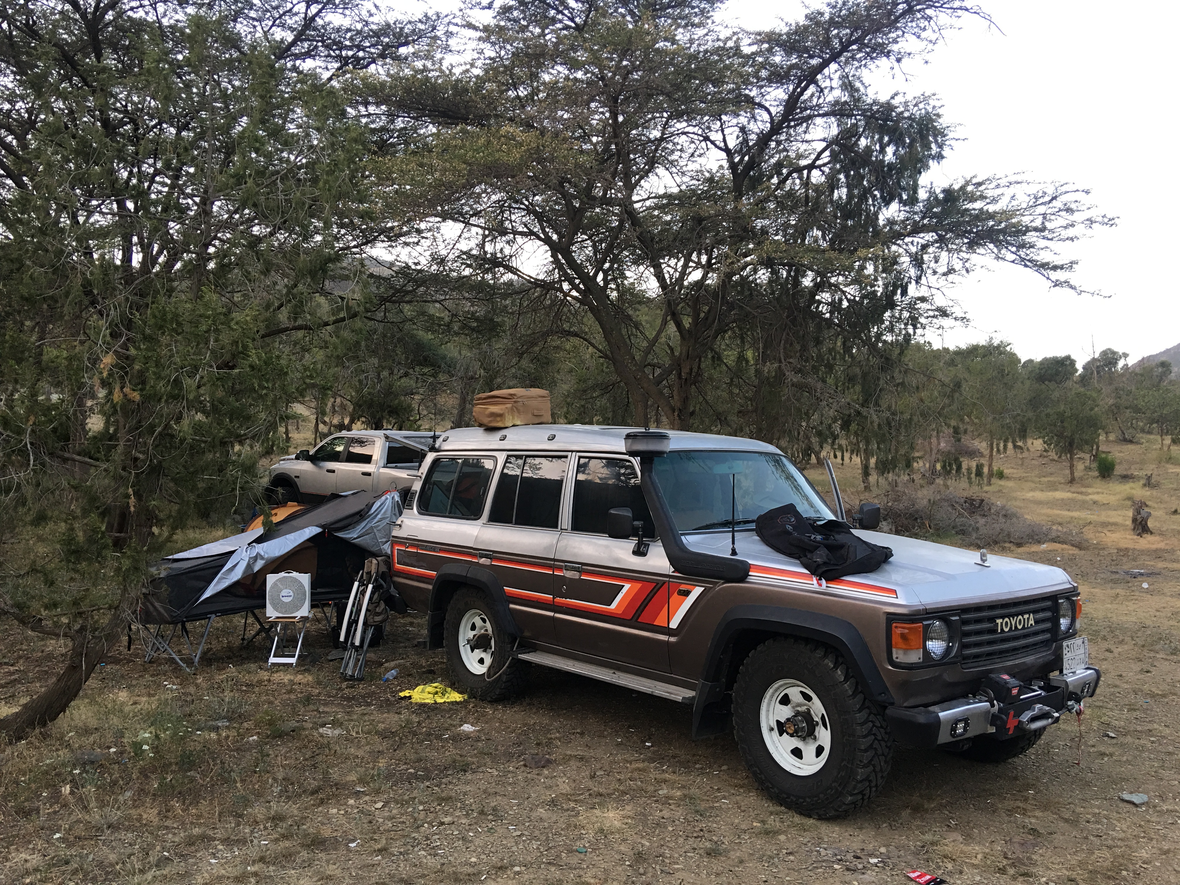

Camp location.

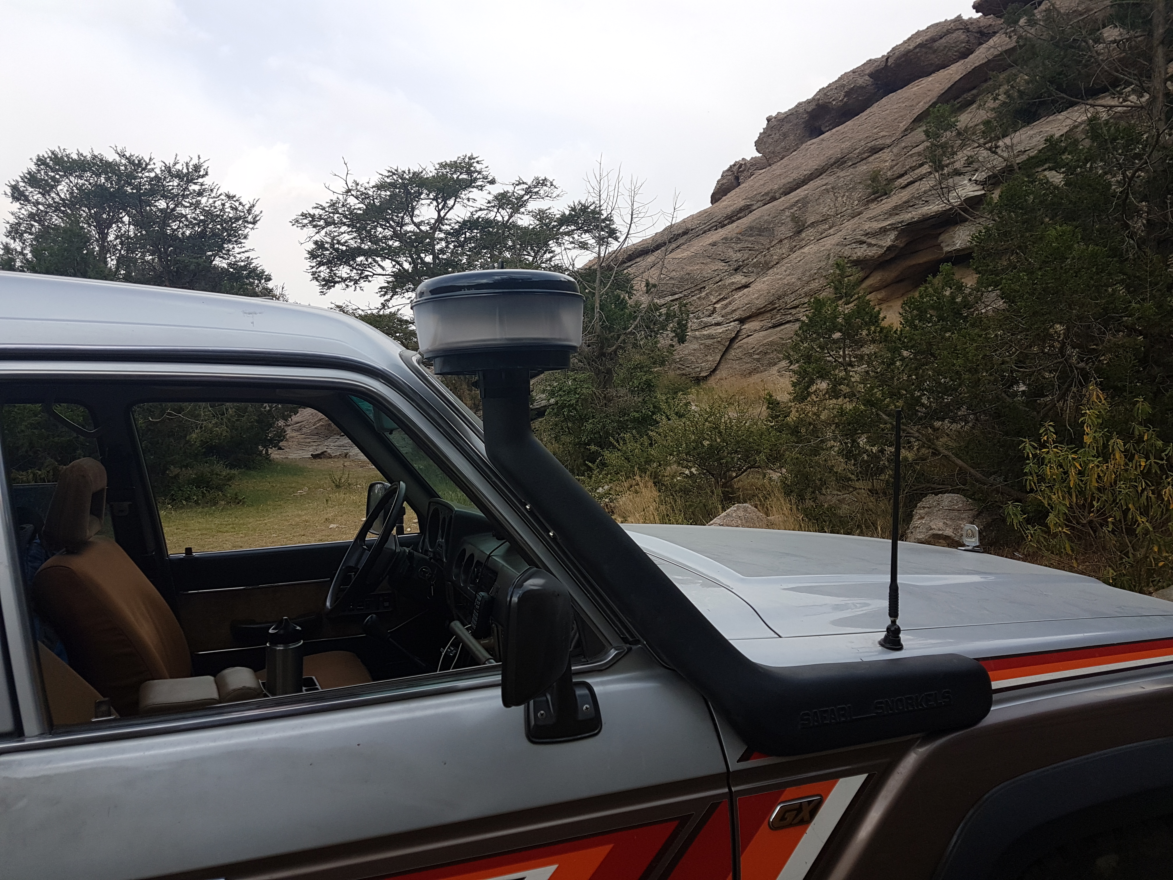

Snorkel with the clear view filter

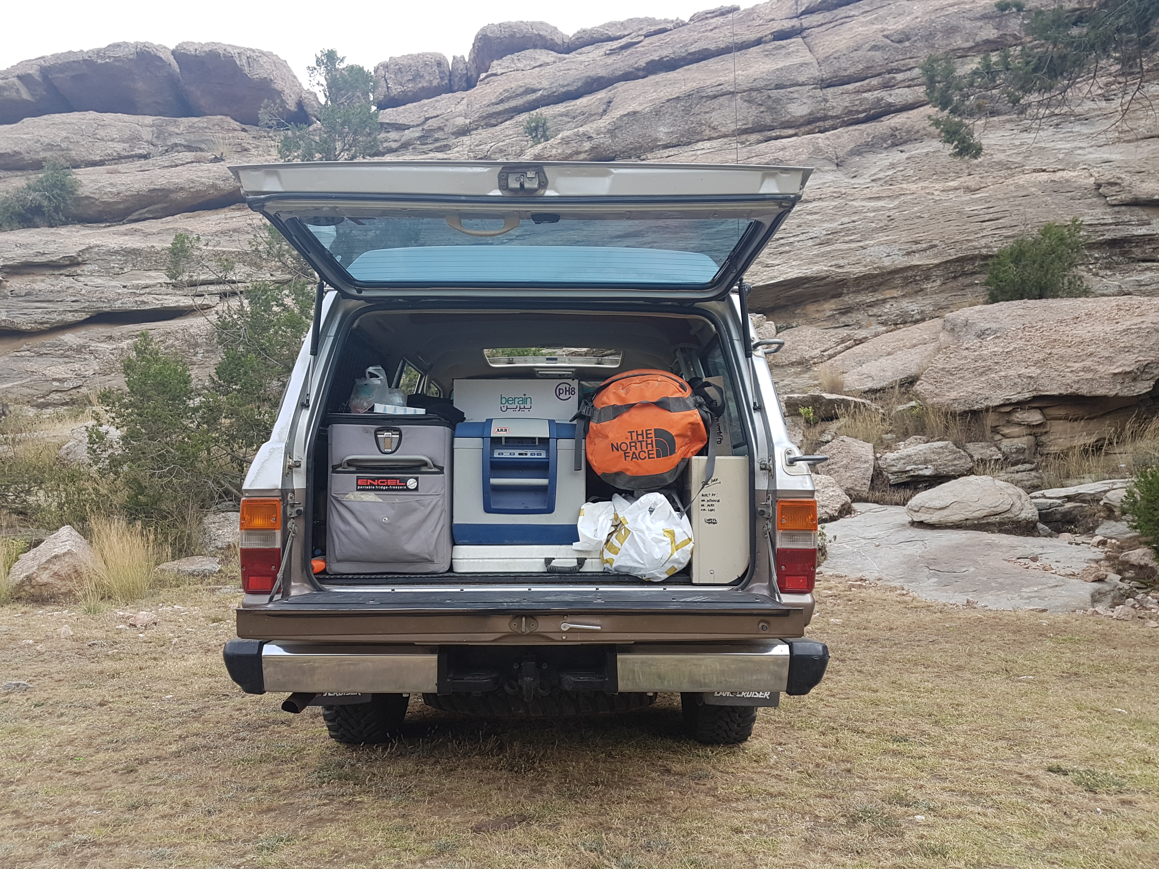

Cargo area!

The panel in action. No rattles no noise. Sealed real good!

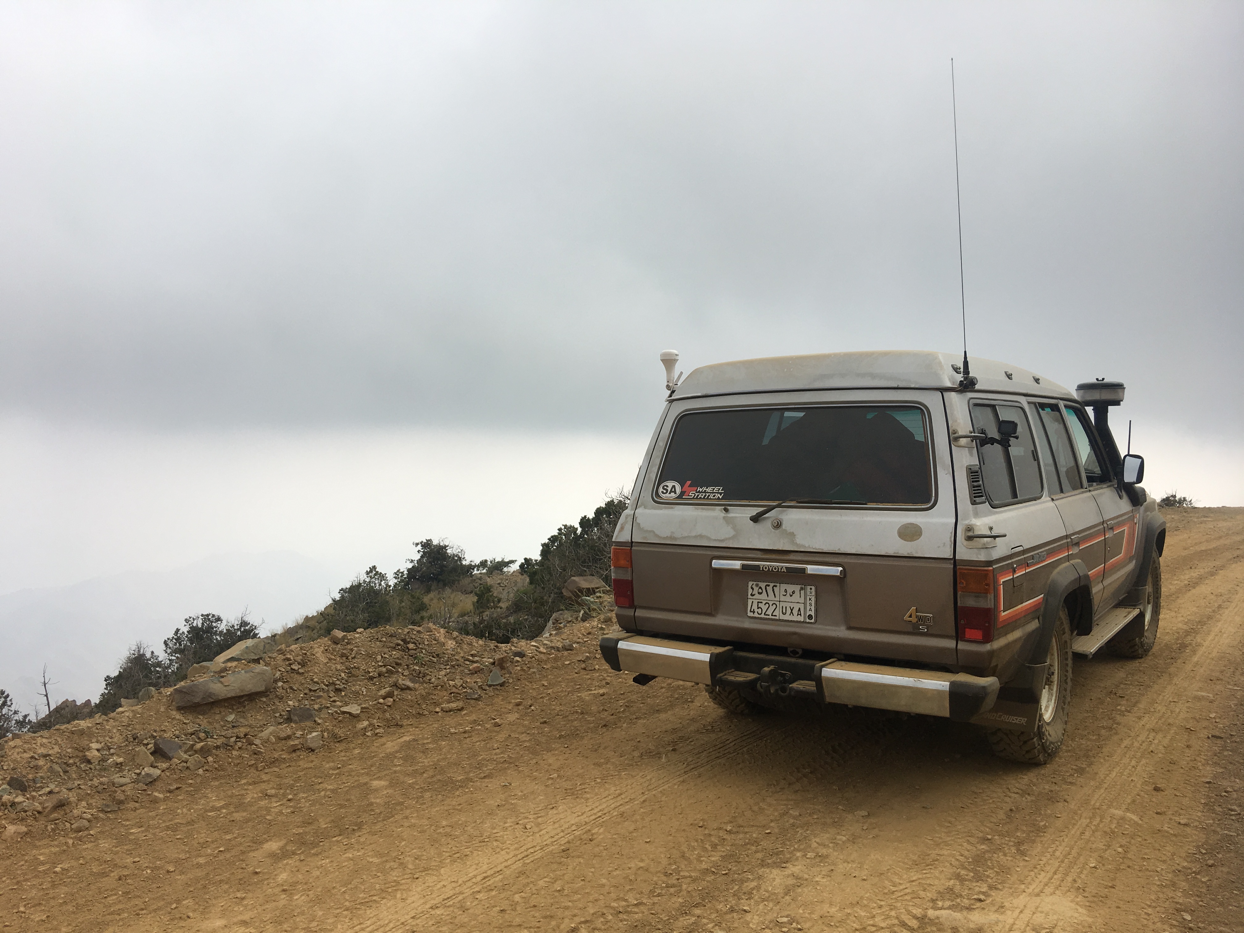

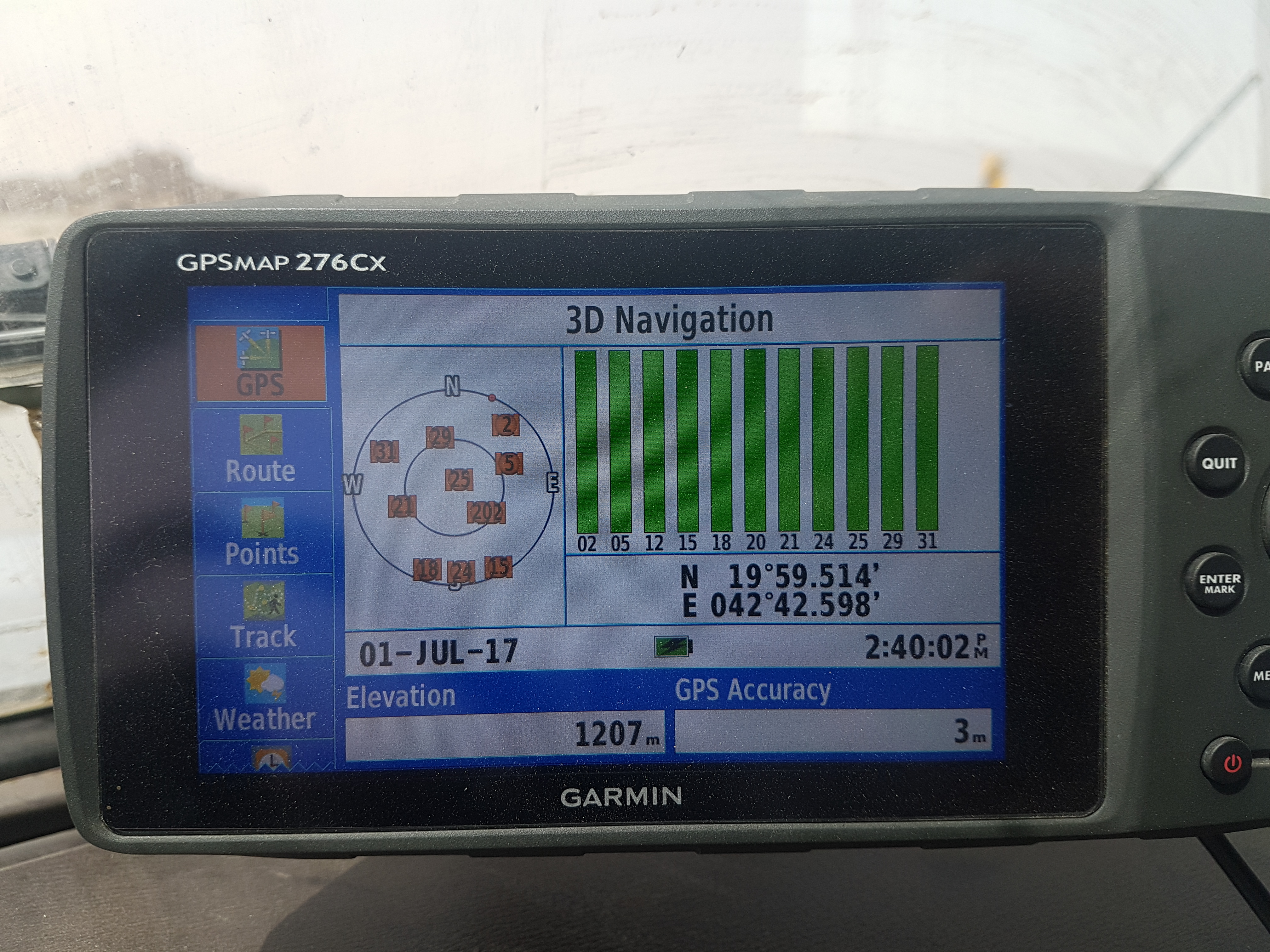

Reaching the summit of Saudi Arabia. 3000 meters above sea level.

Shortly after getting back, Rafiki gets a 2" OME lift.

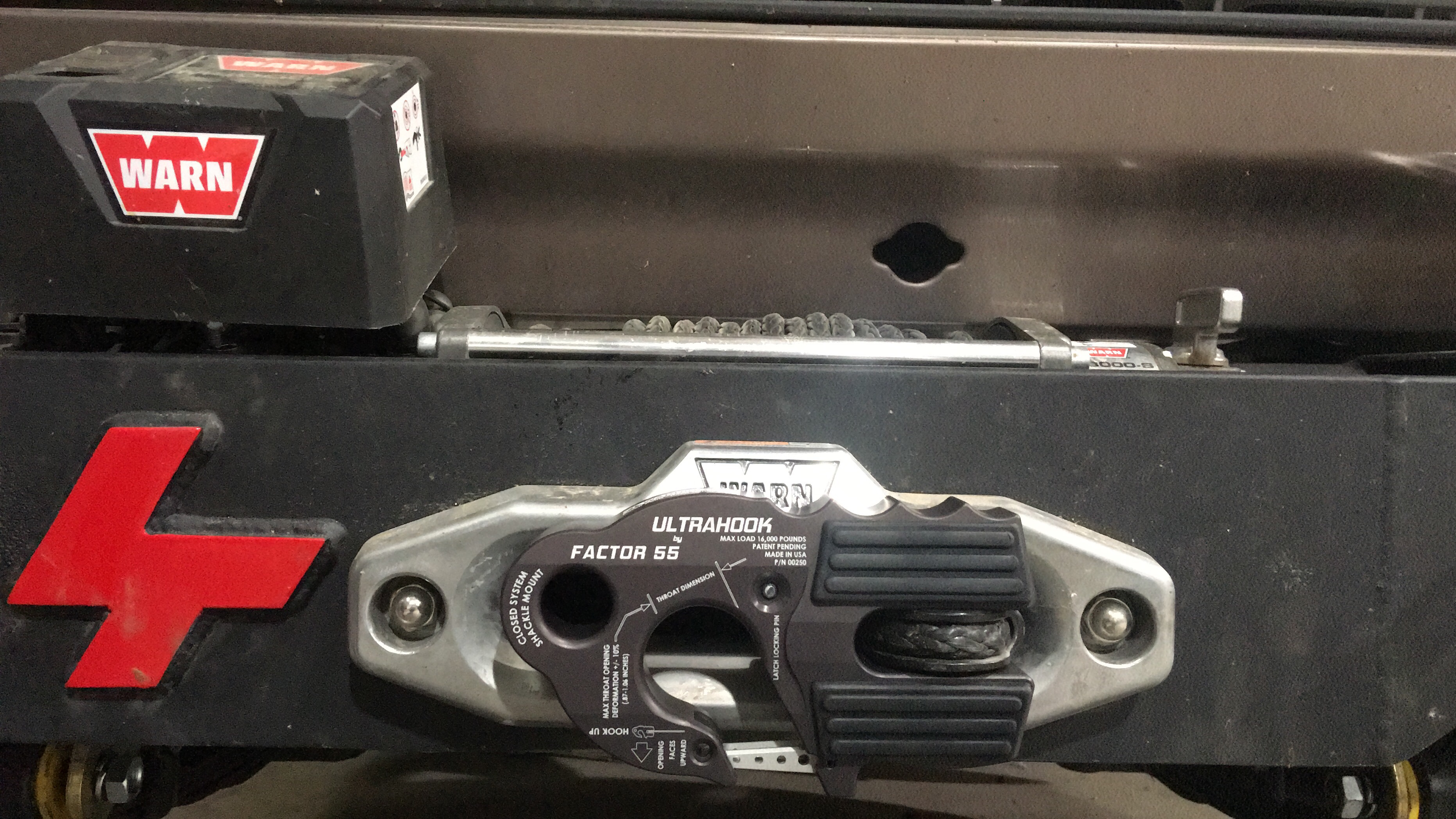

Here is a shot of the Factor 55 hook.

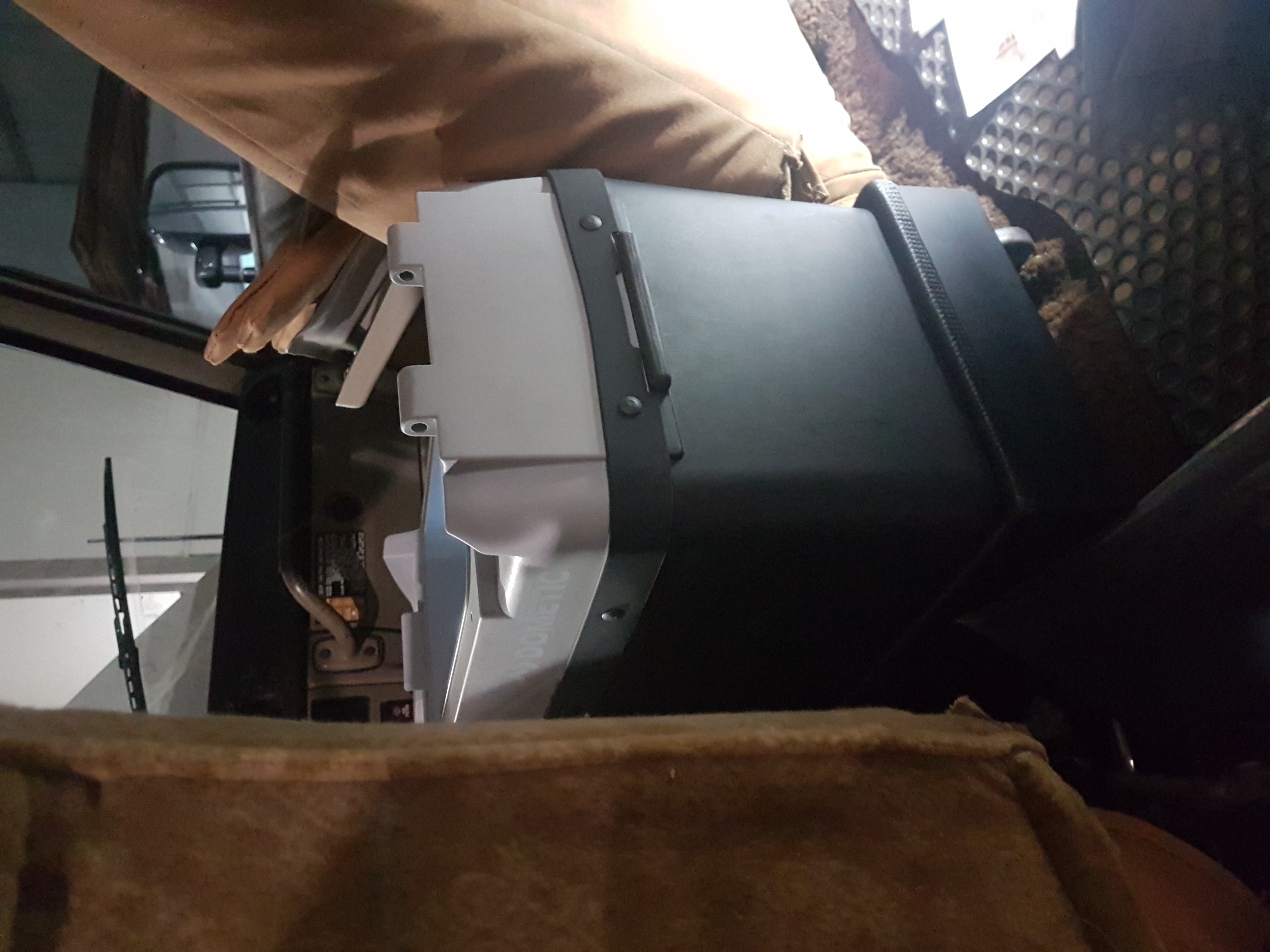

Removed the center console in favor of a fridge/freezer. The Waeco CDF-11 was what I decided on. It has cup holders built in.
So I fabricated a base bracket and hard wired it in.

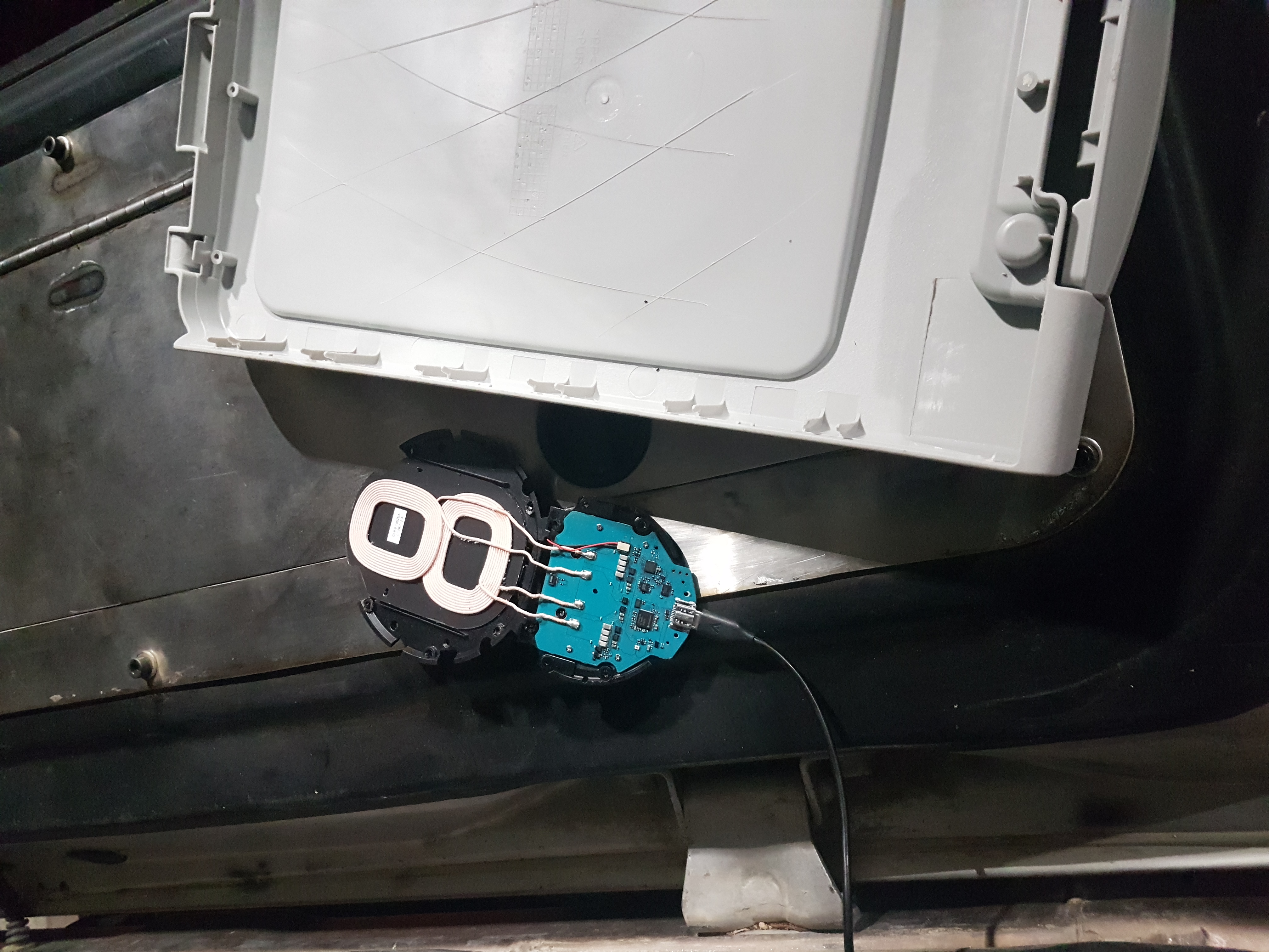

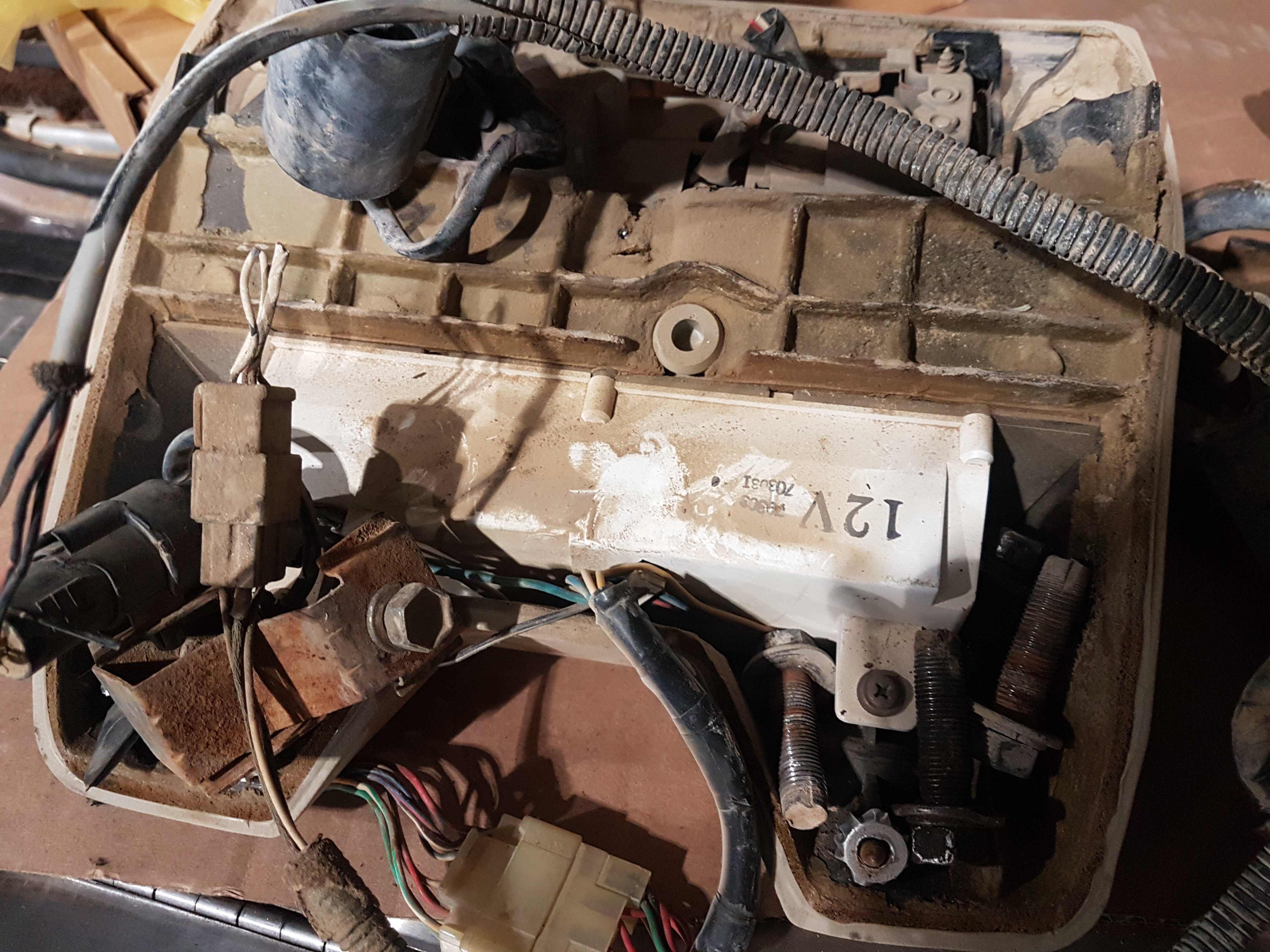

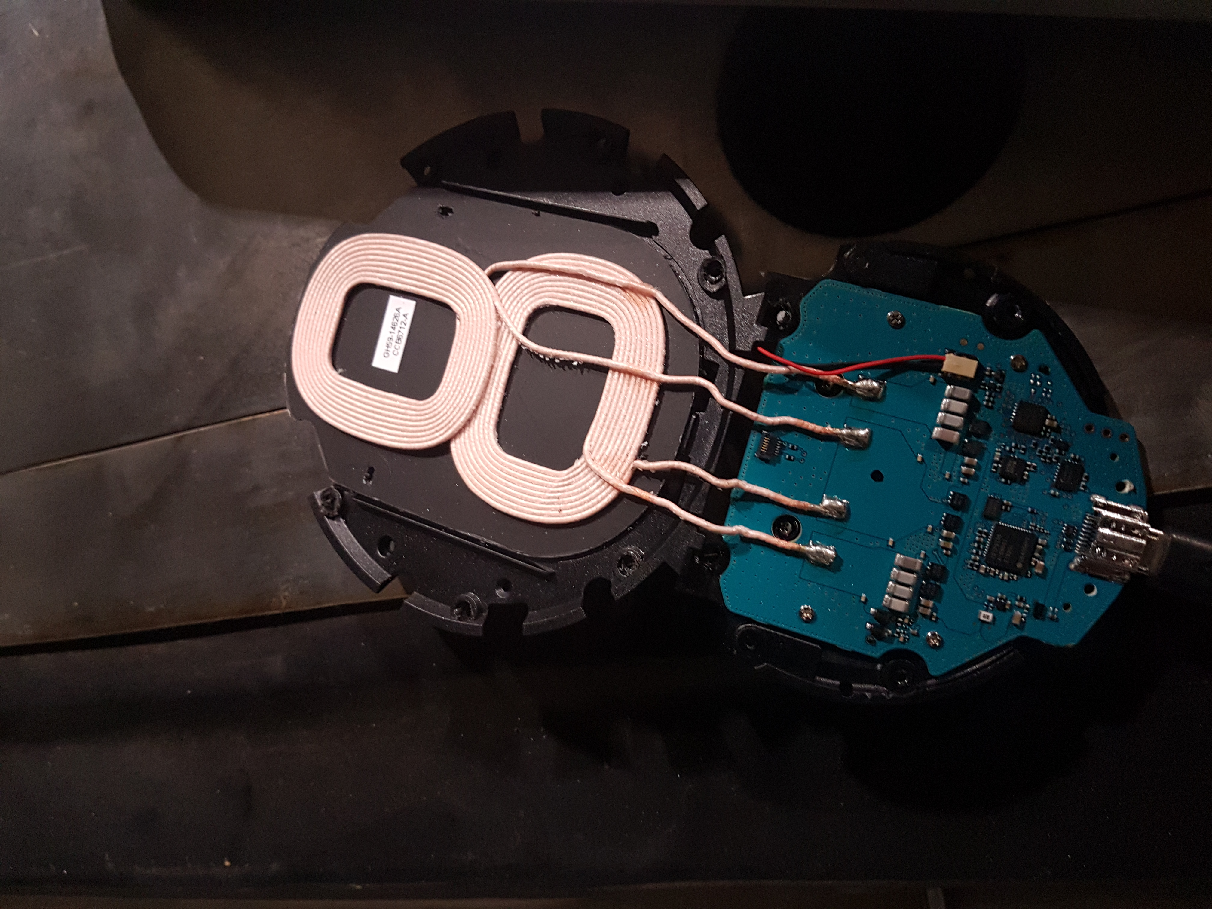

In the above picture, the lid was removed to try out an experiment. I have android wireless chargers everywhere and wanted to try to integrate the charger into the lid. And so, the new fridge was taken apart. Removed the lid and took it apart. Also took apart the wireless charger.
The charger has a fan to cool it down. And the lid has foam to keep things inside the fridge cool. But I knew I wouldn't run the fridge all the time, and with our hot weather climate, it just didn't make any sense to not address the ventilation. The lid is constructed of two shells sandwiching foam in the middle. All I did was make room for the charger. And also create a passage for air to ventilate if the fan kicks on. This could be a dangerous and hazardous attempt, but i'm being optimistic and I think I may pull it off. The charger will get hot while charging the phone. Will it get too hot? I'll have to test that out.

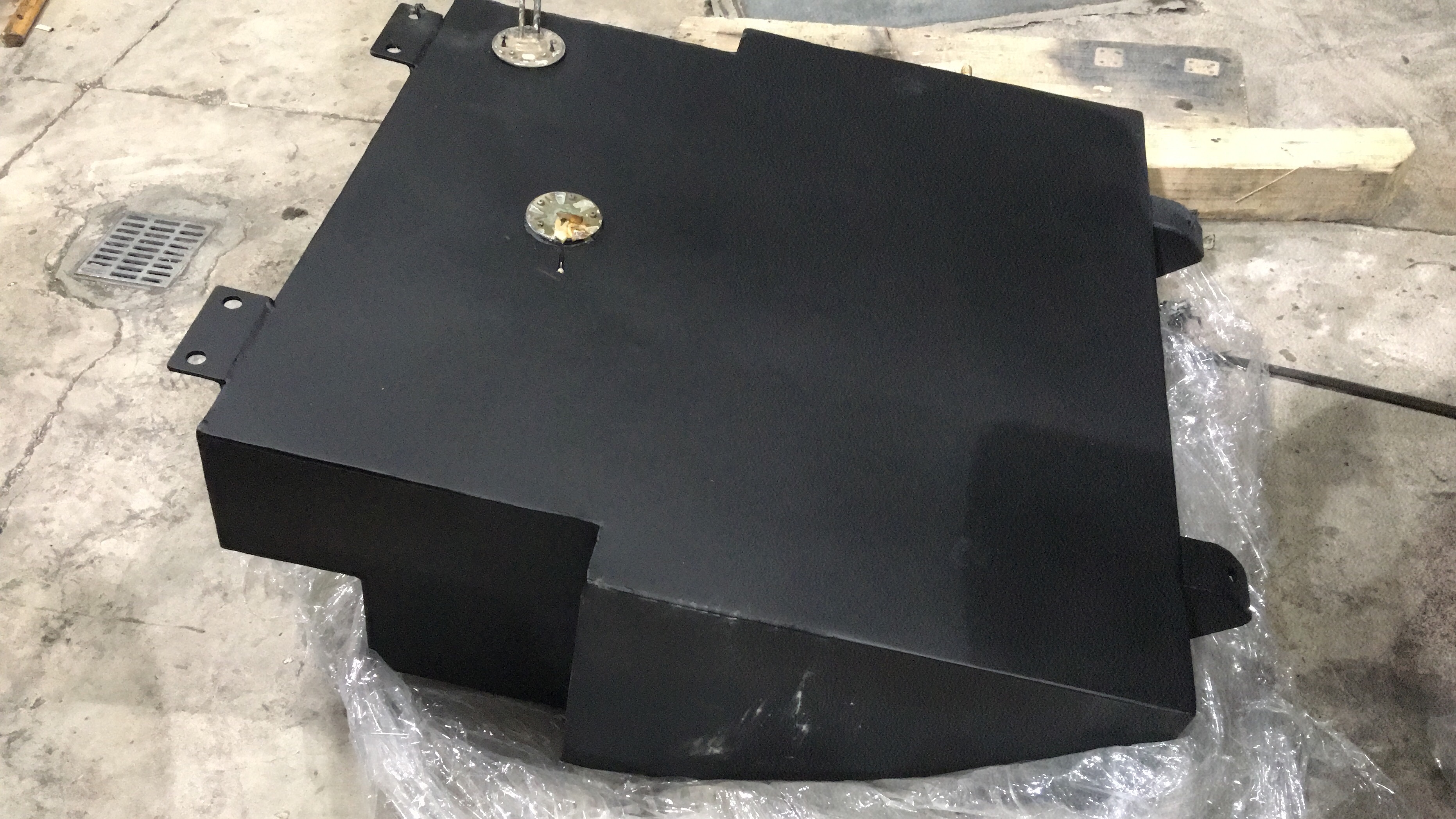

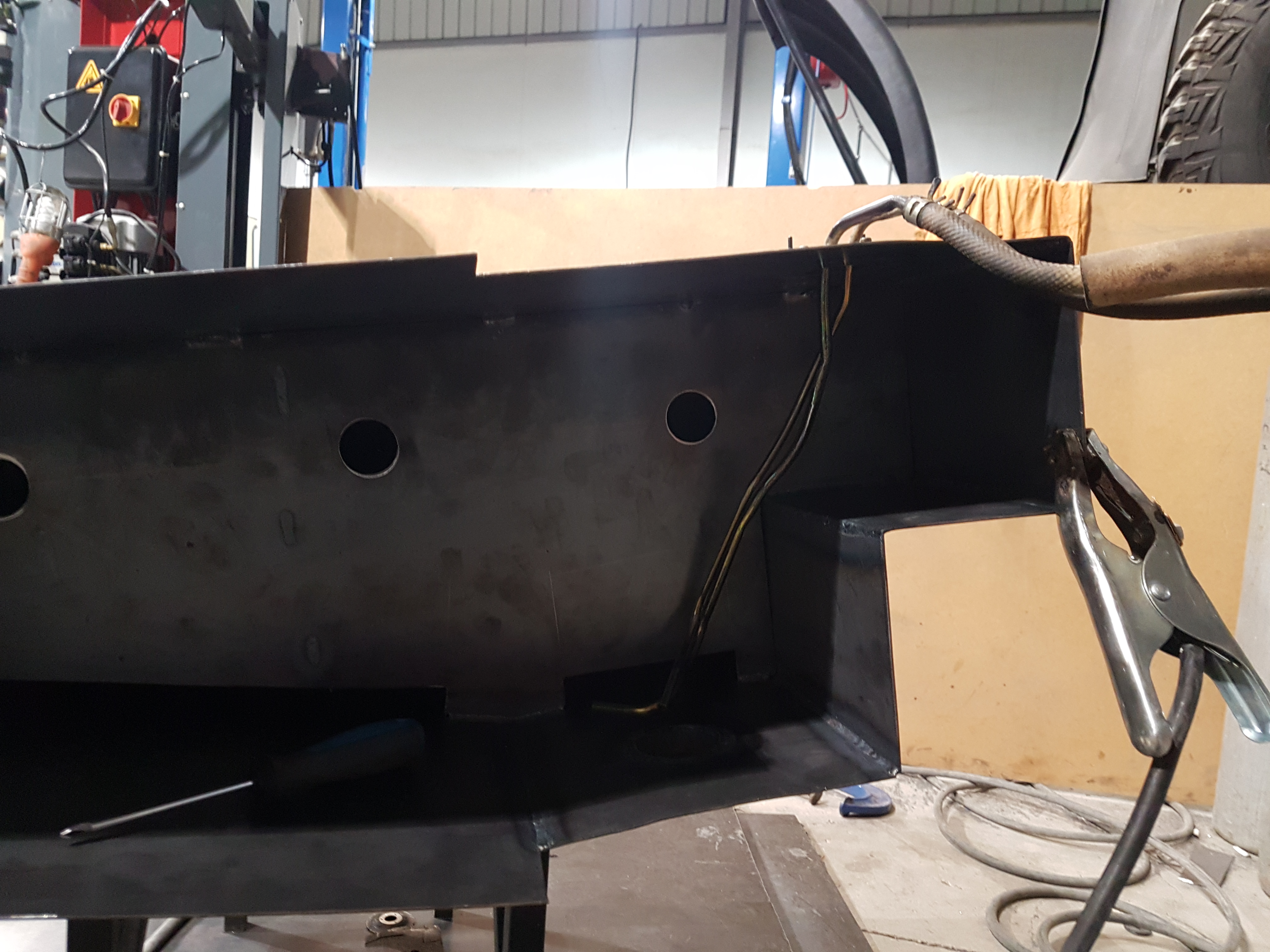

After that, I wanted to address the fuel consumption issue. the 3F properly calibrated goes through fuel like no tomorrow. I couldn't stand the range i'm getting from it. So making a fuel tank was next inline. Expecting 210L+ out of this replacement tank. The fuel tank is only a patch till I diesel swap the truck. I should also apologize for the dirty work shop. We are expanding our facility and making changes. Ignore the mess if you could.

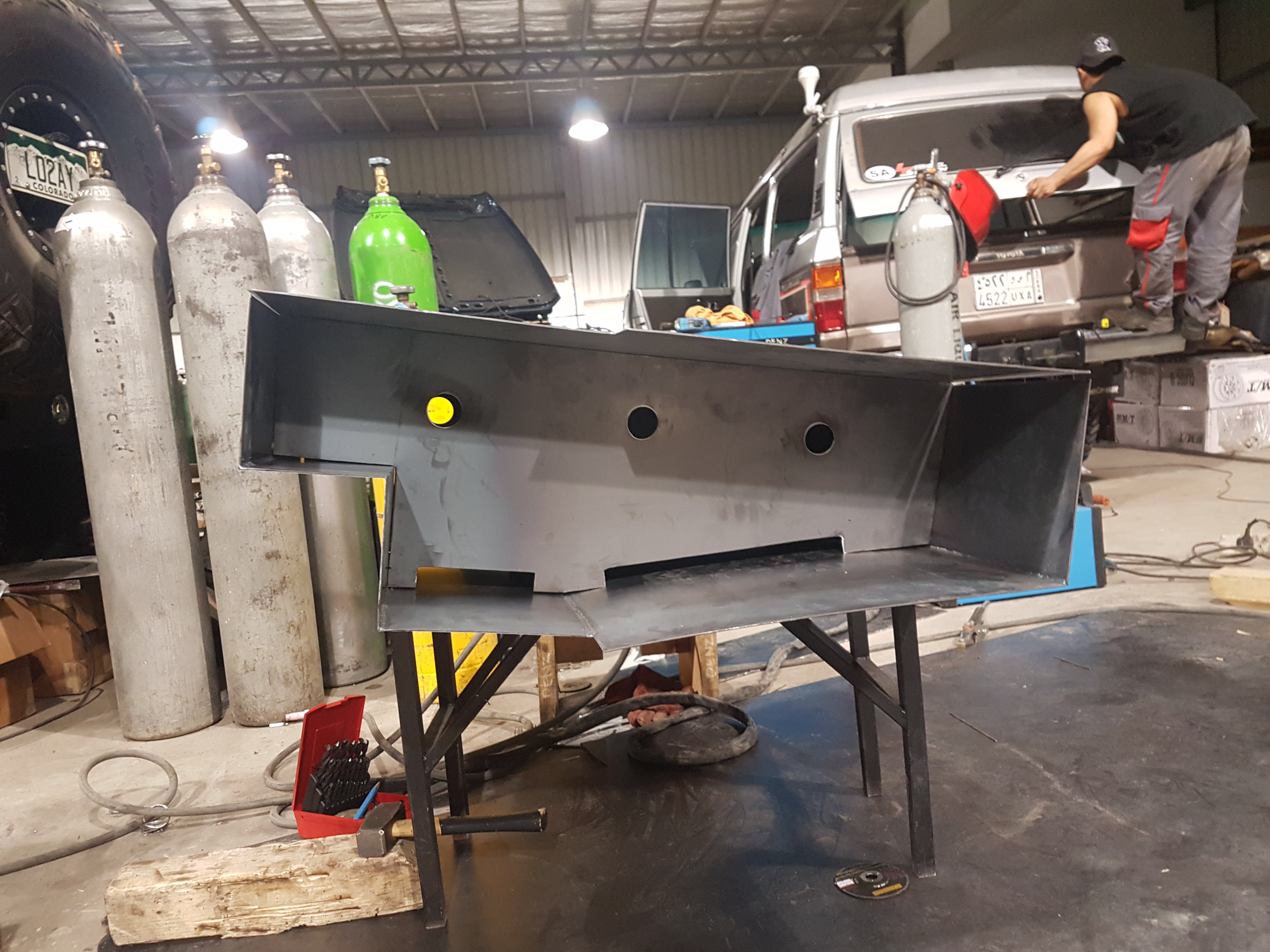

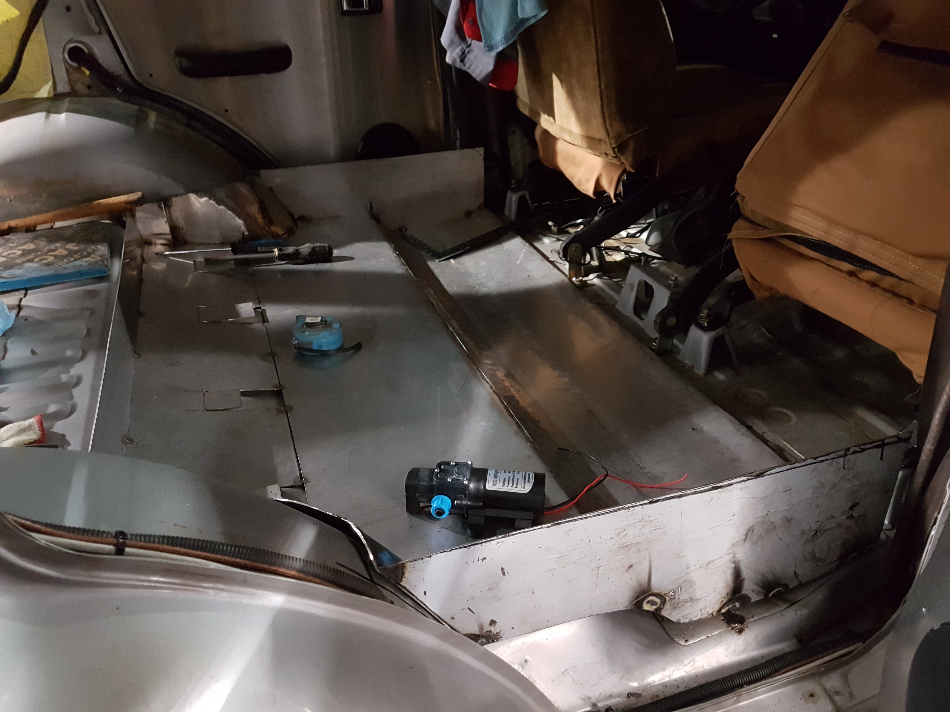

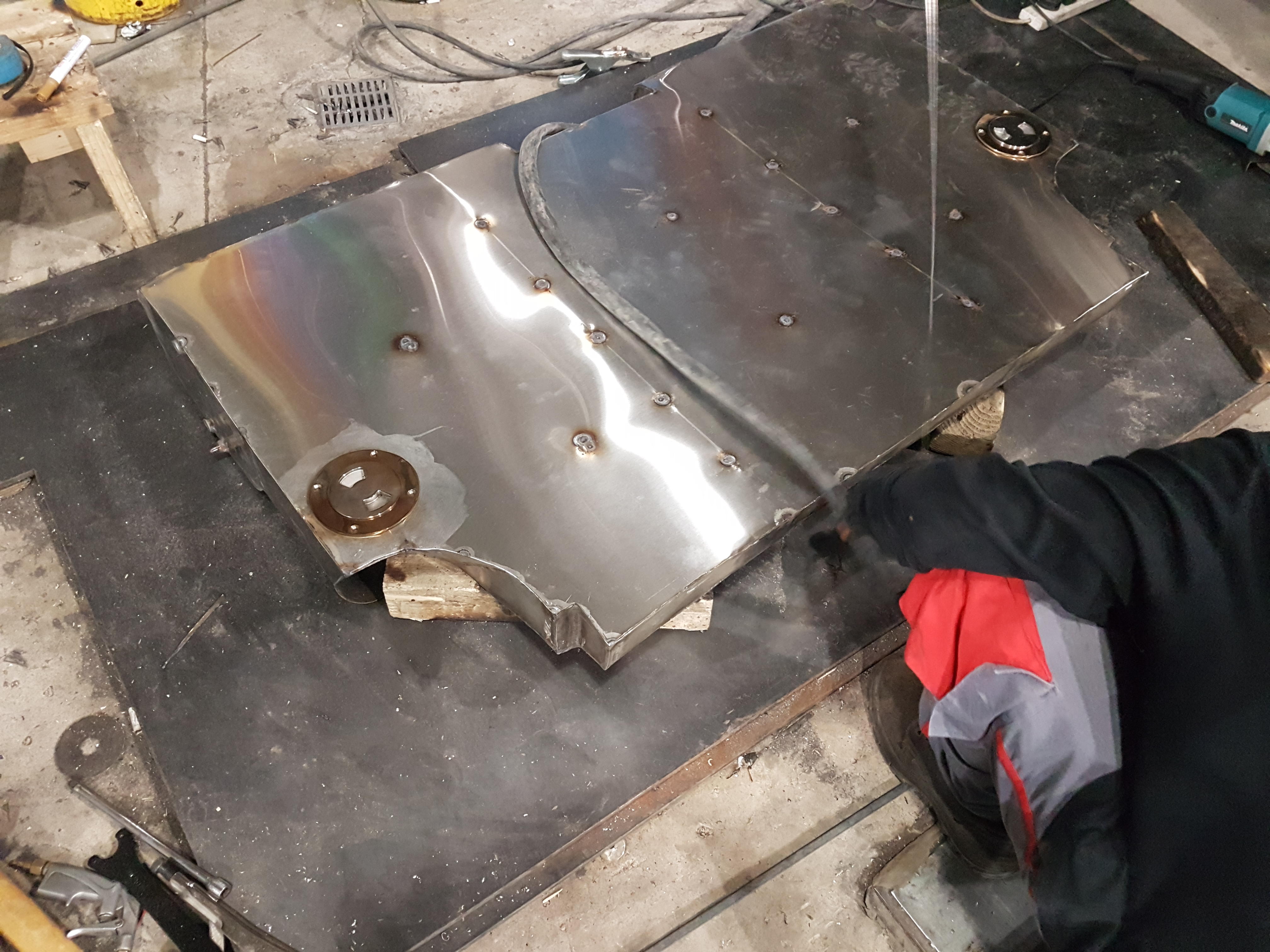

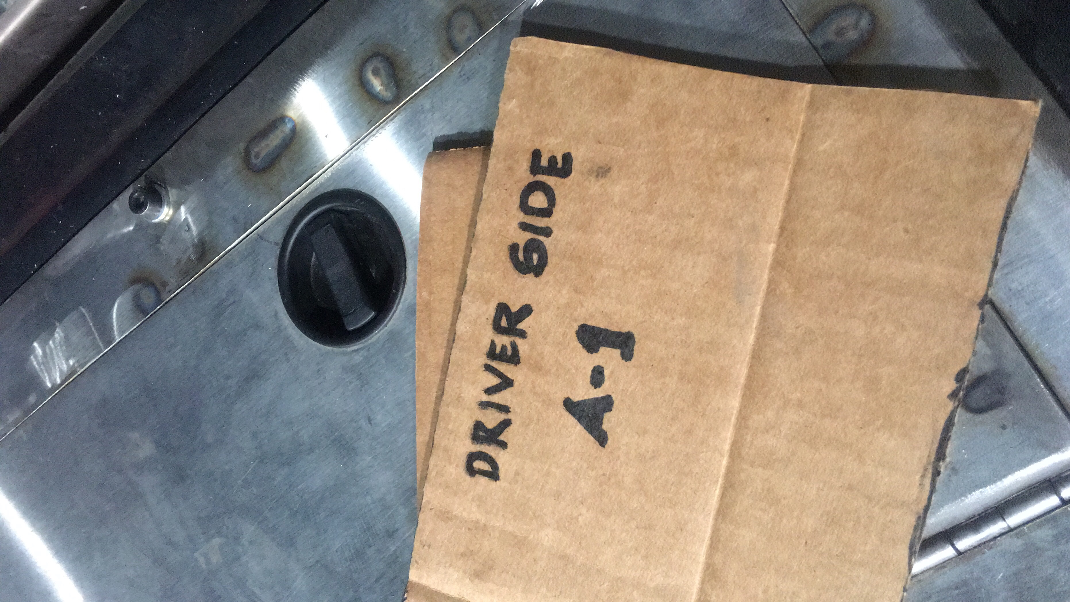

If you live or adventure in the desert a lot, you know that lots of water is critical to have. The tank you see below is taking the shape of the floor and leveled with the cargo area. The tank can be removed using existing factory bolts and the factory rear seat can be reinstalled.
The tank is made out of stainless-steel.
Barriers were added inside. This is one of the templates used.

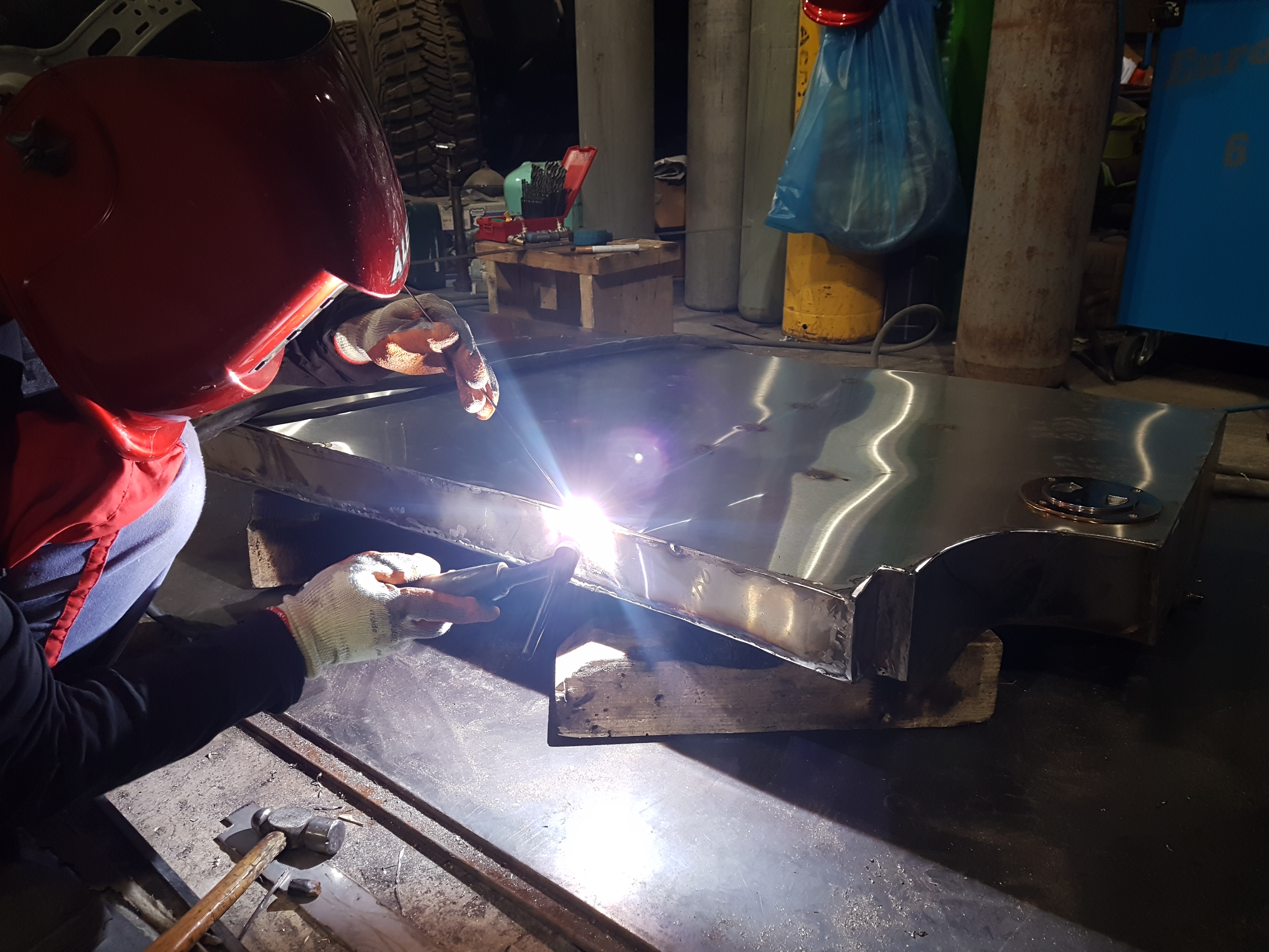

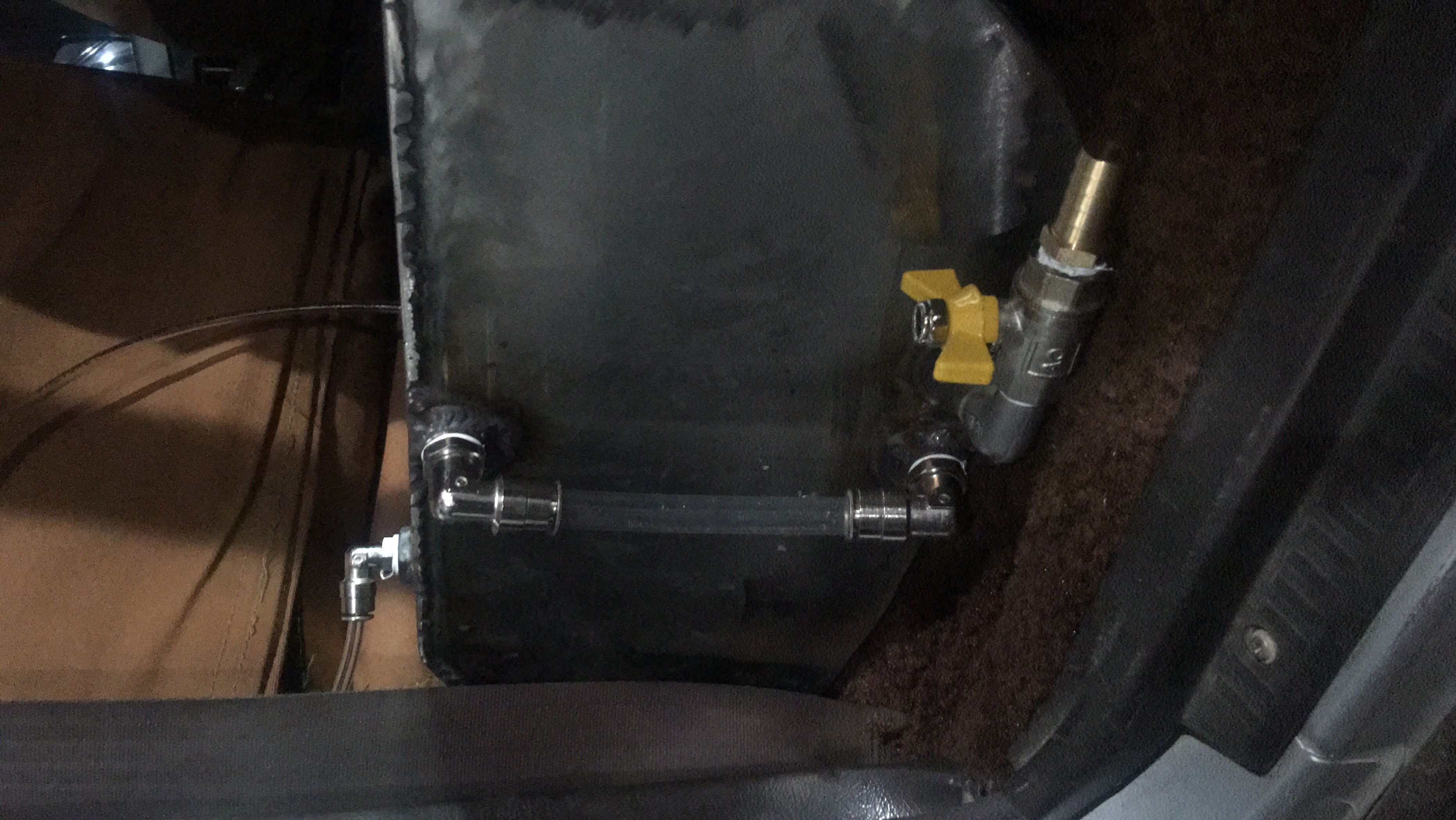

Tig welded
Top left connection is a breather hose for the tank, that's hiding behind the B-pillar and raised up.
The middle fitting with clear hose is my water gauge. I can see how much water is left in the tank through this hose.
Bottom right is my low pressure (gravity feed) water tap. This will connect to a hose that can be pulled outside the vehicle for cleaning or washing anything.
Here is the passenger side. There are two taps here. One serves low pressure (gravity feed) and the other is connected to a pump that can be used for showers and also forcing water to the rear of the truck and just under the rear bumper.
The 3" cap you see up top is where I fill the water in the tank. I have one on each side and is next to the rear doors for quick access.
The water tank was designed in purpose to be flat with the cargo area so I can sleep inside the truck when we have bad weather.

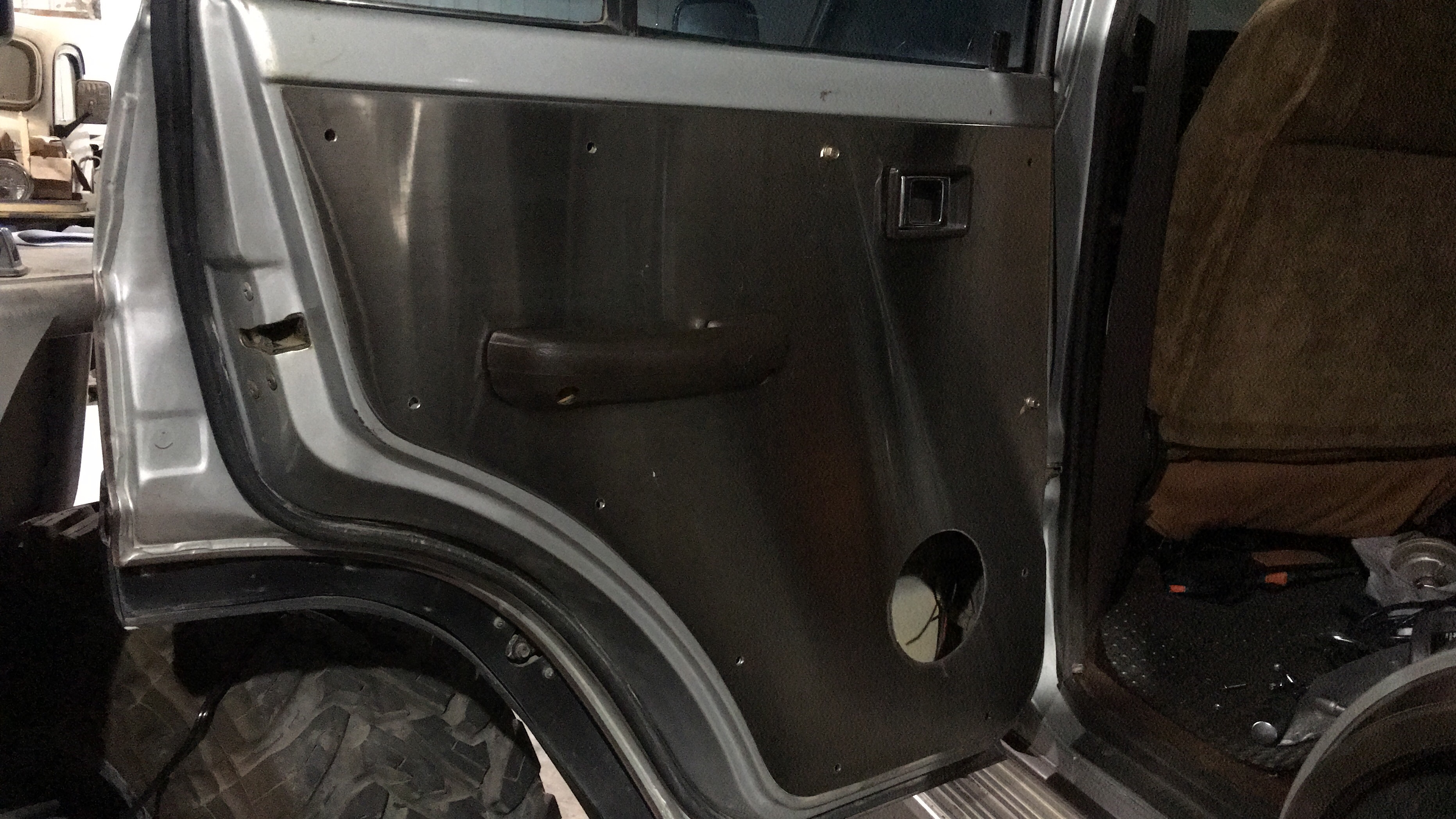

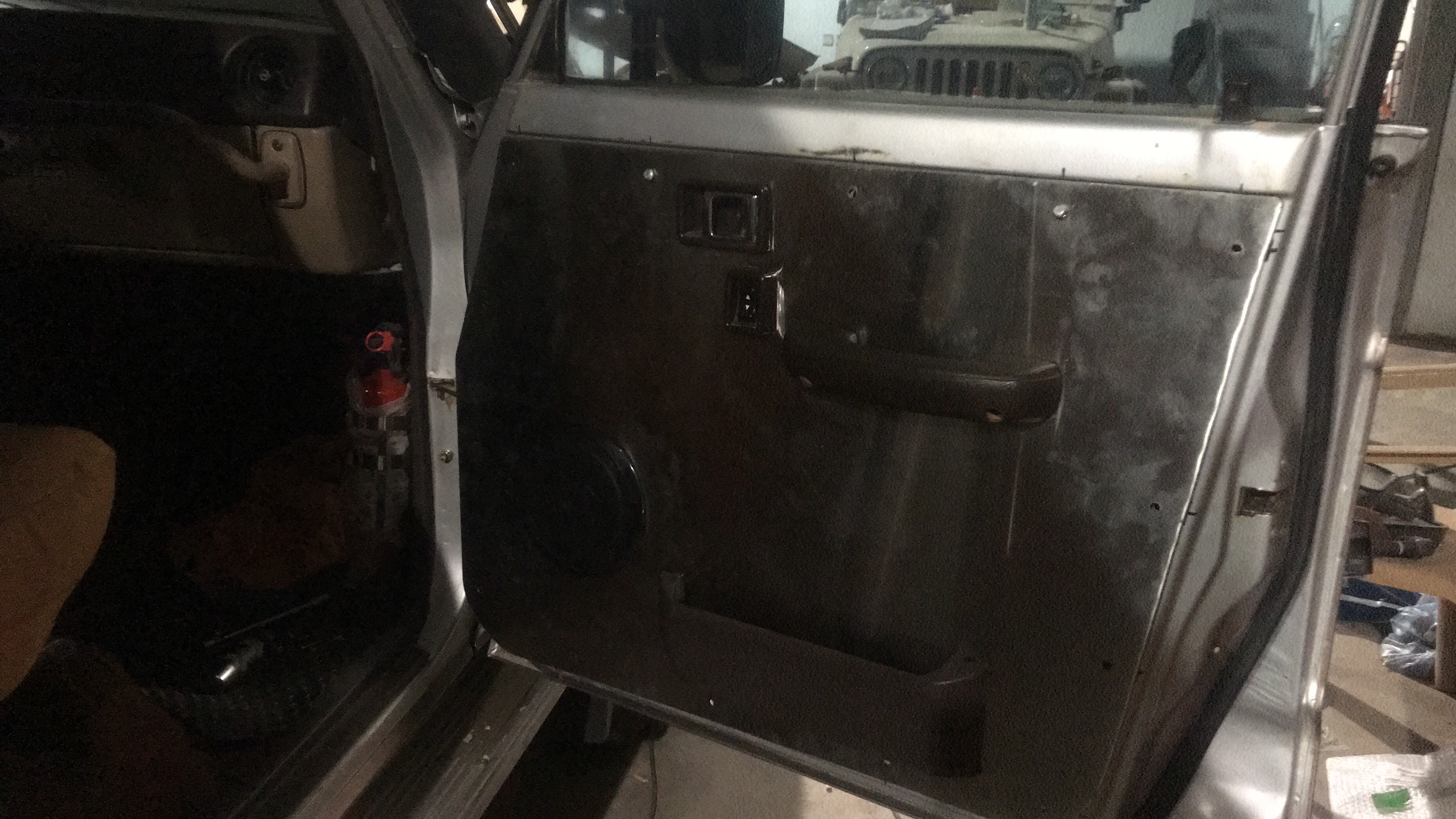

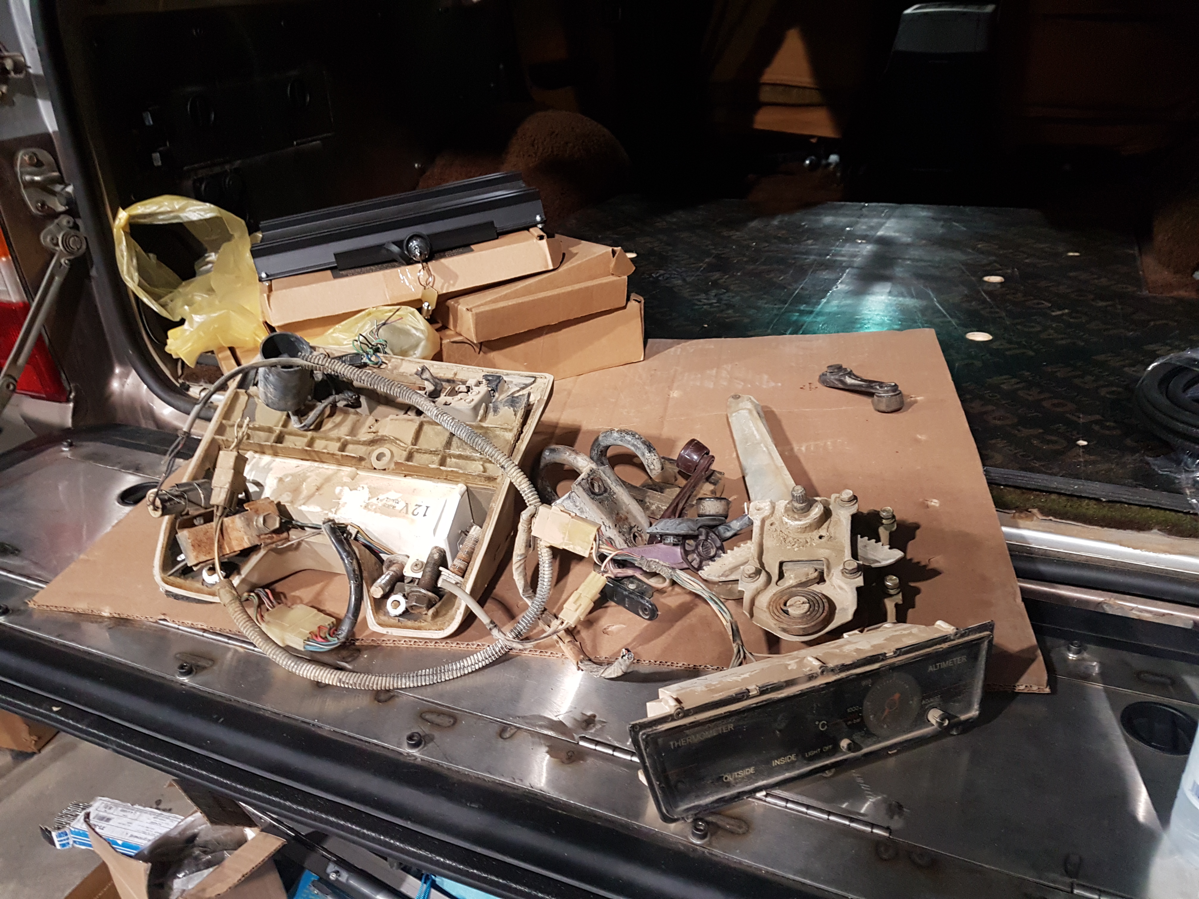

Here are the door panels cut into stainless steel. I'm converting the rears to manual window.

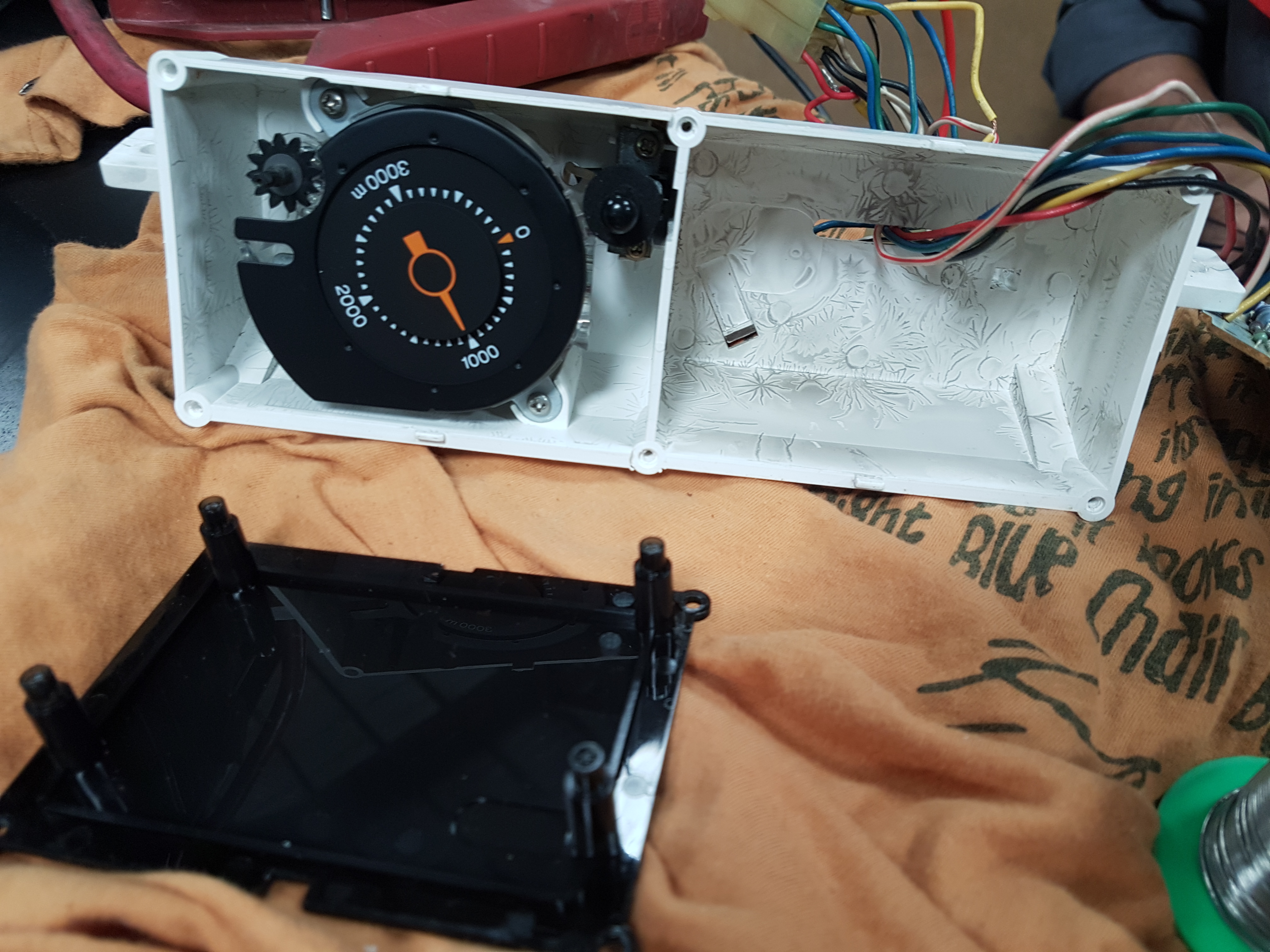

After a few hours in the scorching heat. I came back with the manual windows AND!! a 12v outside temp gauge/ altimeter!! not one!! but 2!! AND the tilt gauge under the radio!! Score of the year for sure!!
A quick clean up

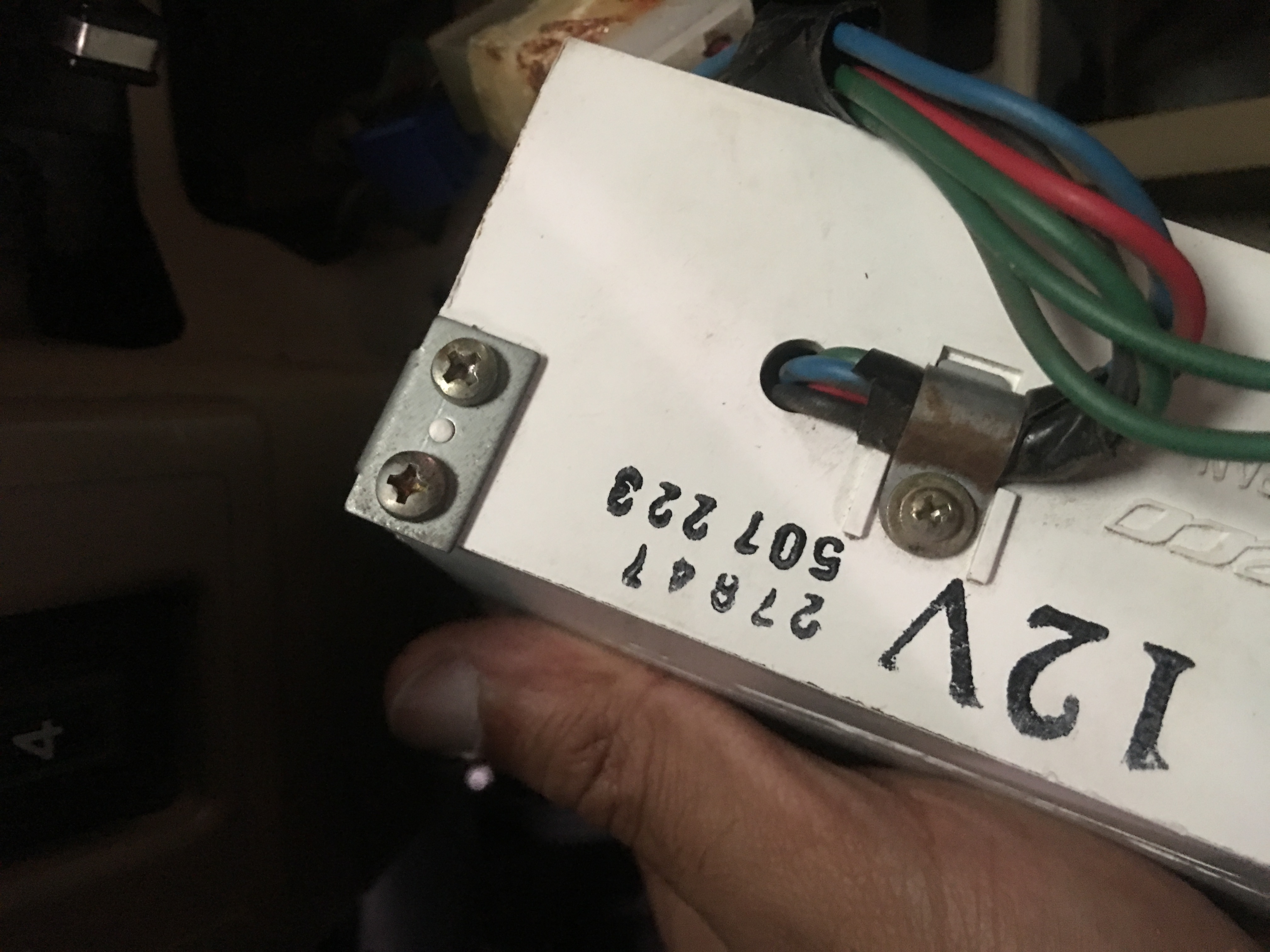

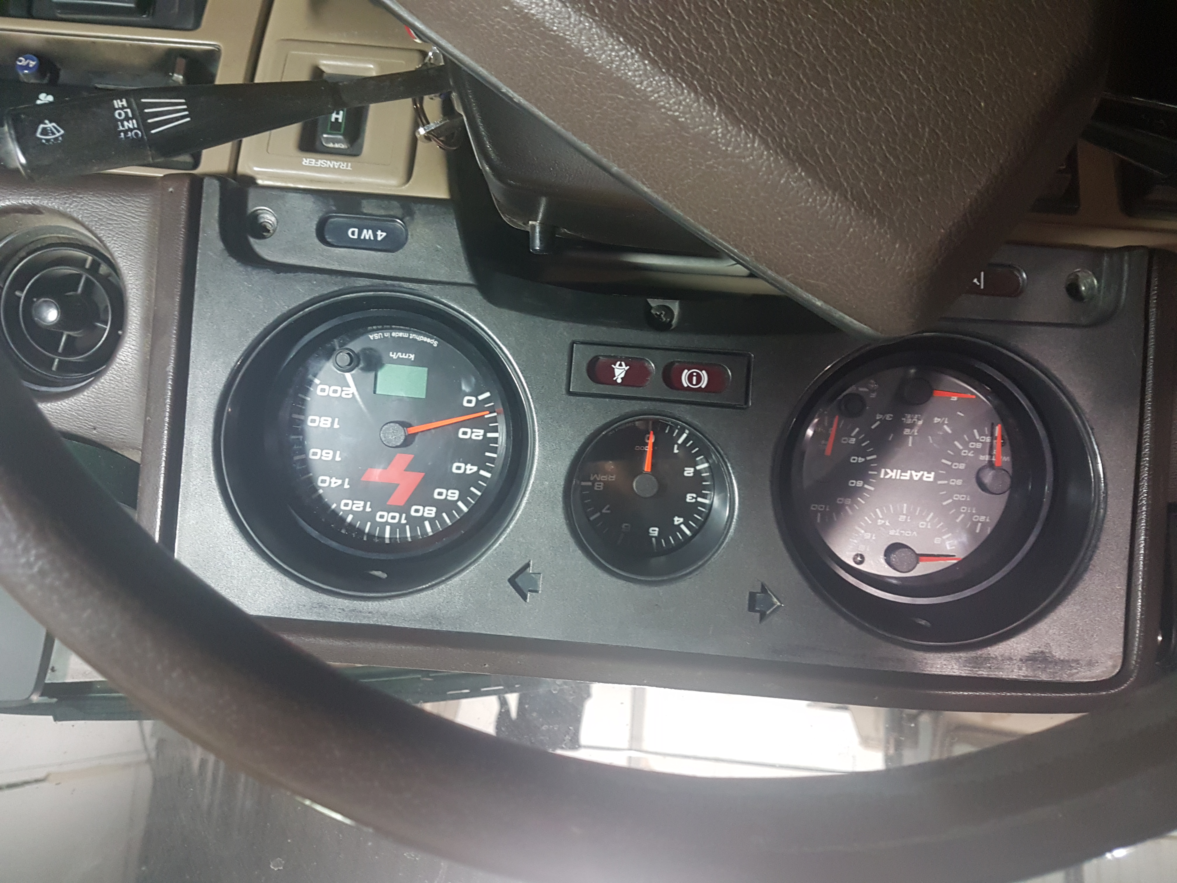

Tested the gauges and they were real dim. a quick fix was due.

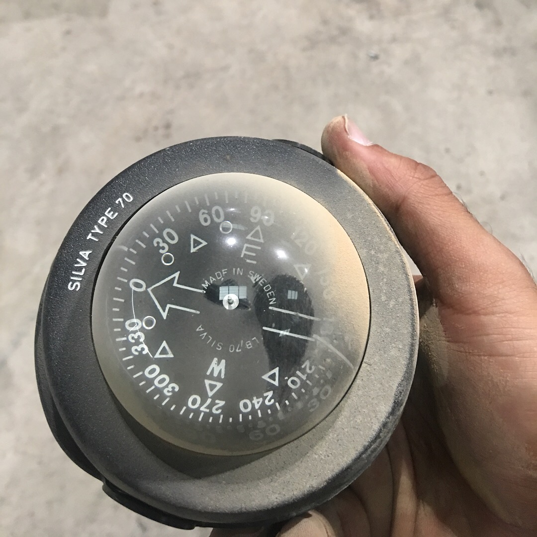

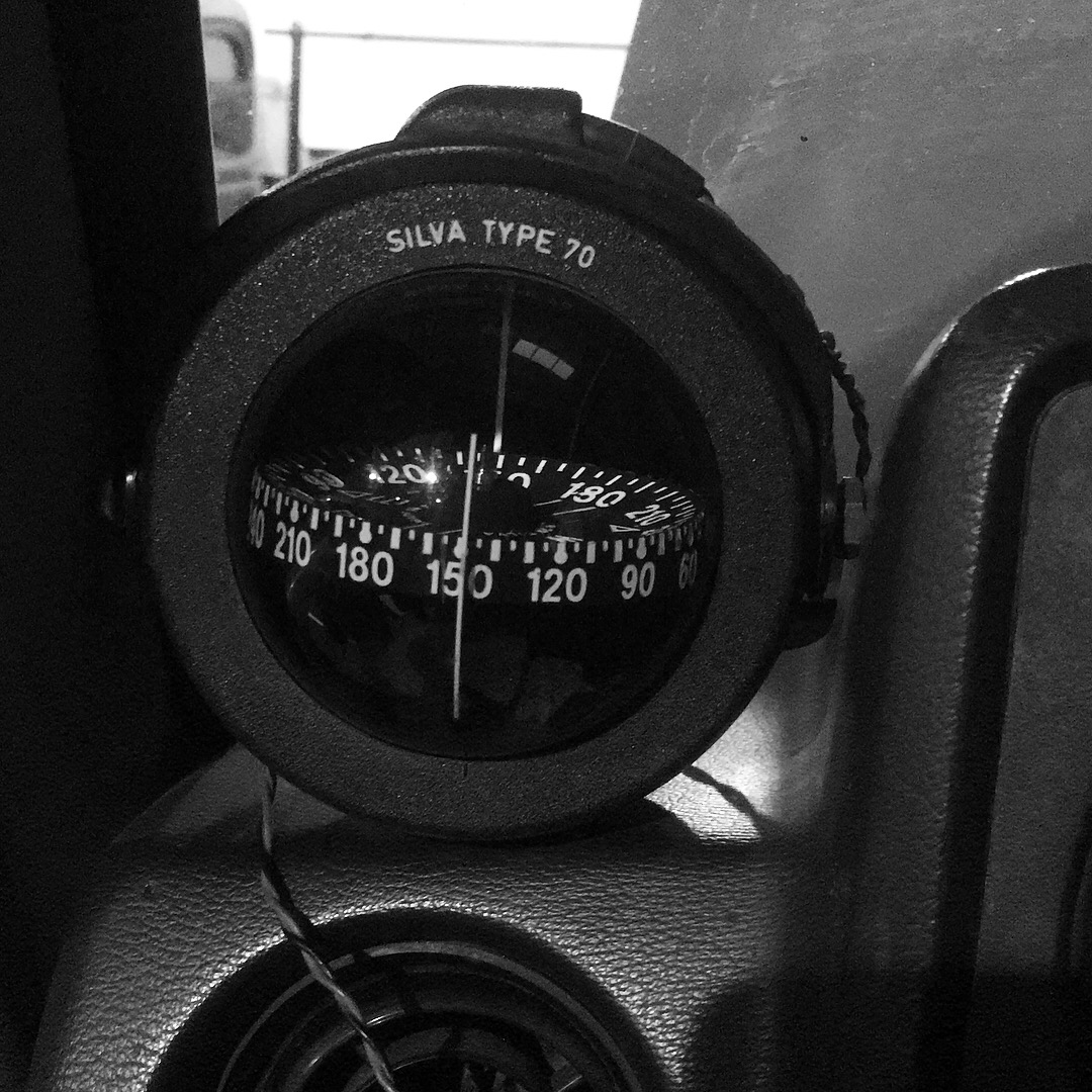

Can anyone identify the age of this compass
This is where I plan to install it

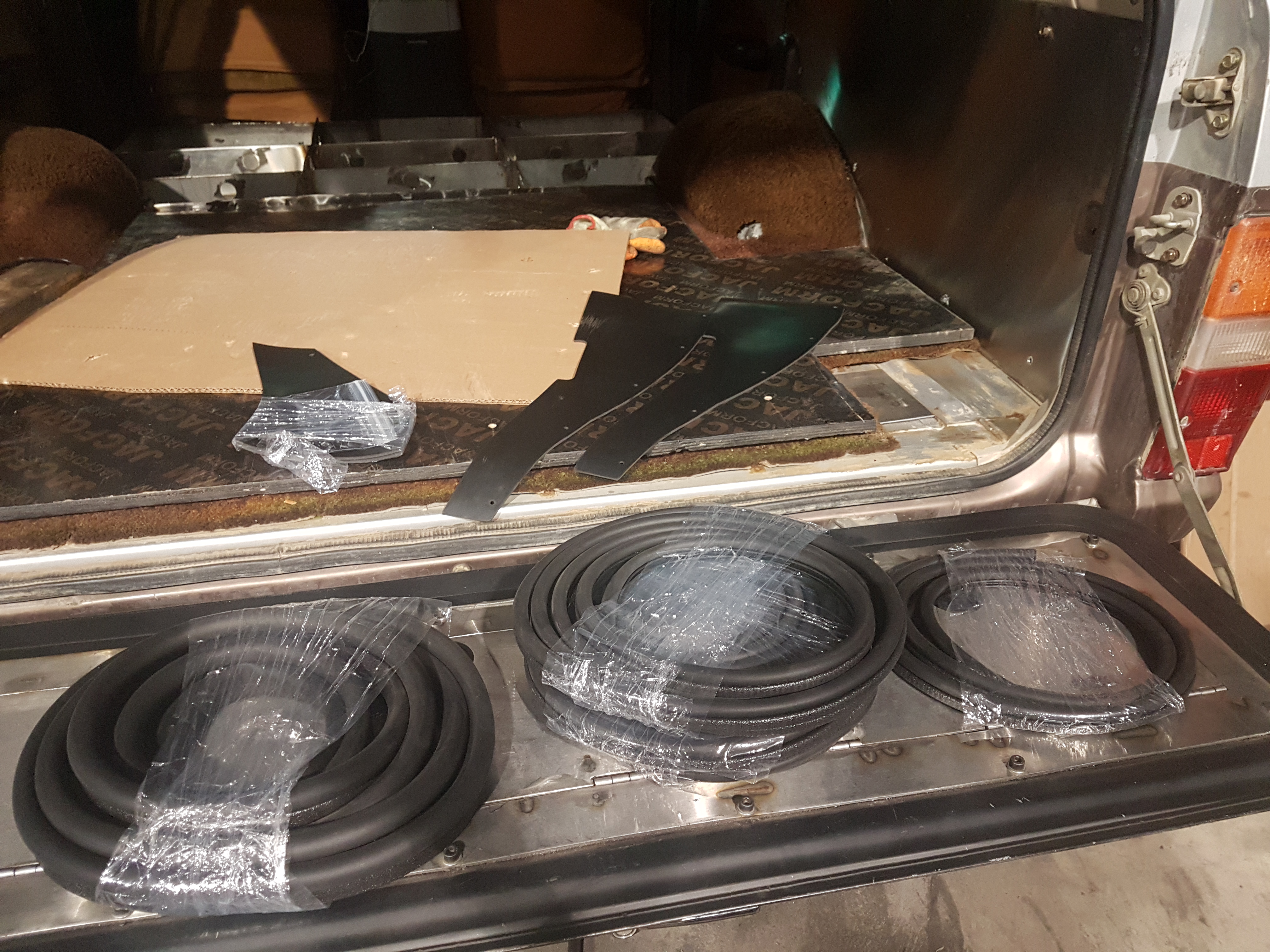

Received my package from @reevesci to replace the seals. Looks great!

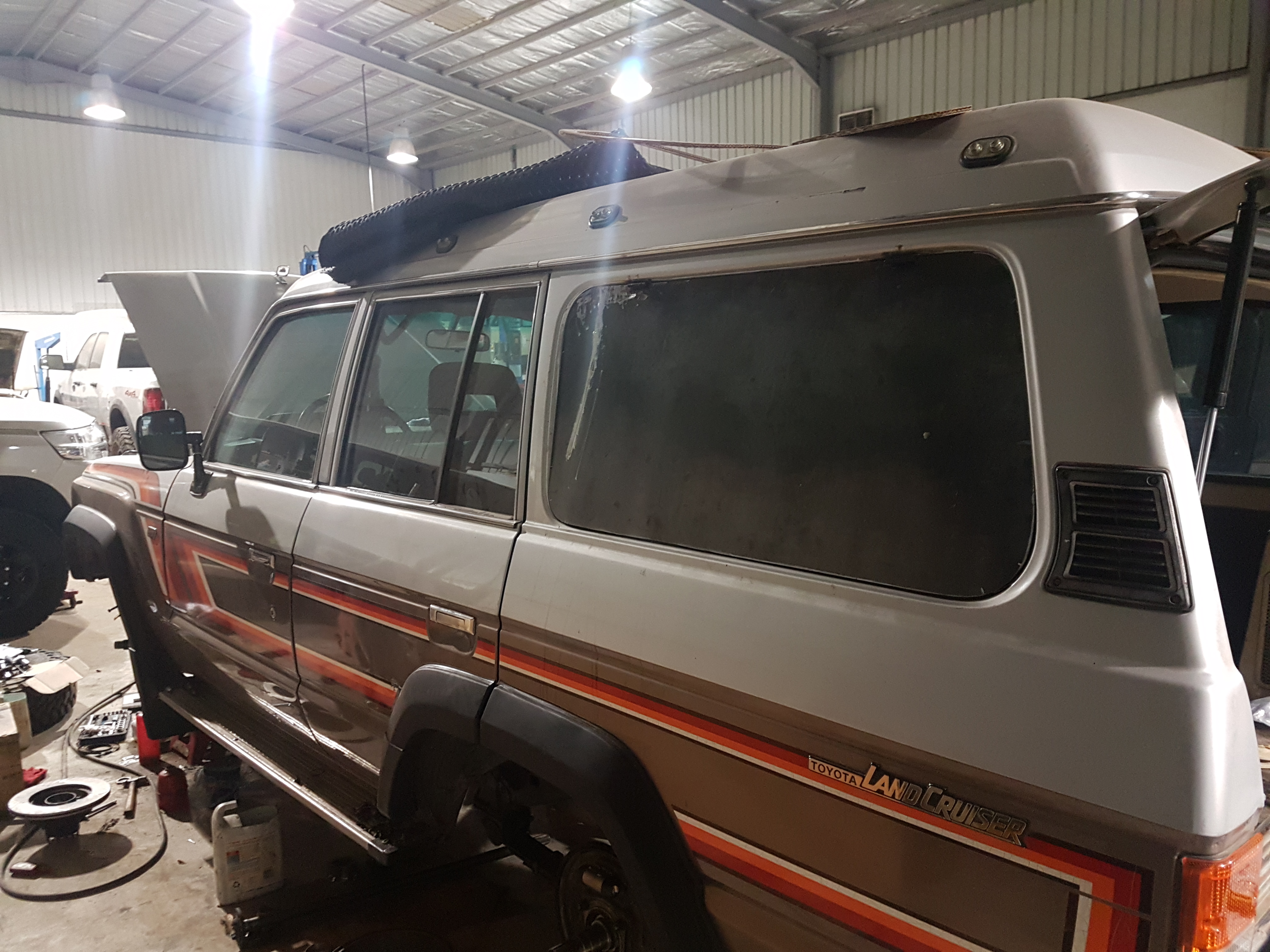

The window worked out so well. I decided to do the other side the same way for easy access.
