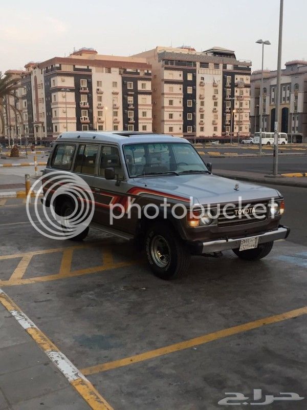

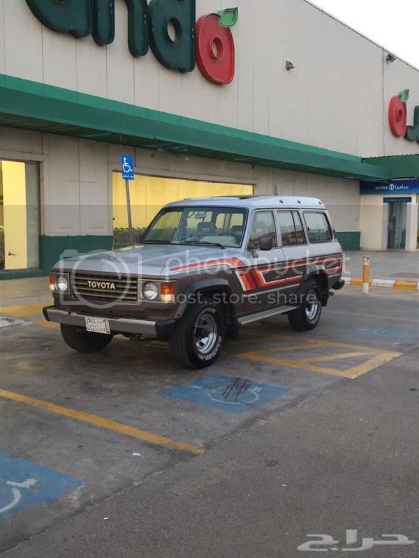

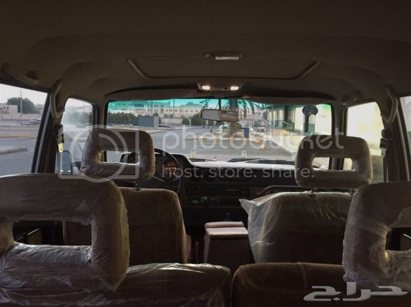

Let's look at the factory specs,
85 with the 3F and H55 5 speed trans.
High Roof, Dual AC and steel sunroof.
Has done 200,000KMs
Clean for a 30+ year old work horse.
Full Floater rear.

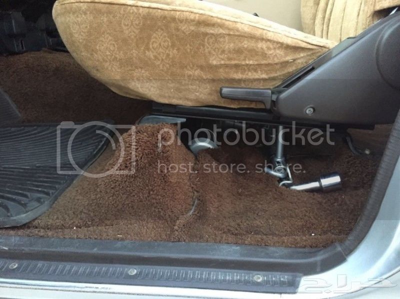

Delux trim which I know is rare globally.

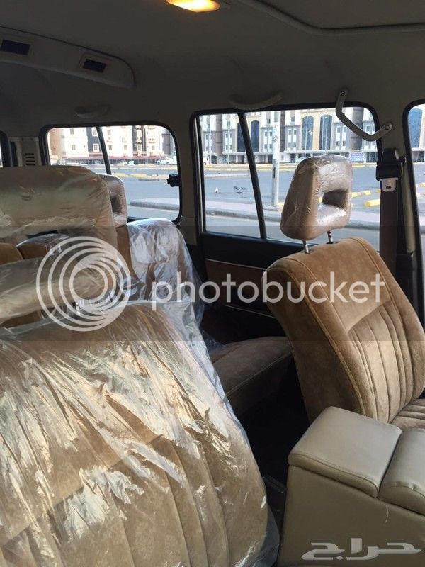

And then you see these pics.
How can you look away! I jumped on it immediately and had it transported the next day!
The Cruiser shows up 24 hours later. and for the first time in buying junk, I actually scored. Don't get me wrong, it wasn't cheap. But after rebuilding my 80 series and hunting for interior trim, it wasn't fun nor cheap. These old trucks locally are known for their durability, so most owners hand them down to their workers for farm duties or carrying excessive loads and you probably have seen pics of what I mean. So, to find a clean and well maintained 30+ year old interior is like flying in a magic carpet, almost impossible at least locally.
I have a lot of trucks, each one serves a purpose. Mostly off-road use. I won't lie, I was planning to maintain it and drive it and that's it. Just enjoy a great piece of Land Cruiser heritage and leave it alone. That plan derailed quickly.

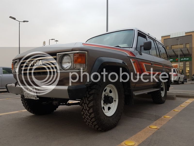

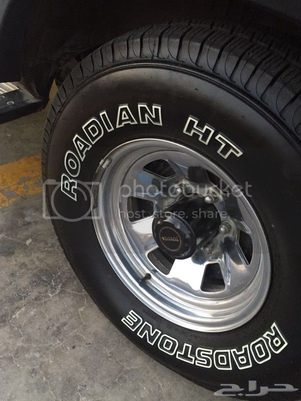

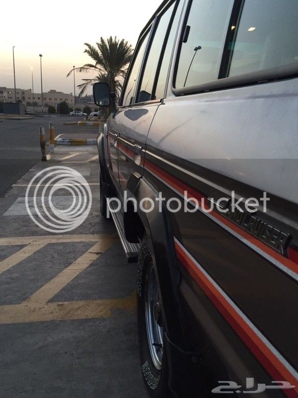

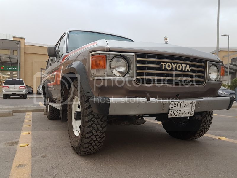

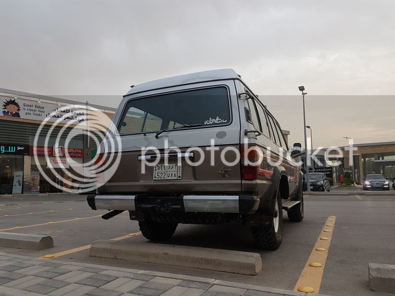

The truck shows up and, well, I just couldn't help my self but throw on my 255 Toyos.
I'm sure a lot will hate the skinny look and fender flares. Weirdly, it's growing on me. For now, i'm going to run it like this.

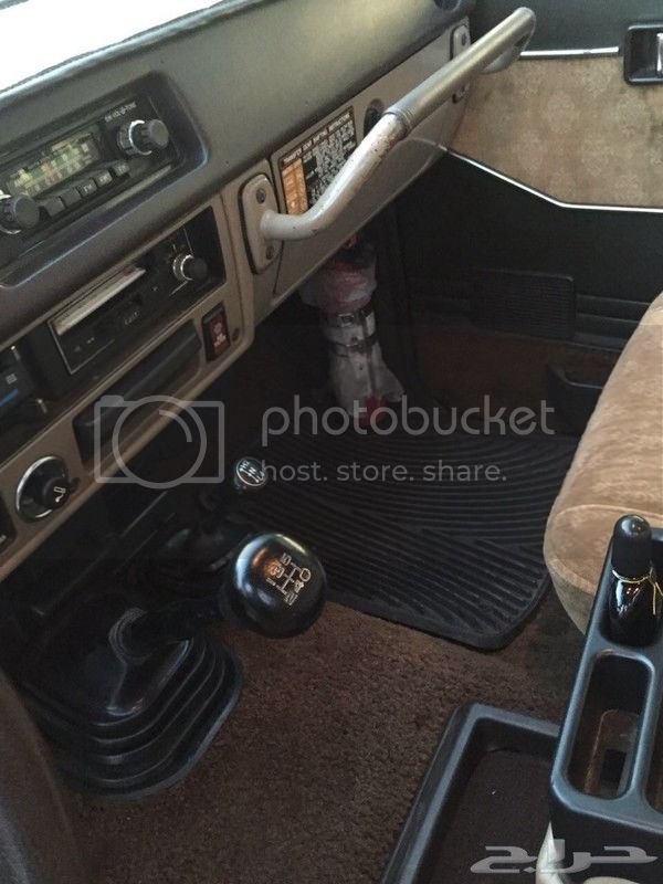

That center console is interesting, any more pics of it?

It looks like it's the refridgerated center console.
Would be a great business for sure. Parts are not exactly easy to find. I have an executive friend who works and handles parts distribution for Toyota in Saudi. He told me that back in the late 80s/ early 90s. The dealer sat on a lot of replacement parts (which every dealer does to hold stocks for a production car) and they didn't move as much because they were too reliable compared to other offerings they had. So they ultimately shipped the parts to their distribution channels in Africa. However, a lot of parts are still here, they are just really hard to find as the dealer sold these stocks to smaller businesses, so your really asking parts people for references on where to find old stocks.
The center console is just an arm rest that slides on top of the factory one. which is going to be replaced at some point with a 12v fridge.

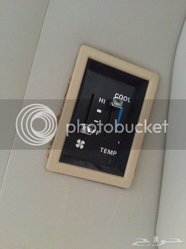

Hi, Very nice cruiser. How effective is the rear air? Mike
I've switched it on just to check that it blows cool air. And it does. It doesn't have a front control switch so I may add that for those crazy hot weather days. I'm planning to duct an air hose in and use a 12v fan to run it when I want to sleep inside but that's future project.

Back on subject and here is a close up of the center console

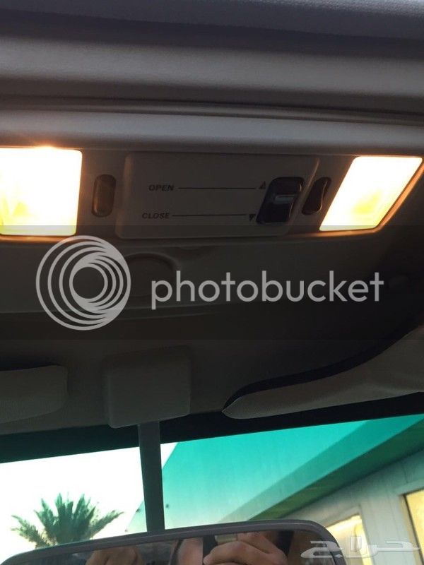

The steel sunroof. I generally don't like these. The seals could fail and start pouring water inside the cab. If it happens i'm going to seal it shut. The truck will likely sit outside almost everywhere I go. Dry and hot weather is harsh on rubber gaskets.

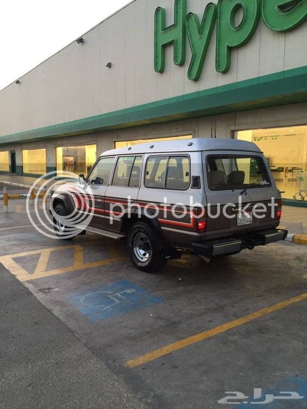

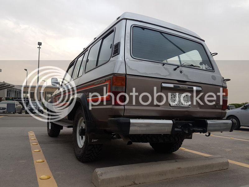

Some random shots I took of it when it arrived
Need to add a front dash switch for the rear AC.

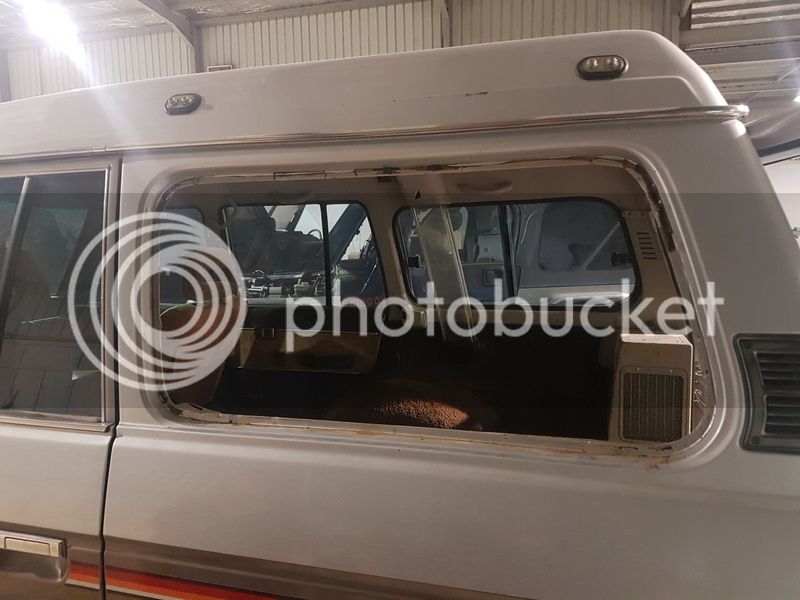

Rear AC system fan and condenser is in an inconvenient location. May have to relocate depending on how I setup the cargo area.
Taking Rafiki home for the first time. Always a great feeling.

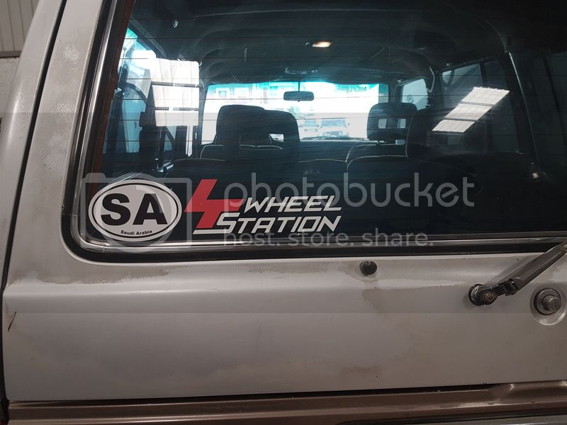

Rear Dealer decal. 32 years old. love the patina

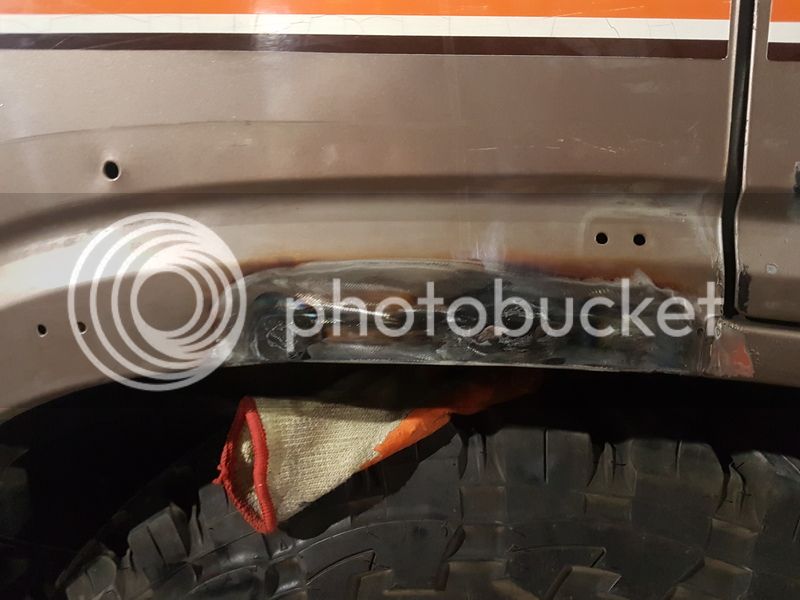

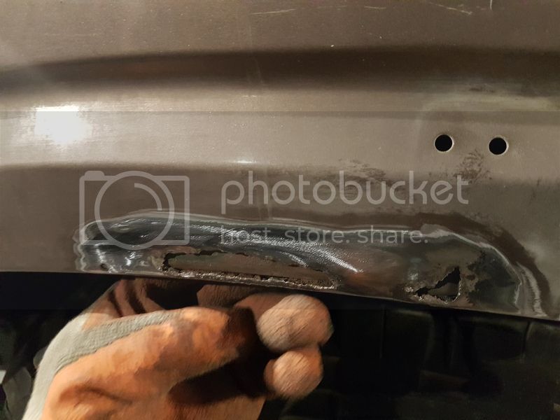

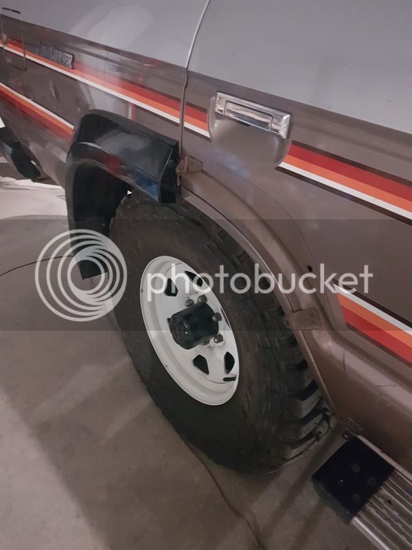

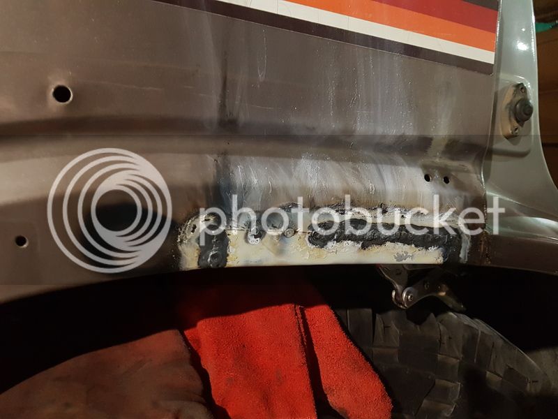

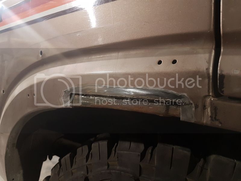

I took the time to inspect the flares. Although they were in decent shape. The rears had some weird indents in them. I wasn't happy with how they were. So I contacted my dealer in hopes of them having them available in stock or available to order from Japan. But they didn't, and they couldn't get them, no surprise there. So they were sent out to my local body repair shop to get cleaned out and painted flat black.
To my surprise, I found a little rust behind one of the flares. So out came the cutting disk and grinder and we had at it.

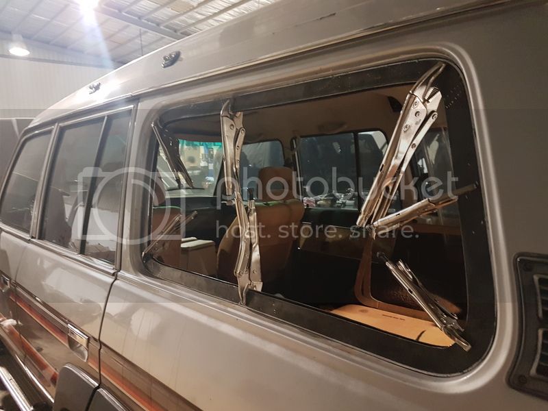

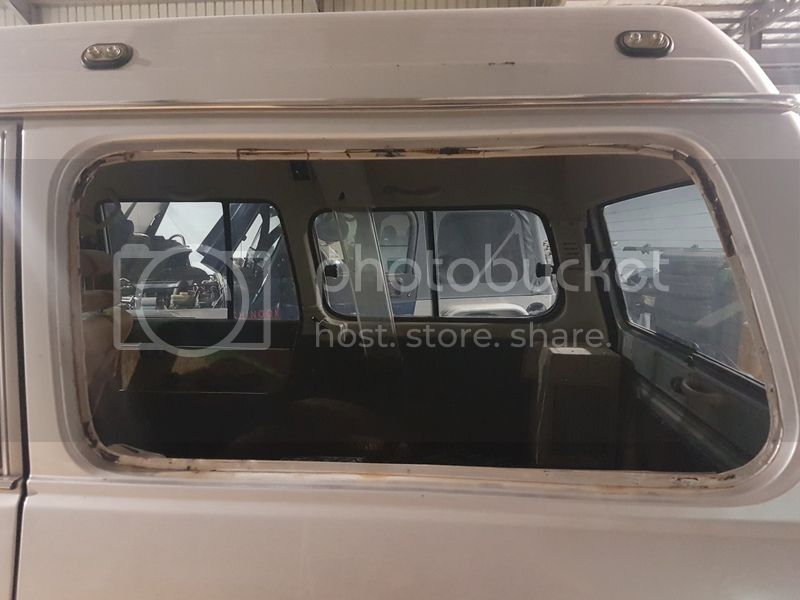

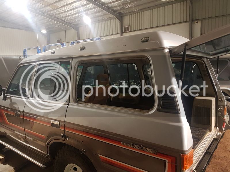

While we wait for these parts to arrive, I've pulled the rear sliding windows out in an attempt to make flip up windows for easy cargo access. The panel/ window will be made out of steel.
I've got offset hinges inbound. Rubber seals and key latches to test with. Some of you DIY guys may like this. I'll post about it as it goes.
Like everything else I've done. I'm trying to build this truck in a way that if I wanted to reverse everything, I could with ease. The flip up windows will be controlled by a frame that is sandwiching the body opening on the truck from inside and outside. That frame will take all the gear required to secure the panels and support the panel movement with gas struts/shocks.

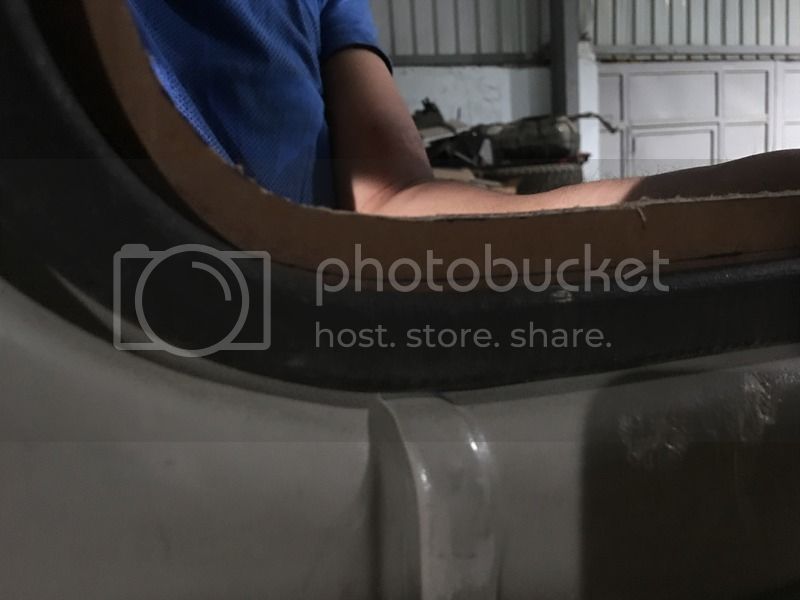

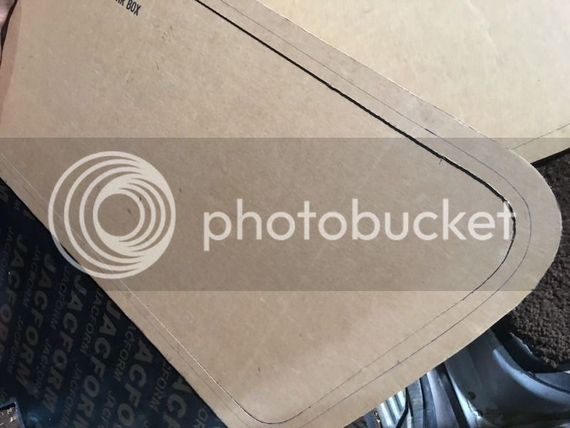

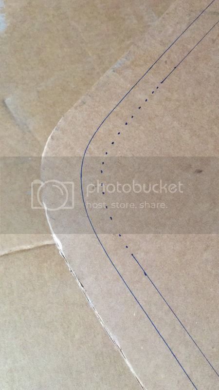

At the moment, I've mocked up the frame using card board. Drew the outside edges on it to mock the body frame shape. Then went out and in half inch to get the proper size for the outter frame. It's not a hard job to-do. You need to spend a good amount of time measuring and understanding how things should seal and avoid/strengthen weak points. If it fails. I can simply revert back to the factory setup. All I would need them is silicon. But I'm being optimistic, and think it will work. And seal well. I'll follow up with pics as it goes.
-Luai

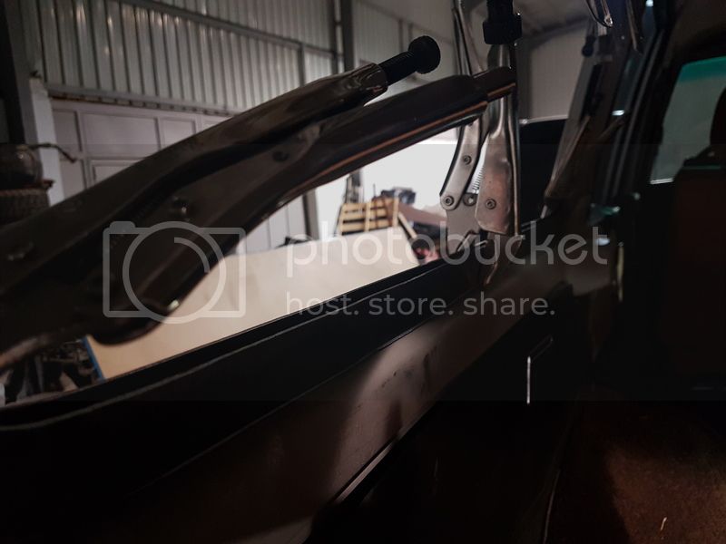

Quick update on the flip up window.
Used thick card board for mockup and getting the correct fit.
This helped get the correct sizing for the outside and inside frames. So then we used that template to cut 3mm steel and use it for the final product.
And here is the steel frame. It flexes and deforms without any support so I'm going to throw in nuts and bolts and see how it likes it. The key thing here is the seal. Between it and the body I'm going to use factory window silicon. And from it to the window, I'm planning to use rubber seals. The issue remains with the hinge. I'm still waiting for it to show up so we can test fit. Ideally, I'll have it attached behind the outer frame and use silicon for sealing. I'll get a better picture of this as it goes on.
Inside view. Notice the gap between the frames. This is good.

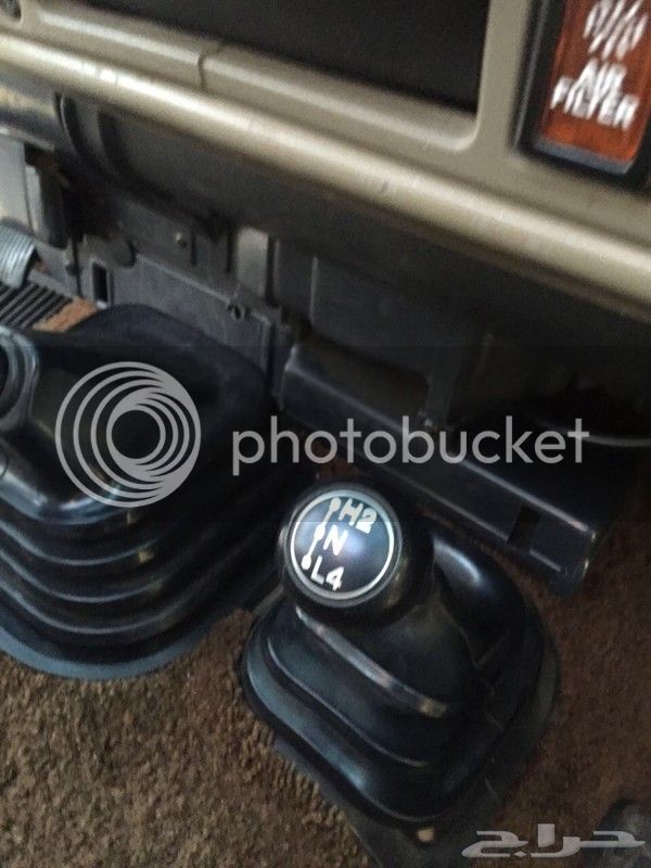

Btw, your transfer case has H2 and L4. Is that a split case or full time 4wd?
Good eye.
It's a split case with a vacuum switch for the 4H. I've thought about replacing it to the stick style. But I use 4LO on everything except gravel roads. So I don't think it will see much use.
