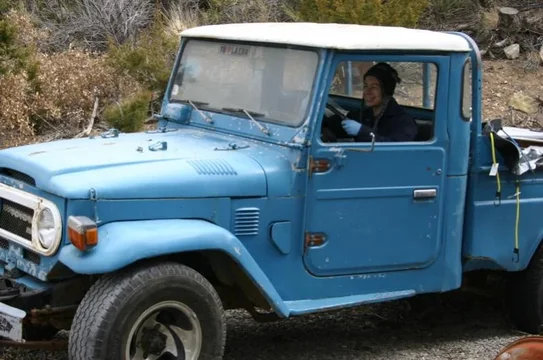

Pretty cool to see someone else "driving" my HJ-45, even if it is just to rob some parts from it.
Patience, patience.... ;)
Dan
