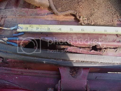

Your lucky your tailgate rust doesnt look like this...

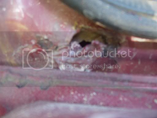

Seat Brackets
Keep up the good work!
My wheel wells looked like that where my seat brackets were too. There is a panel on the inner wheel wheel that that "holds" moisture until it rusts through to the inside. You can see the 3 vertical lines on yours where the raised portions are.
You are probably going to have to remove the inside metal (8? spotwelds) and the outer plate as well (12? spotwelds)
Here is mine from inside the wheel well. I didn't look too bad from the outside, but the inside was rusted like yours.
Yeah, I was noticing the correlation between the outer support bracket and the rusted area before I came in the house. How did you end up repairing yours? Was your outer brace salvageable? Mine has no signs of rust from the outside...and luckily the patch panels I have came with clean inner fender wells. This rust repair is fun stuff, huh?
Yeah, this is my favorite part of the project so far :rolleyes:.
I removed the panels from the inside and the outside. The outer panel was rusted through in one spot. The inner panel (bracket) just needs cleaning up. The wheel well is shot... I will have to patch that.
