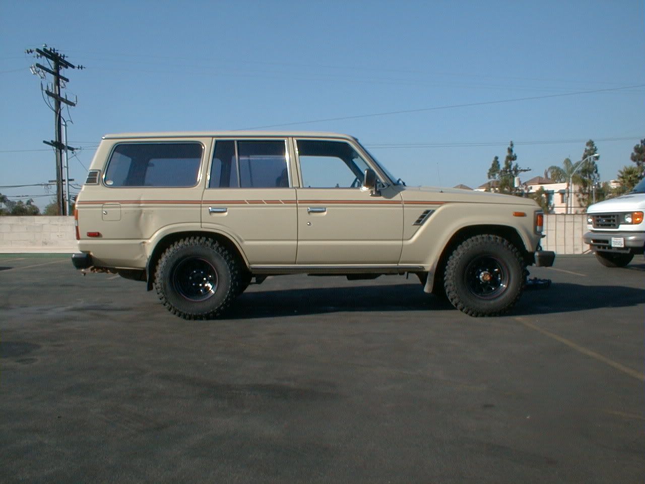

I've got a perfect right side 1/4, inner and outer, part of the floor, from the rocker all the way around to the tail light and half way up the quarter window...............
can post pics when I get home Saturday(I'm in Tucson now)
I'm all the way in San Diego so I know freight would be a killer
:beer:
Yeah I bought it a few years ago(when I used to have extra cash) thinking I would need it to fix this:
clicky-clicky
that's a pole dent that was there when I got it.............
the 1/4 was a good ebay deal and it was close to me.................
but I got a lot of body guys sayin' they can fix what I got.........no rust and not really a major dent.........
I'll post some pics when I get home................
