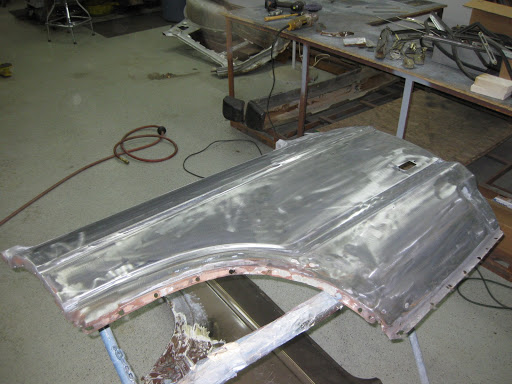

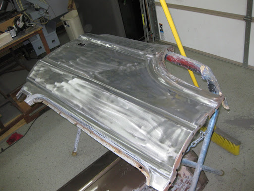

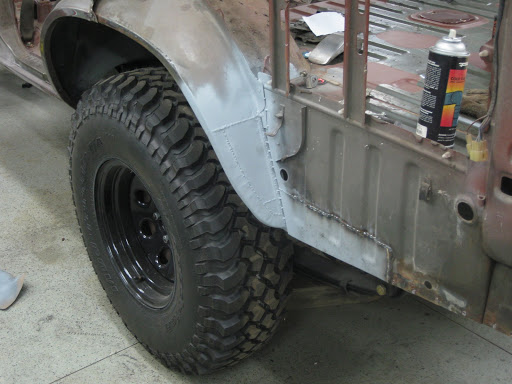

Quick update. I finished the hammer form and got it installed this weekend. I also cut the 1/4 panel skin to fit and stripped it of paint. I then temp set it on the body and fitted up the inner fender patch; just need to weld it in now. I also got all of the tar mat stripped from the cargo area. I am changing direction on the interior; I am going to leave the carpet out of the cargo area and shoot bedliner instead.

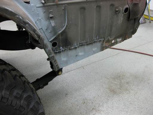

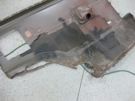

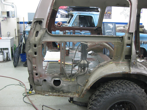

Updates from tonight. I got the patch finalized on the drivers side and pulled the quarter on the passenger side.
Driver side patch; I decided not to grind and finish the welds as they will be inside the quarter:
Passenger side 1/4 off:
Inner 1/4 rust:
Old 1/4 skin; notice all the rust and previous jank ass bondo repair:
Both 1/4's off; how much do you think I could get for it if I sold it right now? ;)

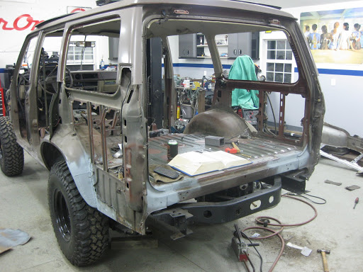

Naked

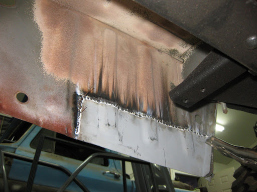

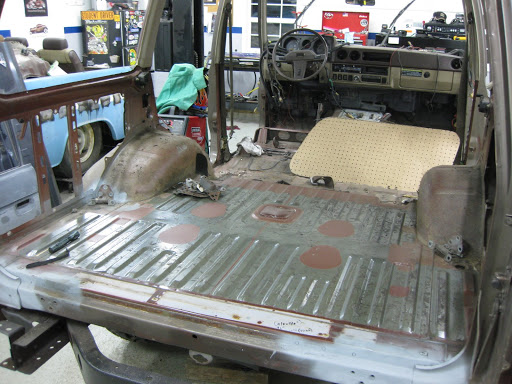

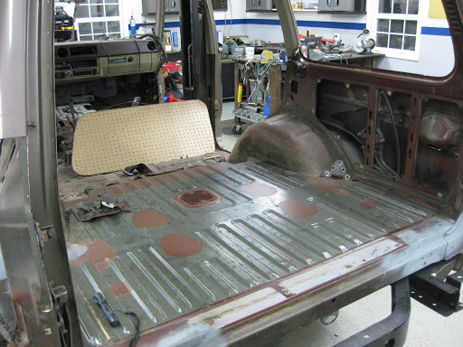

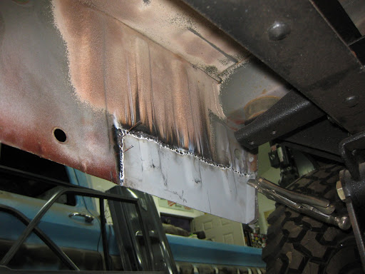

Haven't been good about posting picture updates, but I've gotten quite a bit done on the 60. I am still waiting for my buddy in Phoenix to ship my RR quarter, so I decided to go ahead and rust bullet and paint the floor without it. It will be easy to come back and paint the small section after I repair anyway. I finished the welding and smoothing of the LR patch; turned out pretty good. Didn't get pics of the rust bullet, but they would have looked the same as these, only silver! ;)

WOW!!! :eek:
It makes me feel guilty for neglecting my rig whenever I look at how well you're taking care of yours!
Thanks for keeping us posted, and please keep up the good work!!

Thanks man! Remember, this project started months ago as a way for me to "clean up" my 60. HA! Guess I went a little overboard!!

One thing is sure Skinner; you will have a thousand or more testomonials to the fact that yours is truly the one and only rust free FJ cruiser of it's age on the planet. Pretty good braging rites if I do say so. Again awesome build and great documentation and photos thank you again. :beer::beer::beer::cheers:
