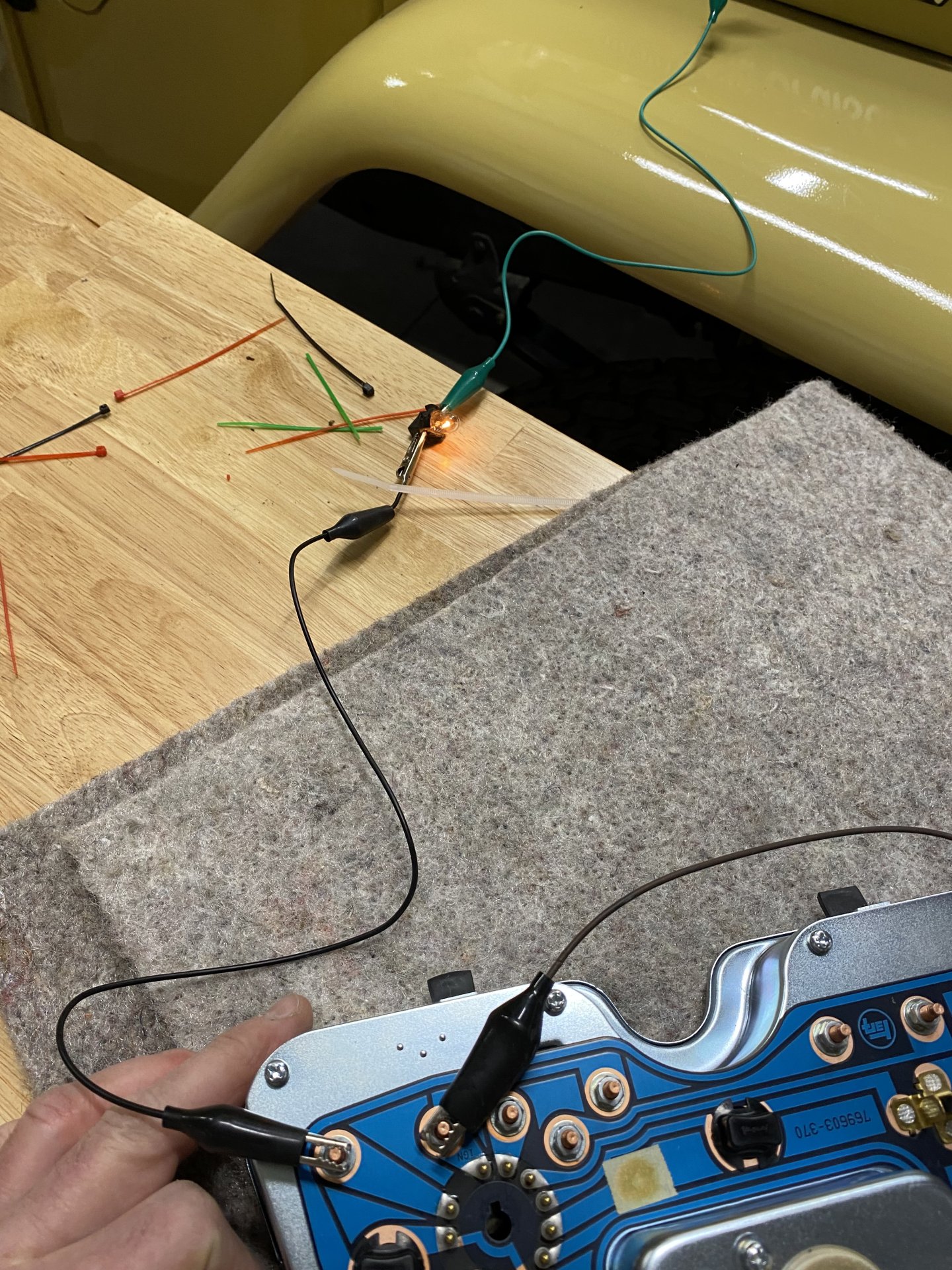

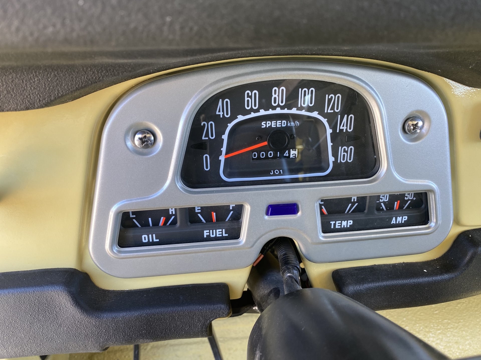

I spent way too much time searching for a oil pressure and fuel gauge gremlin. The oil pressure gauge just had a weak connection with the barrel fitting on the instrument cluster and the fuel gauge turned out to be a bad ground at the sending unit…… i’ve been doing this for four decades and a bad ground is still one of the last things I always check,🙄

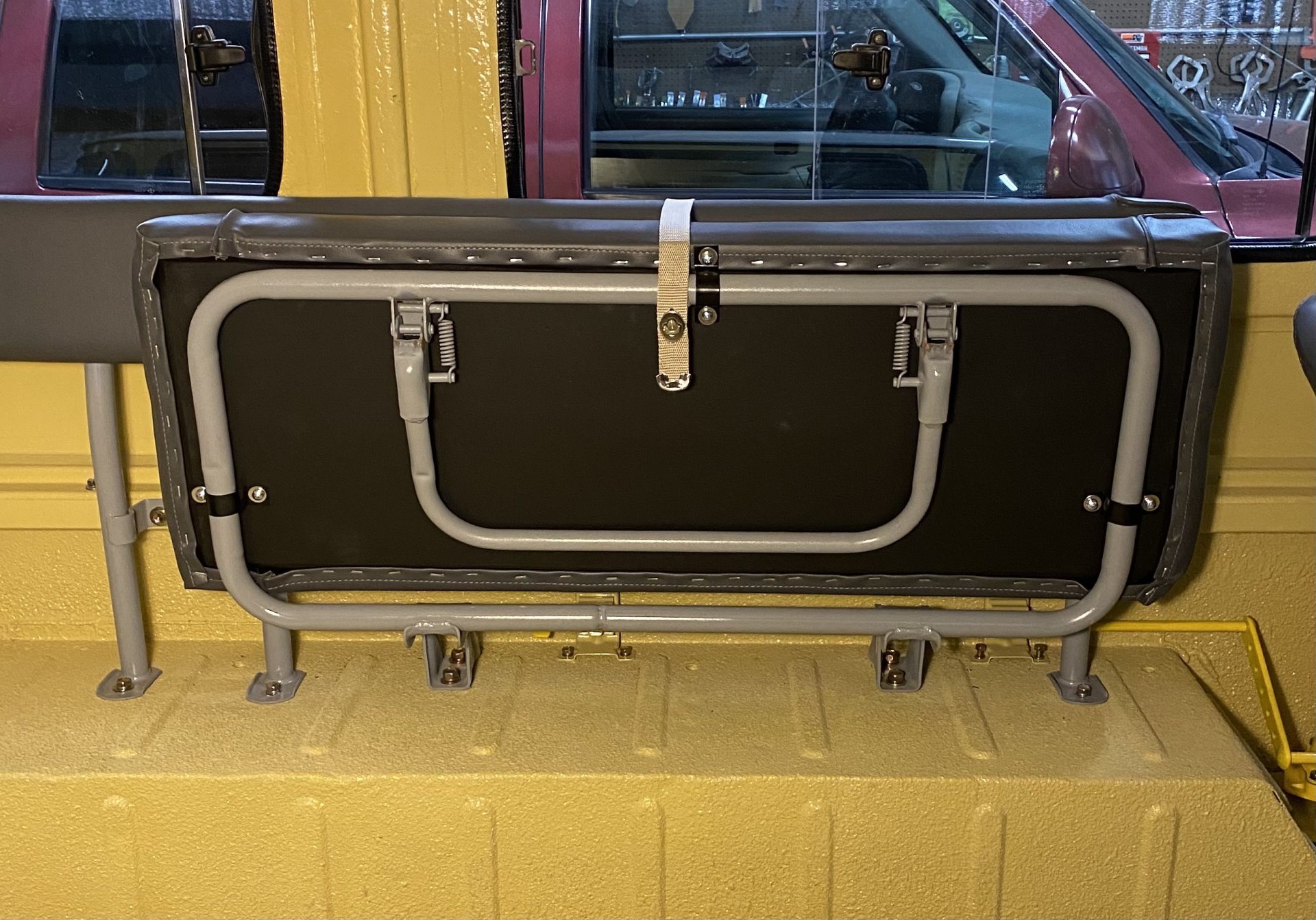

Warning to the purest- don’t look at the tool box door I cobbled together. I could not find an original so I thought I would give this a shot. It is better than nothing and easily removable if an original one is ever found

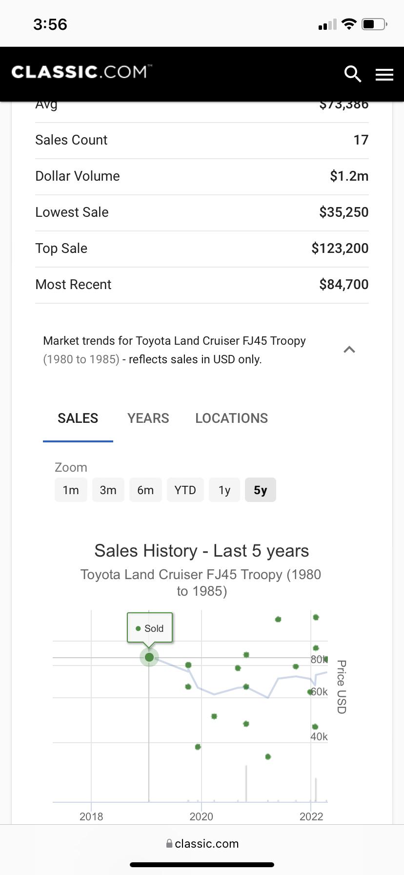

Here is the best market intelligence I could find on US troopy sales over the last several years
It only includes auctions so no idea what private party sales are like.

Interesting to see how horizontal the line is (looking at the average). I would have expected more of a Covid inflation effect than that shows.

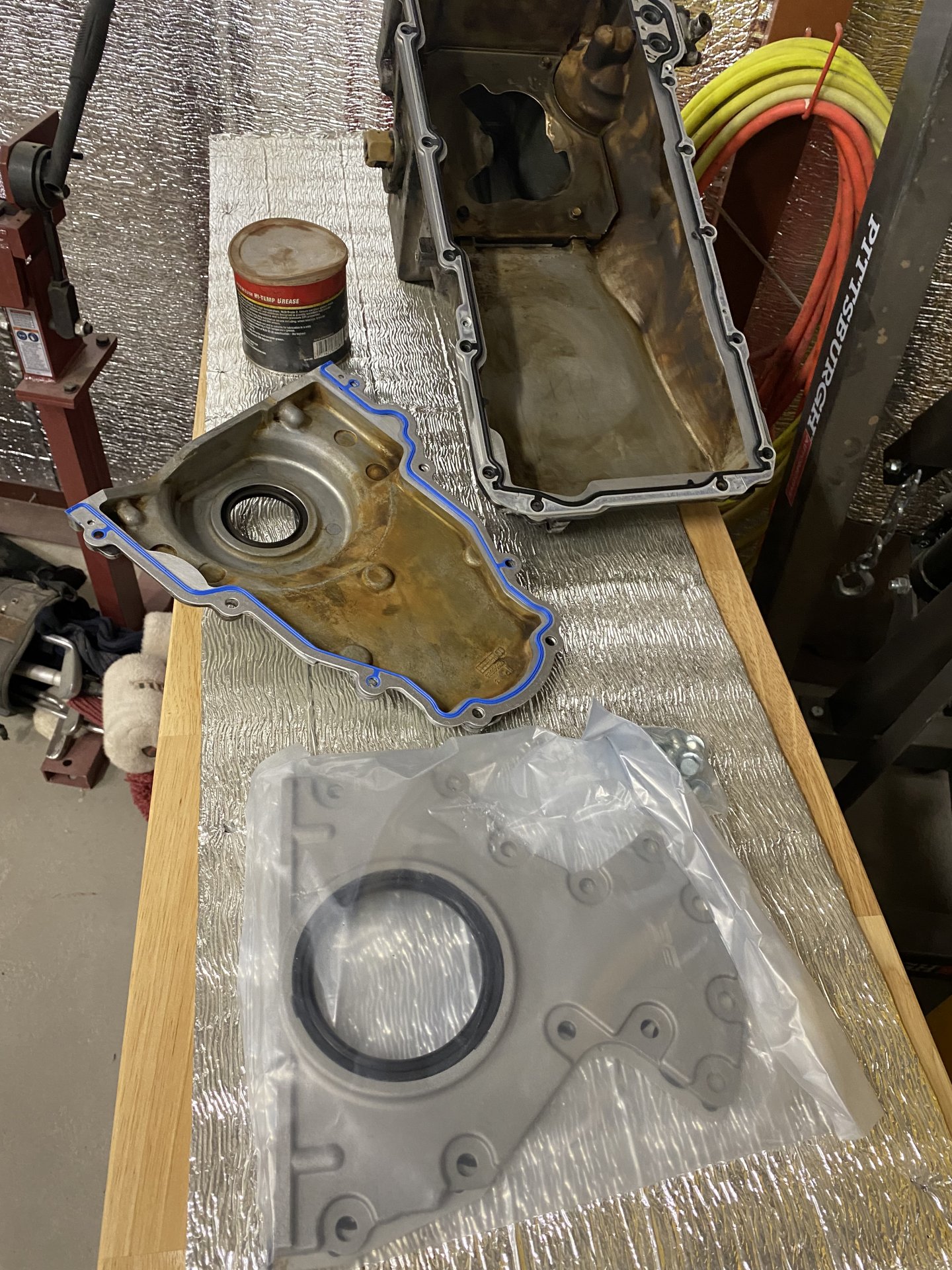

Just in case you think I’ve been laying on the sofa eating bonbons that annoying drip from the rear oil main on my 2001 suburban with 300,000 miles has turned into a full fledge hemorrhage from everything down below. So she got new front and rear seals oil pan gasket etc. just put in the last of the heavy pieces back there now in time for my trip up north

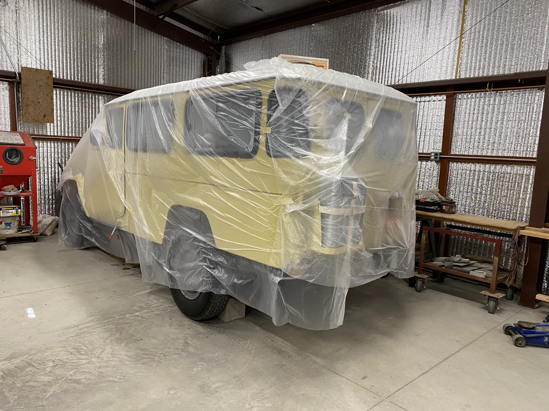

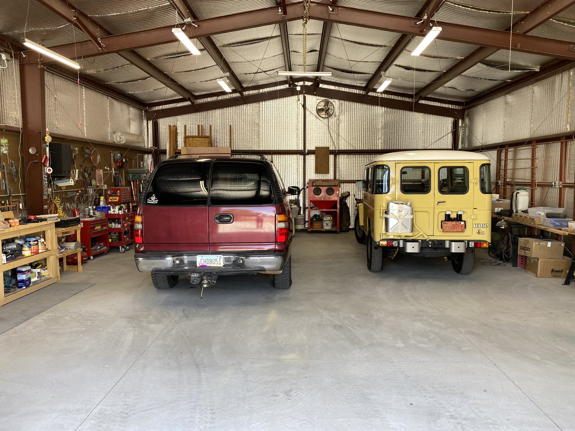

I have her all tucked in for the Summer. For the first time in my life I own a vehicle up on cinderblocks 😜
Fluids are all fresh, battery is disconnected, and the tires are just off the concrete. The windows are cracked slightly and the plastic is loose fitting as we get several dust storms which creep into the garage.

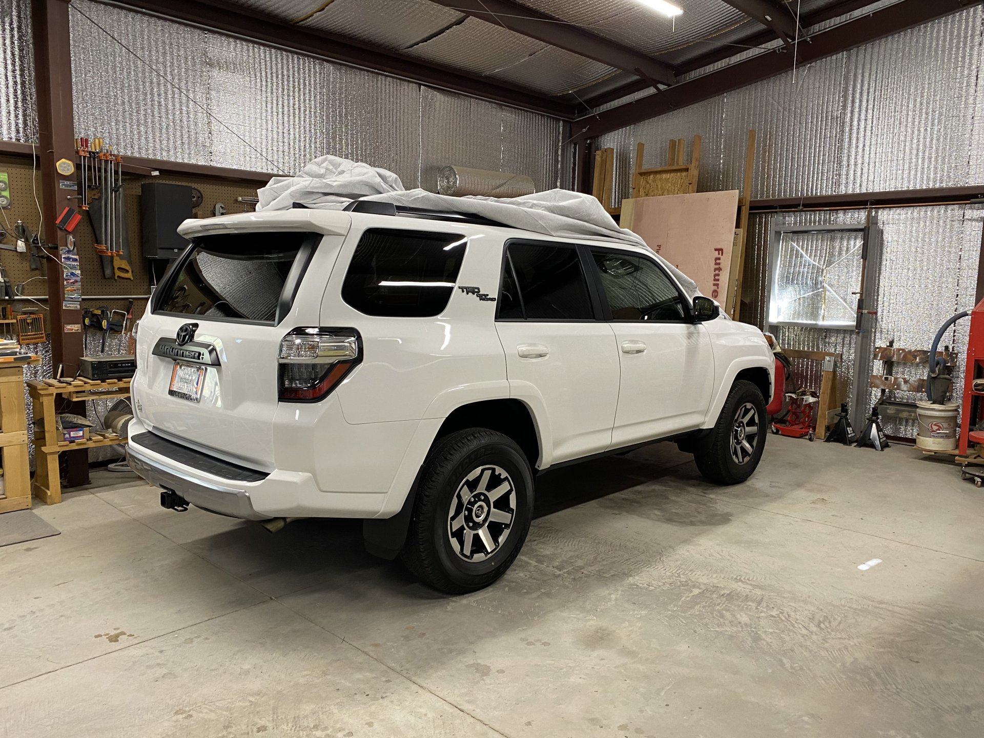

On a different note I’ve got my old suburban all buttoned up and she’ll be making the trip to Idaho so my new 4Runner is going to spend the summer here. I’ve got stabil in the tank, a nice cover for it and will get it up off the ground but had a question about the electronics. Rather than attach a battery tender I am leaning towards just disconnecting the battery. I prefer to shut off power to the garage while I’m away, just in case. It will be about five or six months in total do you guys have any thoughts on that plan of action?
I have used Sea Foam instead of Stabil for the last few years. I think either will work but they work differently. For the last 4 years I have had multiple vehicles sit with the negative leg of the battery off (nothing special about the negative side; it just typically has less junk attached) for months without issue. I typically make sure the tanks are full or nearly full. Doubt you have the humidity issues that we have in the southeast though.

Cool - I was not sure if the on board electronics on the new Toyota had any problem with taking a long nap.
No more so than changing a battery.
