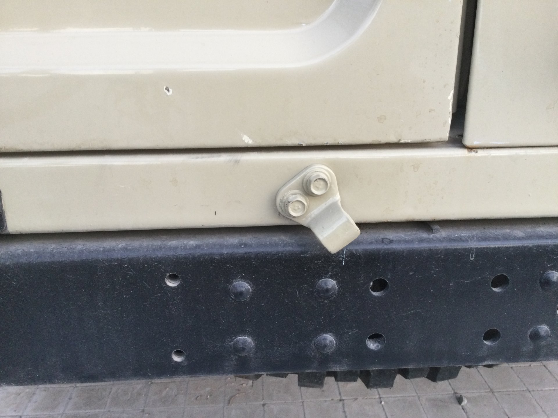

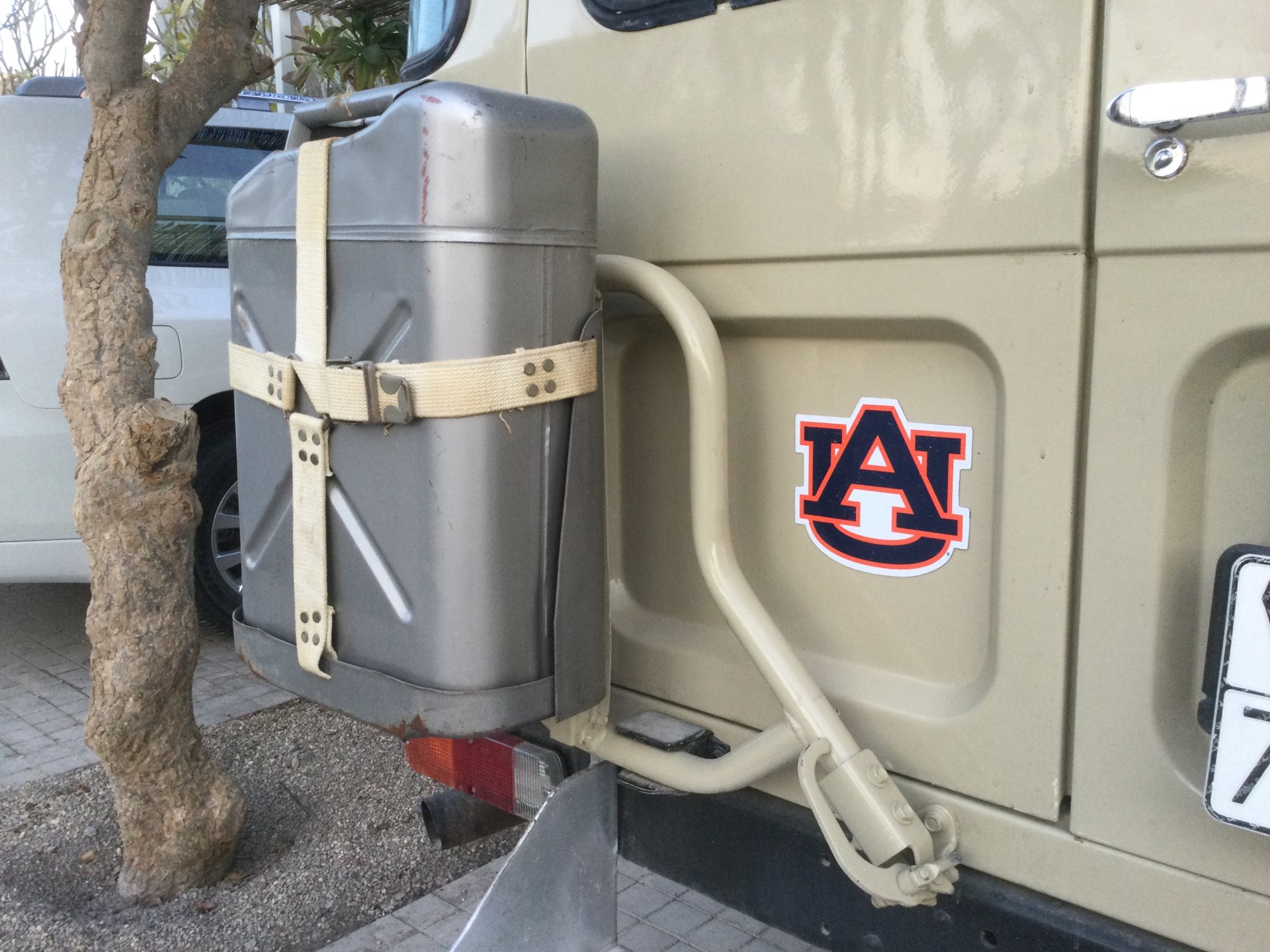

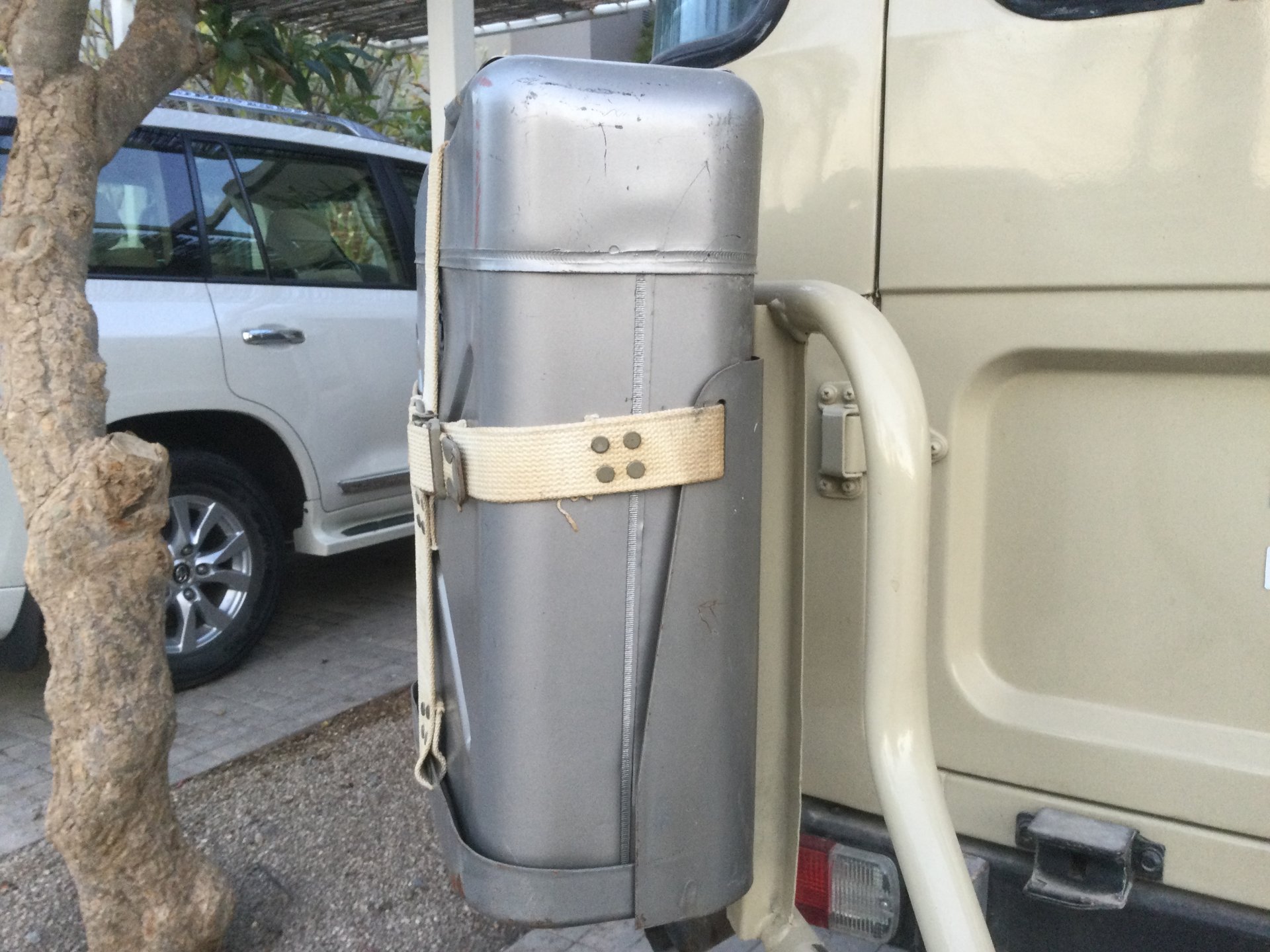

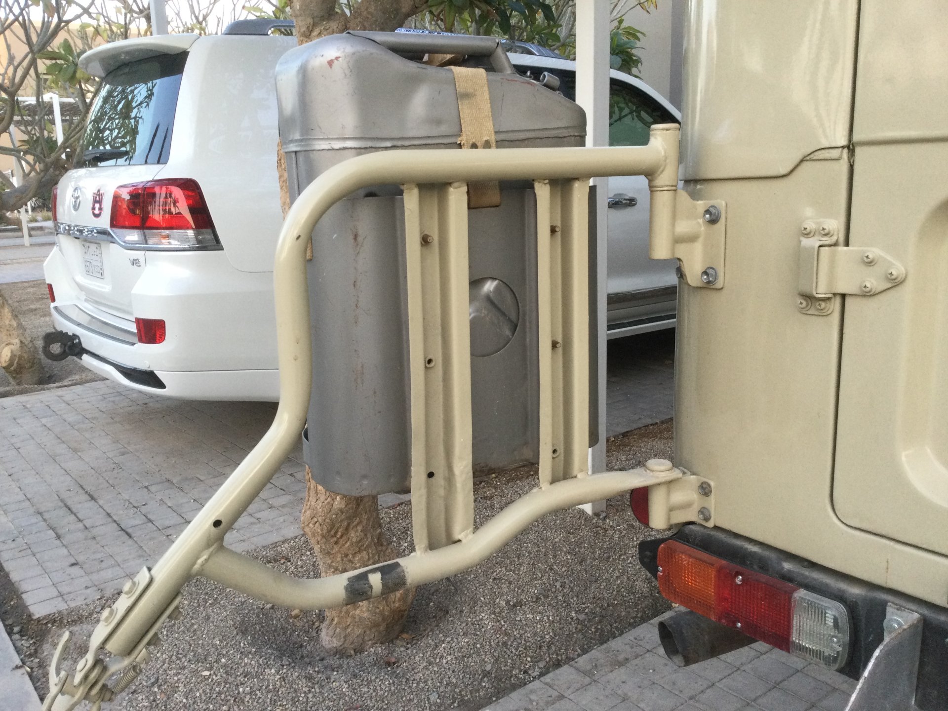

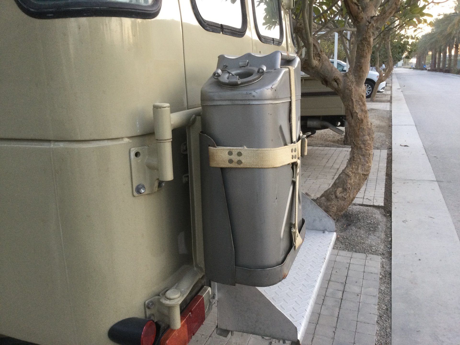

I have the correct OEM auxiliary can and carrier. Let me know if you need some detailed photos or measurements. Where’s the second half of your jump seats? There’s supposed to be two of those seat bottom sections on each side.
Seat 3&4 are MIA - never had them when I got it.
Thanks Id like to see the bracket photos if you do not mind
Not sure what you need. Took these this morning.

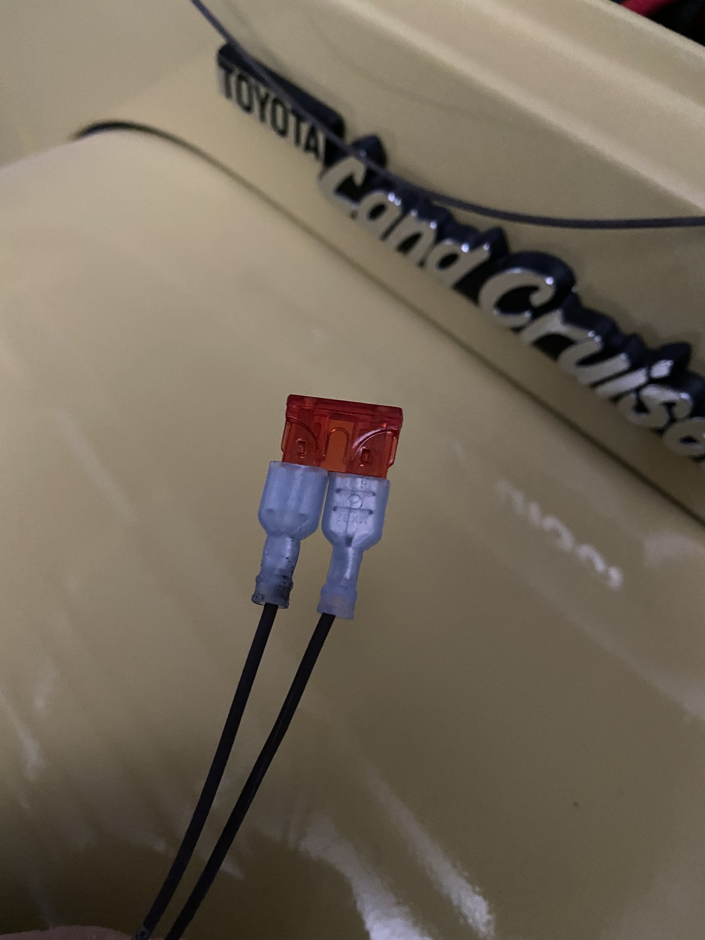

To test the system I jumped a battery with an in-line 10 AMP fuse that way if anything was wrong it would pop pretty quickly no problems so far

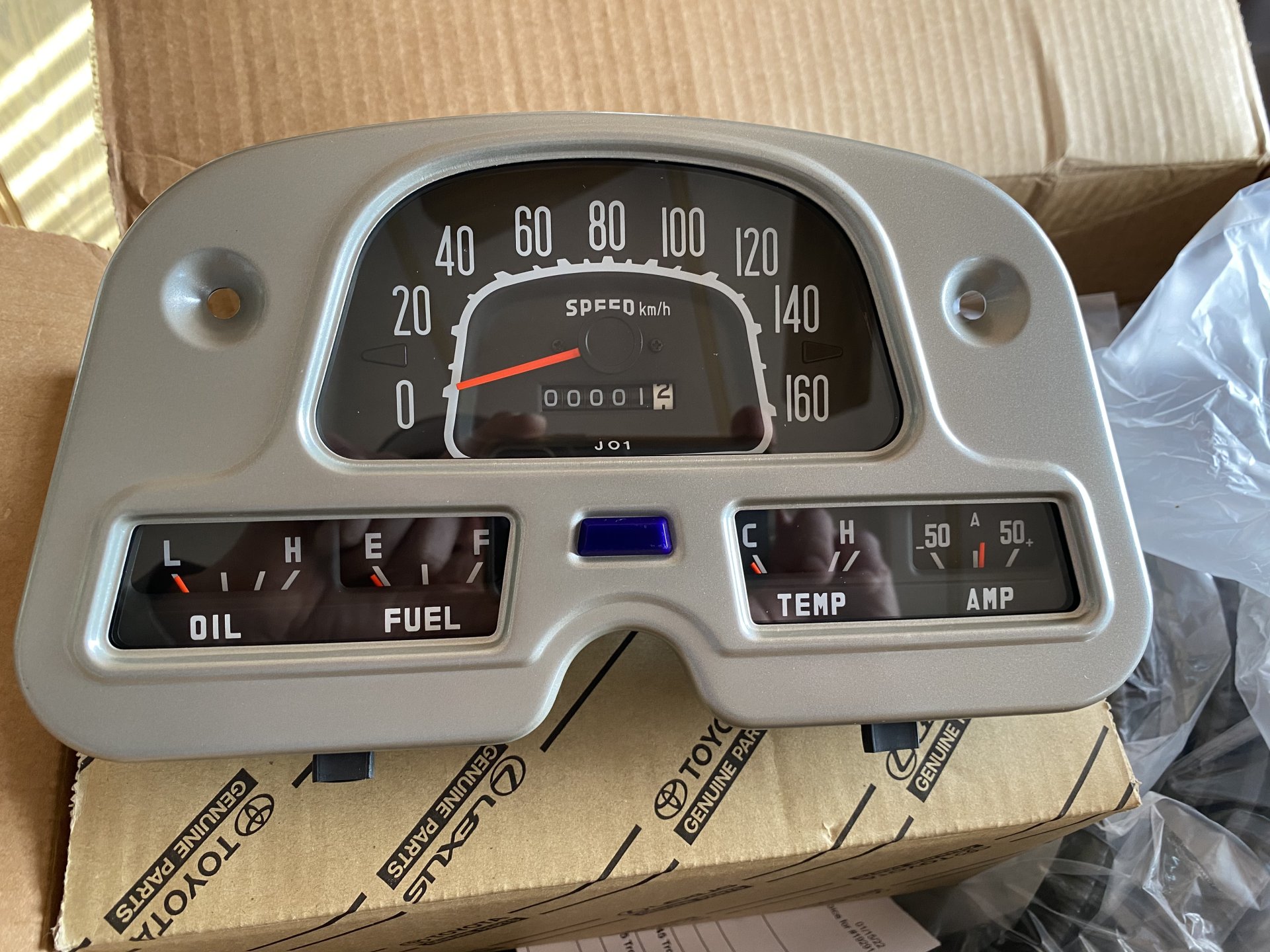

So to make up for it I’m spending money like a drunken sailor….. At this stage of the project the boxes get very expensive, I think I’ve spent more on parts in the last three weeks than I have in the first three years! I think I have all the weatherstripping I need for the doors as well as the four sliding windows. And I treated myself to this little jewel.
I’m 8 days into a nasty virus of some type and it’s really cramping my plans😳
So to make up for it I’m spending money like a drunken sailor….. At this stage of the project the boxes get very expensive, I think I’ve spent more on parts in the last three weeks than I have in the first three years! I think I have all the weatherstripping I need for the doors as well as the four sliding windows. And I treated myself to this little jewel.View attachment 2898090View attachment 2898091
Very nice. I recently purchased that same cluster to use as parts to refurbish my J07 cluster. All the parts are the same number except the speedometer and the plate with the symbols (my J07 has the symbols and not the words). Should still be plug and play in your Troopy.

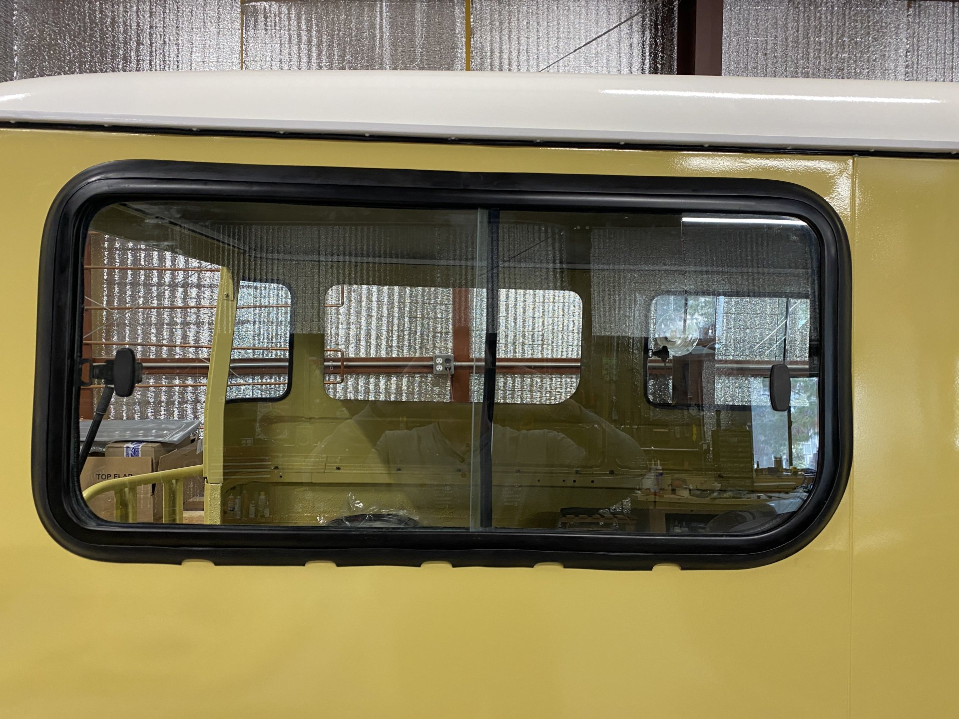

I finished three of the four sliders and wrote that up on a separate thread, the last one has a broken pane of glass and I’m trying to find a replacement but I’ll finish that one up.

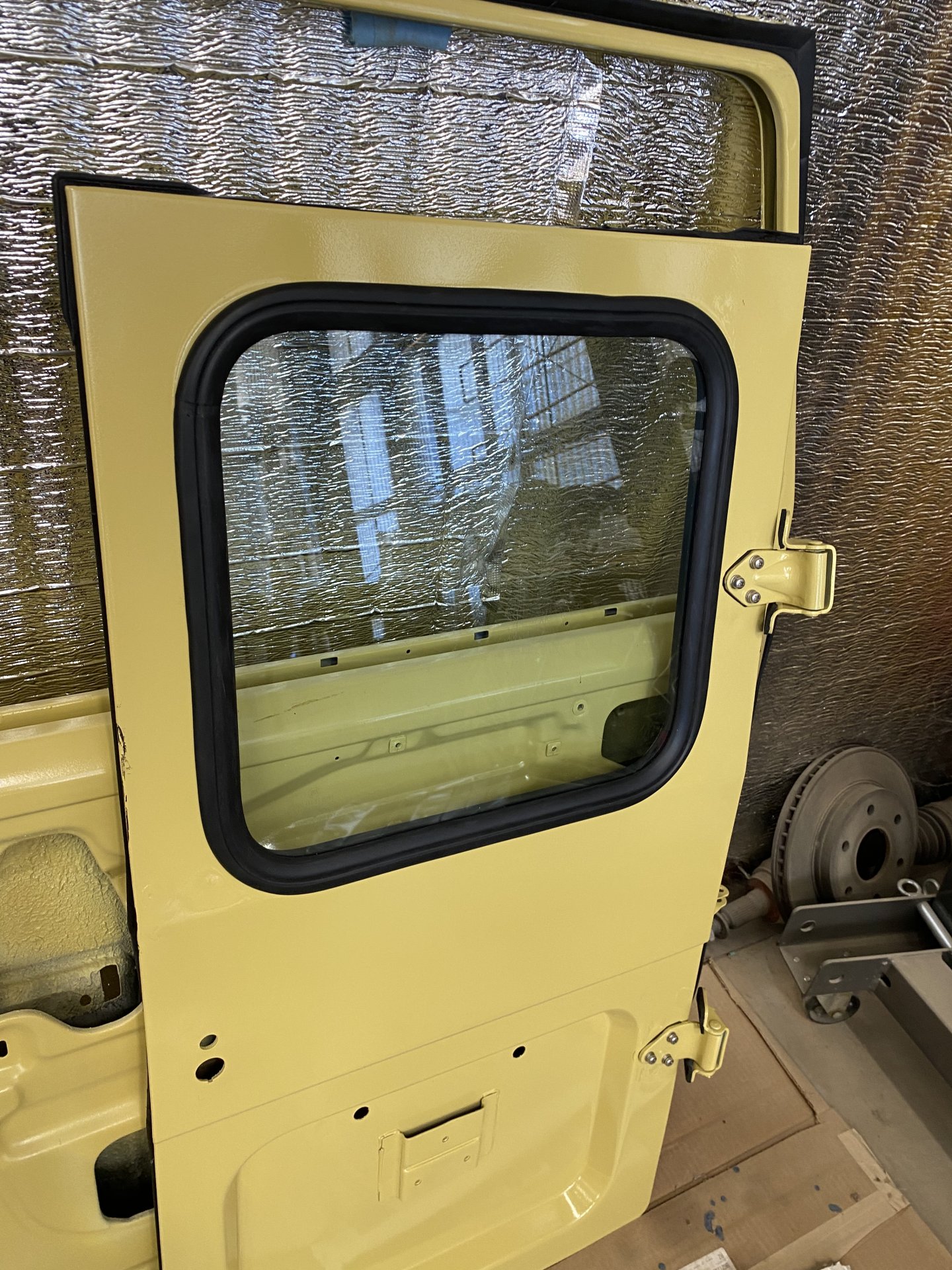

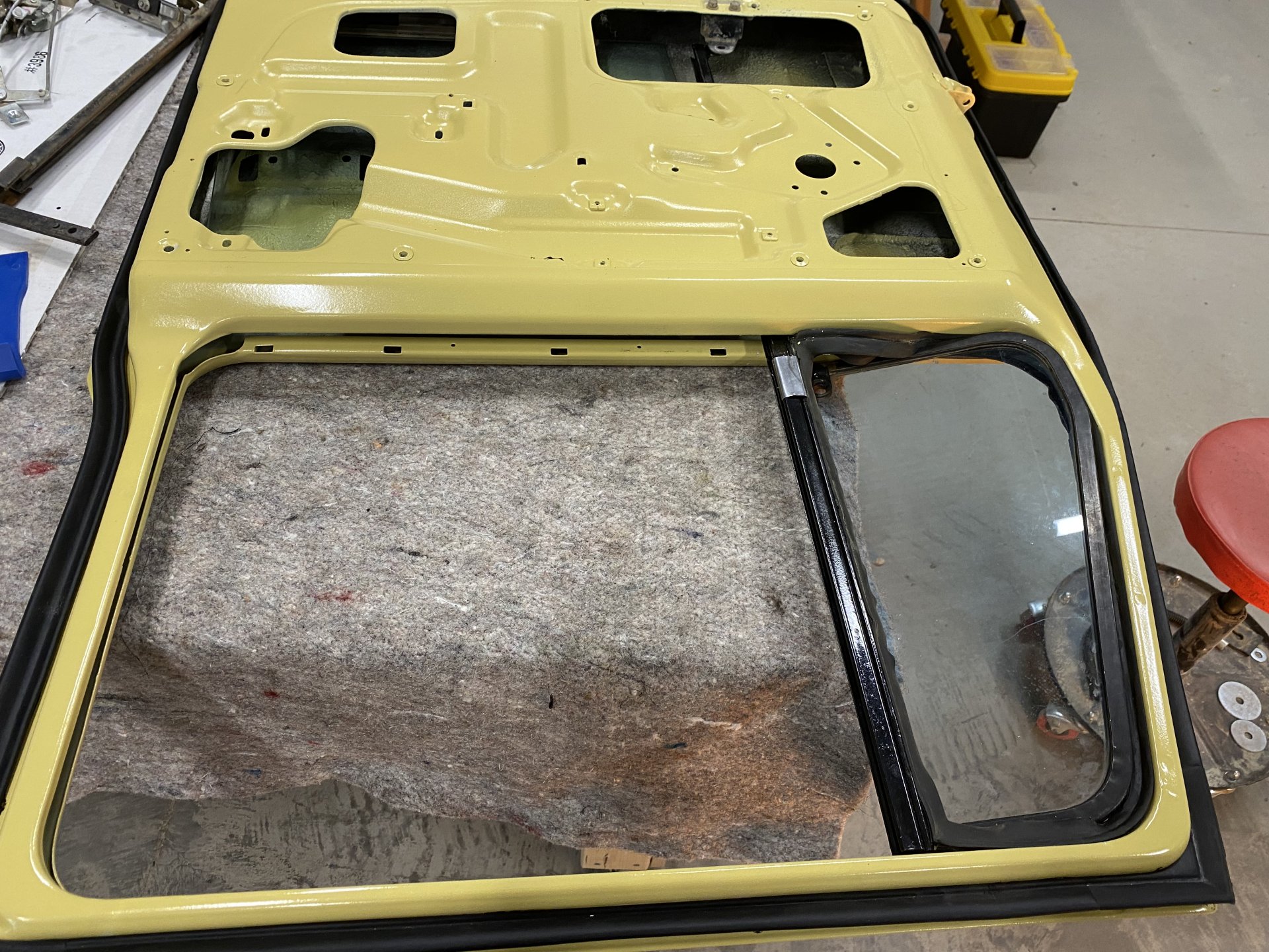

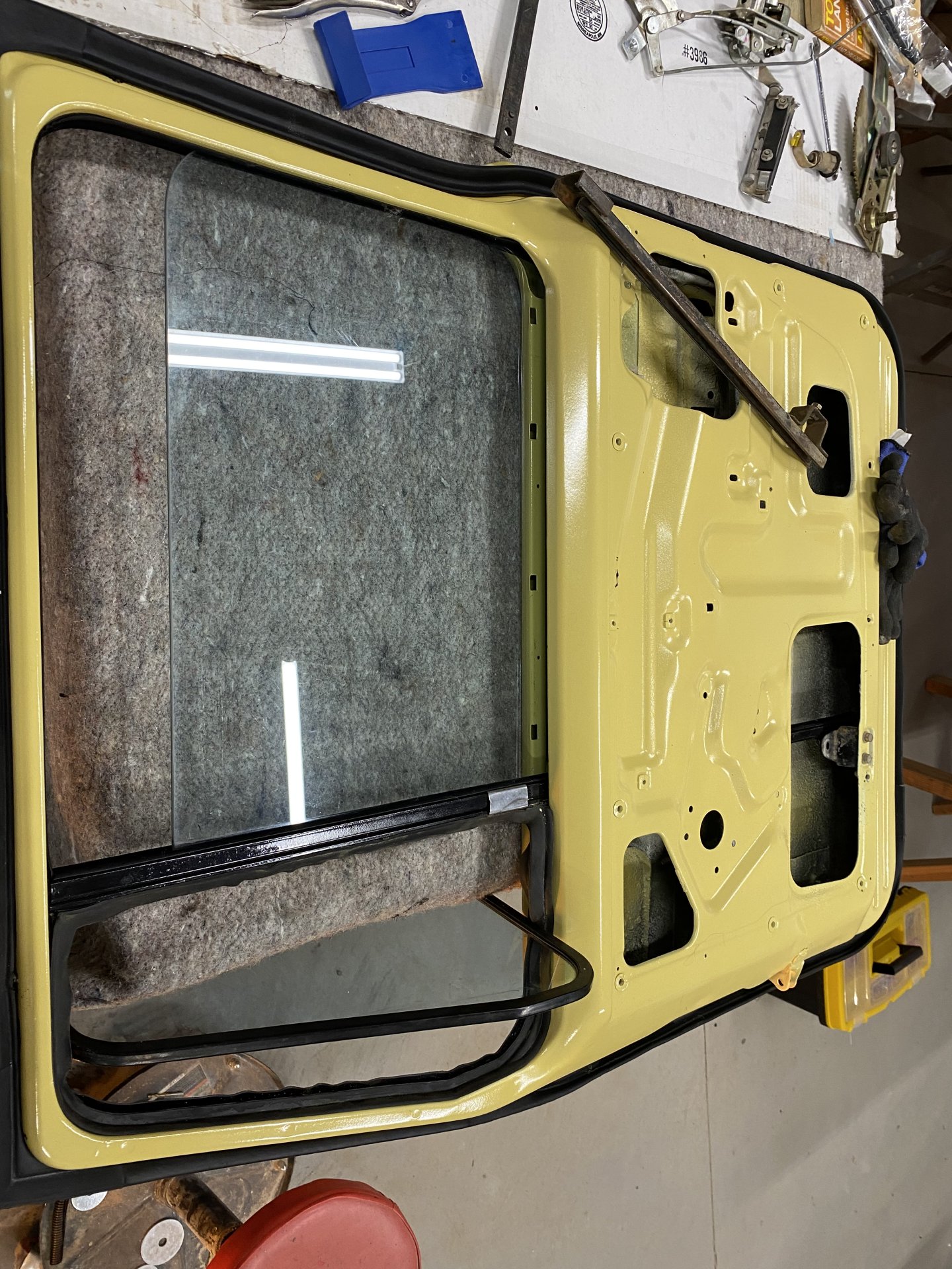

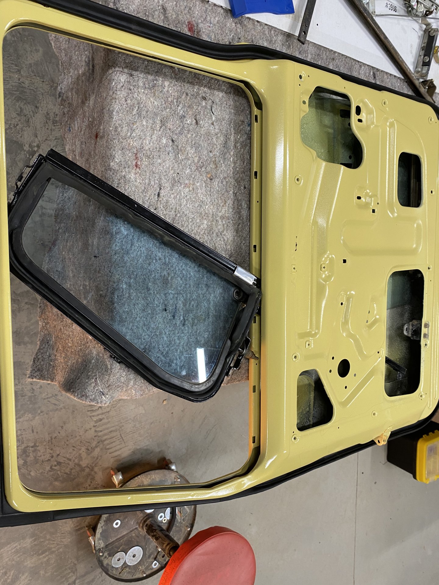

I started working on the door assemblies and got the weatherstripping in as well as the vent window and the door glass. I think I’m going to re-place the door hardware while I’m in here but that will have to wait a little bit
I could not find a tutorial on replacing the vent assembly but here’s what I found worked:
Starting with the empty shell slide the door glass into the empty compartment and let it sit against the exterior wall, then install the vent assembly with the felt channel installed. Finagle the window vent interposition and secure it with the two screws. In hindsight I should not have installed the door weatherstripping before this part.

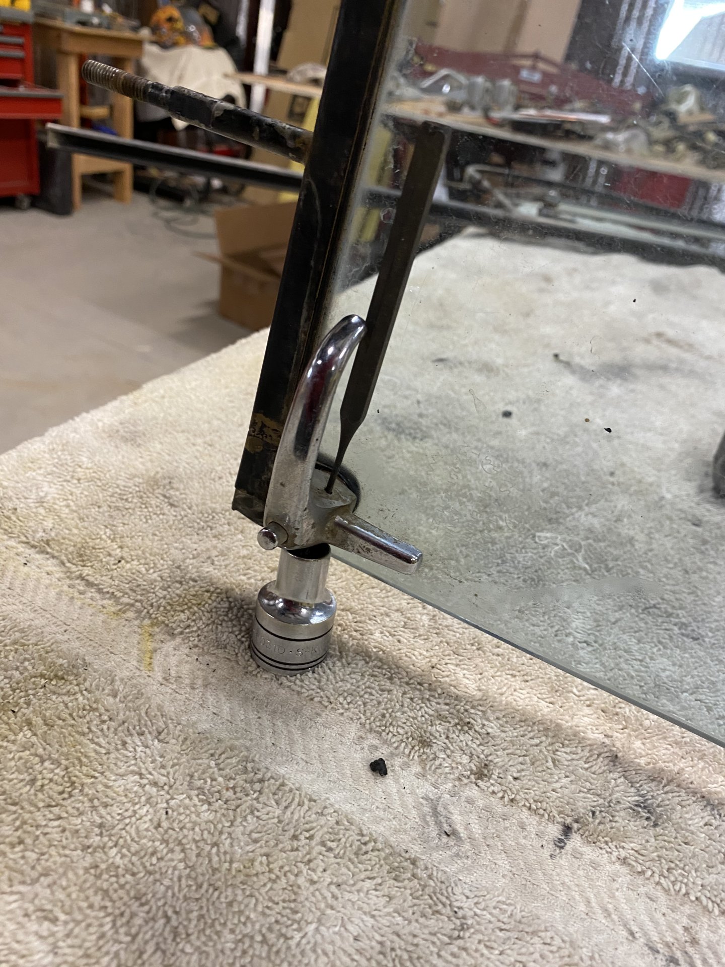

The latch used on the vent window is held in place with a single pin. I got nervous about cracking the glass so I supported it on a small socket and used a fine punch to drive it out
Then install the rest of the Felt channel and slide the moving glass up into the upright position. Then you can complete the rest of the assembly. The door latch goes in first and then that separate piece of glass channel.
I did not realize I needed an extra piece of Felt channel for that last step, luckily I had enough left over to complete the task

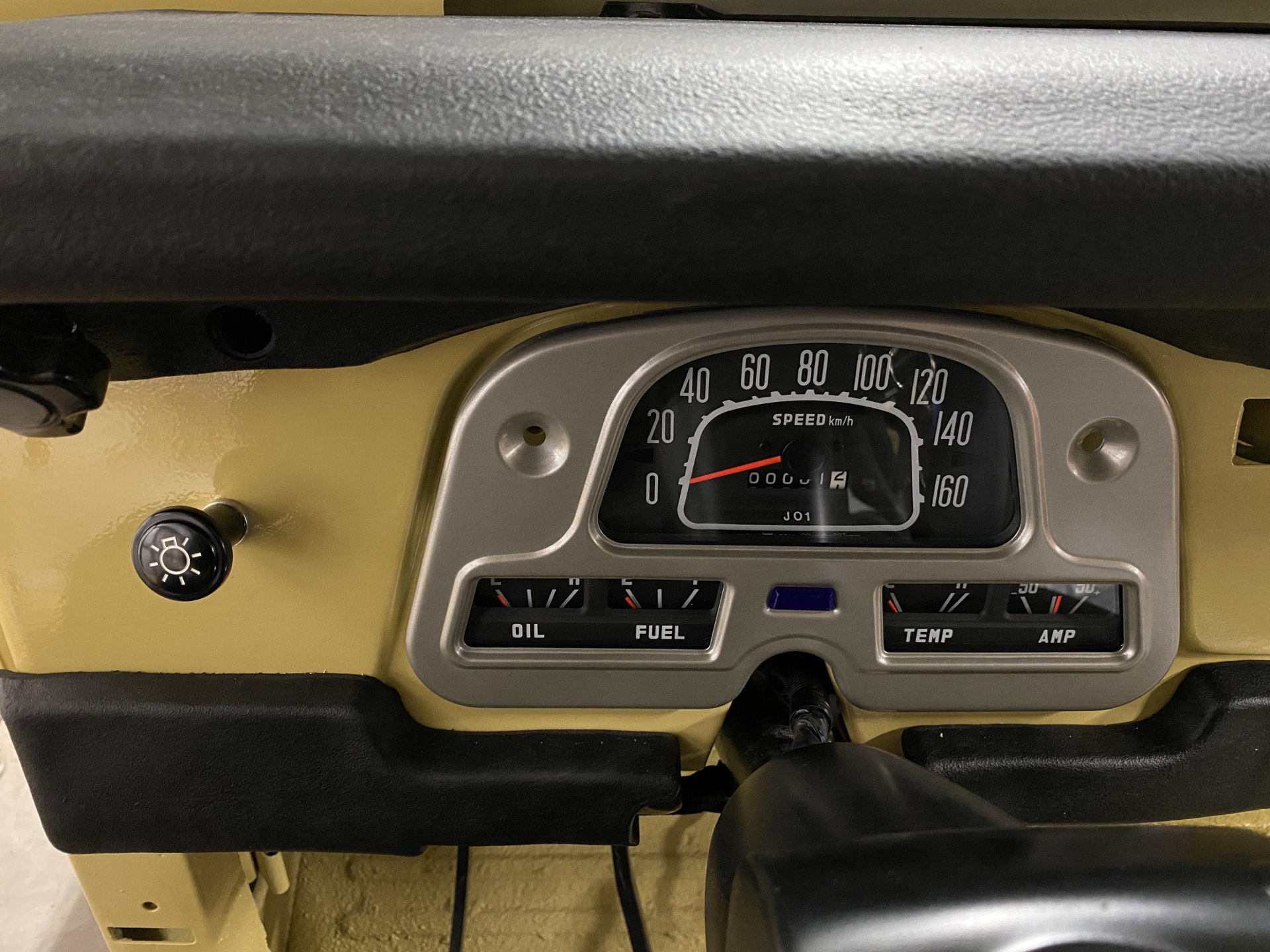

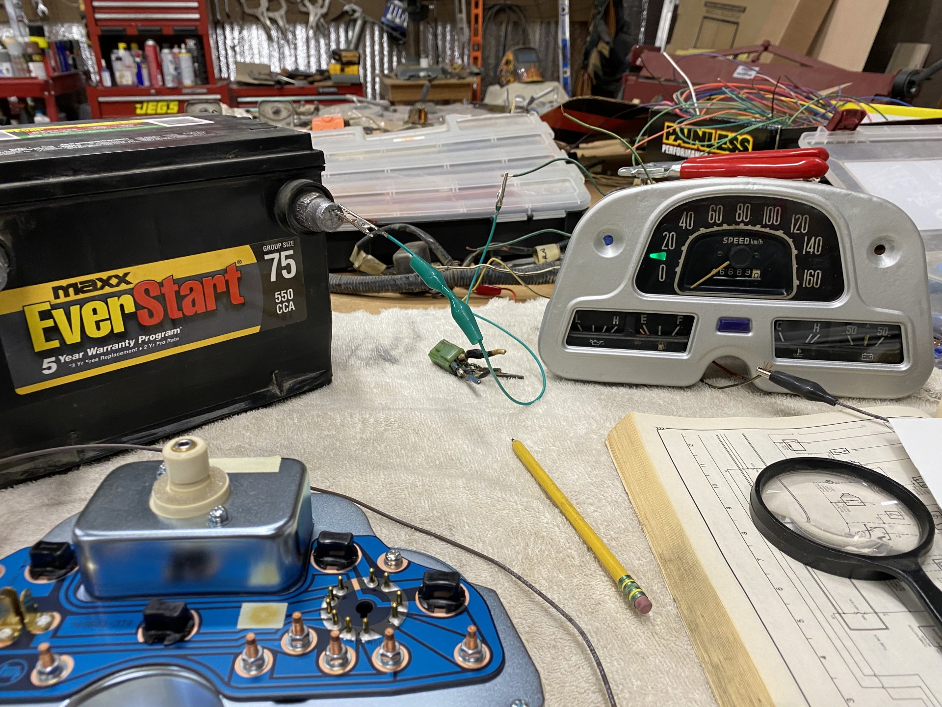

Vacation is over, time to get back to work. That instrument cluster isn’t going to wire itself .

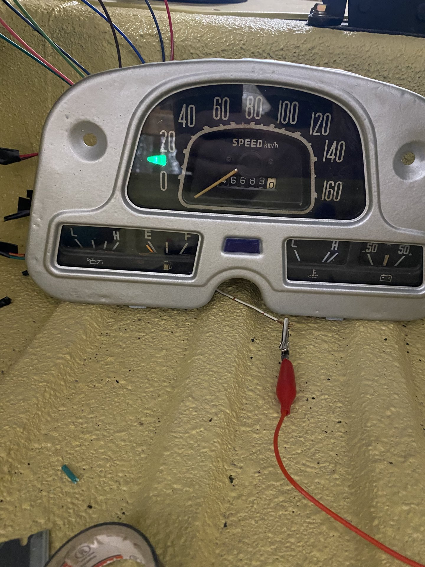

so before I make it permanent I thought I would do some tests make sure everything is working and I understand the wiring layout correctly are used a little positive jumper with a five amp fuse and a light touch just to make sure I didn’t snap anything. Tried it on the old cluster first and then took what I learned to the new one slow but sure I think I can make it work.
I still don’t know how to power the amp meter so I’ll move slow on that one

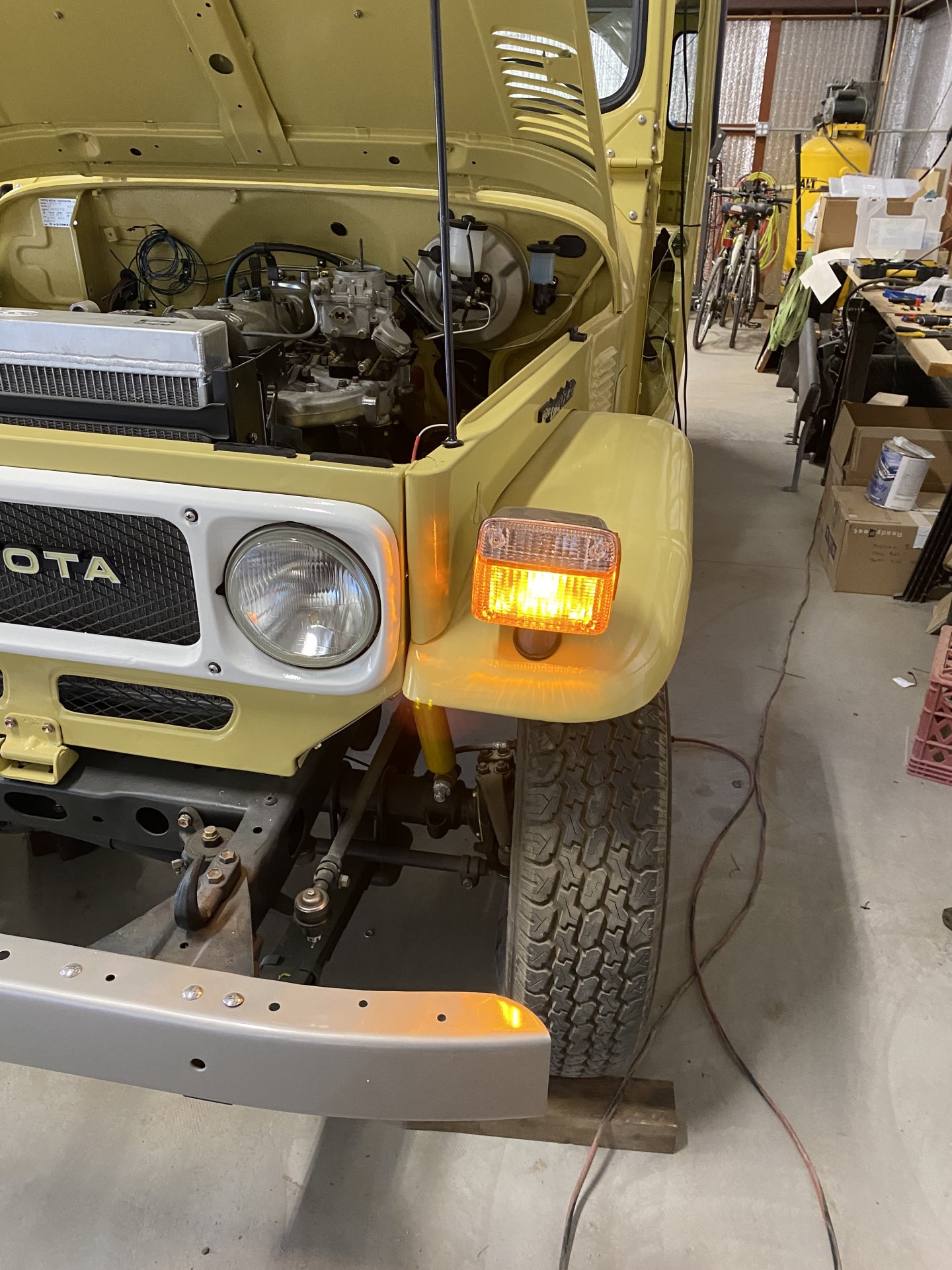

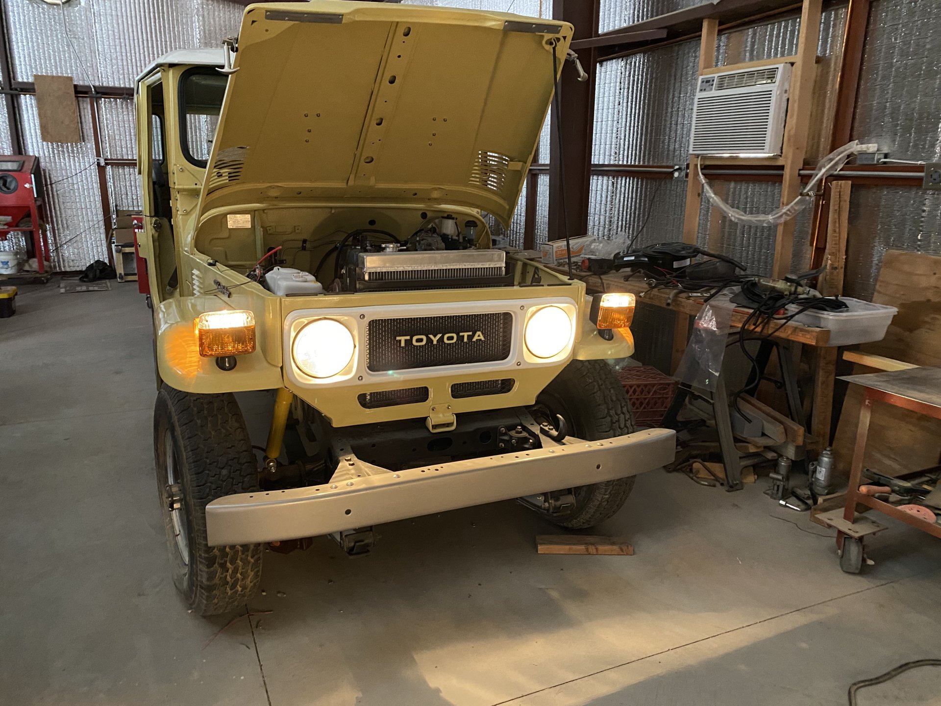

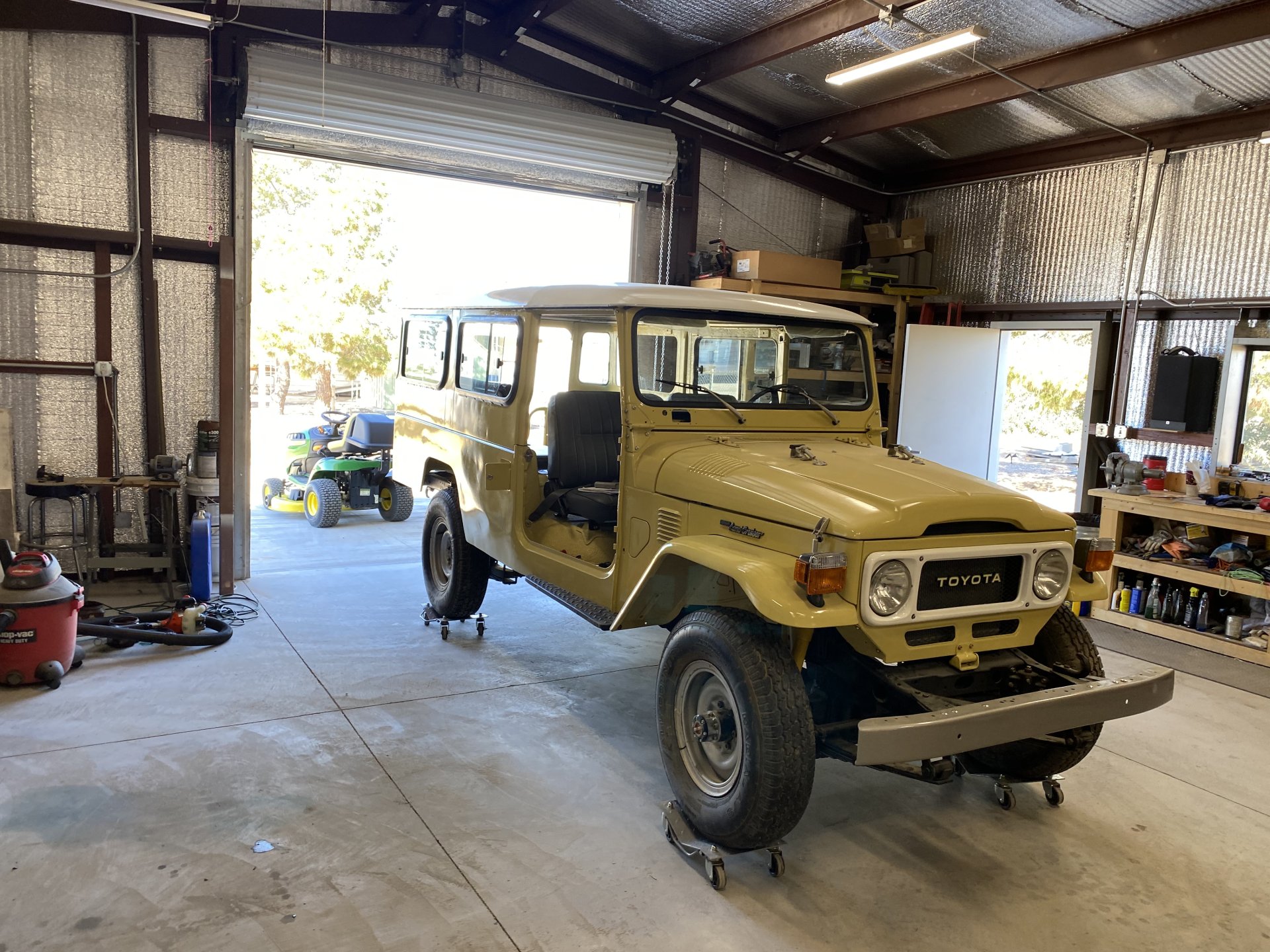

BIG DAY In Casa grande, I still have some loose ends to wrap up but was able to test fire the engine and run all 12 V through the entire electrical system. No snap crackle pop and not a single busted fuse …..yet.
I think I have all of the instrument cluster decoded and wired properly except for the ammeter not sure what I’m gonna do with that yet
But I have turn signals and instrument lights. I took it a step further put a little gas in the car and got the thing the fire with the key first time in 2 1/2 years! Wiring the ignition switch took some finagling but I got it figured out, the painless harness comes with radio/accessory/on/start and the land cruiser only had three options but got her to work just fine.

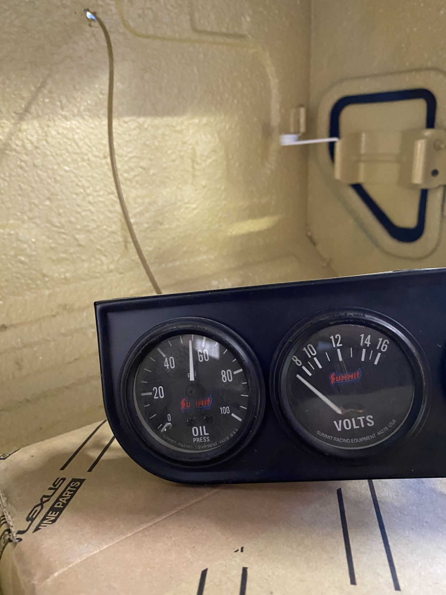

I hooked up my aftermarket gauges and lo and behold actually built oil pressure which is a very very good thing

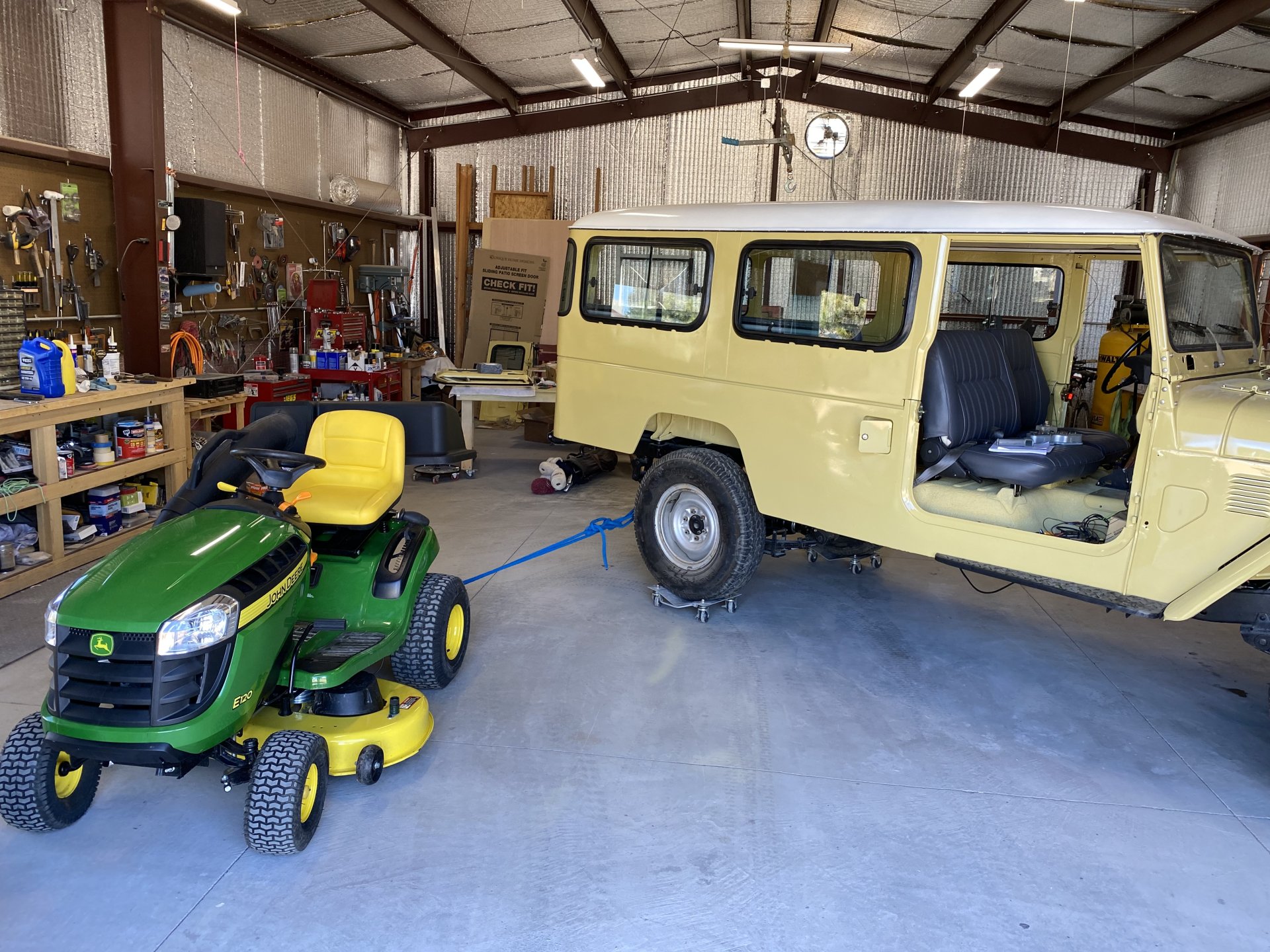

Things took a turn south this week, and I wrote it up in a separate thread if you’re interested. But that snafu has been corrected and on to bigger and better things. I got her to idle yesterday but very roughly so now I need to do some tuneup work on her. Even with my vent and fan on the exhaust was unbearable so to go any further I need to get her rear end pointed out.
The Harbor freight wheel dollies work okay but it’s still a beast to move that big vehicle around so luckily I had a little horsepower to help me out.
I checked the valves and got the timing pretty close yesterday but she still idling really rough and really rich so I’ll take a look at vacuum leaks and the carburetor today or tomorrow.

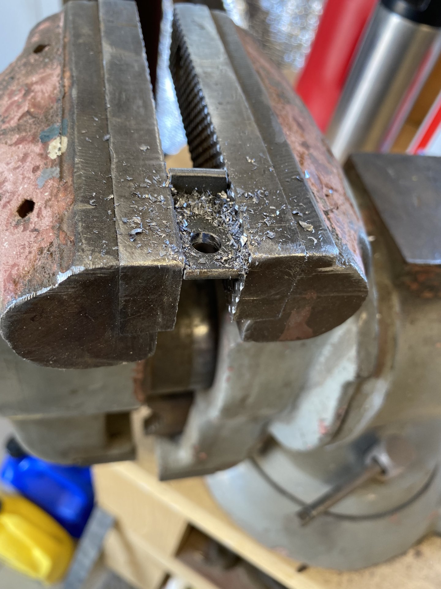

Have been jumping around and Saturday and this morning and working on the brake system. I was able to save all of the hard brake lines only one had a gnarled up fitting and of course that’s the one that was leaking. Stumbled upon a cool trick on a TV auto show, loosen the fitting slightly then retighten loosen retighten and repeat and you can actually watch the fitting thread in deeper each turn since this was a gnarled fitting I use my vice grips and did that walking back-and-forth and got a full additional Halfturn out of it without having to take the vice grips on and off problem solved..

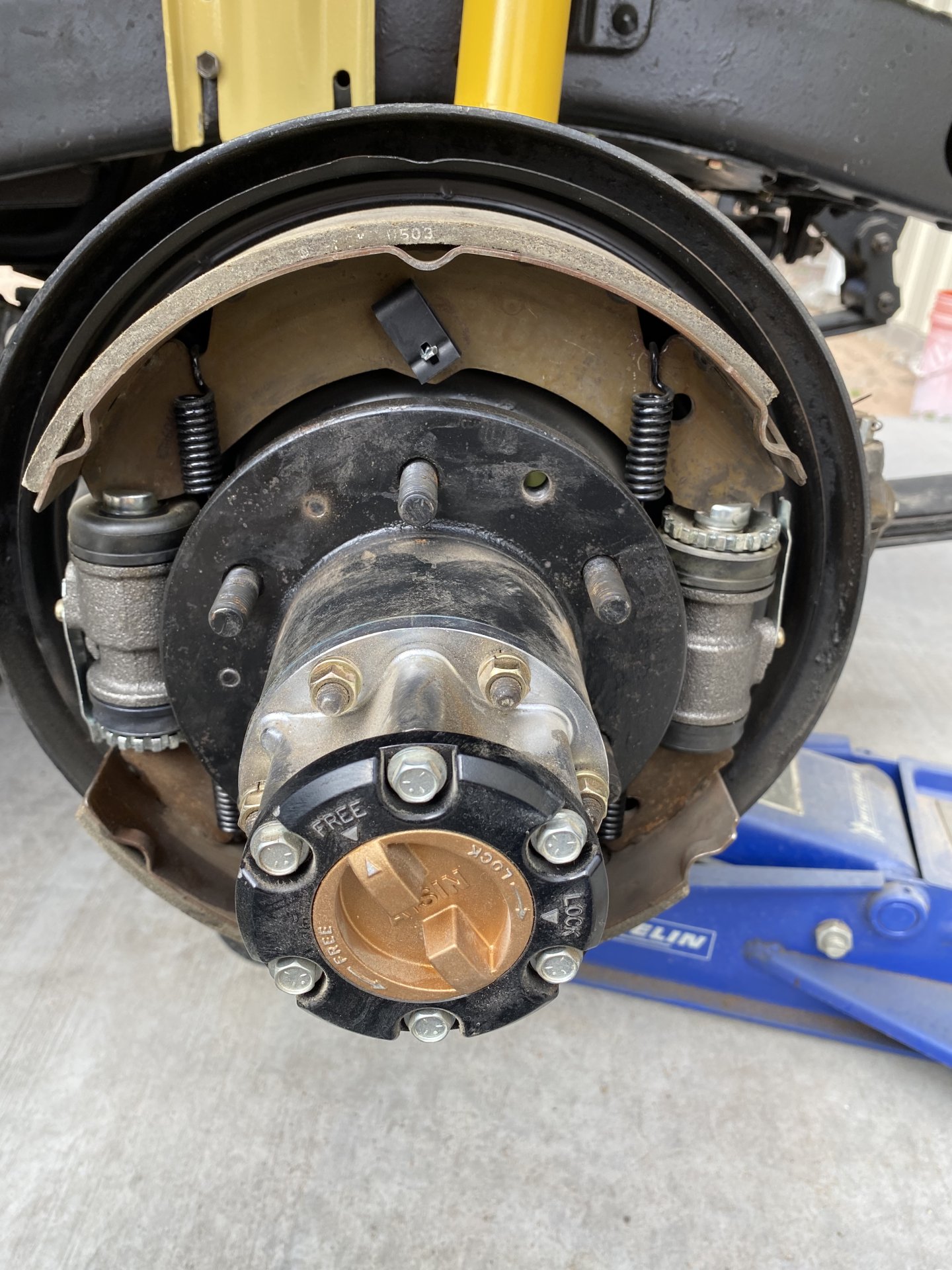

I still had no pedal to speak of and then I remembered I had not adjusted my new drum brake shoes. So I started in the front and was astounded at how much slack there is between the drum and the shoe I made myself a little caliper to measure the distance so that way I could just crank the adjusters to get it close and then put the drums back on.

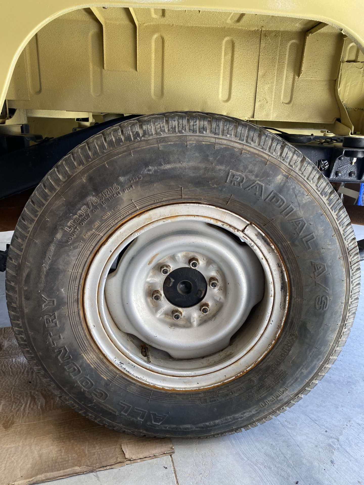

Taking a break from wiring up the instrument cluster and thought I wanted to do something with immediate gratification. I’m not sure what I wanted to do permanently for wheels and tires but cleaning up the old kicks make a big difference👍
