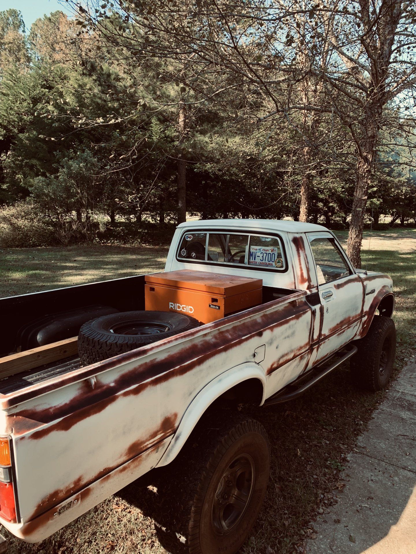

Messing around a few evenings ago. Wanted to try to give the old truck a little more character. Of course I have no clue what I’m doing so just having some fun with the white canvas. I might keep it like this for a while before I repaint it.
I will post better pictures later. I know this one isn’t the greatest. Haha
Hey if you want a truck with patina, you can have mine :hillbilly:

One time years ago I painted my brake drums yellow. A very good friend said to me... "It kind of makes you wonder who drives it."
I love your pickup, but I had to tease you about the fake patina :).
Yeah. No worries. Just messing around knowing it’s an old $200 paint job.
I now have three different shades of tan and one bedside that has all the paint burned off. I am going to have to put paint on that side so it doesn't rot away. I'm afraid I am going to have to paint the whole thing eventually which sucks because it has the perfect set of dents and patina. Not a raisin, just beat enough not to worry about scuffing it on things. I like it but around here everybody drives shiny new pickups.
I am positive people wonder who drives it.

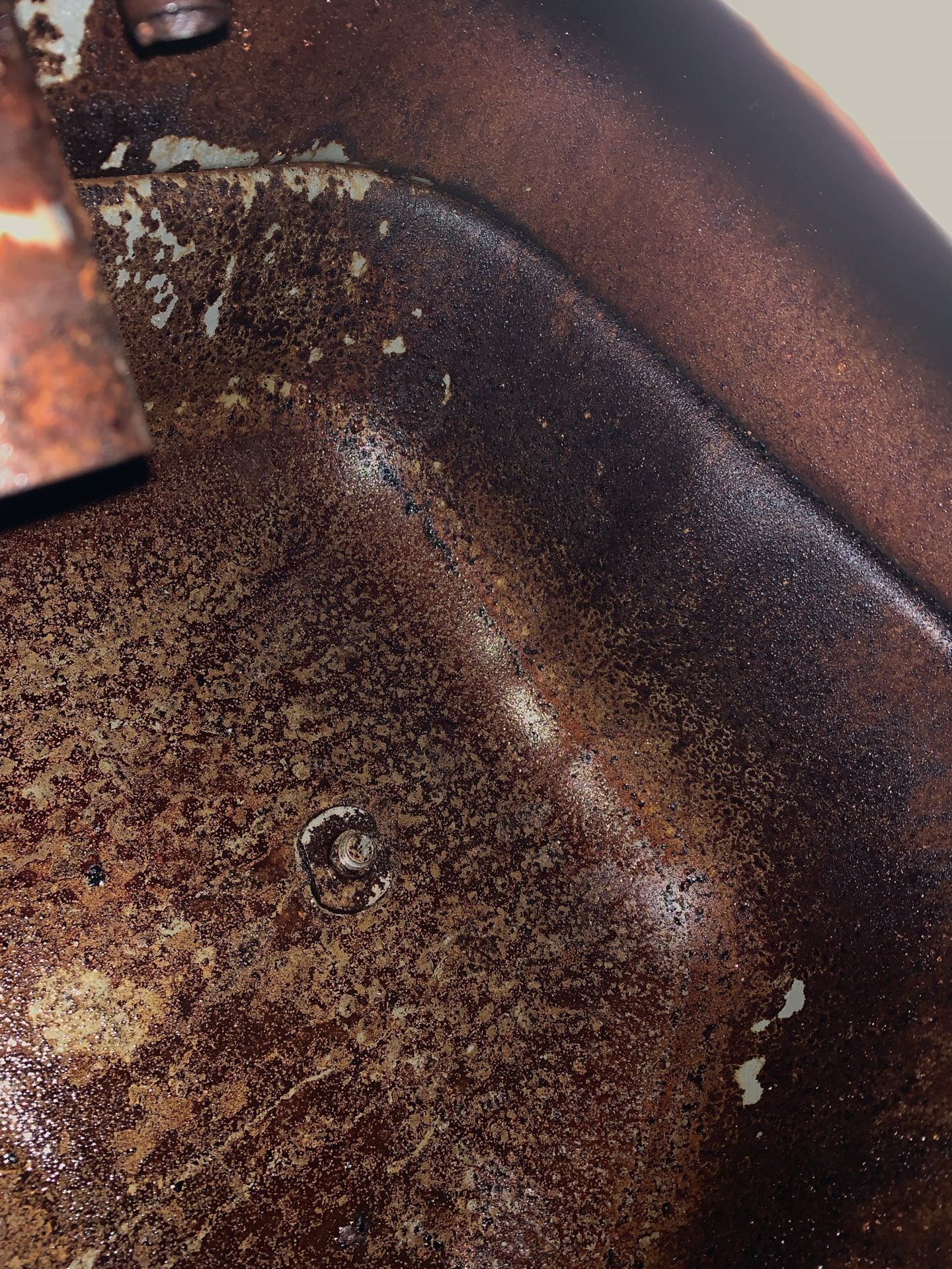

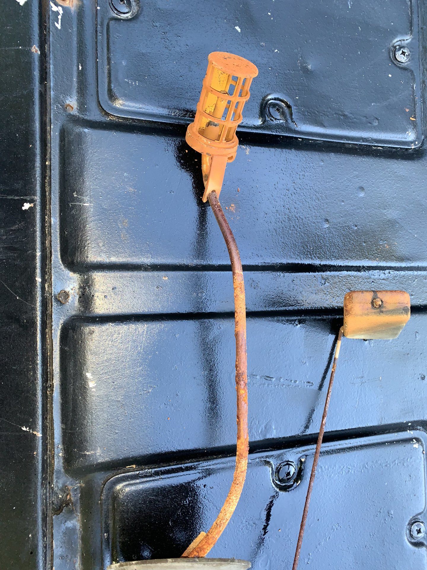

Messed around with the old truck today. Had to replace the fuel filter again. Finally got tired of doing it so I dropped the tank. It is super rusty inside the tank. I have a por 15 tank liner kit for it.it will be used on my other 82 pickup maybe. I went ahead and ordered a new 19 gallon tank from roxk auto.
I wish I could find a new sending unit. I cleaned up the one I have but not sure if it will work again, it’s pretty rusty. The strainer at the end of the pick up line was completely destroyed. I can’t find one of those either so I’m going to try to modify one from another model.
wow, I took my tank off as well last year but for other reasons. My tank was mint inside.
After doing some shape and size comparisons now that the tank is out I went ahead and ordered a new tank from an 84 Toyota long bed 4x4. The tank is slightly deeper because it hold more fuel but everything else looks the same. I am pretty sure I can make it fit fairly easy back In he stock location. I might have cut out the cross ember and adjust its position to make the tank fit but should be too bad.
On the plus side I will gain an extra 5 gallons with the new tank.

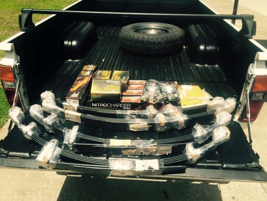

With a 10% off sale on eBay I also ordered ubolt flip kits for all four corners and some headlight improvements.

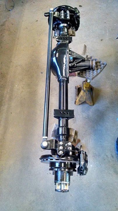

4:88 gears, ARB locker, disc brake conversion, chromoly axles.
Front rock jock axle housing, 4:88 gears, Arb locker, crossover steering, fj80 tierod ends, 6 cylinder brake upgrade, six shooter knuckles, chromoly axles

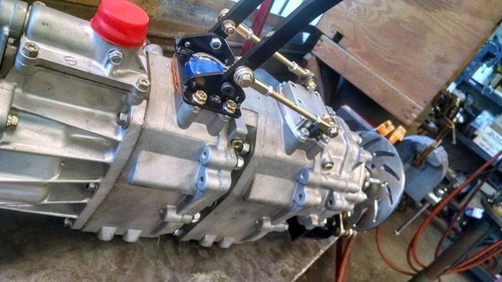

Marlin crawler HD W56 5 speed.
Dual transfer cases rear with 4:70 gears
All pro driveshaft park break
RADESIGN triple shifters

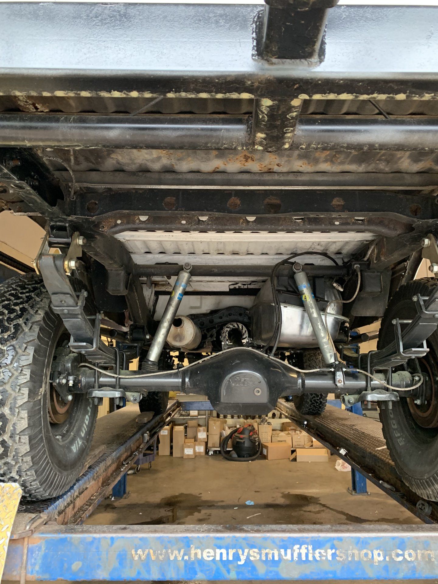

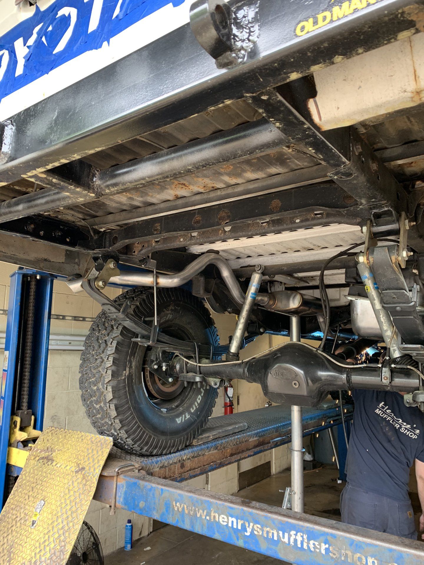

Old crappy paint can looking muffler replaced today.
Truck is a little more quiet but not much.
