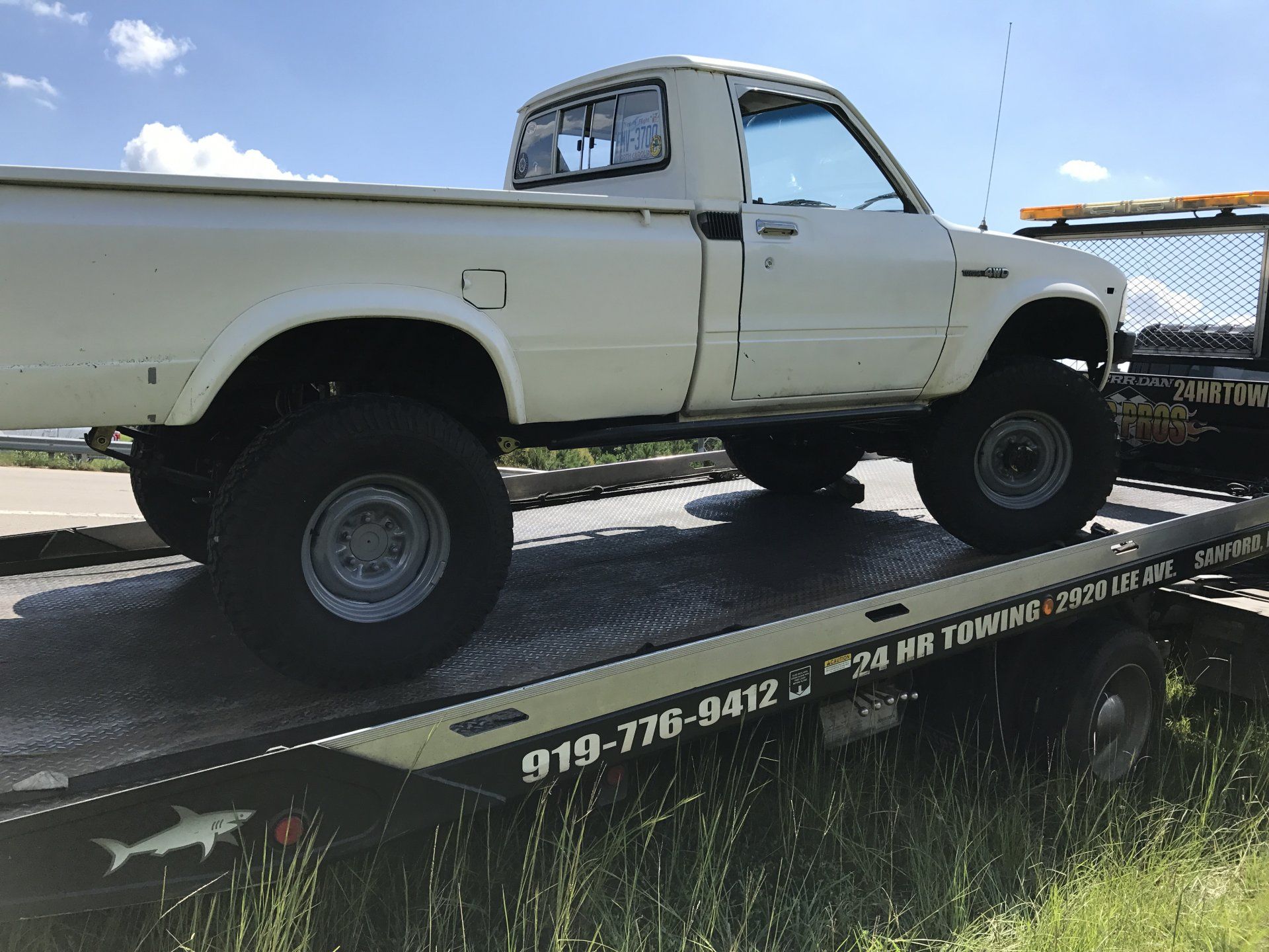

Well. The steering box went out on me on the highway. Was on my way to Logans Run 17 out in Uwharie. Was cruising alon at 65 mph with no issues and then realized that I could not steer to the left so managed to get to the side of the road without issue.

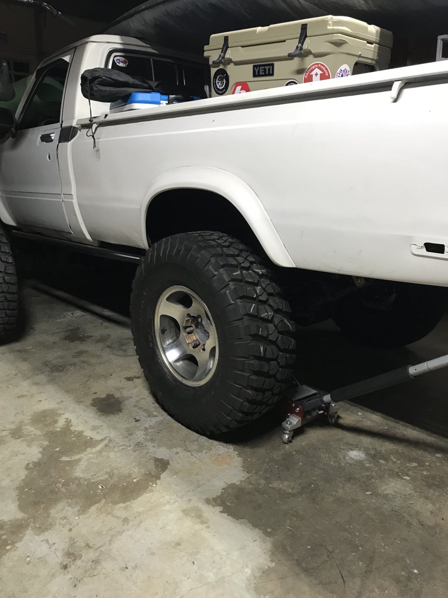

Does anybody know what would cause a power steering box to stop turning to the right?
Vehicle info:
My 82 Toyota has a power steering conversion from trail gear and a 86 power steering box. The truck was driving fine then all of a sudden without warning I could no longer steer toward the right. I was driving on the highway around 60 mph when it happened. Luckily I was able to ease the truck into the shoulder. This happened a while back but I’m just now getting around to messing with it.
I will first inspect for any obstructions that would prevent the steering to go right.
I will lift the front wheels off the ground to heck if it still won’t turn.
I will also check to see if the steering box slipped from center somehow. Because it was driving fine until it happened.
If I can’t figure out what caused problem I will replace the steering box with new one and hopefully it will fix the issue.
Does it turn right to a certain point and stop? Or does not turn to the right at all?
Is this the same box that died on you last year?
It is the one that went out a few months ago. I am just now getting around to replacing it. The steering worked fine when I drove it around the neighborhood a few times once I got the truck running on its own power for the first time. I took it for a 30 min test drive at worked fine. I then drove it on the highway for about an hour on my way to uwharrie when it just suddenly stopped working properly.
The steering wheel does not turn to the right at all. It turns to the left perfectly fine.
This is a power steering conversion. I am using a used 1986 power steering box with a trail gear power steering conversion kit.
My plan was to just replace the old box with a new one I have in the garage. But before I do that. I would like to trouble shoot what went wrong. And to be honest. Trouble shooting is definitely not my strength which is why I usually just replace the broken part instead of trying to figure out why it failed. But I am really trying to change that.
Fixed it tonight. The steering had walked because the lock washers were never tightened. It was very noticeable after I took the tires off to use on another project.
I made the adjustment to the bars by twisting them until I aligned the tires steering box and steering wheel. Now it turns both ways.
I am going to pick up lug nuts for the new rims and tires tomorrow and take it for a quick test drive.
