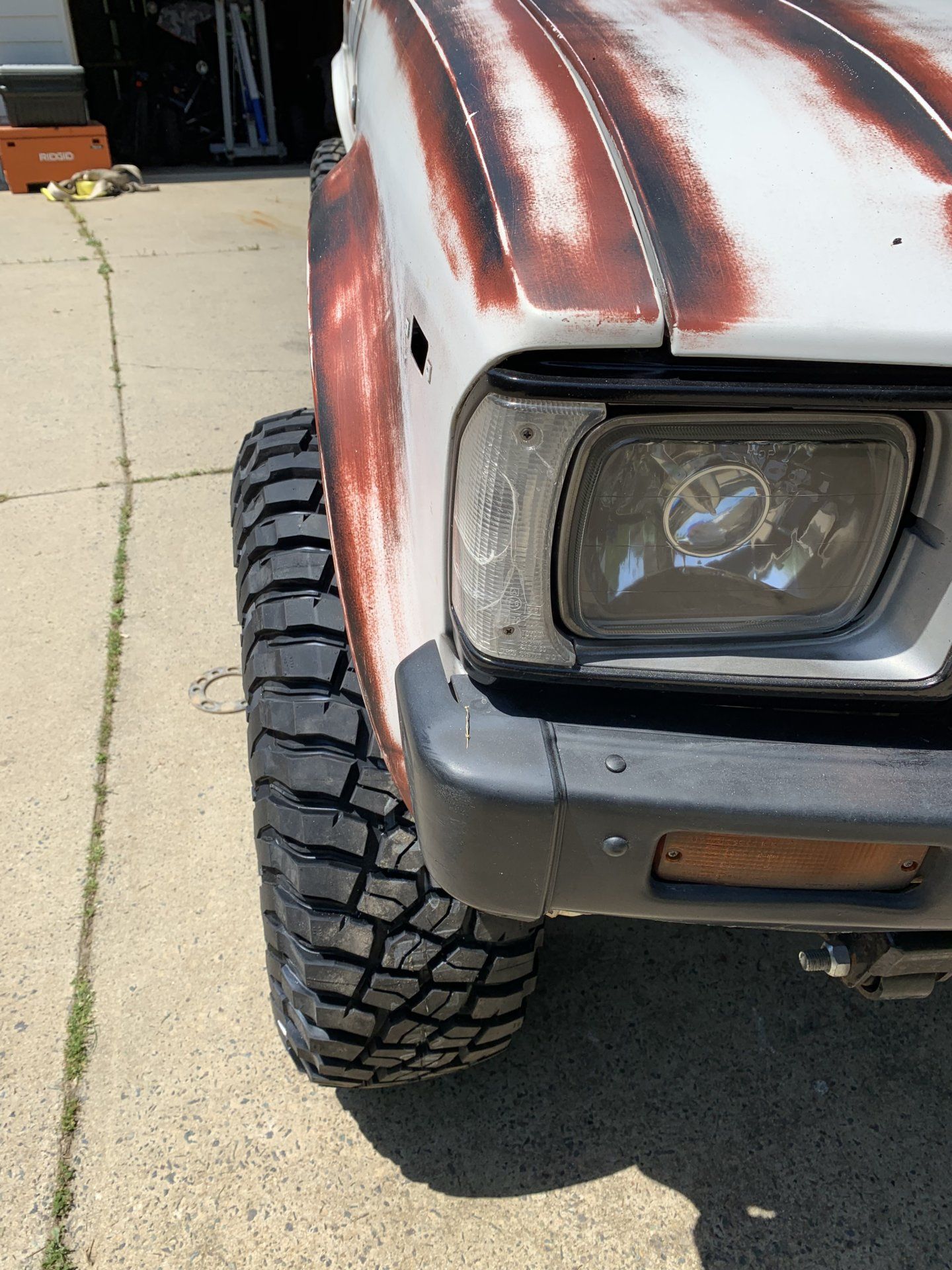

Finally wheeled the little old truck. It performed awesome. Took a while to figure out the triple sticks but the truck performed just like it was designed to do. I wheeled it with the 33s all terrains but planning to upgrade to 35x15 mud terrains to help with the muddy, rocky terrain we have here in NC.

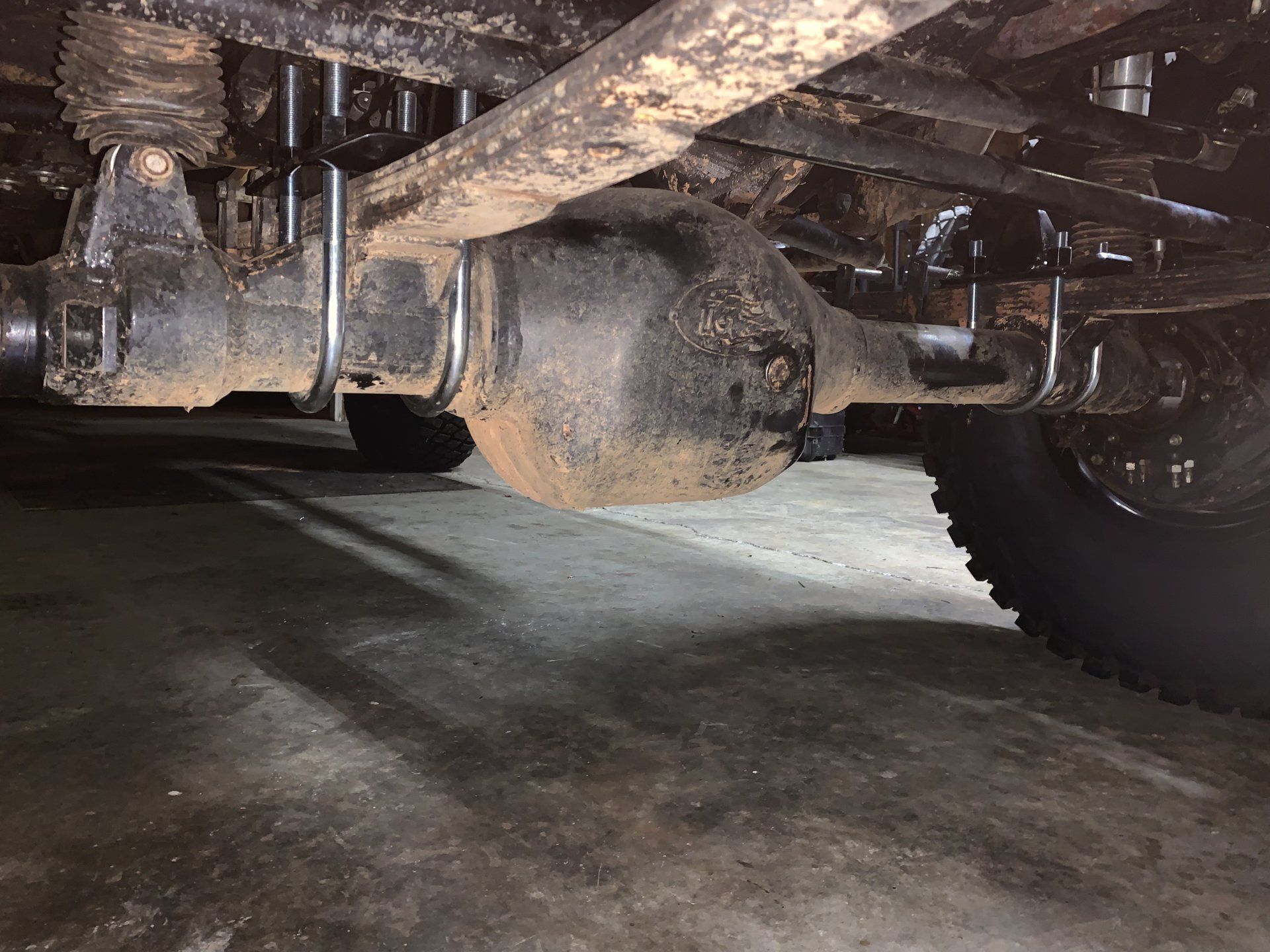

U bolt flip all four corners -DONE
Weld new rear shock mounts- done

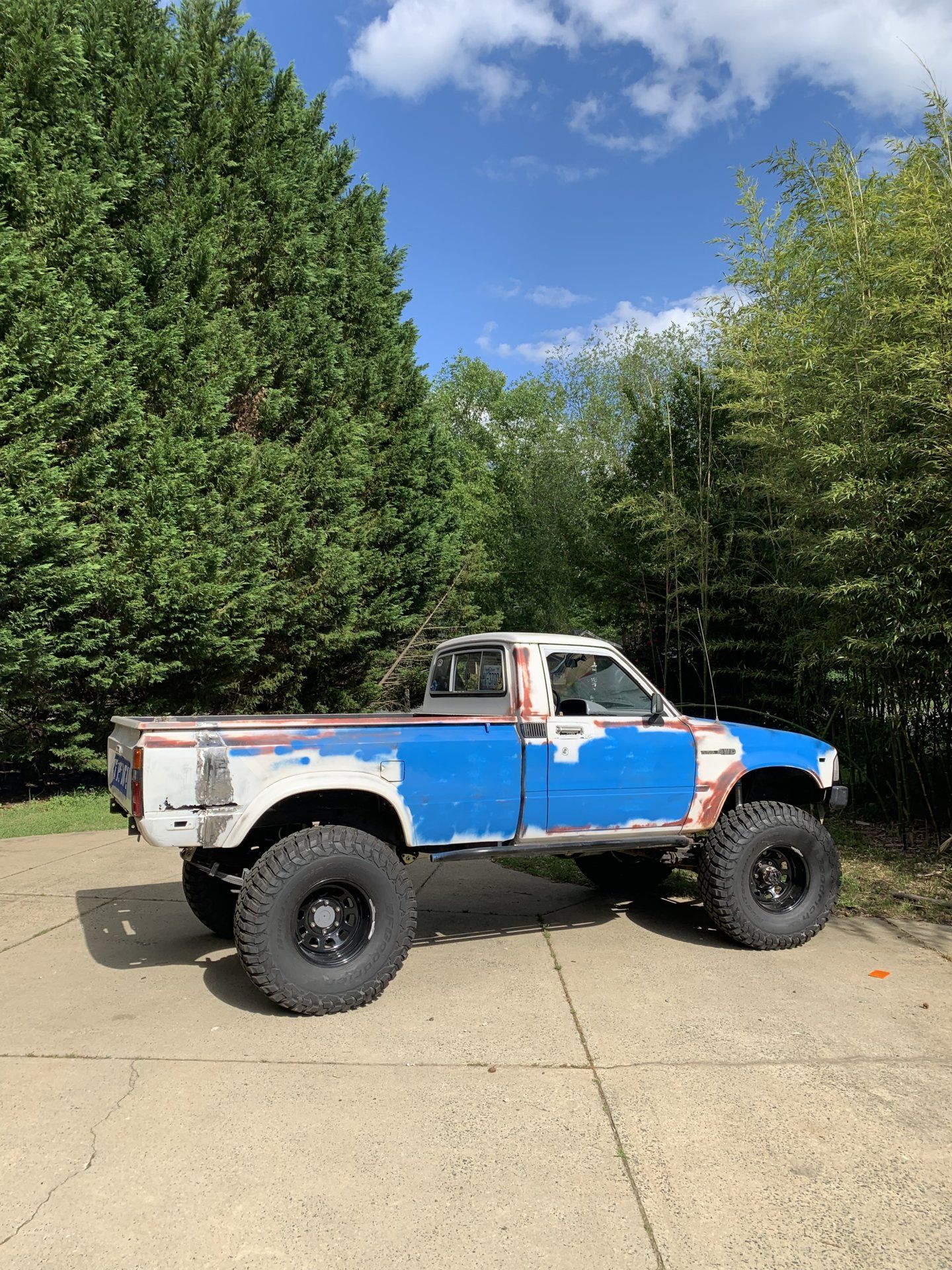

Please tell me you are changing colout to that Toyota blue....
Was doing spray outs to show my kids what the truck would look like.
I am going to spray it gray with a little more metallic than the gray in this picture.

My kids picked blue also. But for now I have some cheap gray paint that I’m going to spray while I continue to do body work and rust removal.
When I’m finally done I will respray it with good automotive paint in Toyota blue. Maybe cavalry blue with old school stripes.

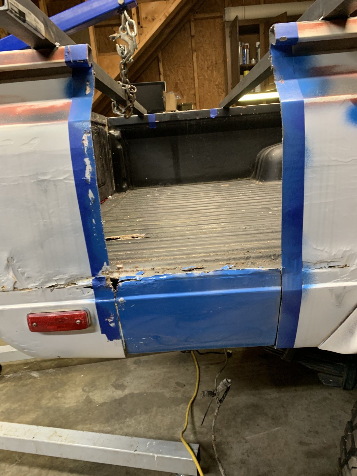

I sectioned the bed floor slightly off set from the bedsides for 4 good reasons.
1 I removed most of the rusty bed floor
2 able to Keep the bed supports under neath
3 have more bed floor left over to patch up other small rusty sections on this bed and on my other short bed
4 got to keep the end piece of the bed floor near the tail gate.

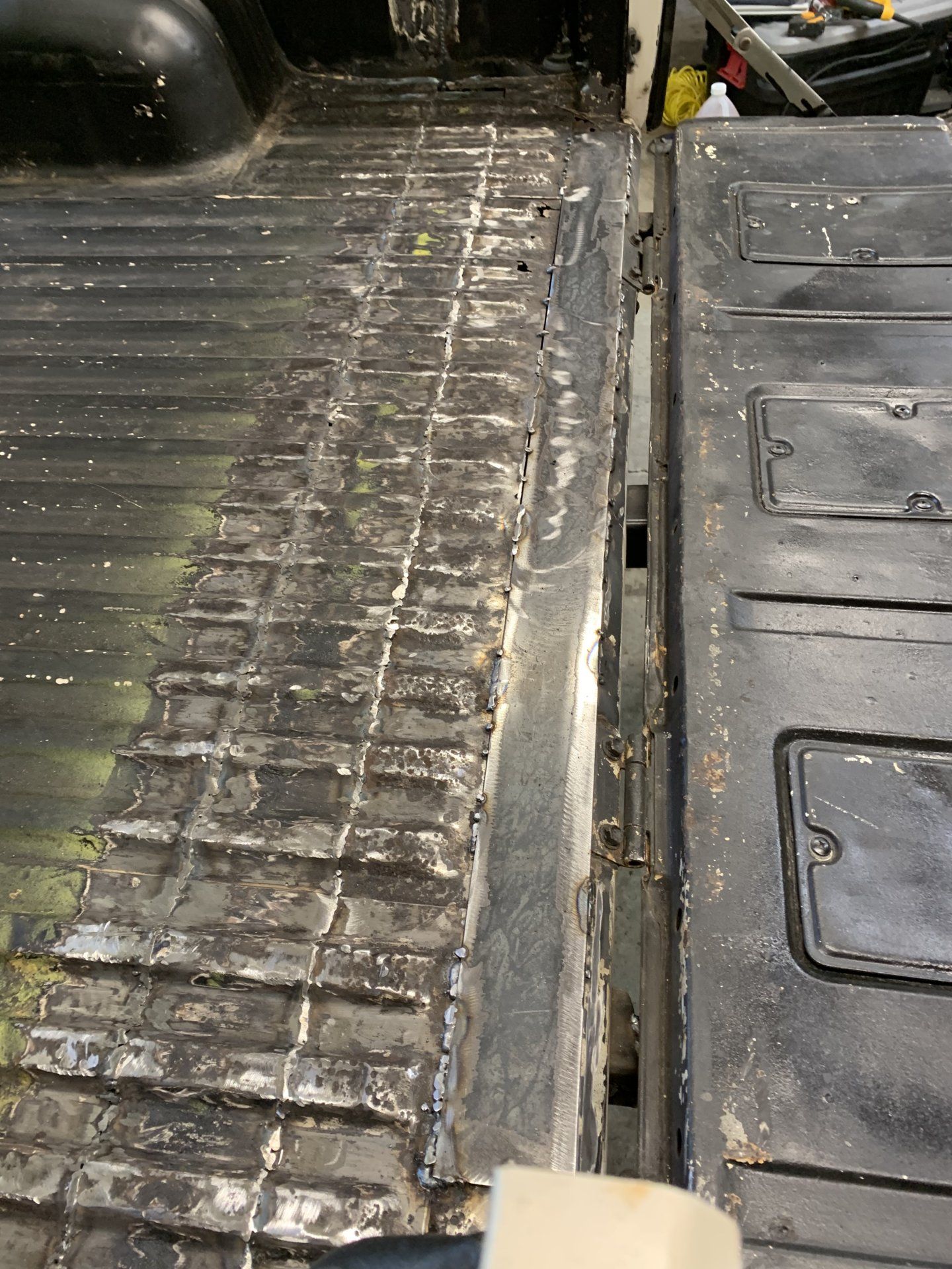

I also reinforced the rear of the bed near the tailgate because most of that area had popped the welds and was very rusty. Replaced it with 3/16 piece of plate for more rigidity.
Not done. Still have to patch a few more areas. But good enough for now.

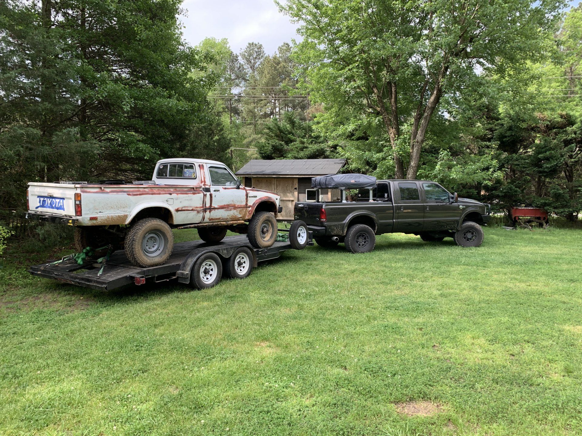

Went out to GSMTR this past weekend and had a blast with the truck. Right away I realized I had to do some trimming of the fenders and modify the cab with a hammer in order to improve my turning radius on uneven terrain with the bigger tires.
Also broke a drive shaft but was able to repair it and get back on the trails.
No pictures while on the trail. Was too busy driving but here is one on the trailer
