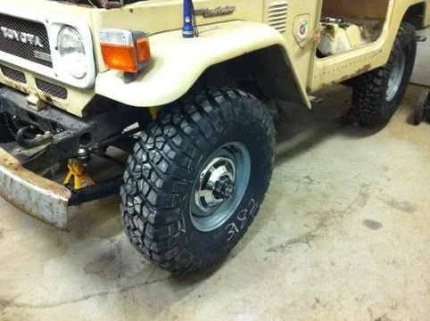

Cool. Thanks. You might want to rotate that rear drag link clamp down for a little extra just in case protection.
Are you pretty pleased with the 10.50 series tire fitment on the 15X5.5's? My 82 wheels are 15X6 and I have thought about doing exactly what you are doing.
FYI, with the stock offset wheels, manual steering is not bad at all. The only time I really noticed it was out on the rocks.
That's the first time I put a tire on. Good catch.
The way I see it I can air waaaay down and not loose a bead due to the narrow rims.
Parking lots, parallel parking... otherwise, no, not bad
It looks nice. I don't see any weights on your rims. Did you use stick ons? Also, do you do all that work in a 2 car garage?

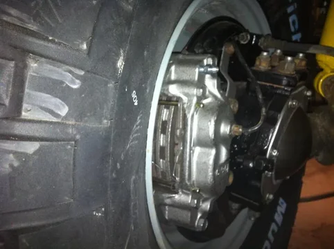

Got the new calipers installed yesterday. I think I am done with the front axle so I put the wheels and hubcaps on. I won't bother bleeding them until I have a chance to inspect the rear brakes. No point in doing it twice.
